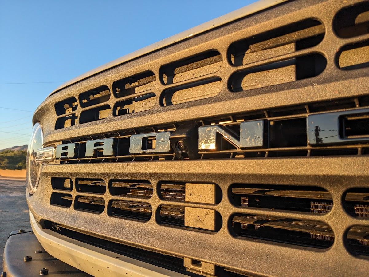

Got mine all together, very stoked on the end result. I thought getting the dash apart was actually easy, that sasquatch dash removal video that's out there was a huge help, it would be very hard without that video IMO, figuring out what to do without that would have been a pita. Shout out to @Preheateddinner for giving me some tips and info and guys like @strawhatguy for rekicking the front camera retrofit discussion off again. I can confirm the Naviks setup does work with the manual trans now.
I have the base grill and decided I wanted a really clean factory looking front camera mount so I ended up getting the OEM camera bracket and housing for the grill and retrofitted my camera into that. I like this setup since its clean and then also it points down which is what I want for when cresting very steep hills. The camera diameter was slightly smaller then the hole opening on the camera mount so I had to epoxy in a piece of plastic sheet into the back of the housing and then redrill to the camera size so the camera would be secure in the housing opening hole. Otherwise all I had to do was trim two pieces of plastic on the grill off and then bolt the mounts onto the back of the grill using the factory screws.

Wow definitely cleaner looking than mine! And I learned the oem camera had a washer to it. When does it turn on? With the window washer?

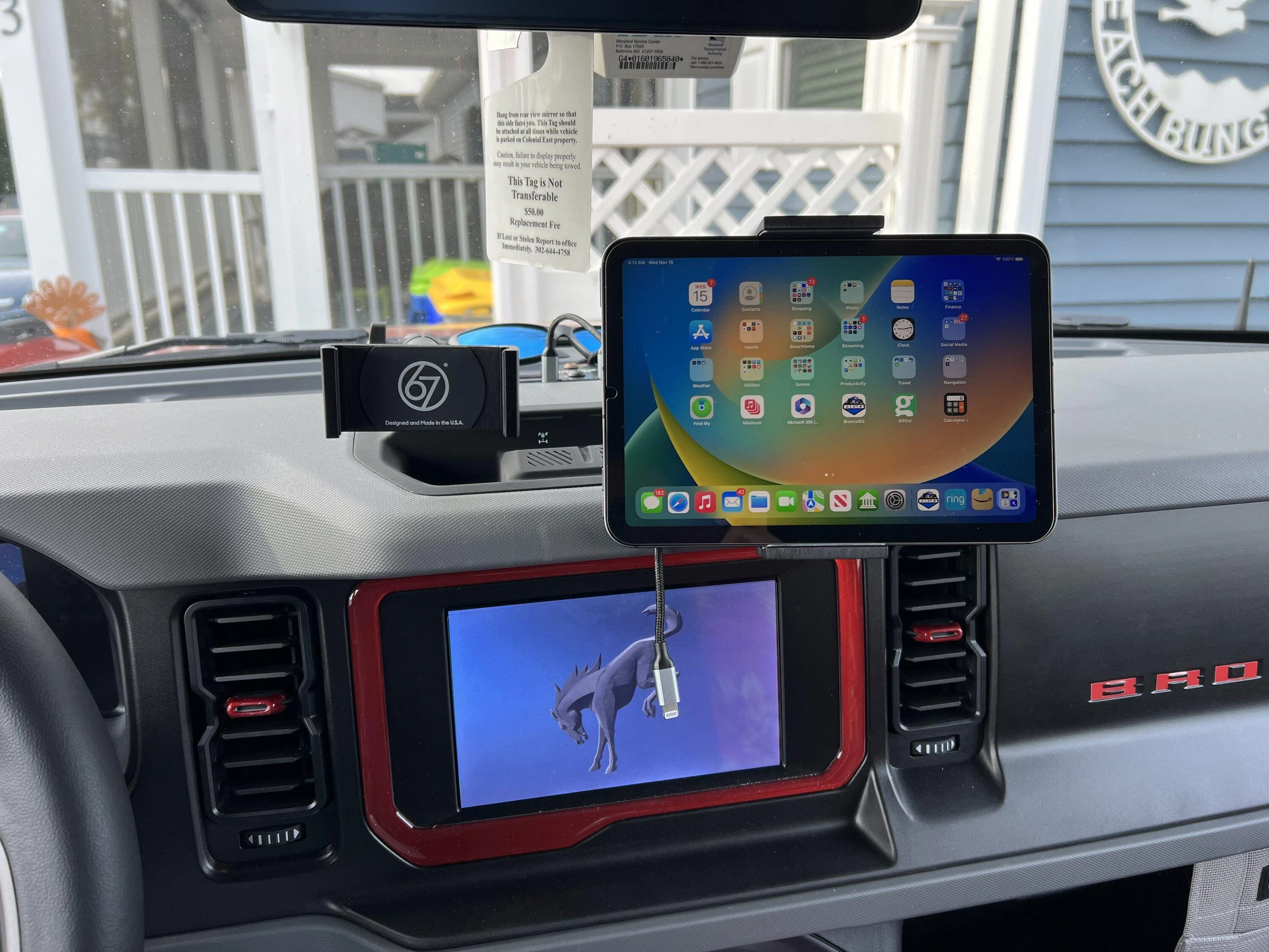

I have a better work around for the GPS losing its location when I use the turn signals. I have an iPad Mini 6 w/cellular. I mounted it using the 67 designs universal tablet mount. I tethered it via USB to the head unit. Play music via the USB interface and Apple maps. I also add the route to my apple watch which alerts me to turns. I am working on using my iPad pro 11. I ordered a longer arm will test once I receive it.
