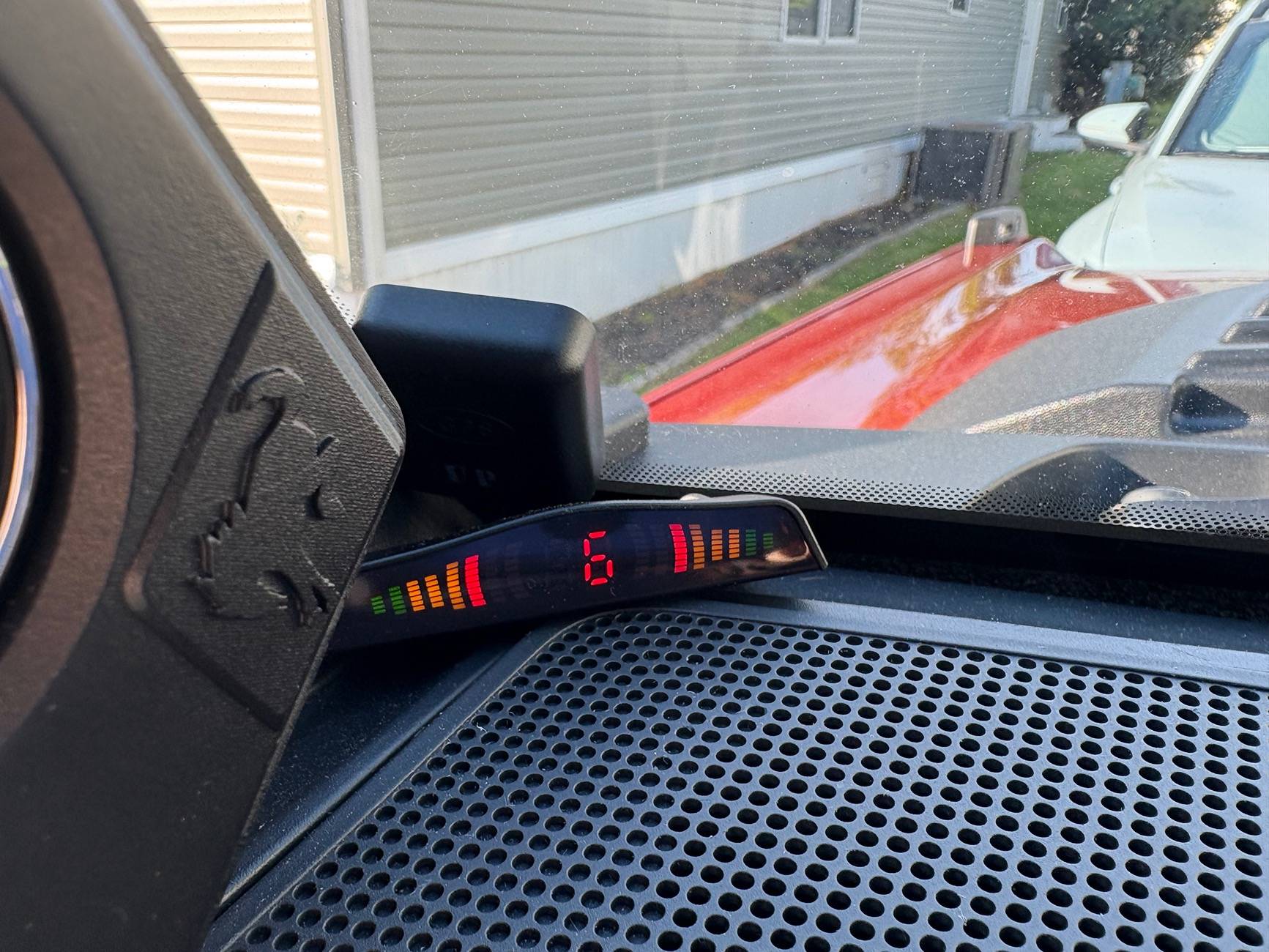

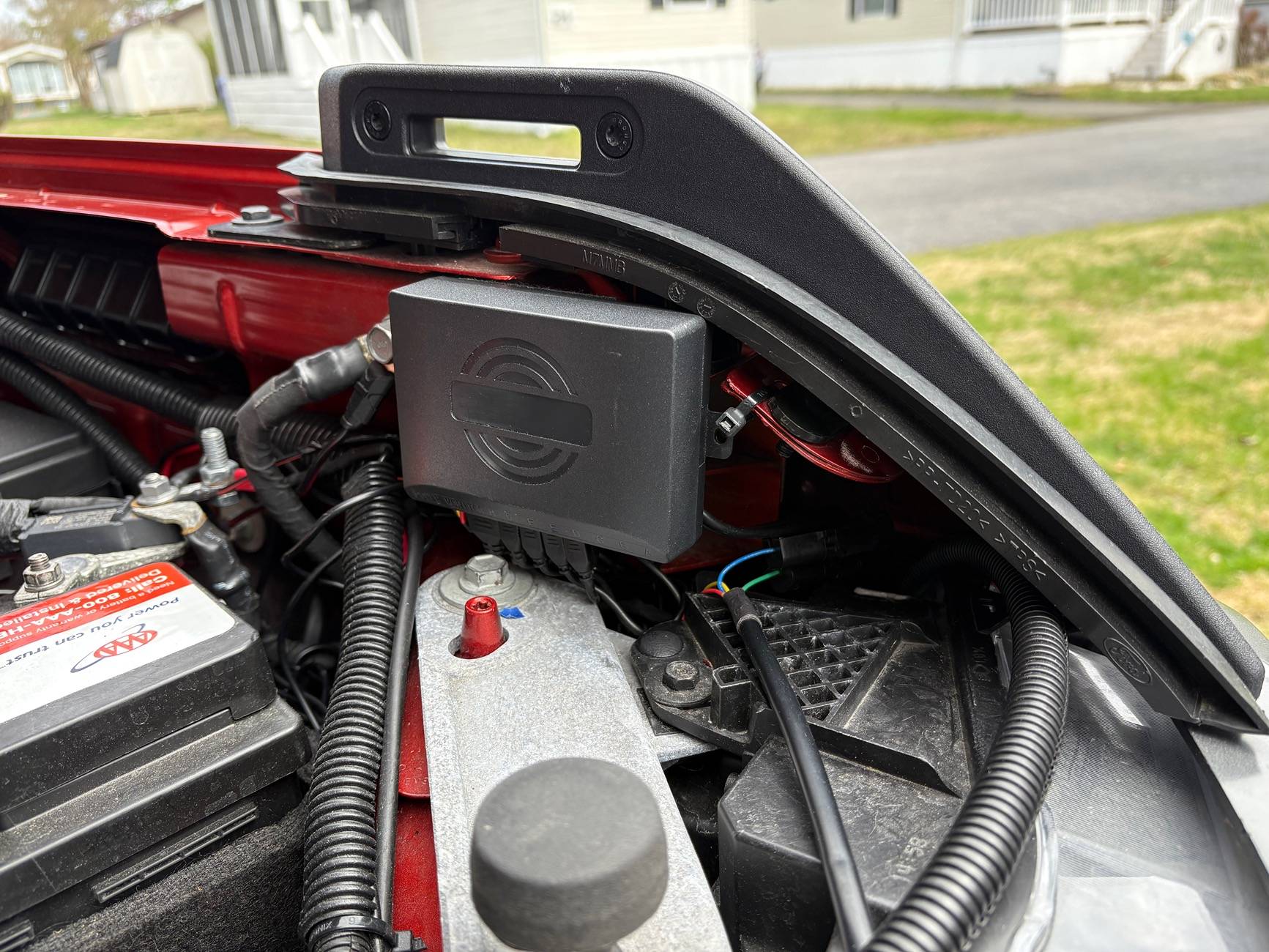

I ended up using an aftermarket system. My wife had issues parking. I think I ended up paying about $ 270 for everything. I had to drill the sensor holes in the modular bumper. I routed all the cables following the existing wire harness. I wired the trigger to one of the aux switches. This gave me the ability to turn off the system since it can be annoying in traffic. I could not find an easy way to tap the brake light wire as the trigger. I did not want to run a cable to the back. I chose the smallest display.
https://www.tadibrothers.com/products/bright-display-parking-backup-sensor-system
Appreciate the suggestion, although I don't think my wife is going to accept anything less than OEM for her new car.
When you say you routed following the factory harness, which harness are you referring to?

The factory fog light harness.
