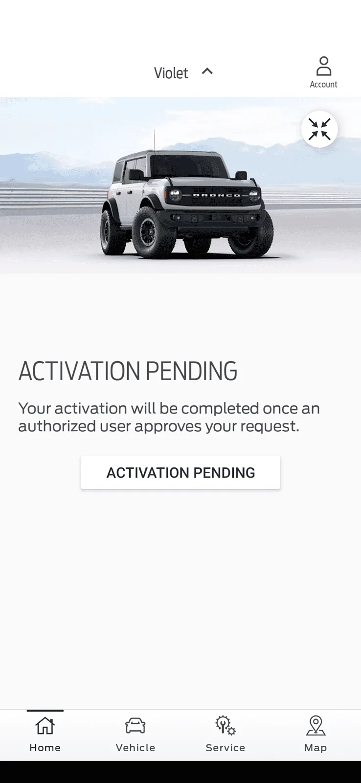

So when we were setting up Fordpass originally we put my wife's email as the contact email. I tried to switch to mine and now I get the activation pending message. Problem is that she's never had Fordpass. We tried installing the app on her device to get her to ok the email switch but she didn't get a notification. Tried doing the email switch again but now Fordpass isn't responding. Who or what confirms Fordpass activation requests? Thanks.
Ford Bronco Activation pending Screenshot_20240408-094839

Once the activation request is received by the vehicle it may take a bit to get the acknowledgement on the center screen of the Bronco. You can always go into account on Ford Pass select the vehicle and delete it from Ford Pass. Then restart the process of adding the vehicle to Ford Pass.
  1. Make sure your vehicle is turned off, then select Add to add your vehicle.
  2. Scan or type in your VIN.
  3. Name your vehicle.
  4. Select Activate Vehicle.
  5. Start your vehicle and select Allow on the in-vehicle pop-up. If you’re having trouble activating, FordGuides are here to help: (800) 392-3673.

Thanks. Tried this before and couldn't get it to work. Just did a factory reset and started over. All good now. Thanks
