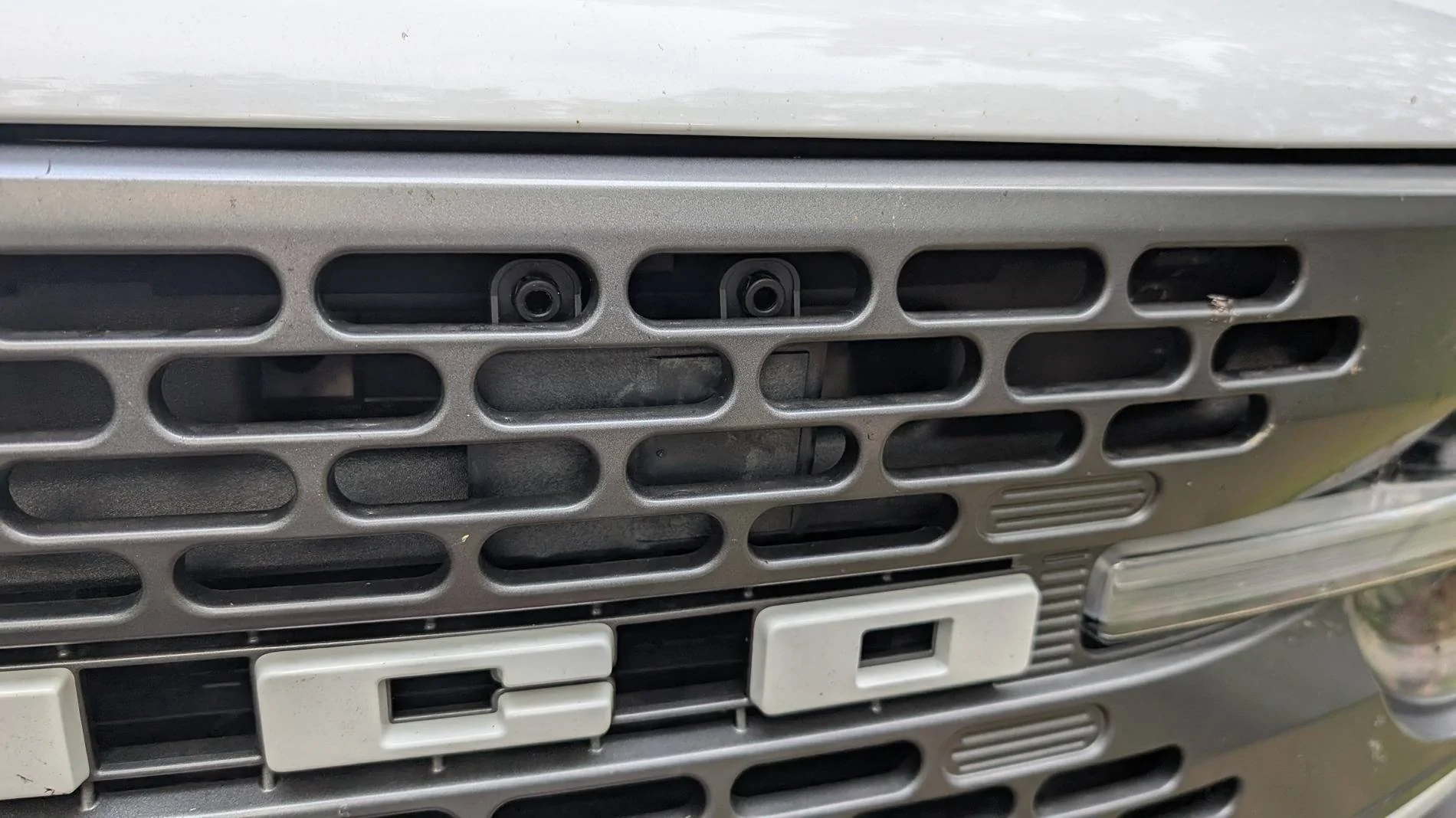

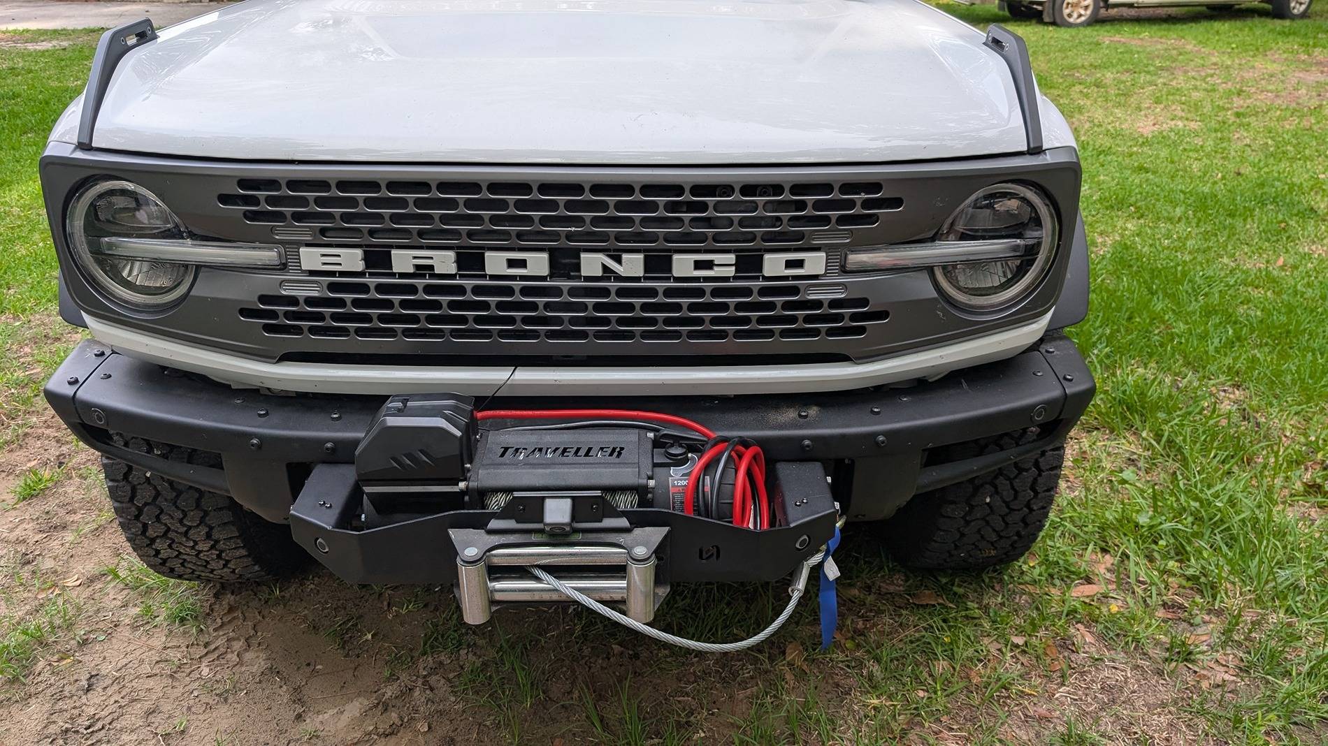

Installed the Turn Off-road winch mount bc it didn't require any frame modifications. I also bout their Front Camera Relocation kit and the ACC relocation kit. I fought and fought with the ACC kit bc I didn't want to cut apart my active shutters. Found a great spot to mount it in the grille. No cutting required. ACC wire runs behind the active shutters and the ACC module is mounted between the grille and the plastic backing plate. Pics for detail.
