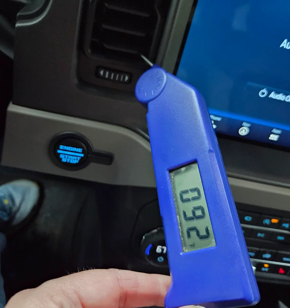

More to the story... Took it to a dealer, and they couldn't find anything wrong. They said the tech said it was blowing at 35 degrees. Must have been Celsius, as it doesn't get anywhere near that cold in Fahrenheit! I checked it with a very accurate chef thermometer in my vents, with the air set on 67 degrees, and my thermometer shows 92 degrees! When I set it to Lo, it blew 59 degrees. Seems to be a massive difference in actual temp for just 7 degree change on ac dial. Guess I'll try another dealer

Seems like for the fancy temp systems there is a temp sensor down by the drivers side knee that loves to have issues and feeds back to the hvac to tell it the cabin temp
92F may as well be heater running
