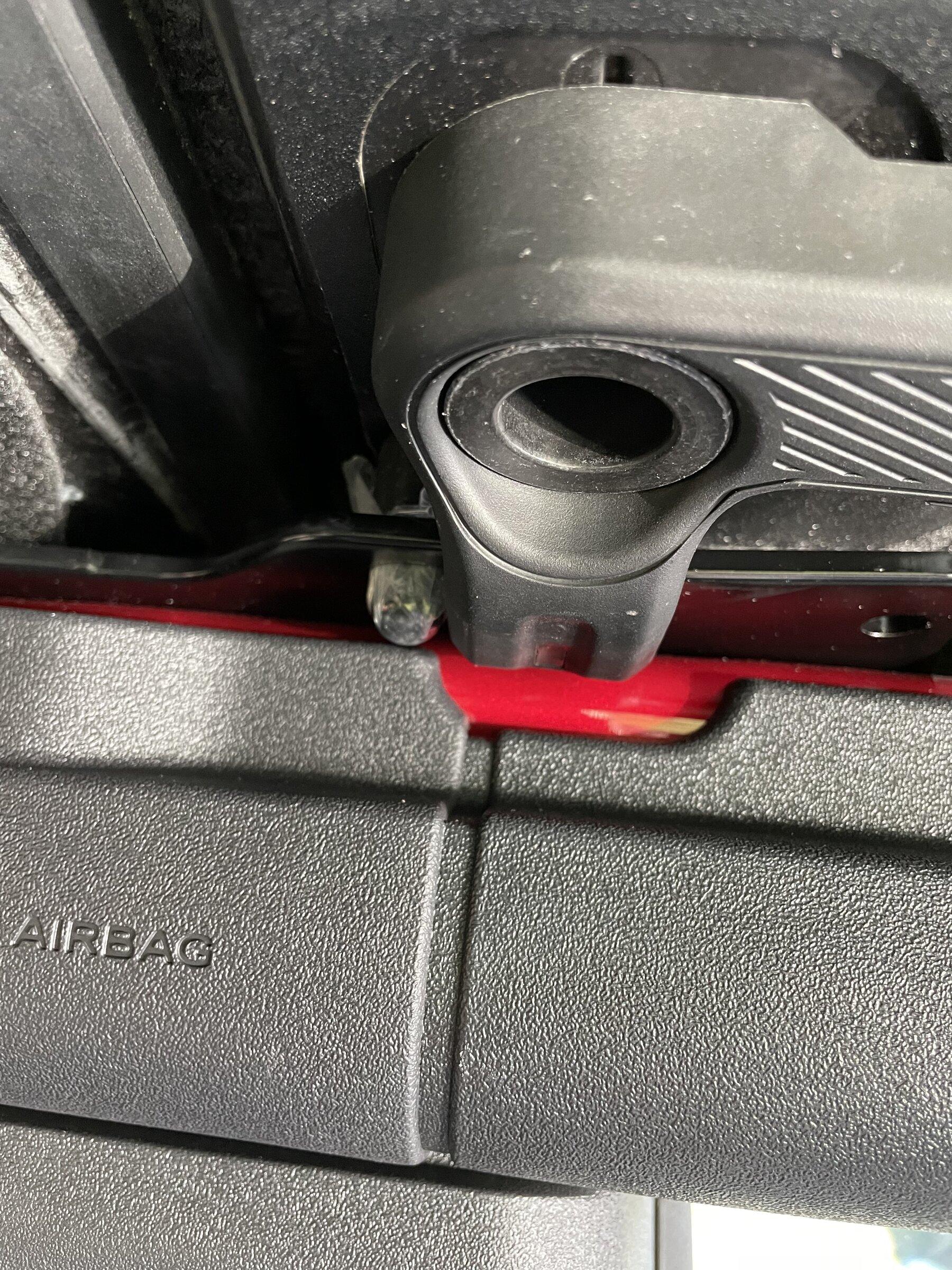

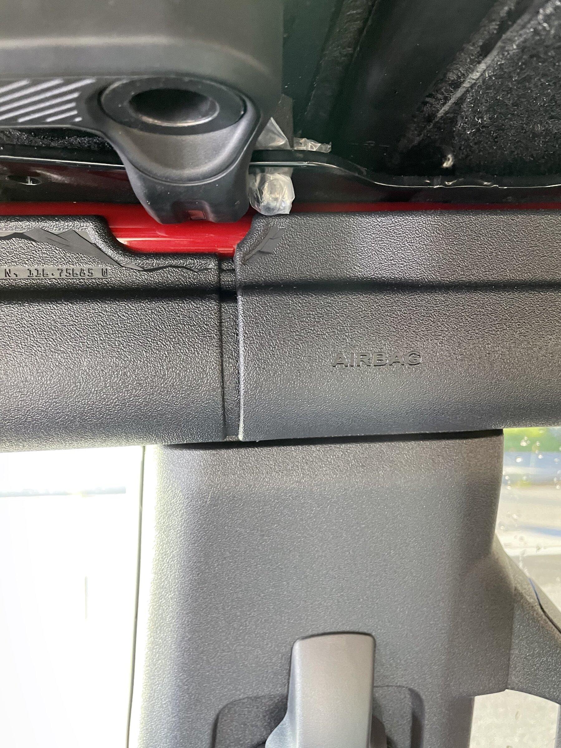

I’ve had some popping sound but it seems like it is coming from the passenger window. Also some squeaking from just above my left ear… in shop now having
them look into it… would you mind taking pics of what you did with the foam?
here is the popping
it’s the guide pins on the roof panels. Wrap them with a single tight wrap of electric tape. Heres my first fix, trash condoms, shows location.
here is the popping
Yes that sounds like the popping/squeaking that seems like a very common defect for MIC roofs. If it's from the same thing as everyone else's issue then it's because Ford cheaped out and didn't put rubber grommets in the holes where the MIC roof goes in. You basically cut 2 inch by 2 inch squares from foam craft sheets like this that you get from a hobby store or amazon. You place them over the holes before you put the top panels back on so that the foam goes into the holes with the plugs that are on the roof panels. It stops that popping/crackling sound.
Here is another thread about the fix that includes images that basically show what it looks like. I used thinner craft foam than what they used, but the point is to stop the peg/plug from rattling and rubbing against the metal holes that they go into.
here is the popping
I just lubed the guide pins.
No more noises in ??? a few months or more???.
People getting all tricky with foam etc etc.
I used a teeny tiny amount of vaseline ... probably any lube will work, white lithium, etc etc.
Vaseline was the cleanest stuff I had in the garage.
