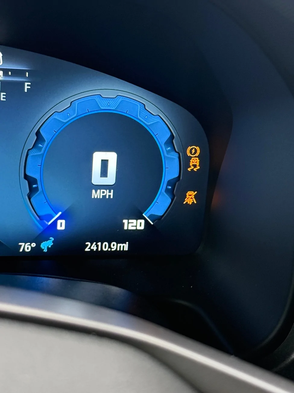

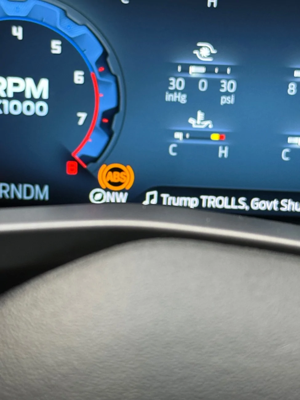

ABS light and collision detection systems unavailable and other lights in dash just lite up for no reason. 2025 Big Bend. Help
Ford Bronco ABS light just came on. Help IMG_0427
Ford Bronco ABS light just came on. Help IMG_0426

Hill Start Assist failure as well

You need to see the DTC code
there are hundreds of possible causes do those lights. While there are definitely some repeat offenders, not every case is the same
Odds are you just had some excessive wheel slip in the rain and the Bronco interpreted that as a potential broken axle — this is fairly common and once reset, everything is fine. Just an overly vigilant computer check. Low or failing battery is another common cause and easily fixed with an overnight on a trickle charger. Dirty or damaged wheel speed sensor another common offender.
But if you pull the DTC code with a OBD reader - we won’t be sitting around just guessing. If you don’t have a scan tool often auto parts stores will read them for free.
