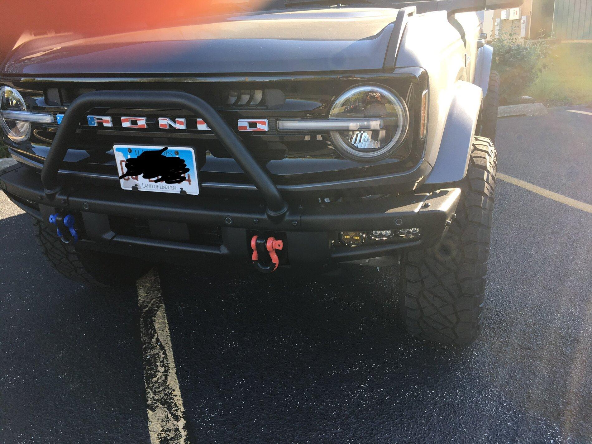

OP, it is assumed that the offset for the OBX wheels are the same as the stock BL wheel which is +55mm. If you have a few minutes this weekend, maybe pull of the spare and look for the stamp on the inside of the wheel to confirm as I don't think anyone has done so yet.
So, assuming the offset is +55mm and the wheel sits flush with the stock fender
+55mm = 0" poke (all stock Bronco wheels?)
+30mm = 1" poke (Sasquatch wheel)
+18 = 1.5" poke
+00 = 2" poke
-12 = 2.67" poke
There is no need to do that. It is +55 offset. Not hard to find that info.
OP do you ever drive off road? I would never want that kind of offset on mine. Mine is a filthy beast with the 255s that came on it.
