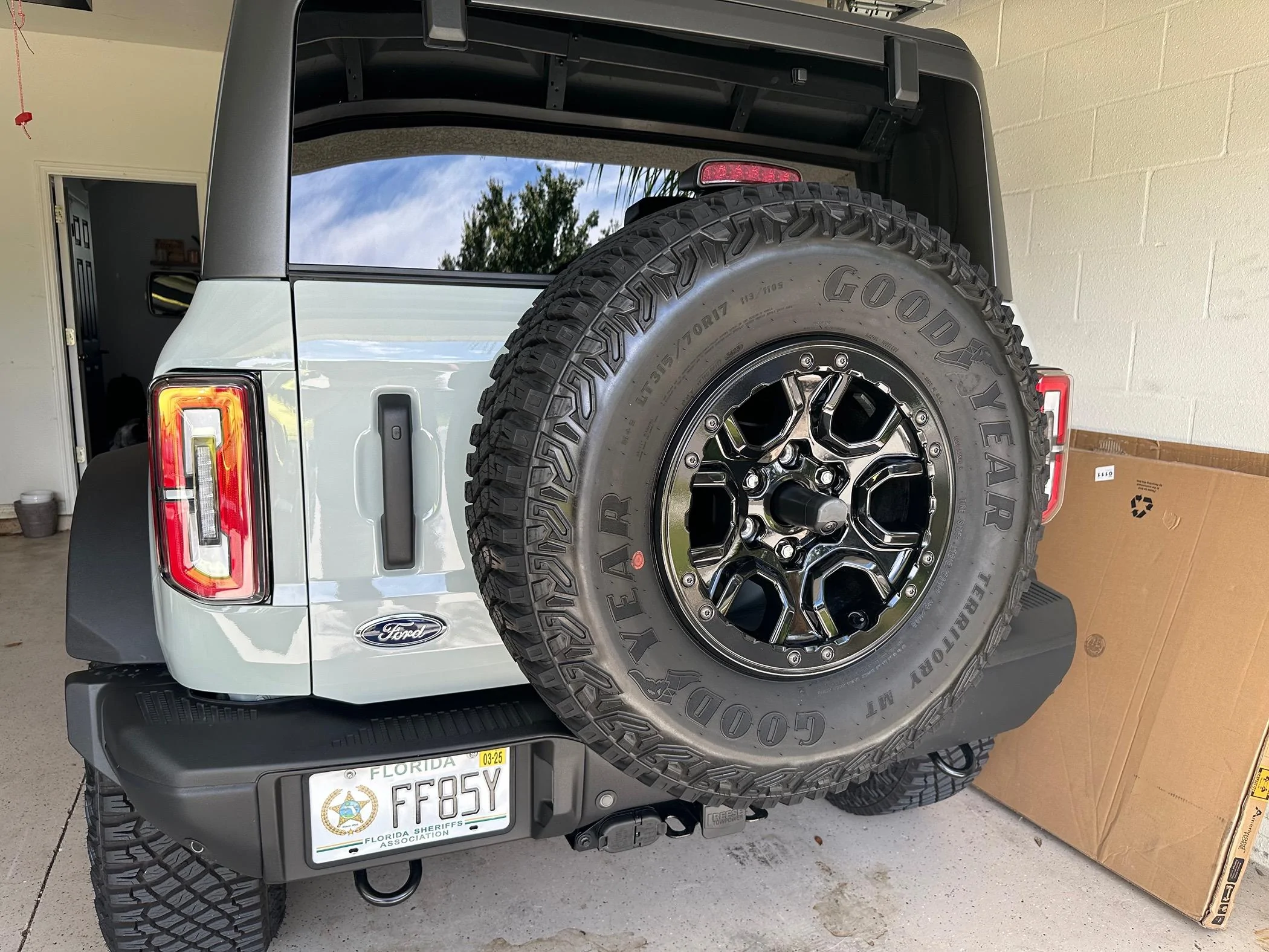

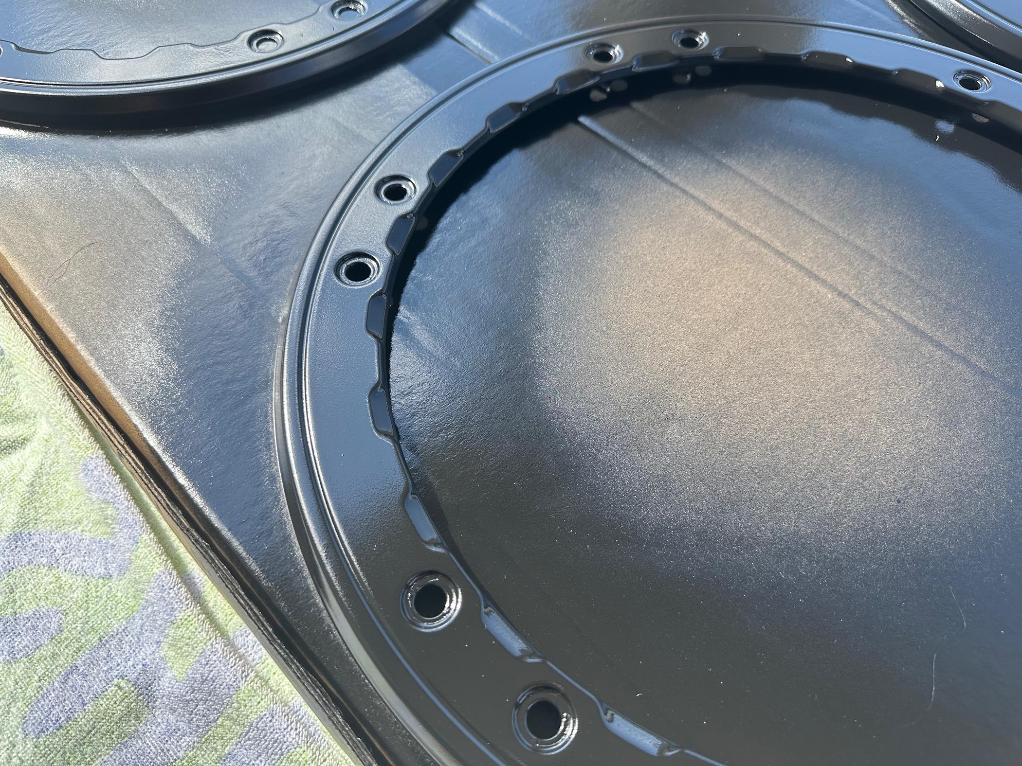

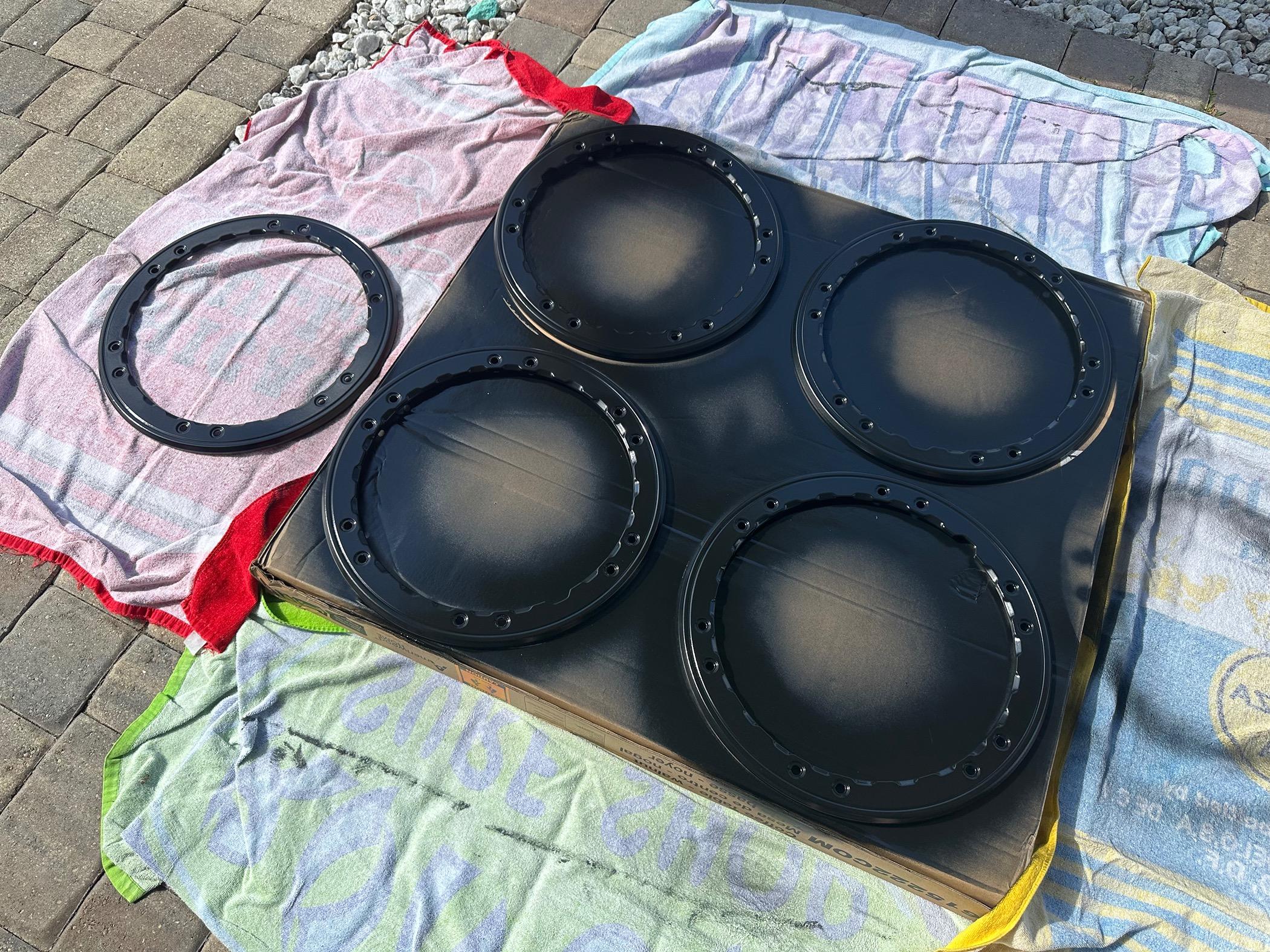

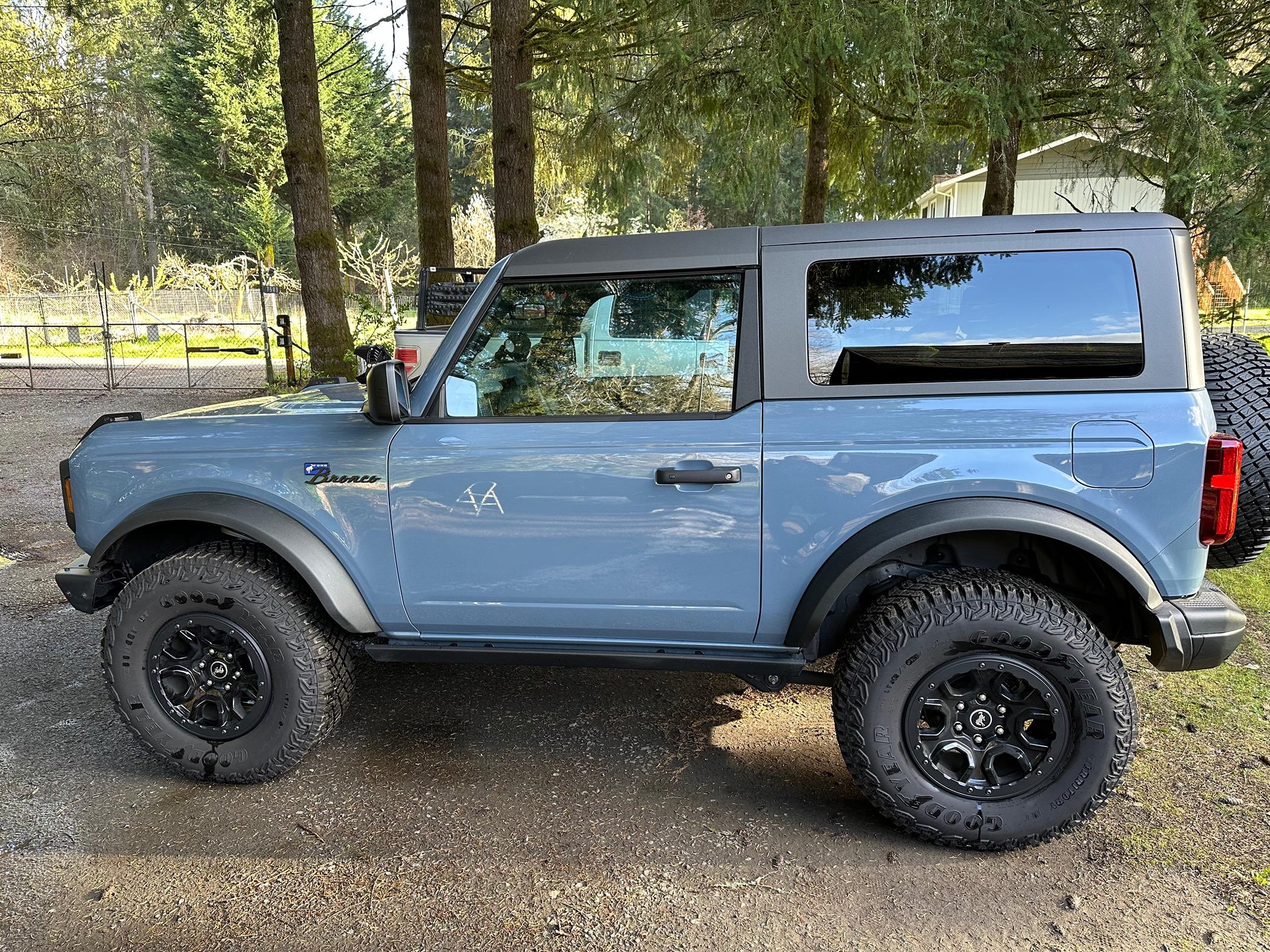

Man what a pain though. Getting all the bolts out with every single one being locktite’d. I had to break every one loose with a ratchet and a T45 torx and then I could buzz them off with my impact driver.
Used Raptor1k wheel paint from auto zone. Also the blend 3m scuff pad. That made quick work of the factory finish and made it perfect to spray with the 1k, no primer.
Huge pain in the ass to clean them, then scuff then clean again then paint. But they all came out awesome. I’d do it again if I have to. Total cost was $27 all from auto zone. Also I was lucky enough to get all 5 wheels completely finished black under the rings. I know some weren’t all the way finished.

I would have went that route, but even bringing them in all my local coaters wanted $300++. And honestly the three closest to me had HORRIBLE google reviews. Lots of 5 star generic reviews, and then 1 star paragraph reviews. I figured for the $30 or so it would take to try, it was worth it vs losing $350 on a shit job or having the shop take weeks and weeks to do them. If they dont hold up or I damage one wheeling, I will just repaint the damaged one or do the distance and get the powder coated.

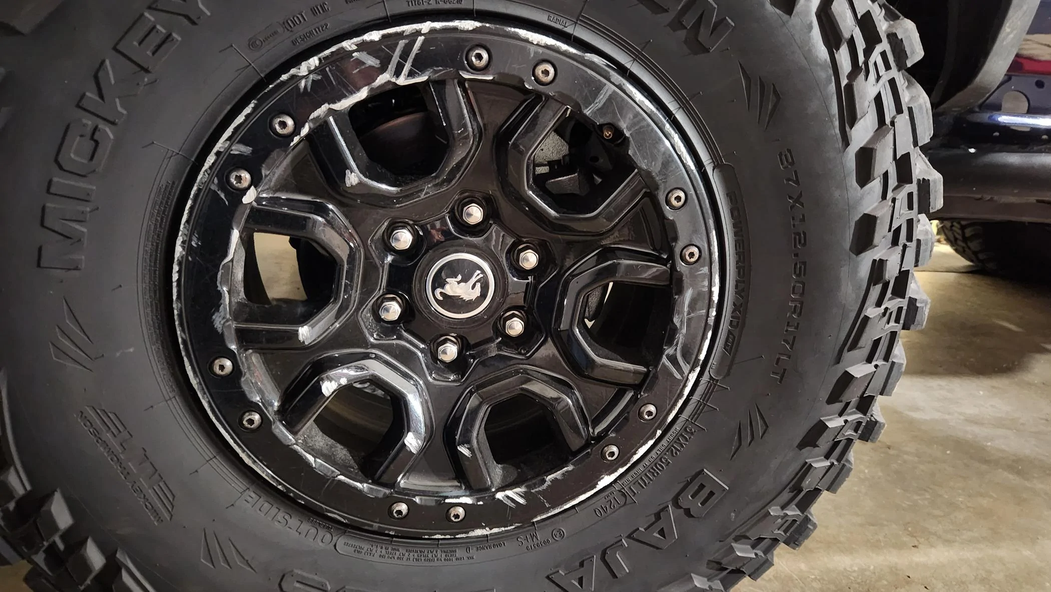

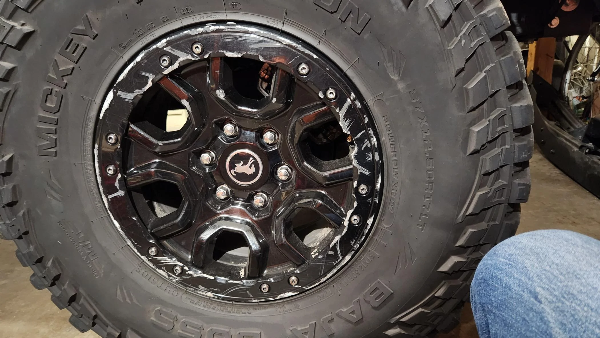

I got mine powder coated and it was $250. I did a matte black on the rings for some contrast to the gloss wheel.
