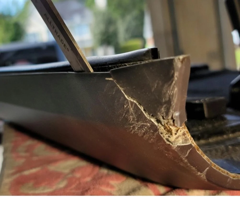

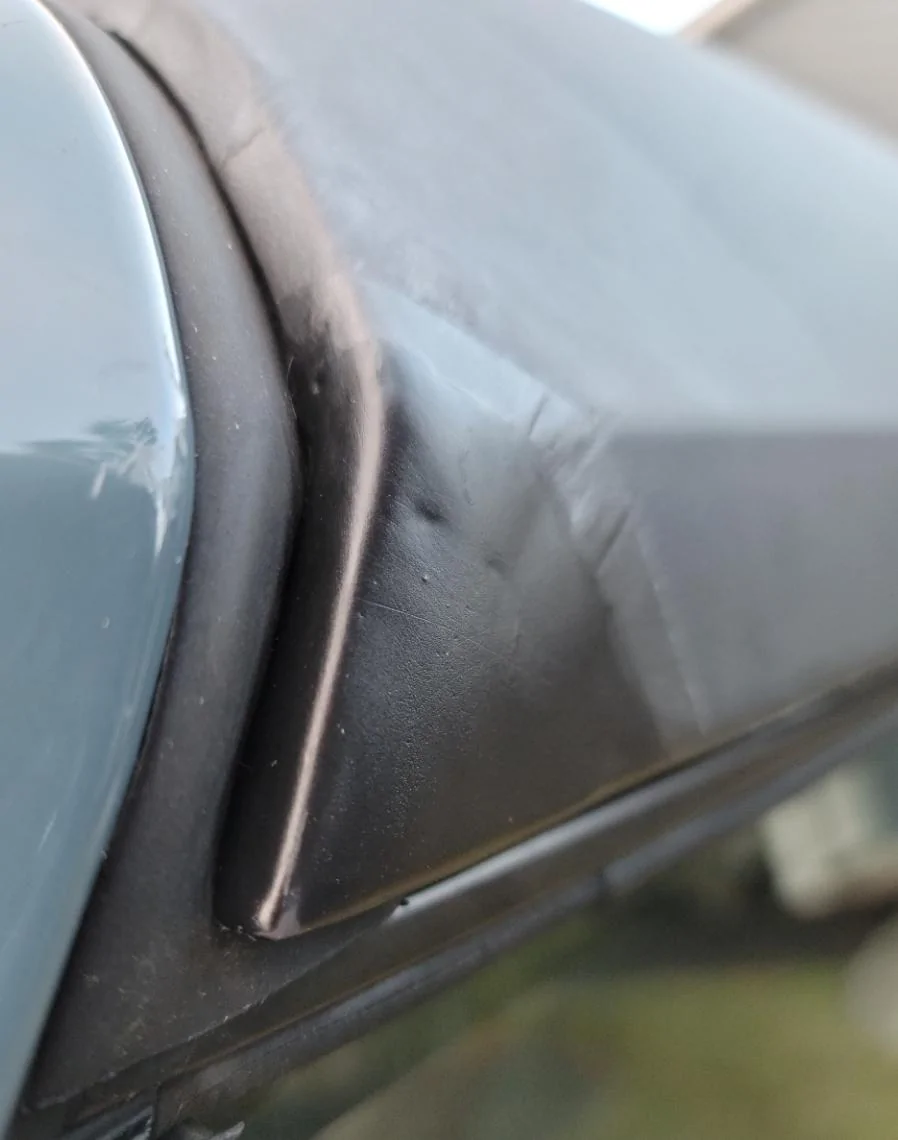

Depending on damage, the MIC top can be repaired, (I did it) but theres no paint that will match a color impregnated composite. You can, however, repair a panel and then paint the whole top in a new color. Are all the panels damaged? I used a carbon/graphite blend in my epoxy paste, for UV protection and for a marginal color approximation. If the panels were painted, there are lots of options. I'll be painting mine white, eventually.
