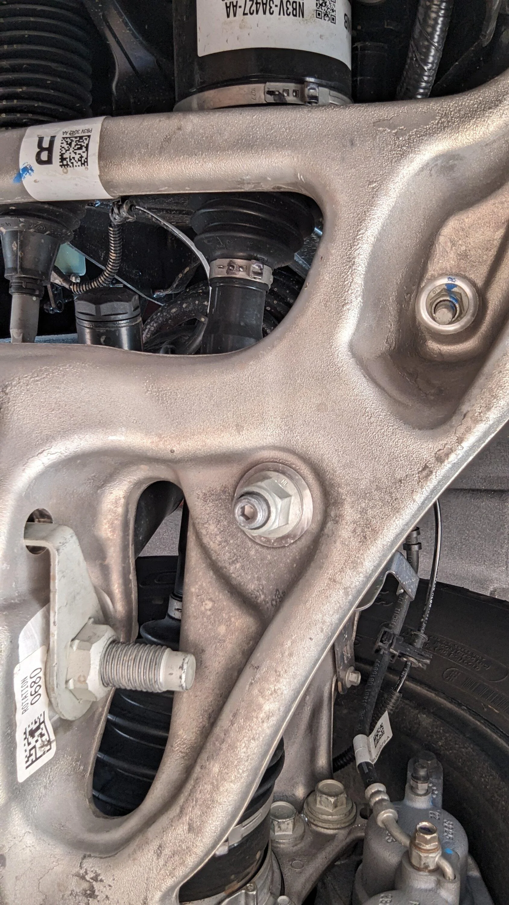

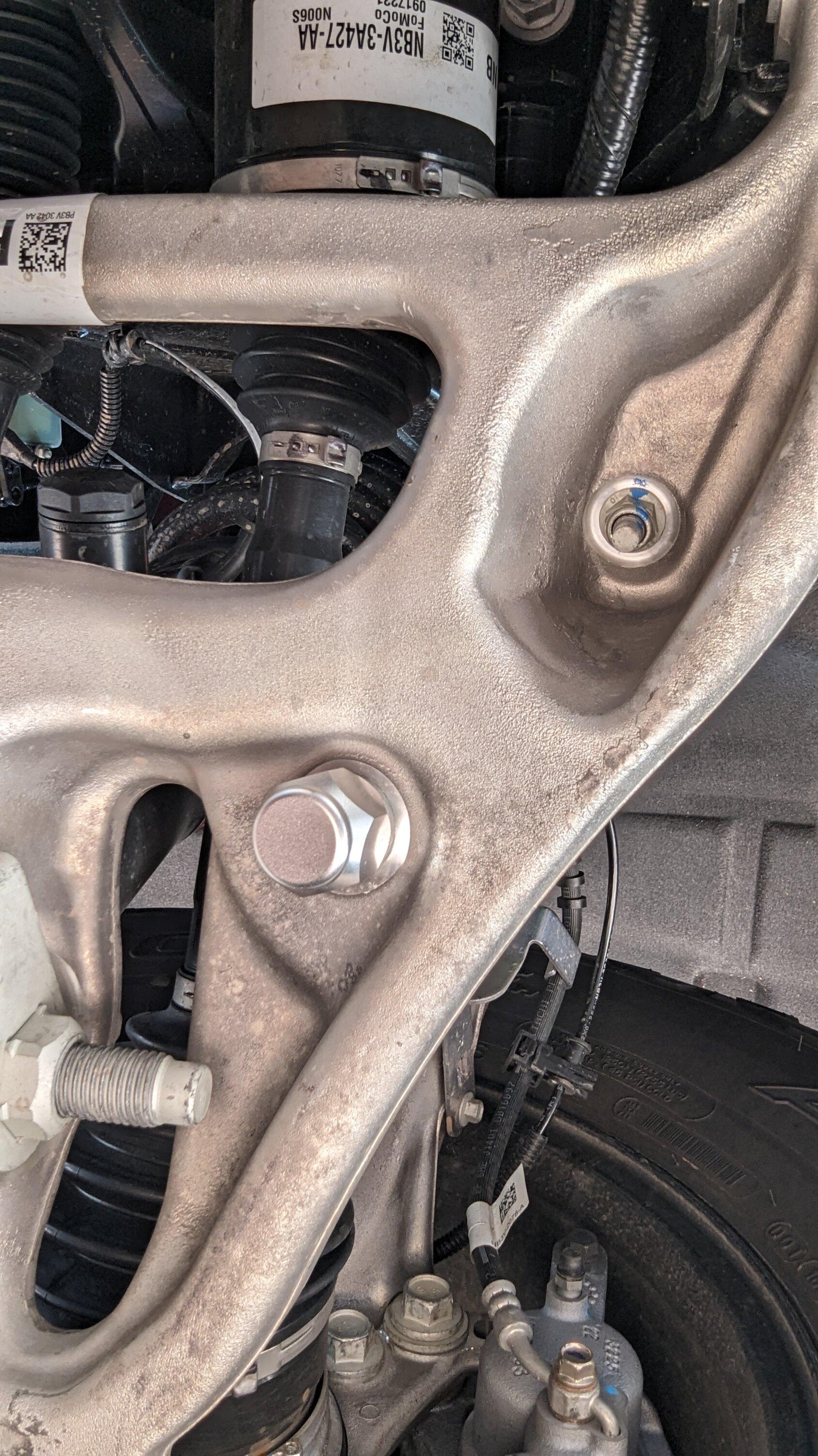

IAG Lower control arm screw caps (note the kit includes 2 small and 1 large nut per side for the base Bronco but the Raptor only uses 1 large nut per side). Before and after:
Ford Bronco Swamps Code Orange Bronco Raptor Build PXL_20231221_182237344
Ford Bronco Swamps Code Orange Bronco Raptor Build PXL_20231221_182249782

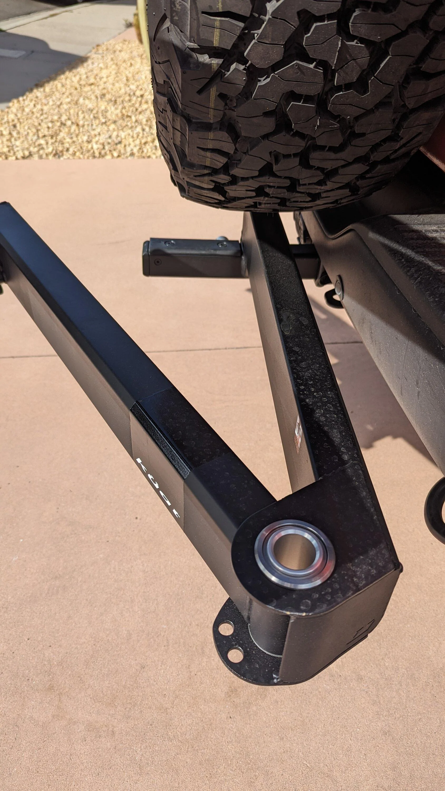

Kuat Pivot V2 Swing Out Bike Rack Adapter:
Ford Bronco Swamps Code Orange Bronco Raptor Build PXL_20231221_182929275

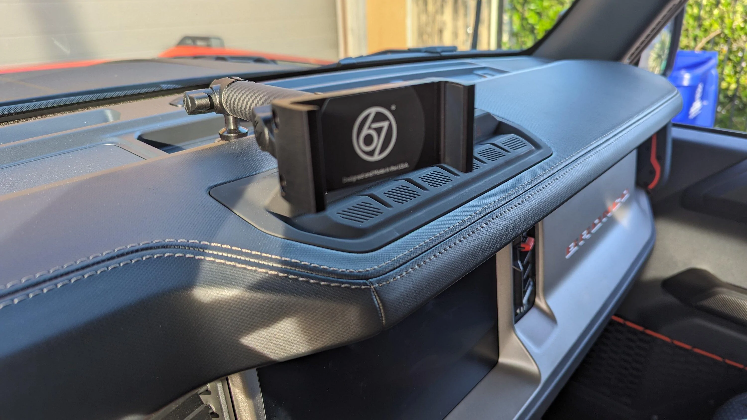

AR/67 Designs Phone Mount:
Ford Bronco Swamps Code Orange Bronco Raptor Build PXL_20231221_232400000

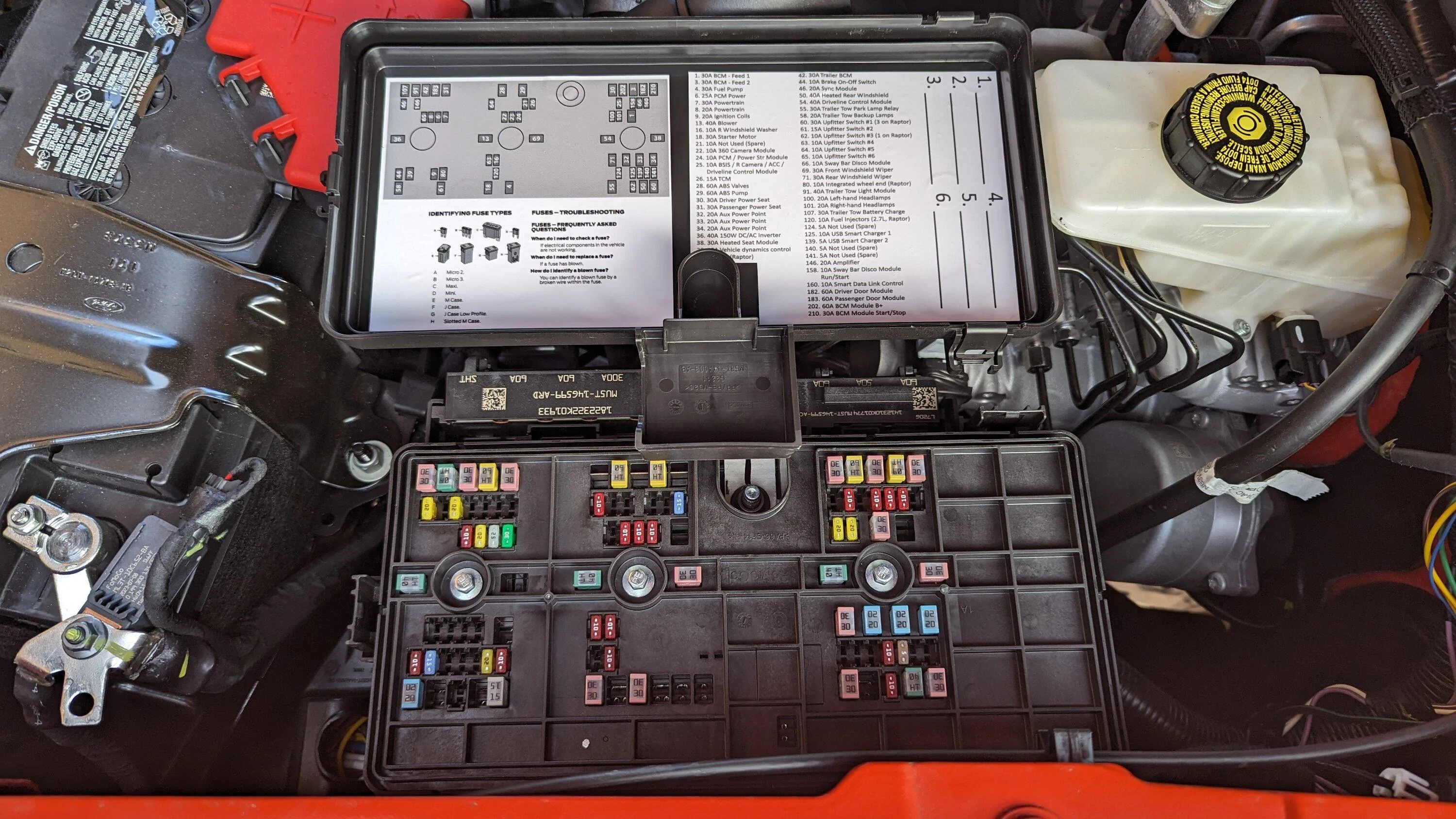

Sticker Fab Fuse Box Labels:
Ford Bronco Swamps Code Orange Bronco Raptor Build PXL_20231221_234810486

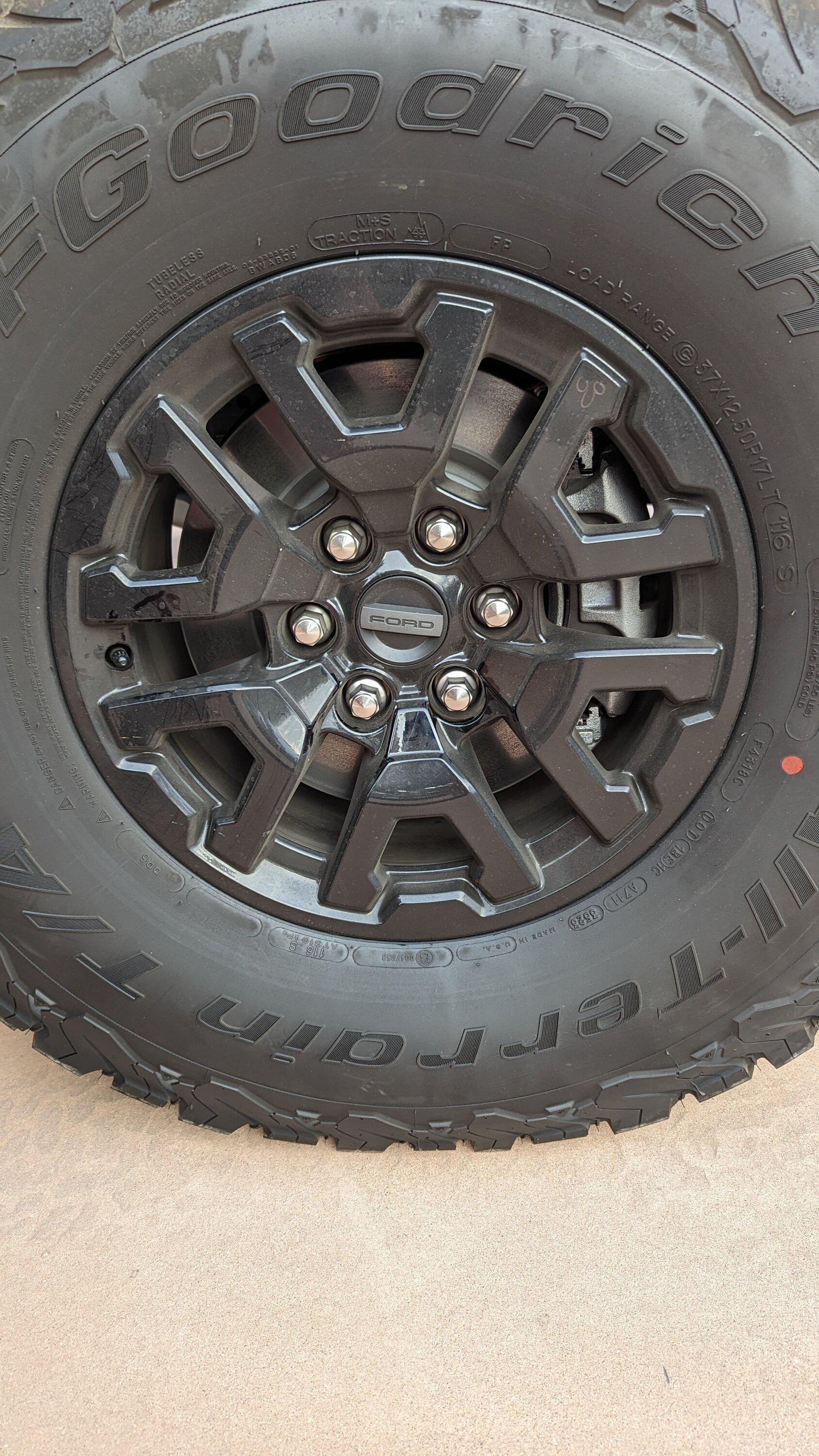

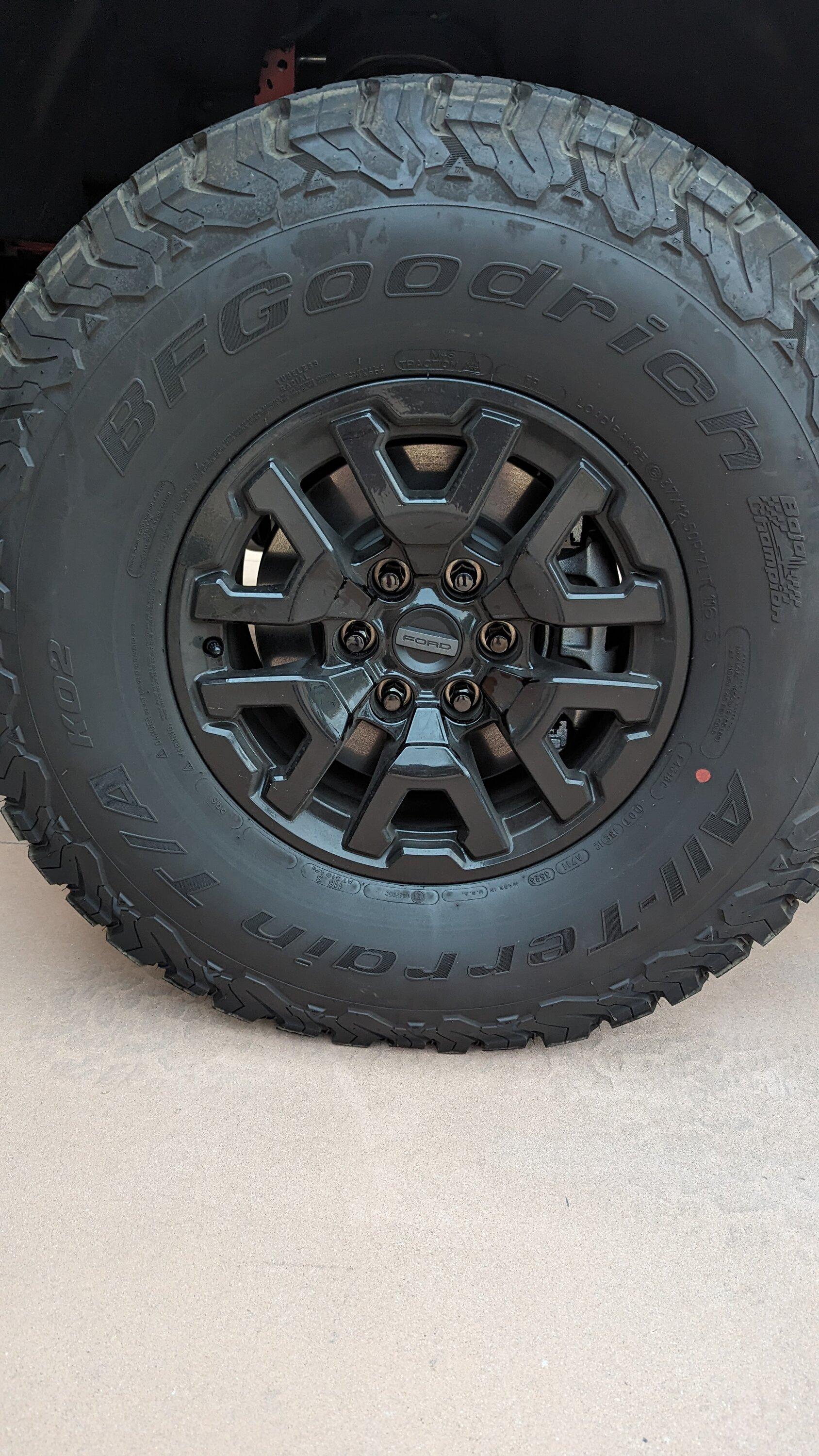

McGard Black Lug Nuts (before/after):
Ford Bronco Swamps Code Orange Bronco Raptor Build PXL_20231221_235537553
Ford Bronco Swamps Code Orange Bronco Raptor Build PXL_20231222_003042295.MP

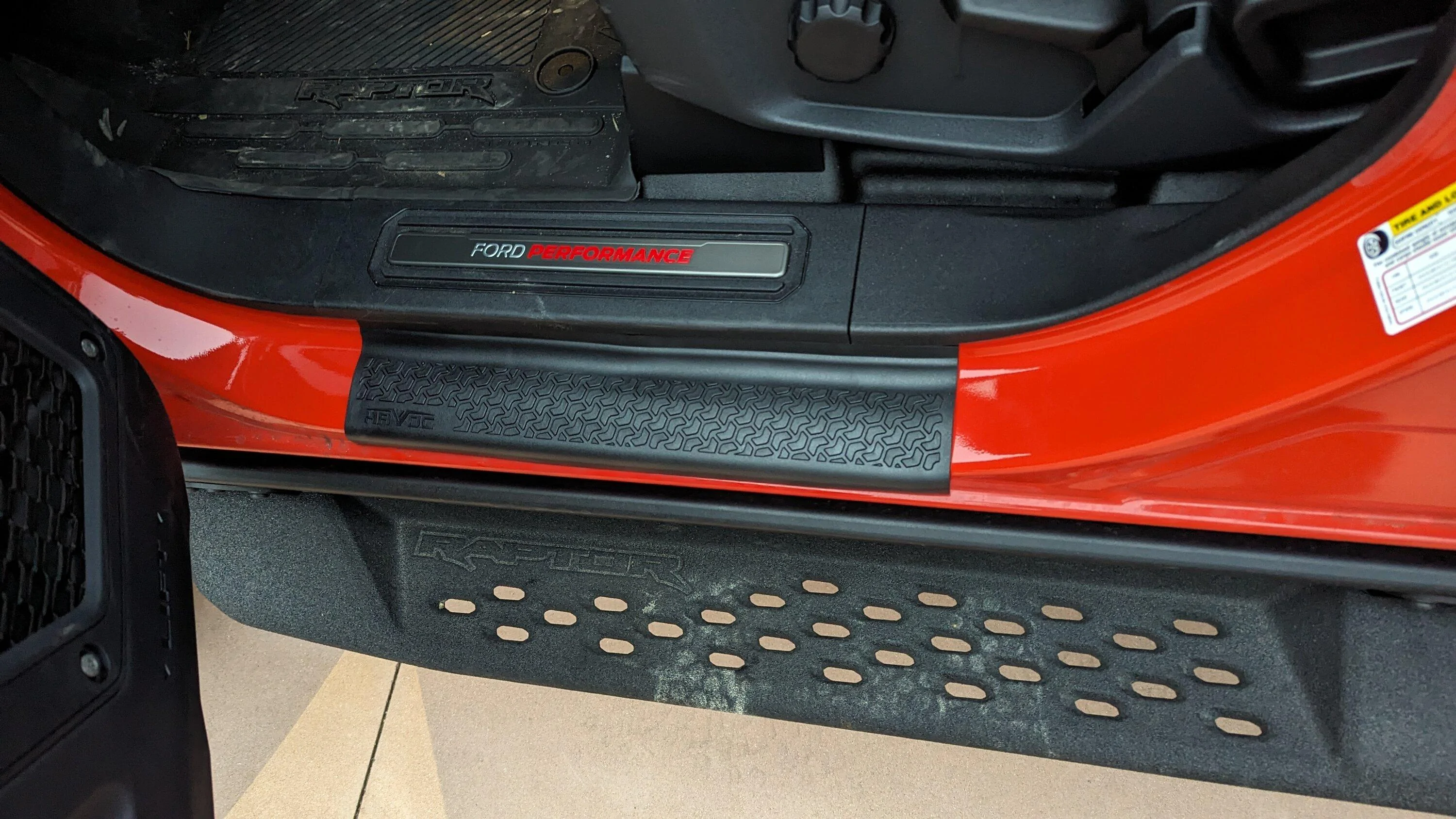

Havoc Offroad Sill Guards:
Ford Bronco Swamps Code Orange Bronco Raptor Build PXL_20231222_004447199

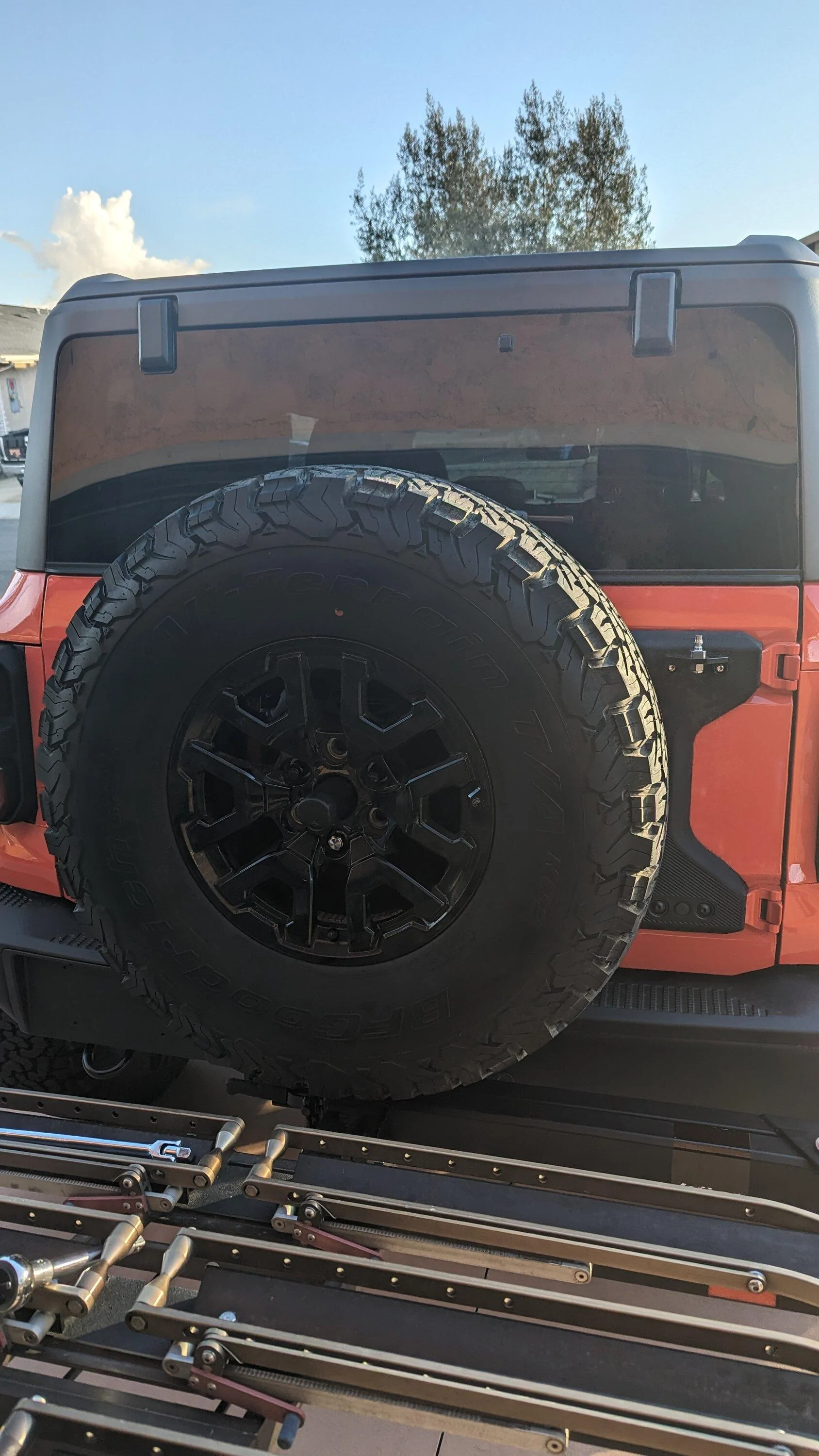

Removed 3rd Tail Light:
Ford Bronco Swamps Code Orange Bronco Raptor Build PXL_20231222_234857175

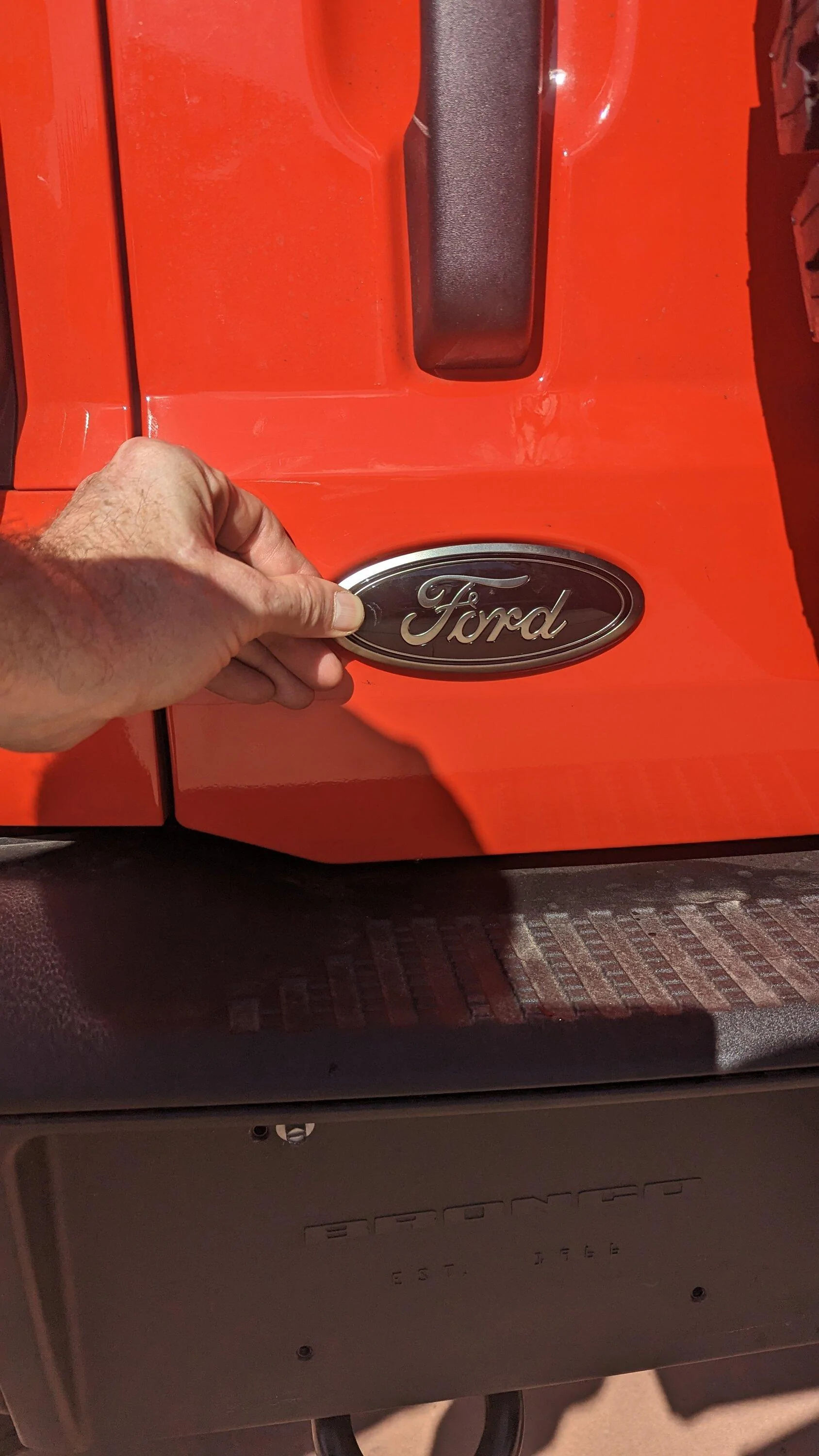

Replaced Rear Raptor Logo with Ford Black Chrome Oval:

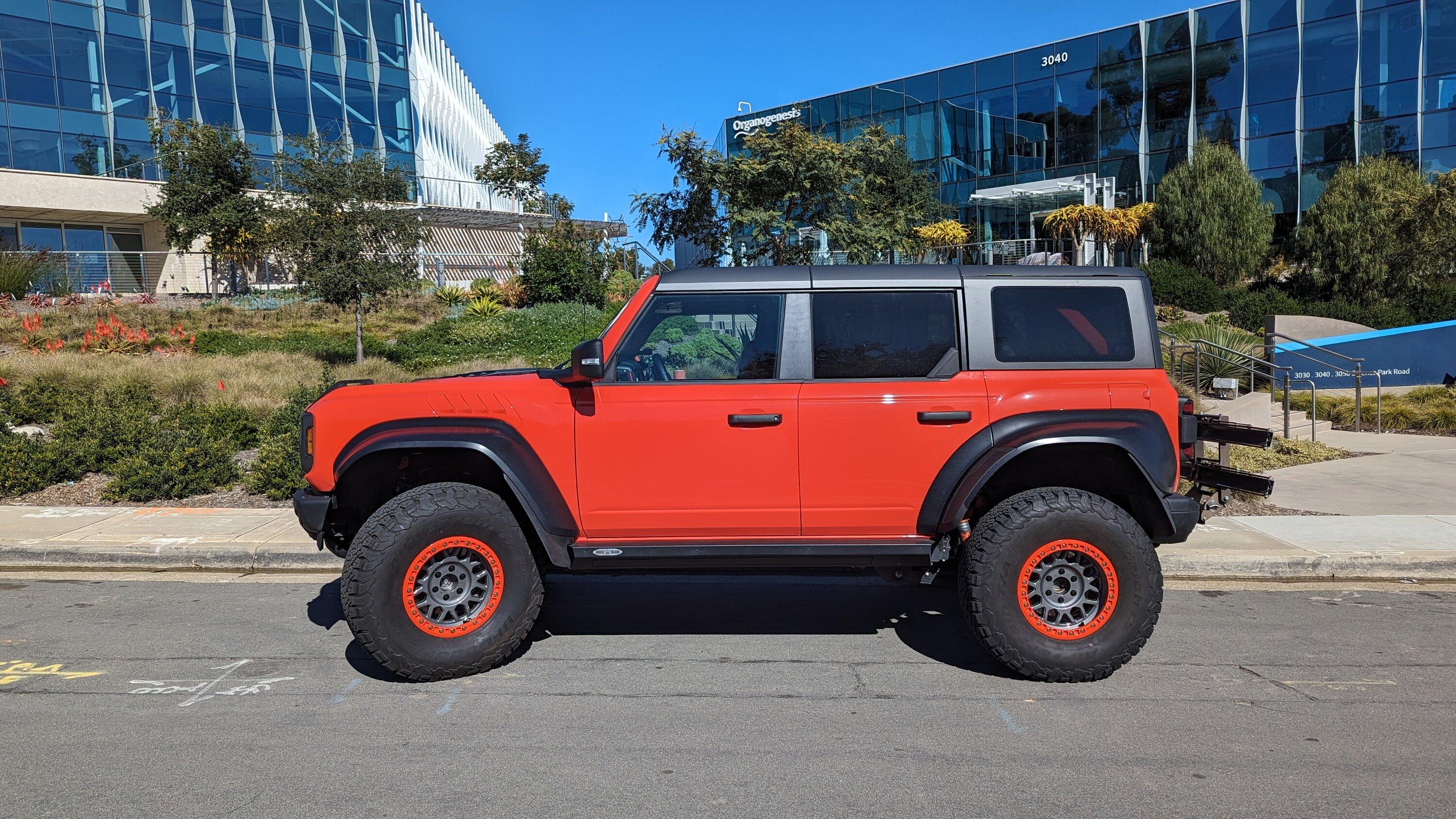

And finally a recent shot:
Ford Bronco Swamps Code Orange Bronco Raptor Build PXL_20240211_190035199

Love it. Can you educate me as to what the IAG screw does please.
swamp2
swamp2
Dec 19, 2022
156
4,130
4,262
These prevent damage to the bolt threads and nuts when rock crawling. Obviously, if they get damaged, removal of the nuts would be slightly to significantly more difficult.

Hey swamp how you like the fit and quality of the sill guards?
swamp2
swamp2
Dec 19, 2022
156
4,130
4,262
Love 'em @Breptar , I specifically wanted a thick and textured sill guard and I think these are the only ones on the market. I don't care for the skateboard grip tape style ones. These tucked up under the sill plastic and fully wrapped around the 90 degree metal fillet on the lower sill.

Yeah, I don’t care much for the grip tape
Style either. These don’t interfere with the door or door seal, do they?

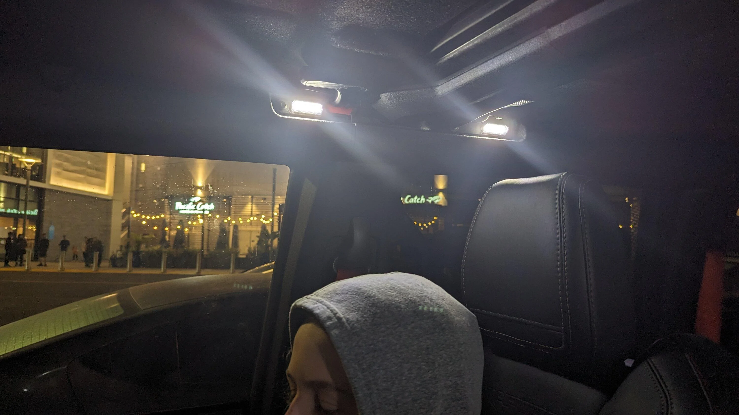

Added Mabett interior light kit. These should have been factory...
Tips:
  1. Prying out rear light takes some oomph. Clips are on left and right. If a metal clip flies off inside the roll bar you can get it out with a magnet.
  2. Lights are L&R.
  3. Route cables above alignment/install posts on plastic trim and above screws to keep them out of the way of airbags
  4. There are some little corner spots on plastic trim ideal to give just a bit more room for wires to pass outside of trim right before fixtures. If you don't use these the wires seem to get pinched to hard between roll bar and trim when screws are tight.

Nice! Did you splice into a wire or pull power from the fuse box? I want to run the iag version of this kit, but refuse to use a t-tap. I’d rather find the dome light fuse in the fuse box.
swamp2
swamp2
Dec 19, 2022
156
4,130
4,262
^ The Mabett kit is plug n play, connecting to the rear lamp.
