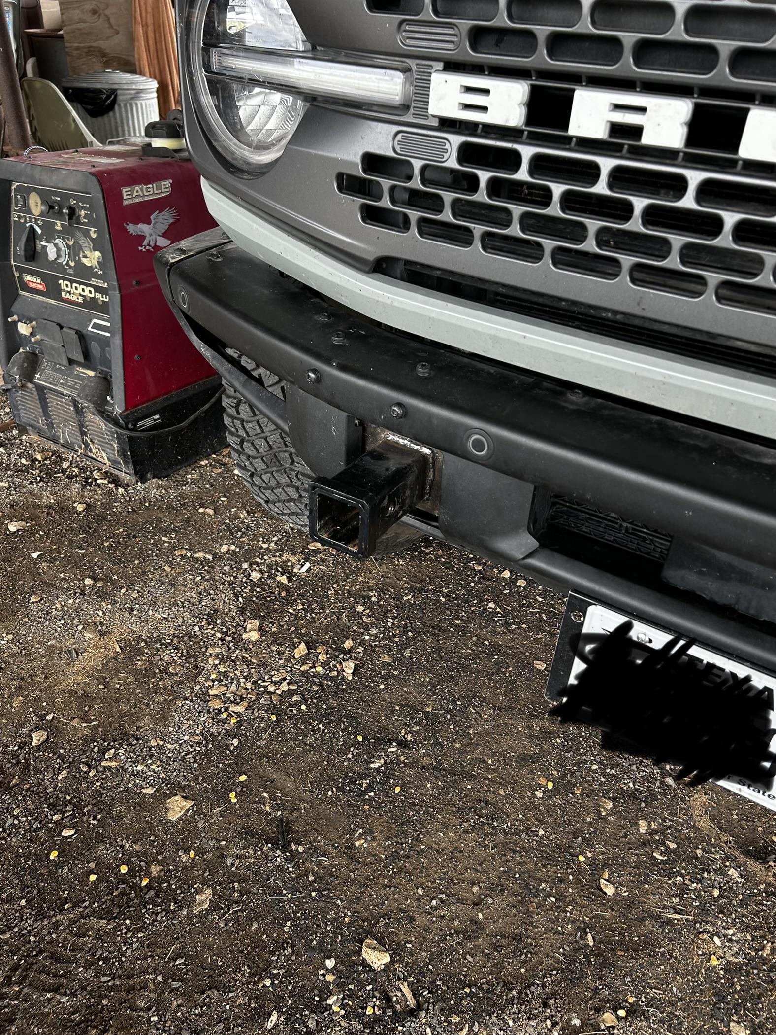

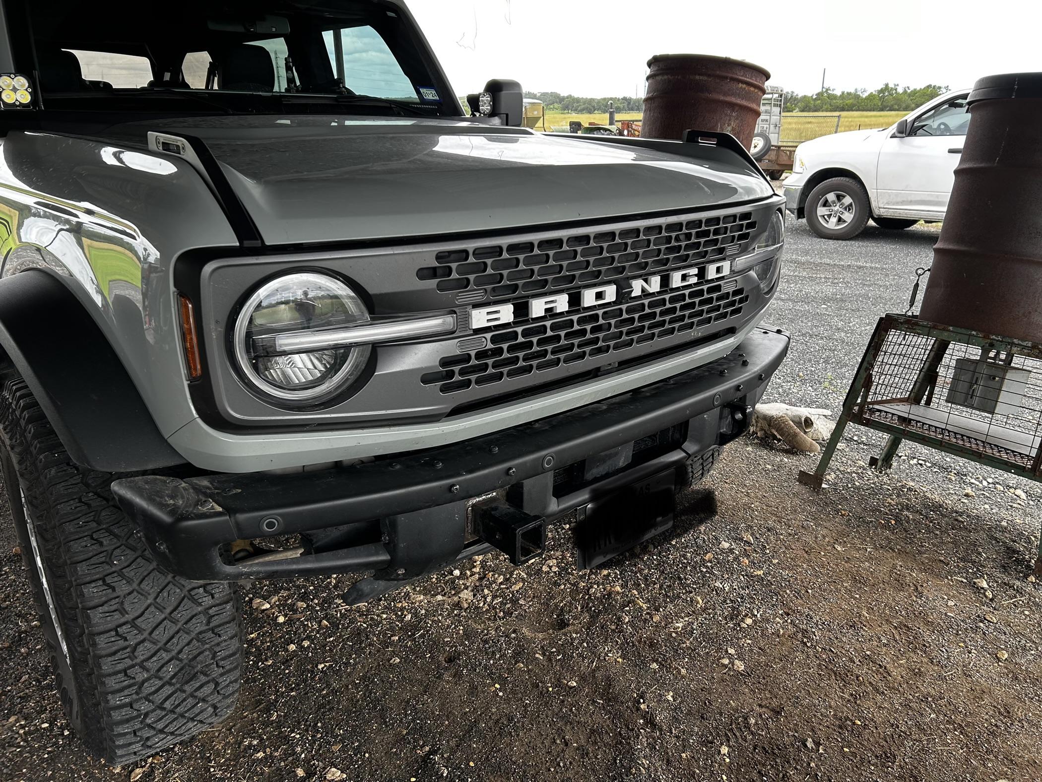

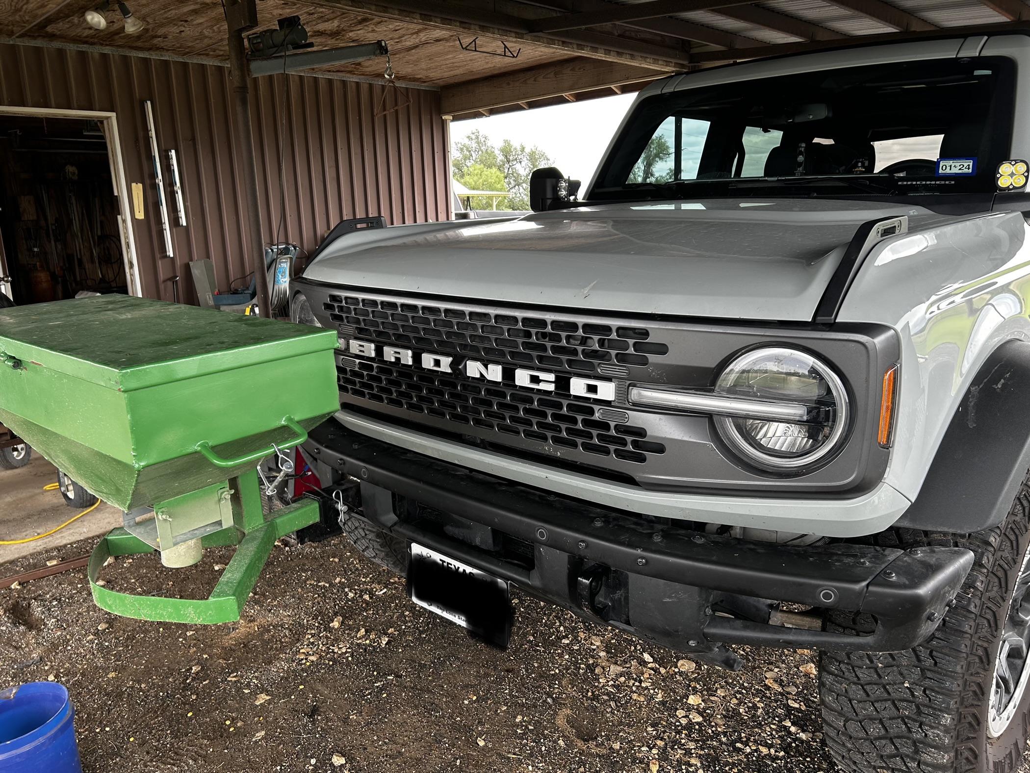

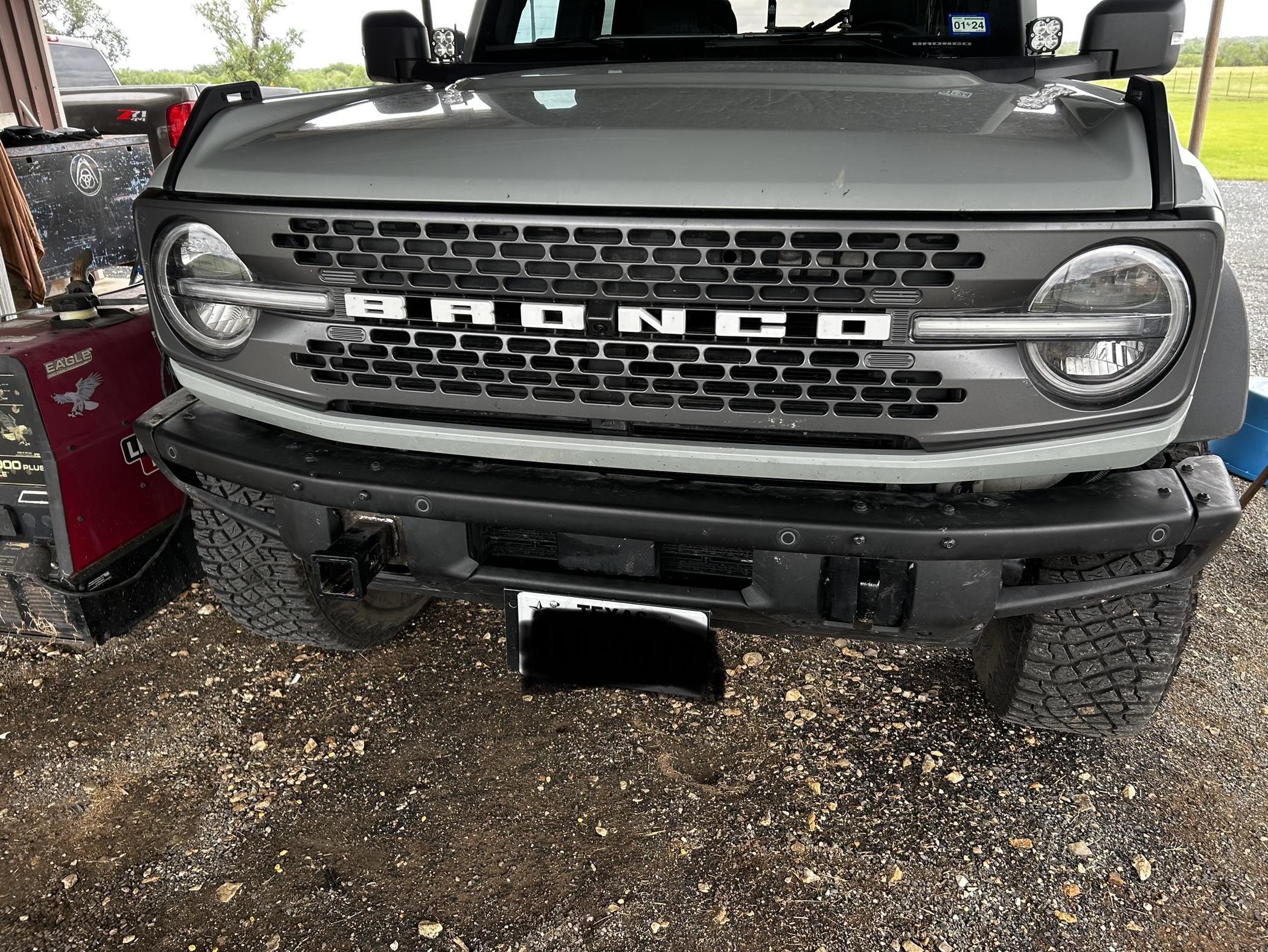

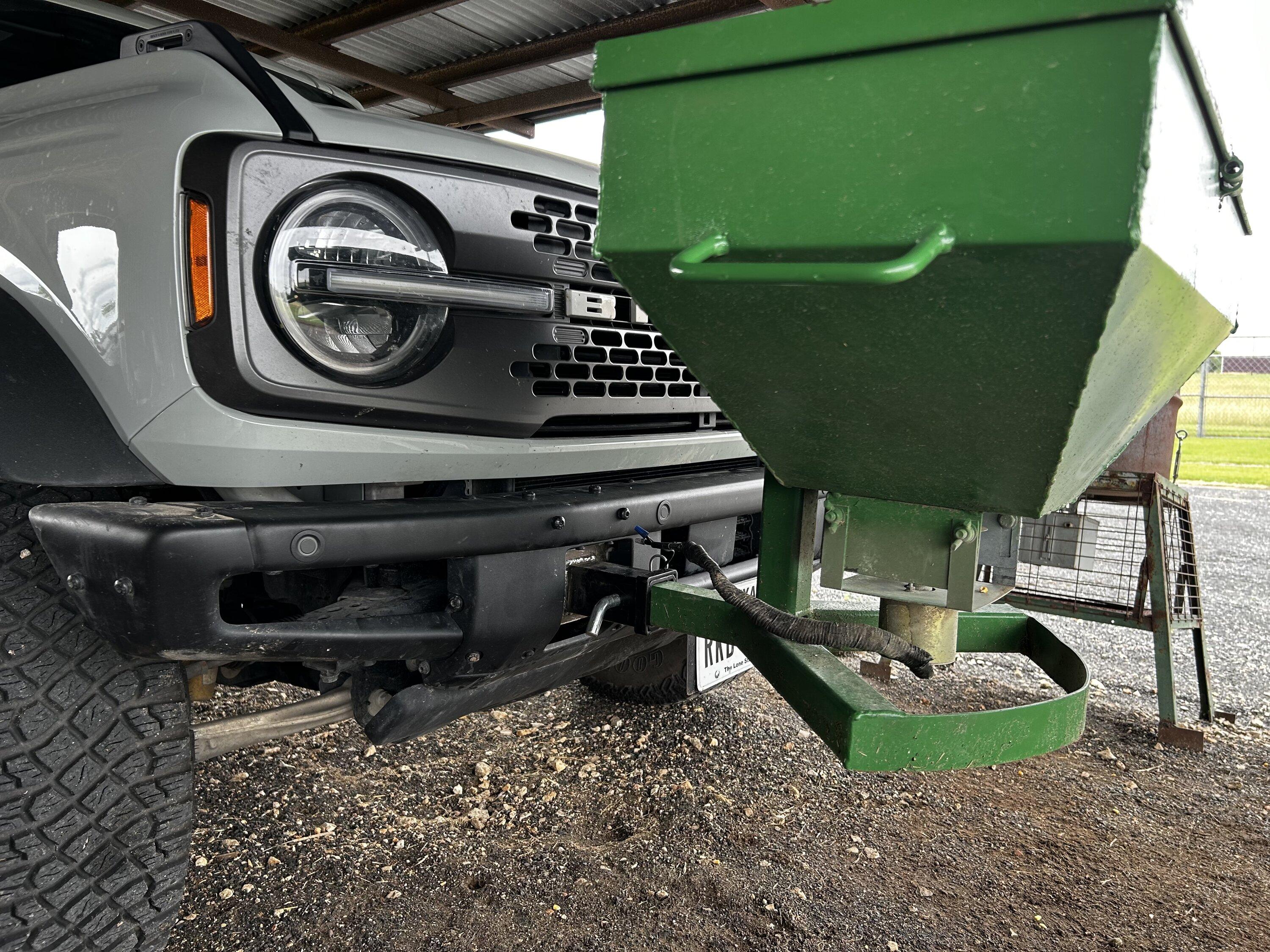

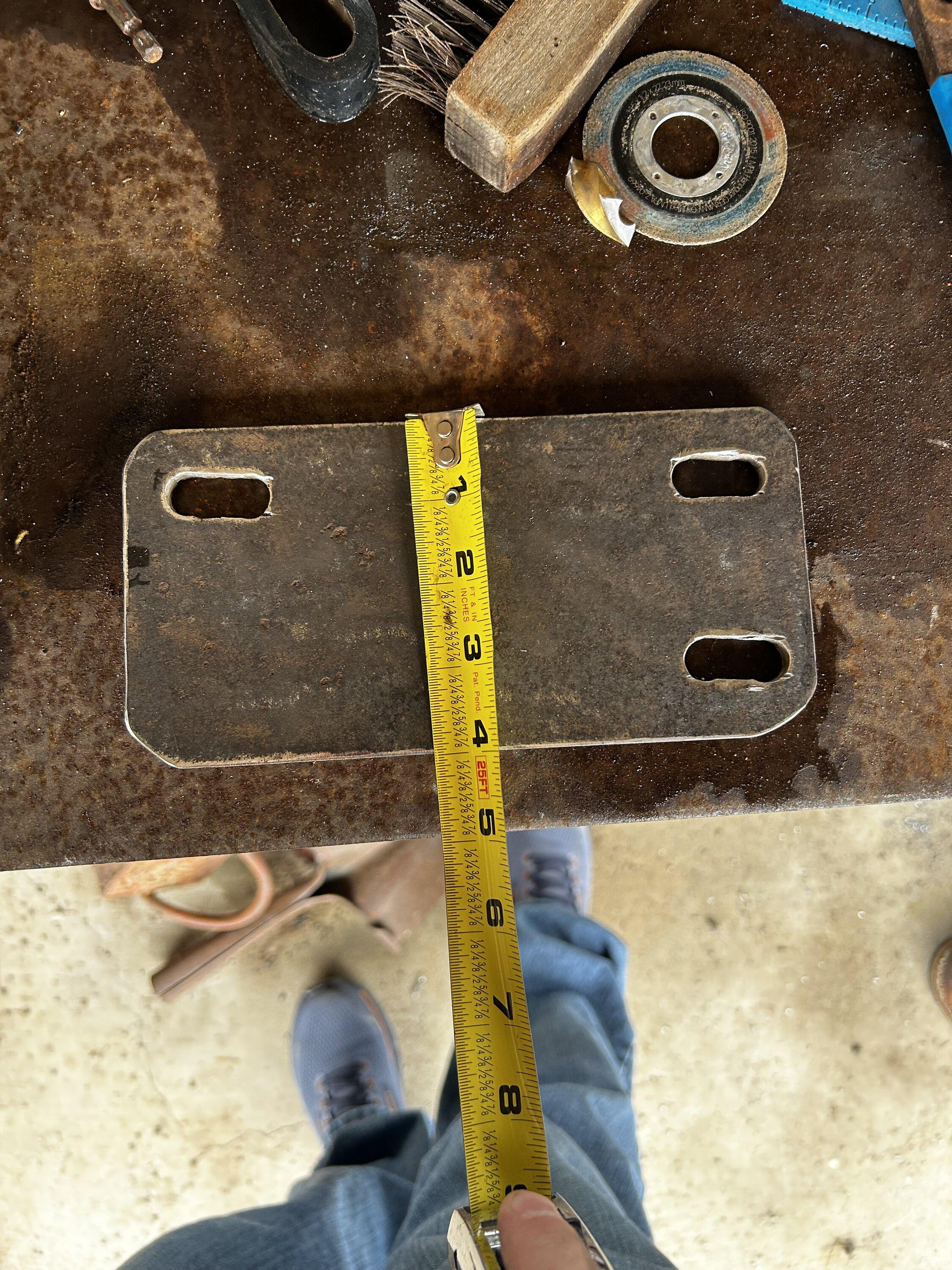

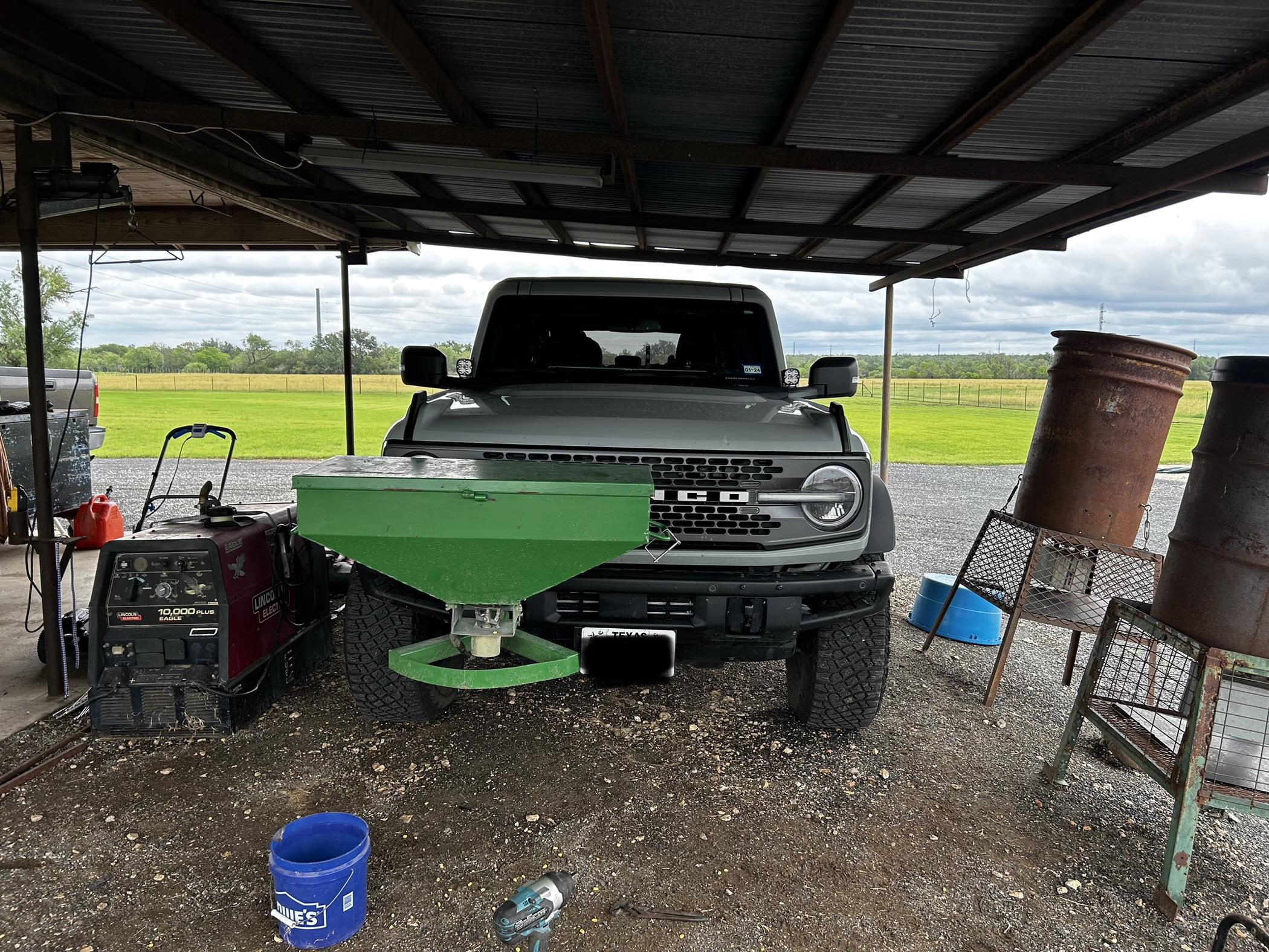

Decided to make a custom front tow hitch for carrying a deer feeder at the lease. Hope you like.

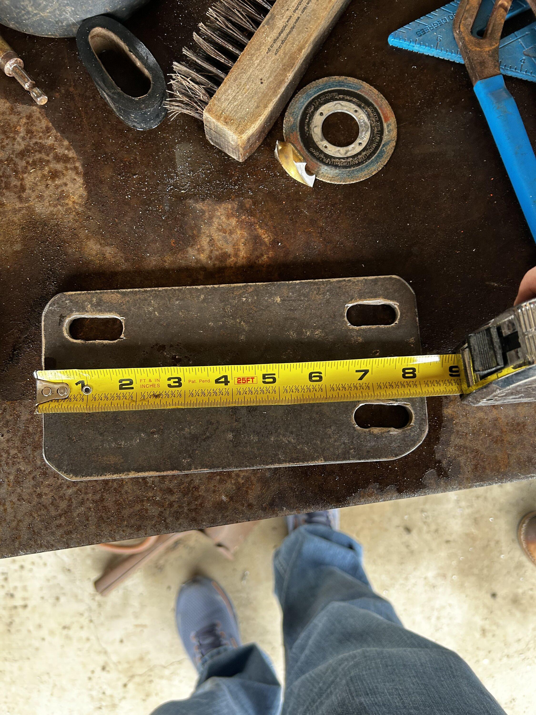

Do you wanna share some details on how you built and attached it?? I'm very interested in one of these but haven't seen anything out there!! I love my 2 door but I need another place for heavy loads.
4”x8” plate metal with holes cut out to match the tow hook. Then I welded a receiver hitch to it. Replaced the tow hook with the new receiver hitch. Had to use 3 washers at each bolt as shims since the plate is thinner than the old tow hitch.
min not sure what it’s load capacity is. So be careful with that. Let me know if you have any questions.

Nice set up. Do you use the hitch to move the feeder or use it to spread corn to multiple spots?
I really like the front tag bracket.
It is a hitch feeder to spread corn to multiple locations. I got the tag bracket from a Bronco6G member who was making them.
