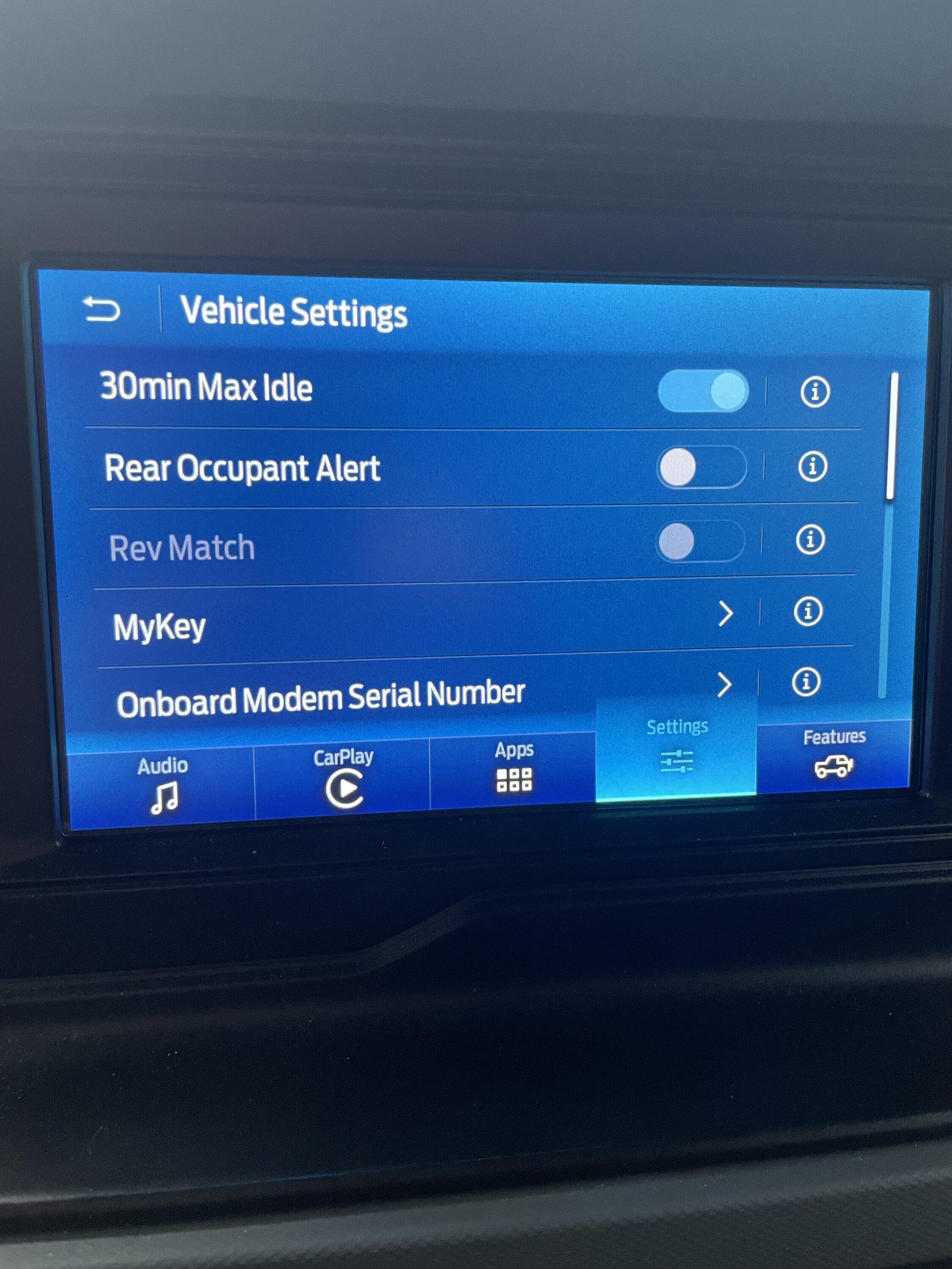

So, it looks like changing those settings in Forscan added the toggle to Vehicle Setting, but it’s locked.
Which settings did you change? There might be another module that needs to be enabled for it to unlock or a direct AS-BUILT change that doesn't show up in the English translated menus
