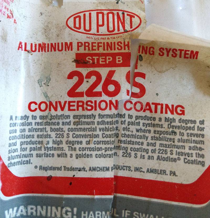

Years ago I bought a chemical product that put a kind of golden sheen on aluminum parts for corrosion protection. It came in two bottles, one to prep the aluminum, the other to put the coating on it.
I got the product from some automotive chemical shop, I'm not sure if it was necessarily a consumer grade product, there were a bunch of warnings on the labels, and you had to be careful with the chemicals. It was a while ago, I'll try to remember the name of the product. I used it to coat some aluminum parts on my old Land Rover.
Was it from Caswell's? https://caswellplating.com/
I've used a few of their kits for anodizing and nickel plating at home.
Passivation will get you a yellowish-gold color on 6061-T6 aluminum
This is referred to as a chemical chromate conversion. Alodine and Iridite were standard products. These are very hard to find these days as they are not allowed in most product sold today because of the hexavalent chromium used. They have be replaced by ones using trivalent chromium but not nearly as prevalent. This provides a protective coating but is still conductive so used in many electronics enclosures. Anodizing is not conductive so it’s use is limited were grounding is required unless masking is done prior.
