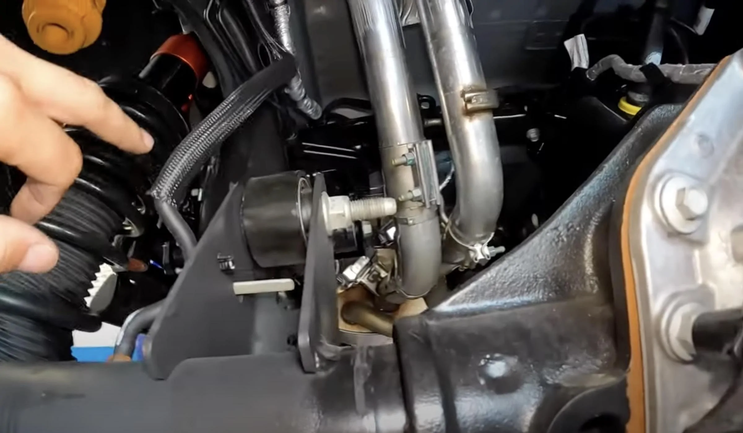

Although my google-fu resulted in nothing, it appears the Braptor has the same transmission and axle venting that the Everglades has to fortify/enable a good water fording spec. Evidence (at least explicitly for the rear axle is at the 6 minute mark in this video here ). I assume the other axle and trans follow suit.
The Everglades is speced to ford up to 36.4" whereas the Raptor is 37". I would have expected a larger difference, based on both tire size and body height. Maybe the breathers mount slightly differently.
Regardless, glad the Braptor didn't get cheaped out here.
As to one-upmanship by Jeep the 2023 Jeep Wrangler Rubicon 392 20th Anniversary Level II by AEV (mouthful... and the only "factory" way to get 37s) provides a whopping 37.1" of water fording capability :ROFLMAO:.
Despite all of the numbers, specing fractions of an inch for water fording is a bit silly/meaningless, by Ford and Jeep.

Thanks for the info.
If the Braptor has 37” of fording capability then is it fair to say that it’s safe to ford water that goes as deep as the (factory) tires? Am I thinking about that correctly? Granted the BFGs are technically like 36.5”

Yup, that's a good way to know/test the limit - up to the top of tires. That's very far up the doors...
