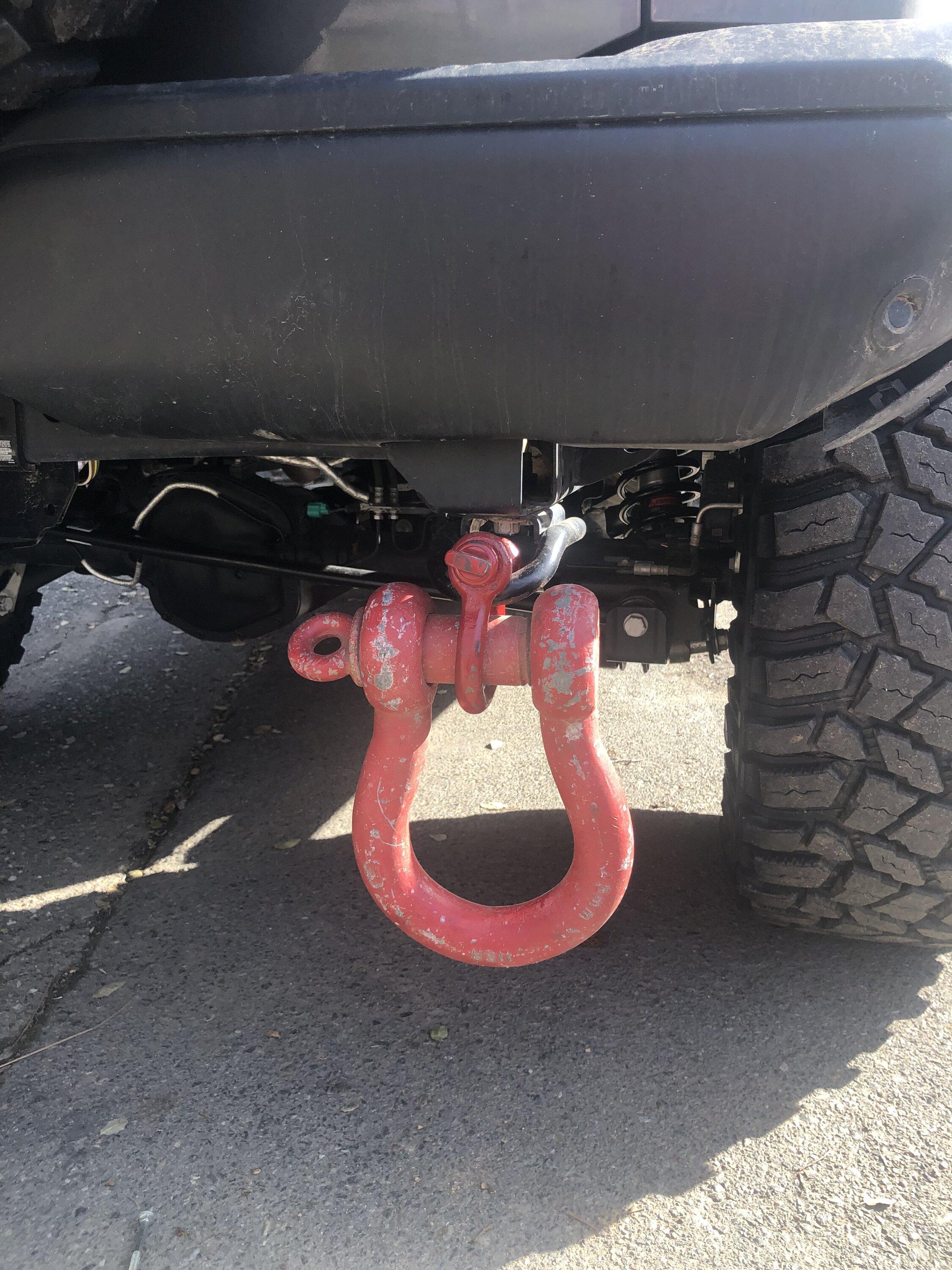

With respect to the Bronco recovery points, how does this all factor in? On my Badlands with modular bumper, I understand the front recovery points are rated by Ford at the Gross Vehicle Weight, which is 6,100 pounds, give or take. I can only assume that's very conservative but that's what we have to work with. How do you factor that in? Same question goes for the rear recovery points (factory hoops), although I'm not sure what they're rated for.
Here's my current inventory. What would you consider changing out? Maybe a lower rating on the soft shackle, and similar rating on the kinetic rope?

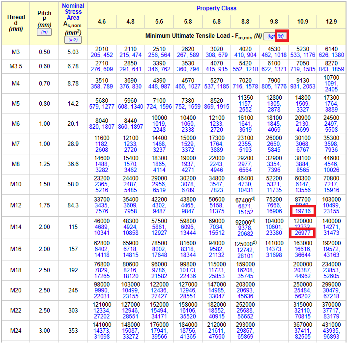

We don't really know what the factory recovery points are rated, assumption is they are made with quality steel. So I would put them in the 40-50,000lb category. The first time someone manages to remove it will be interesting to dig into.
However,
Rear mounting Points are mounted by 2 10.9 M14 bolts if I remember correctly will need to check size but I know they are 10.9. So 26977lb per bolt in tensile load so I am guessing in the 50,000lb area or so. Even with 46,000 soft shackles you should be good. This is basic guess-estimation engineering.

I wouldn't run out and change anything you have purchased. I would match the 30,000lb tow strap to a 30,000lb Kinetic rope. That way if you need more rope/strap for a recovery you aren't creating a failure point at one end.
Big thing with metal shackles of that size is not connecting them to anything of lesser strength or using them anyplace but connected to steel.
Really the big thing about this post is to think about what your buying and basic recovery like mounting points.
