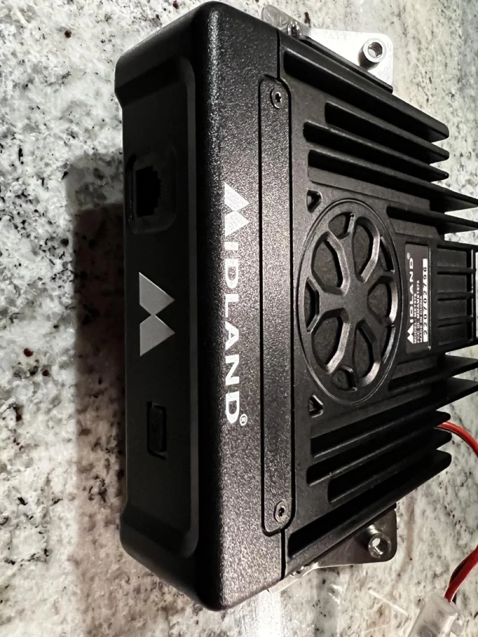

Anyway, I settled on the new Midland MXT575. I picked the version with the controls on the mic. That allows me to hide the transceiver elsewhere. For that, Mountains2Metal (M2M) makes a very cool and inexpensive mount that puts the transceiver or small amp, right above the glove box. Just have to love how Ford created all this space, nooks, and crannies for mounting stuff. And kudos to M2M for finding the space and making the mount! For me, it saved the under-the-seat, in the console, under-the-console, remove everything, debate. If you don't have plan for that empty cavity, use it. It couldn't be easier.

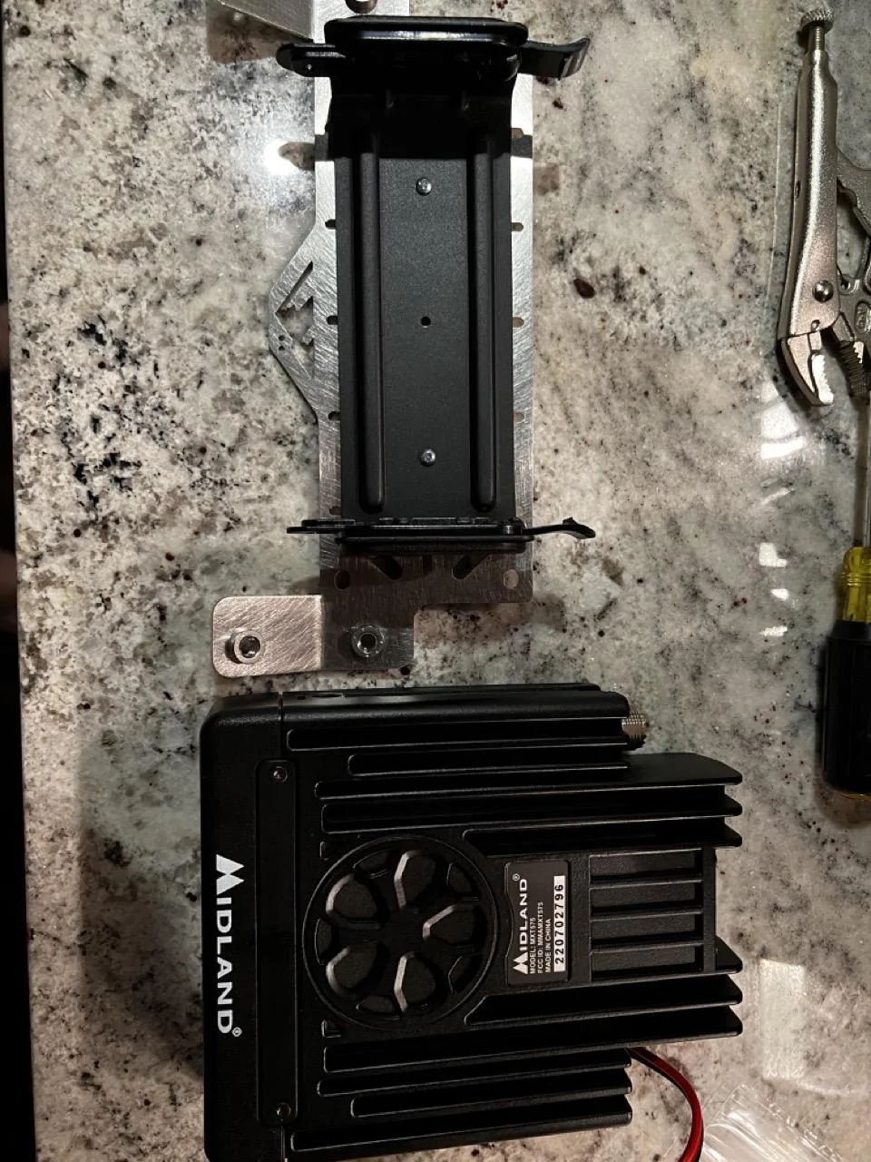

Step one, attach the radio mount to the M2M mount using supplied hardware. Tip, the 575 is the largest of Midland MicroMobiles (there's a little mod that needs made and we'll get to that). So, mount the radio with the 'M' or Midland as close to the front of the M2M mount as possible. Tip, get the Midland mic extension cable MXTA31 (you'll thank me later) and connect it once the radio is attached to the mount and before you install it in the horse:
Ford Bronco Midland MXT575 GMRS 2-Way Radio Install & Photos *SWR Report* IMG_3469 Larg
Ford Bronco Midland MXT575 GMRS 2-Way Radio Install & Photos *SWR Report* IMG_3471 Larg

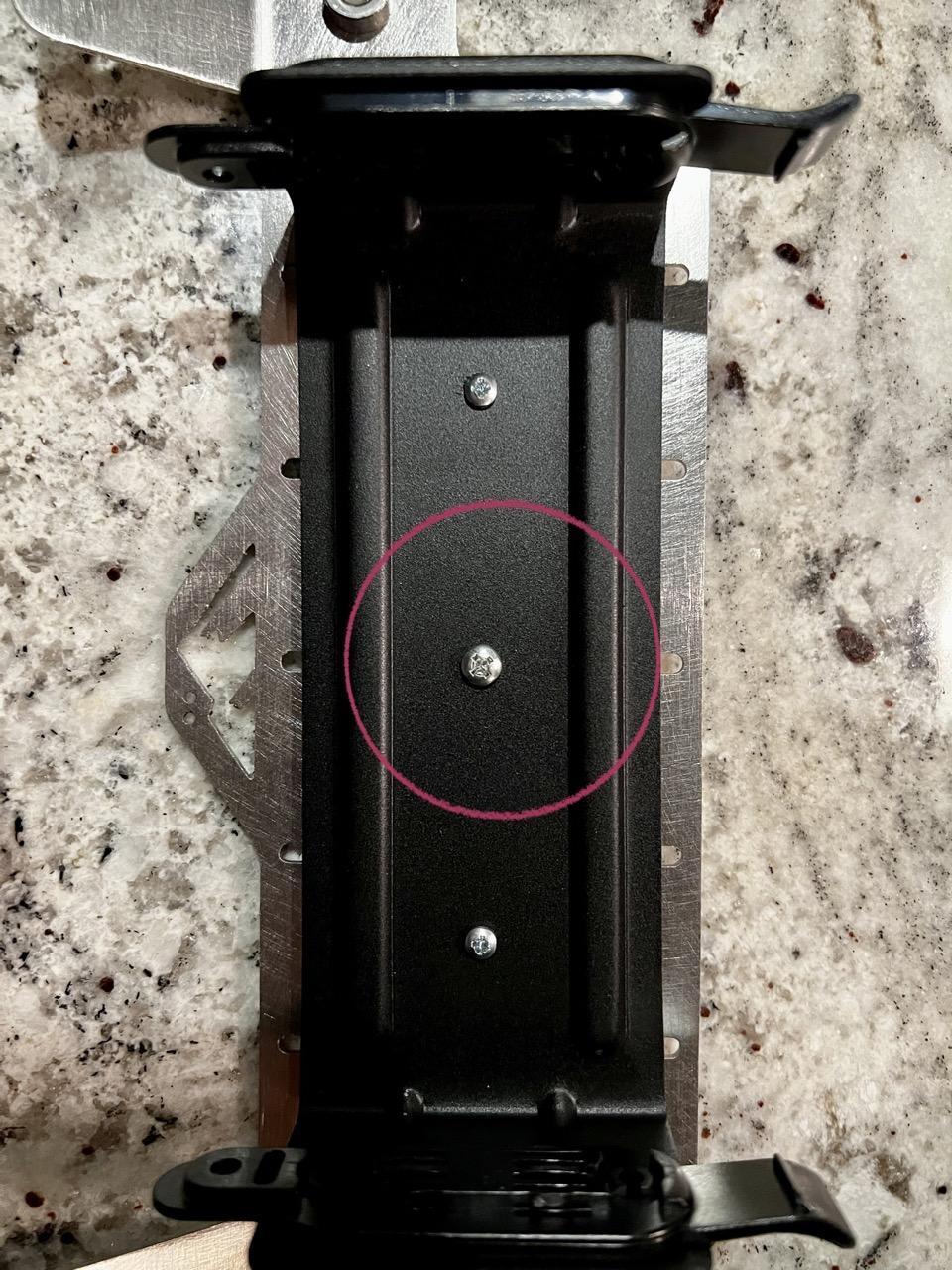

I took the extra step of driving a self-tapping screw into the mount for extra stability. The other two connectors are bolts and lock washers.

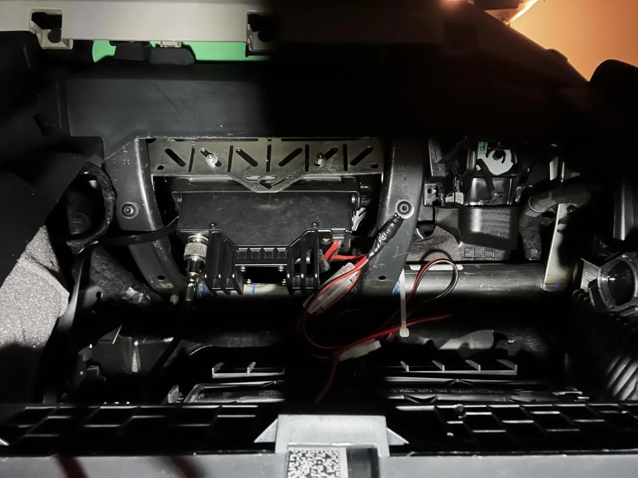

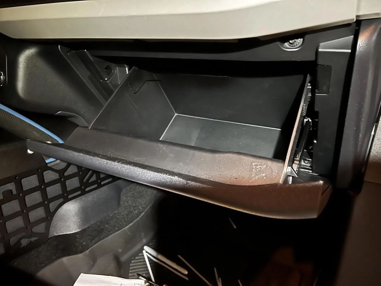

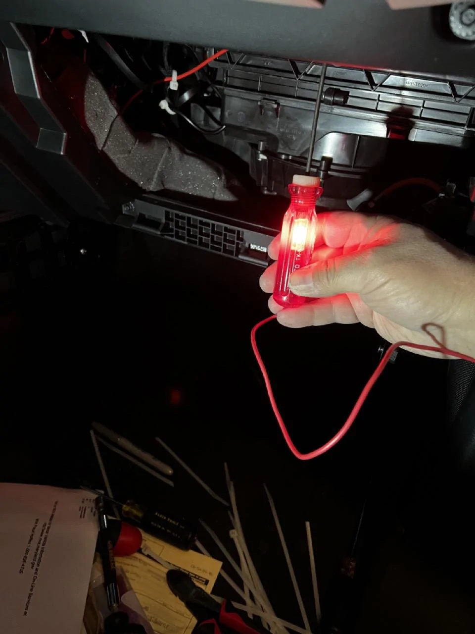

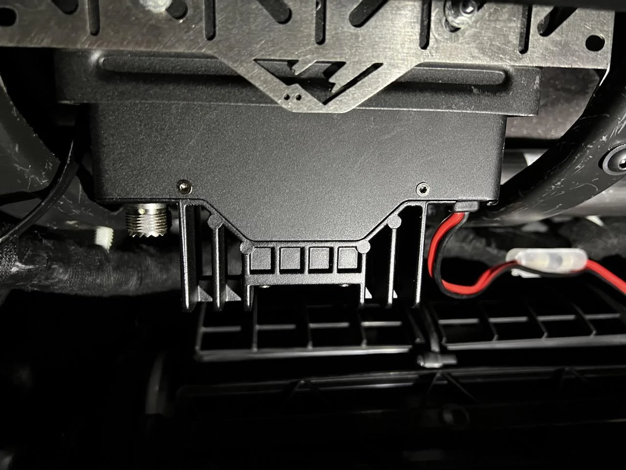

Now the fun part. Remove your glove box and look for the two 'rails' and open space directly above. Make sure that mic extension cable is plugged in now! And forget about using that USB-C port. None of it will be accessible post-install. You figure out how to lay on your back, twisted half sideways with the door sill digging into your ribs.
Lift the rig into that free space:
Ford Bronco Midland MXT575 GMRS 2-Way Radio Install & Photos *SWR Report* IMG_3500 Larg
It will look like this when set correctly, attach it with the two black torx screws that come with the M2M mount. I used one of the two screws as a ground point. Verified the ground and it looks like this (from the floor up, directly under the glove box. The coax and power wires are facing the firewall):

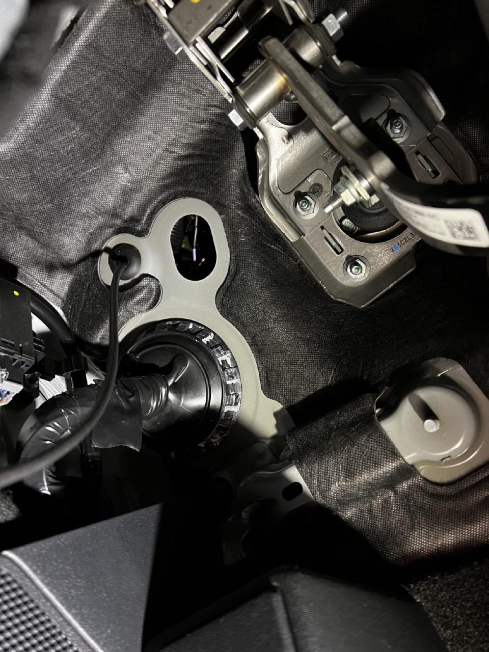

Notice from this angle, you don't even see the radio. I ran my hot wire and coax to the drivers side firewall. There is a very nice hole there with a removable cover (unless you have an manual trans because that's where the clutch cable runs).
Ford Bronco Midland MXT575 GMRS 2-Way Radio Install & Photos *SWR Report* IMG_3512 Lar
Ford Bronco Midland MXT575 GMRS 2-Way Radio Install & Photos *SWR Report* IMG_3513 Larg
You can also use one of the Aux wires just behind the passenger kick panel for power. But the pull to the battery is so easy, I didn't want to waste a switch position. The hot is fused and the fuse is accessible near the steering column and the radio has a time out feature. But, if you're not transmitting, battery drain is minimal, but a risk nonetheless.

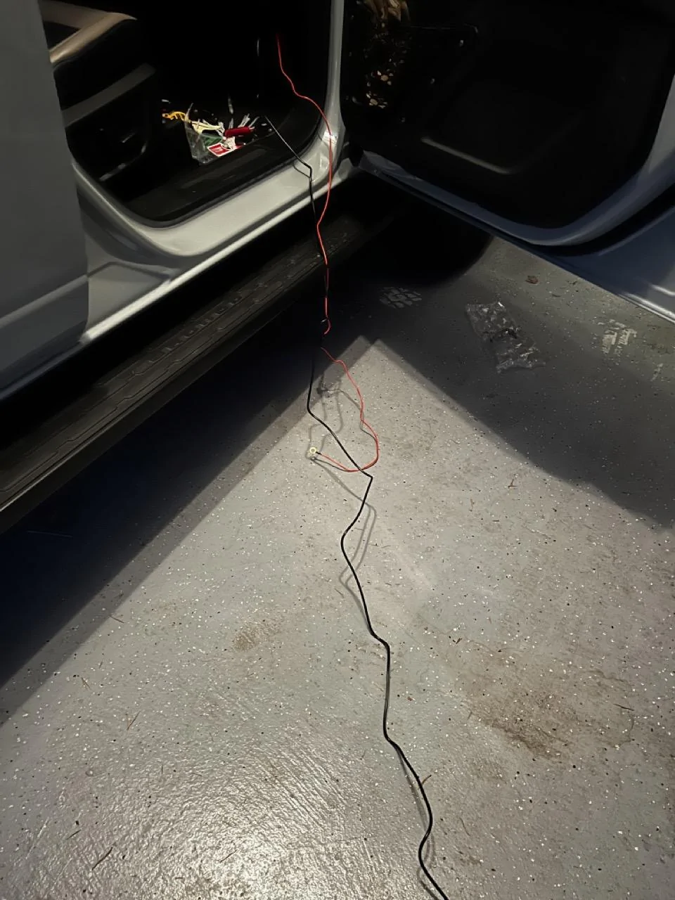

Tip: Fully unwind/stretch out your coax and hot wire before pulling to the engine bay. Just makes life easier.

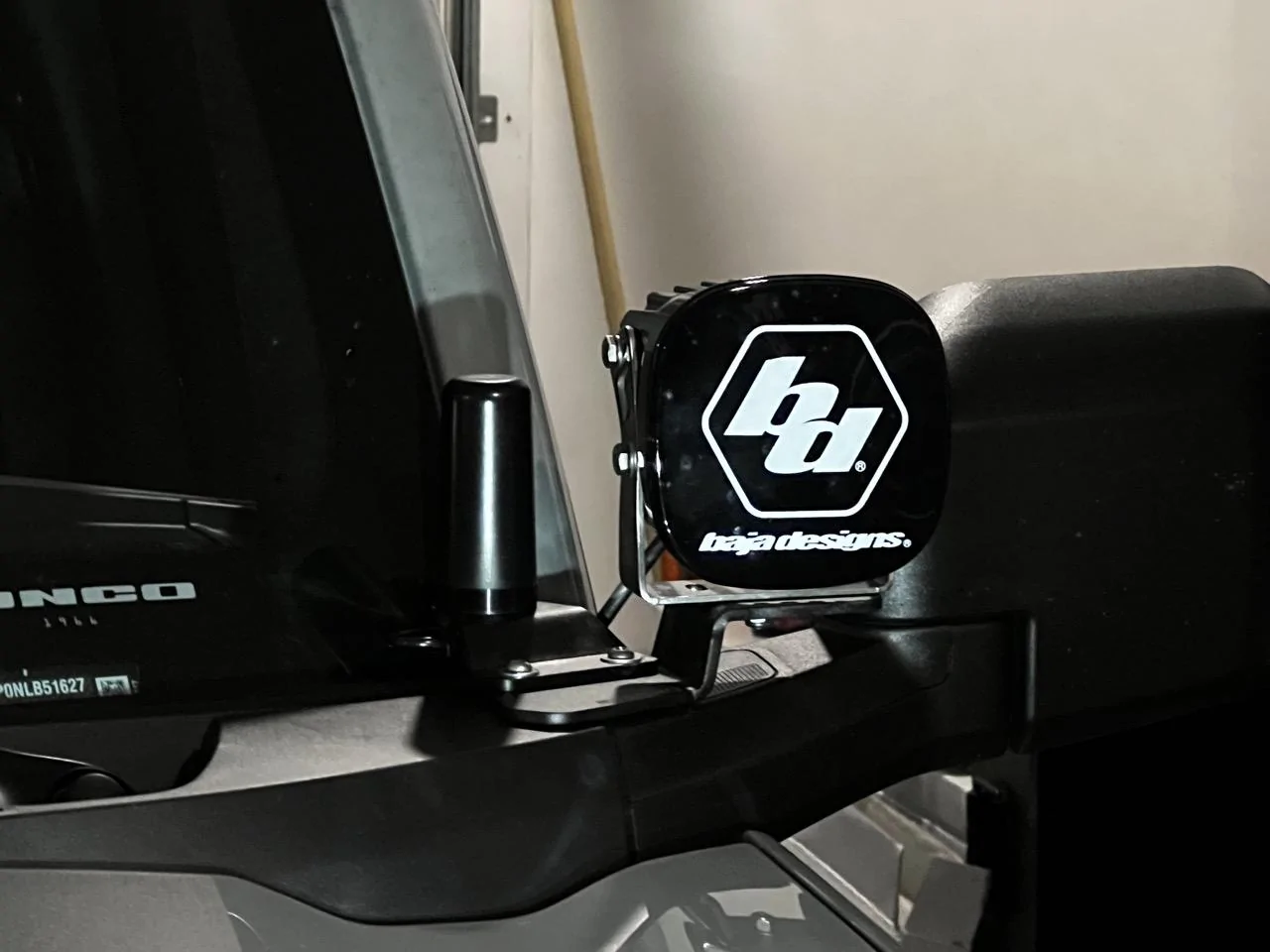

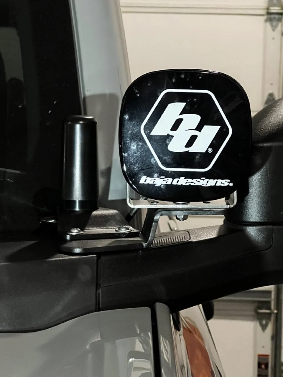

Hot to battery and coax to either side a-pillar (or wherever else you want to run the antenna). Mounting any antenna is slim pickens on a vehicle with no metal roof. Metal roof = ground plane. There are a lot of antenna mounting options. Hinge mounts, bumper mounts, spare tire rigs, etc. I like to keep things clean and simple. I used the M2M NMO mount which I installed over top my SDHQ a-pillar light mounts. Very simple and straight forward. I also chose to use the Midland MXTA25 Ghost Antenna with an NMO mount. Claims -3db gain and looks amazing on the bronco. Blends right in.

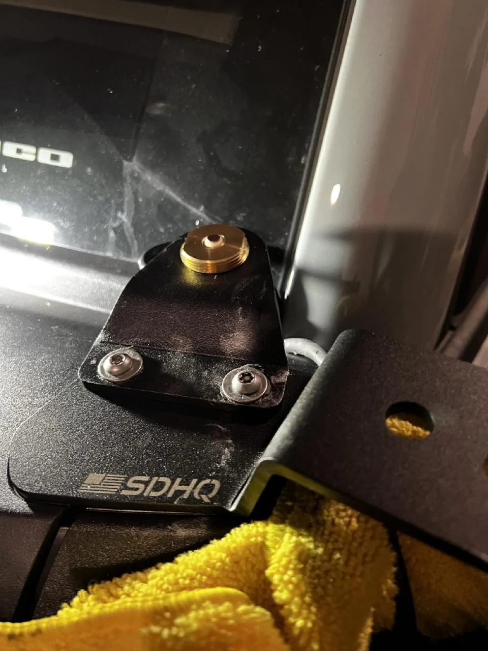

Slight digression. I've now bought 3 different a-pillar light mounts. The SDHQ are by far and away the best of the three. All three were good (Baja Designs and ZROADZ) but the build, finish, and 'lift' for the SDHQ are fantastic. It also move the lights out and away from the edge of the hood and gives ample room for the largest of cube lights. I'm running two XL80s which are some of the largest and they sit perfectly on the SDHQs. The SDHQs also align perfectly with M2M NMO mount.
A word on SWRs relative to GMRS. I haven't tested SWR yet. There's no trimming of the Ghost Antenna but I will and post the results. I suspect this Midland set up will yield decent SWR. If so, I'm done. If the readings are unacceptable, I'll switch to a 1/4 wave antenna, trim and test. I doubt that will be the case and if the results warrant it, I'll do a new thread. Generally, standard transceivers, unmodified coax, and appropriate antenna combos should be ok, but certainly not always. I just didn't want to turn this in to a thread on antenna theory. I'll test later this week and add if there's anything worth reporting.

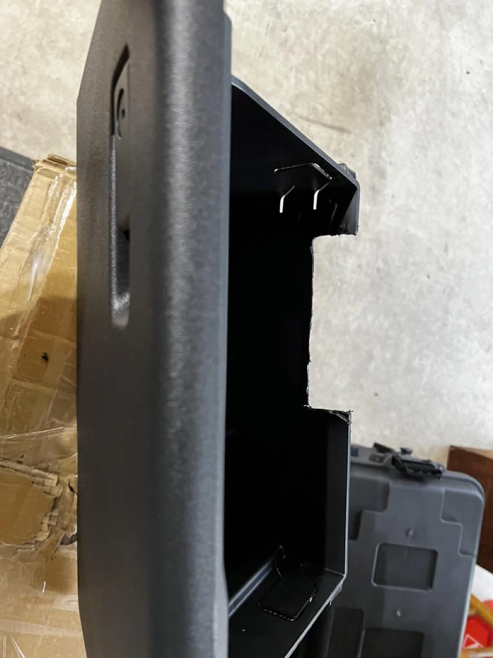

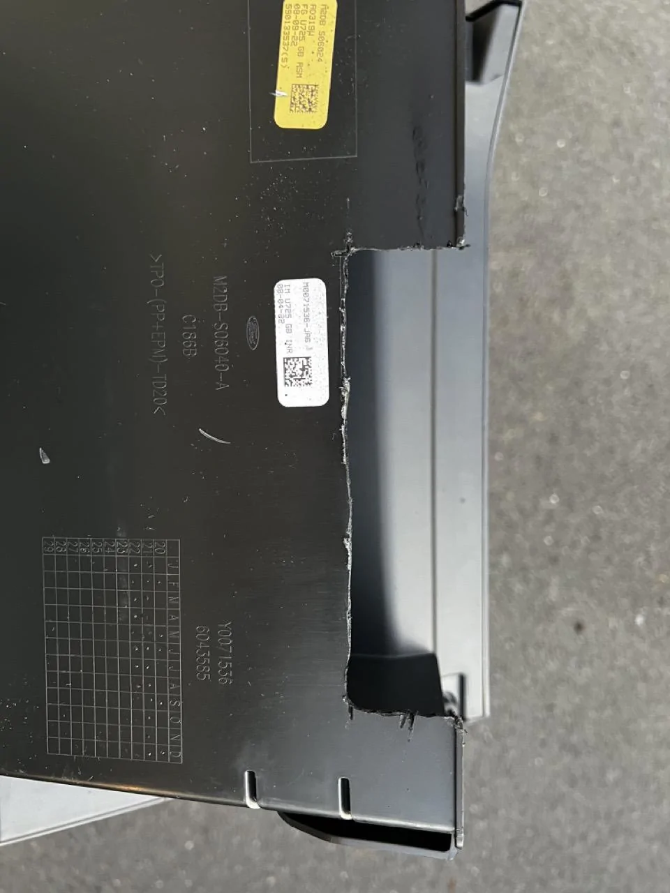

So here's the catch. This is the mod you aren't going to like. But I swear, as a guy who like clean, neat, OEM-like installs, this one is a trim and forget kind of things. You have to notch the back of your glove box if you chose the MXT575 using the M2M mount. The heat sinks are bigger (50W) than their other rigs. No way around it. But, for the clean, neat, permanent kind of placement, I'd do it again and again. I highly recommend this mounting approach and once you make the trim, you don't see it and will forget it's there! I used a Dremel and cutting wheel. Marked a space and cut away.
Here's what the un-sanded notch looks like:
Ford Bronco Midland MXT575 GMRS 2-Way Radio Install & Photos *SWR Report* IMG_3497 Larg
Ford Bronco Midland MXT575 GMRS 2-Way Radio Install & Photos *SWR Report* IMG_3499 Larg
I cleaned it up and reinstalled it. Like I said, you can't even see it.

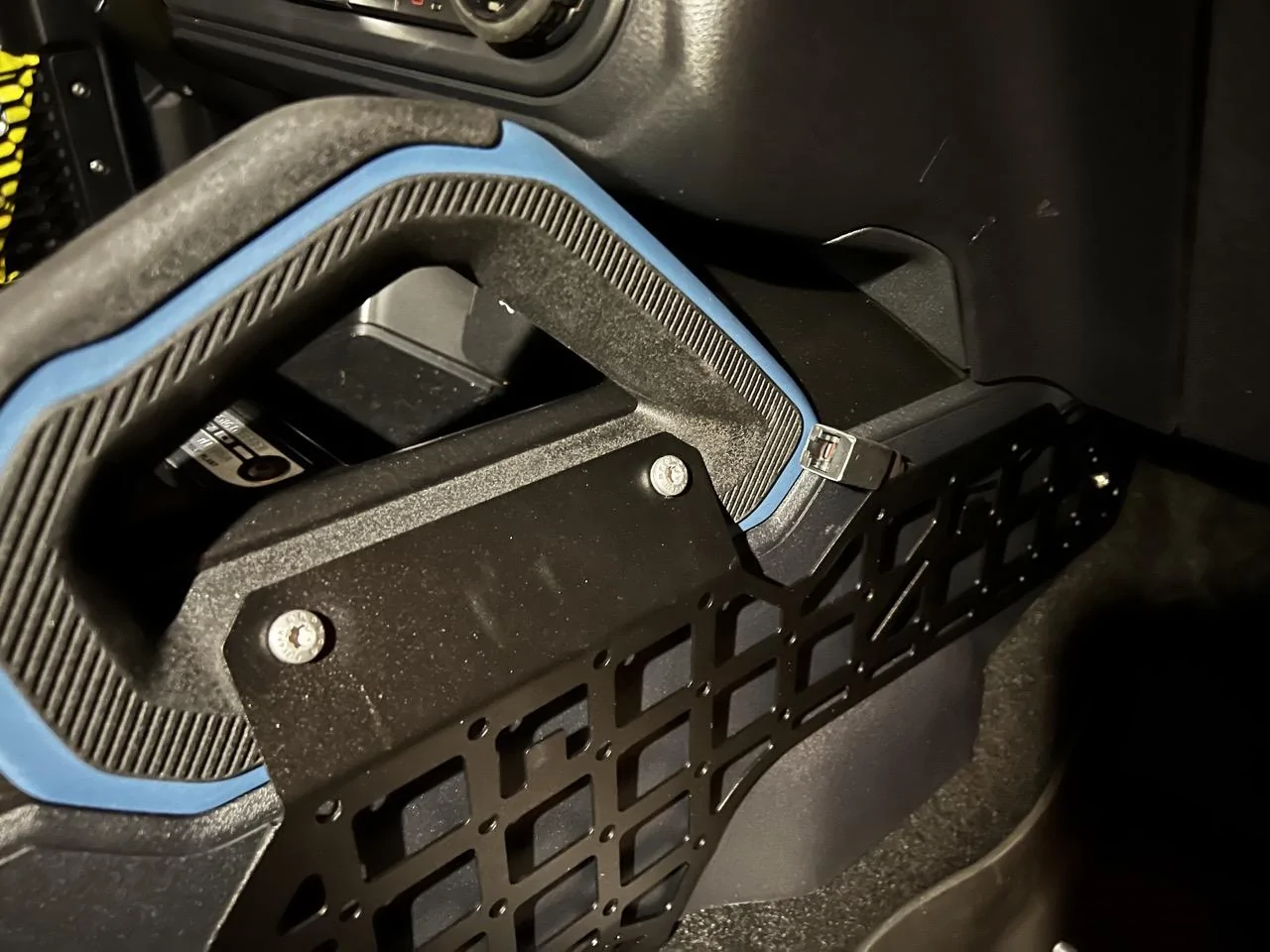

I also installed the Mountains2Metal MOLLE panel. Very nice product! Great for adding a small MOLLE bag to make up for the lack of driver accessible storage. Here is the mic extension tied in.

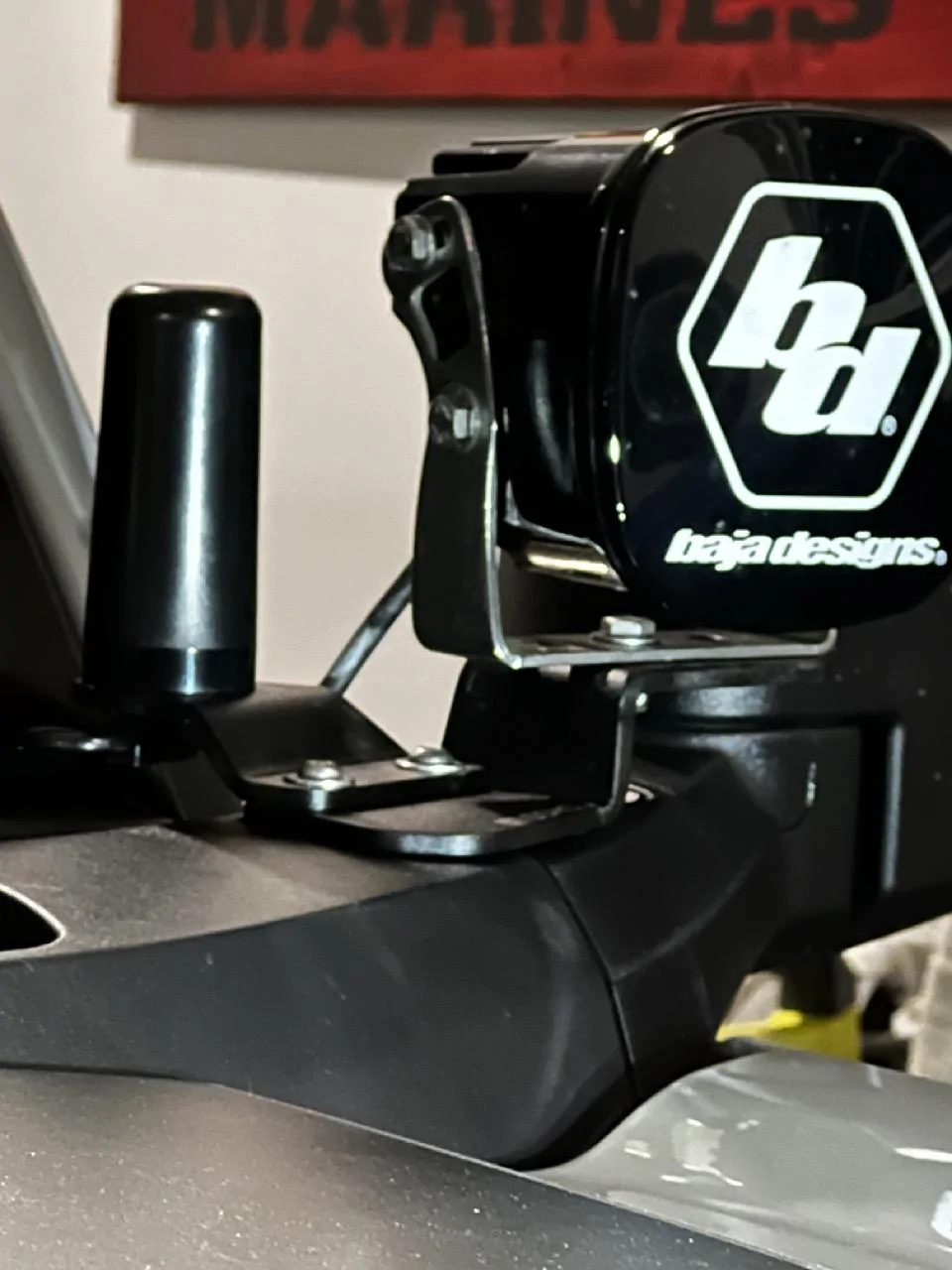

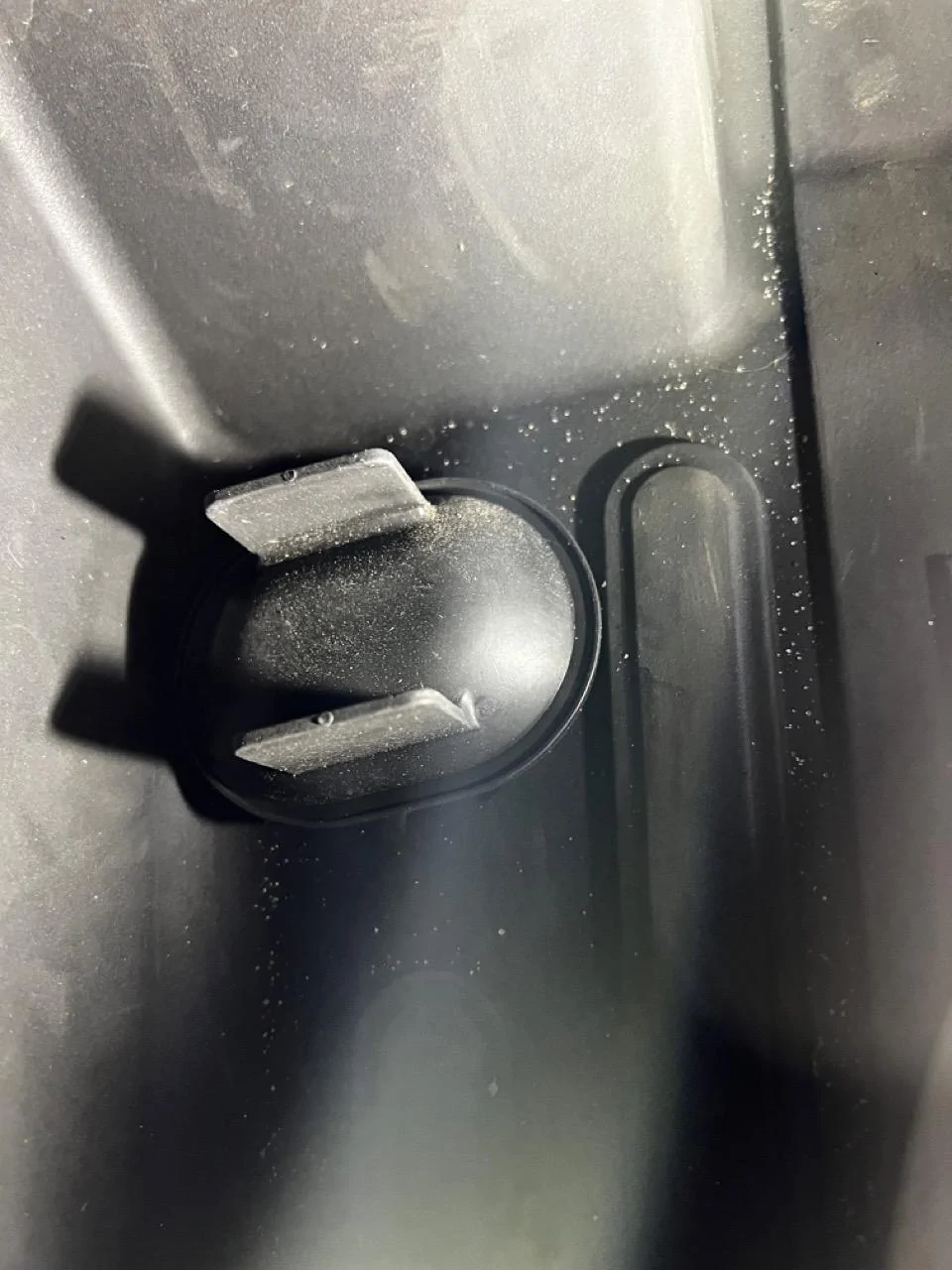

panel mounted the jack extension and panel mounted the usb c extension
mounted a 32” antenna ona drop down bracket on drivers mirror

Really nice install. How does that antenna perform? I’ve read some so-so comments elsewhere.
Could the USB-C be used to power a walkie-talkie charger? I’m thinking of dropping a couple into the glove box for others.

Thanks! So far so good. On 50W, I'm hitting non-repeater units at 2+ miles. Need to see how the SWRs are, that's tomorrow night's project. I'll be comparing the Ghost antenna and the Midland stick that comes with it. I'll post results. If this were a 2m rig, I'd be real particular on SWRs, power and the like. Just my opinion, for most of my (and likely our) applications, it will do better than most.
As for the USB-C, you get 5W so depending on the charger. You could easily drop an extender into the glove box. That's a great idea!

Nice write up and photos! This explains the M2M description that no other videos or posts have addressed until yours:
Works with Midland MXT575 GMRS Two-Way Radio (not included)-Note: Trimming at top of glove box required to fit around any interference.
I opted for the MXT275 for ease of install and not expecting to need a 50W range. If I do, I'll upgrade later.
Thanks, I'm sure you'll love the 275. Let me know if you change it out, I'm betting you don't.
