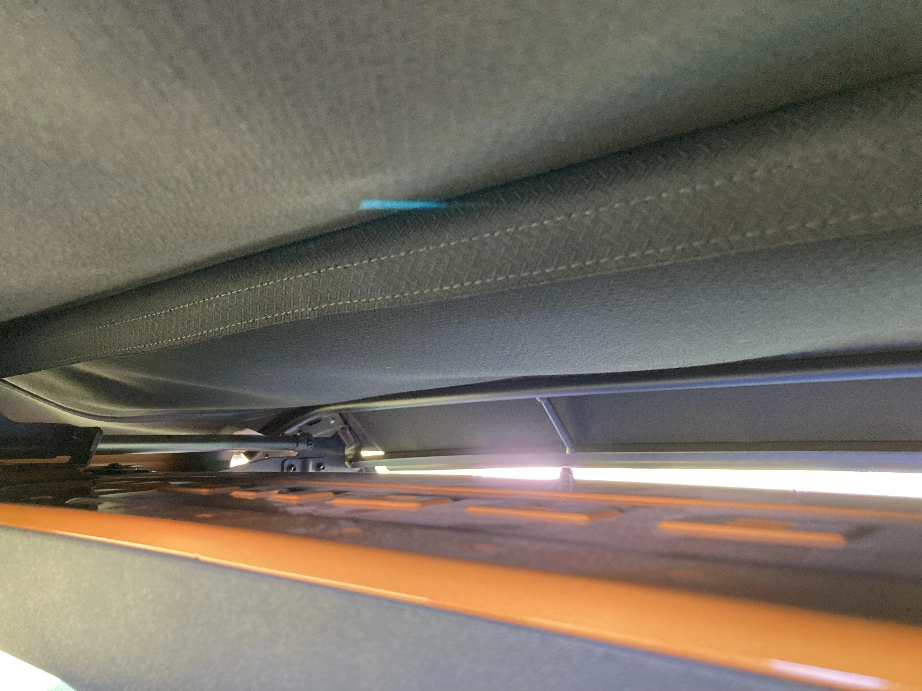

Step 2: Disconnect all velcro connections around bows from the inside and fold back
Open up the velcro straps on each bow and tuck them above. I'm not sure if this is entirely necessary but seems to give the whole assembly more flexibility for removal. Fold back soft top for remaining removal process, giving you access to all the bolts you will need to remove

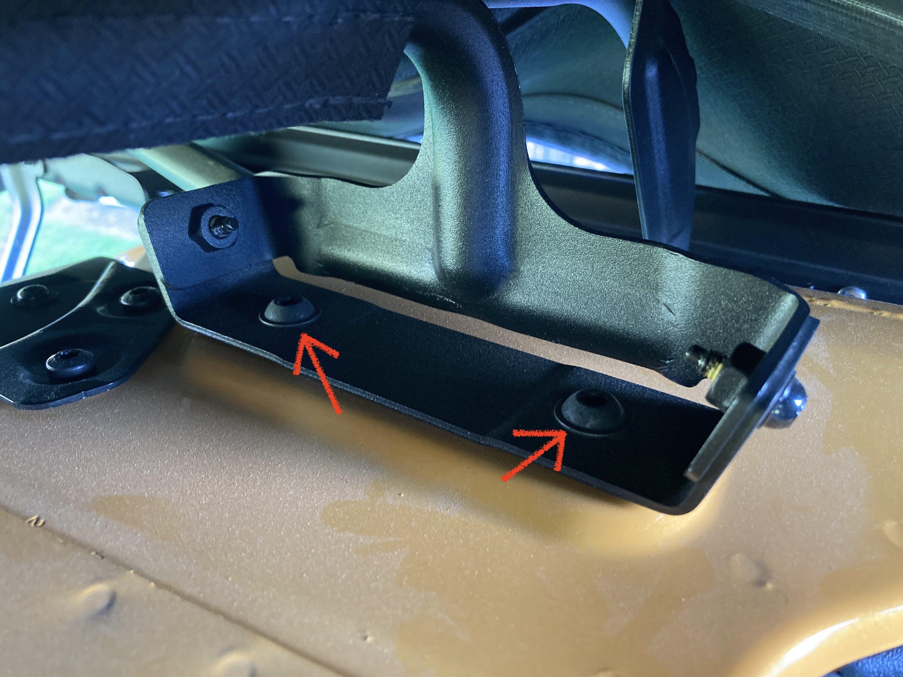

Step 5: Remove rear bracket bolts
Using a T50 socket, remove these bolts and retain these for future reinstallation.

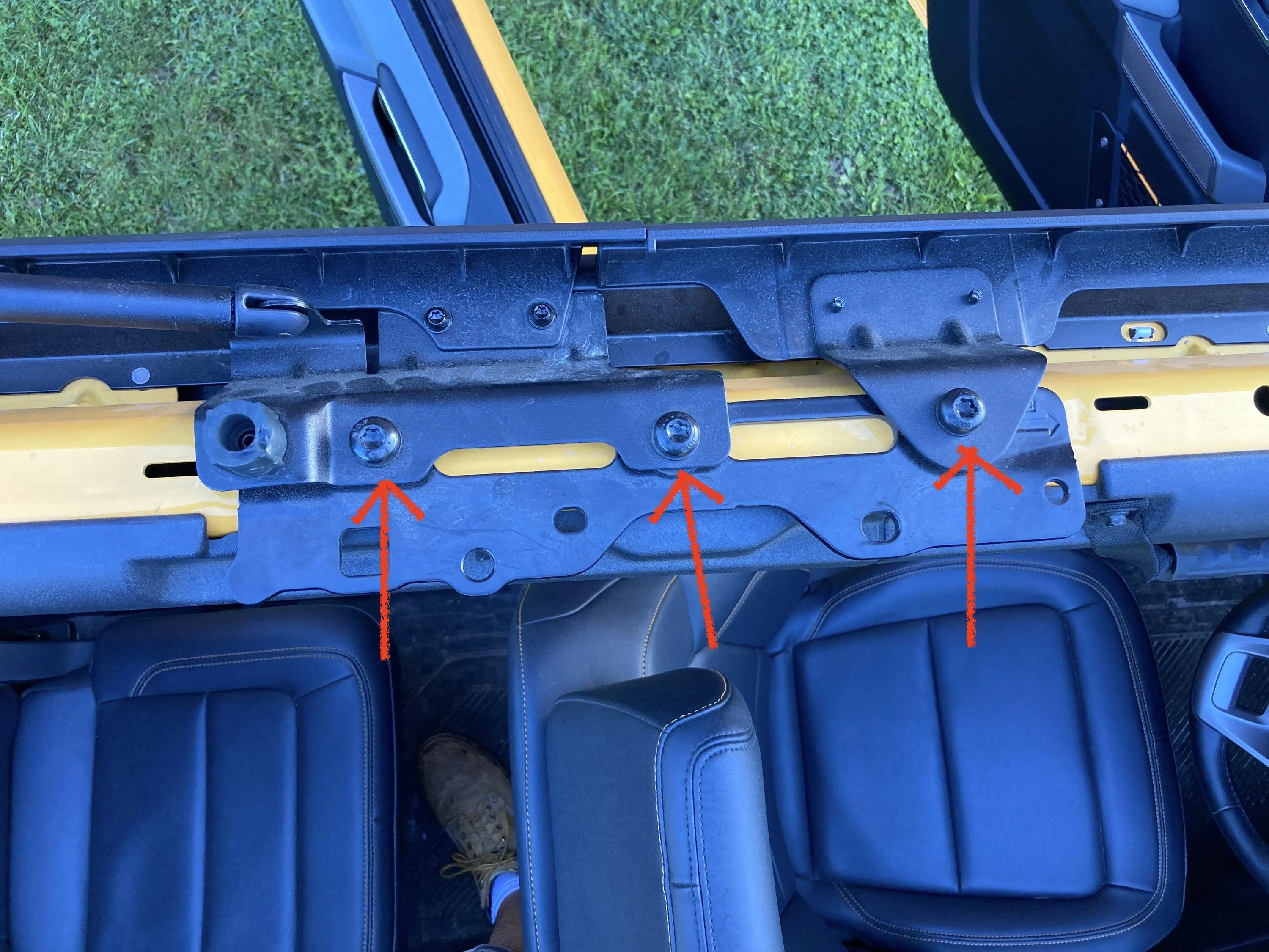

Step 6: Remove remaining bolts along top rail
Using a T50 socket, remove the four remaining OEM bolts holding the middle and front brackets on the vehicle. These will all need to be reinstalled, so retain them and remember that the shortest bolt is used on the hole closest to the front of the vehicle. Make note of the positioning of the lower OEM top rail bracket and make sure it gets reinstalled for proper hard top operation (there's an arrow that shows you which way goes toward the front if you forget). Retain all plastic washers for future reinstallation.

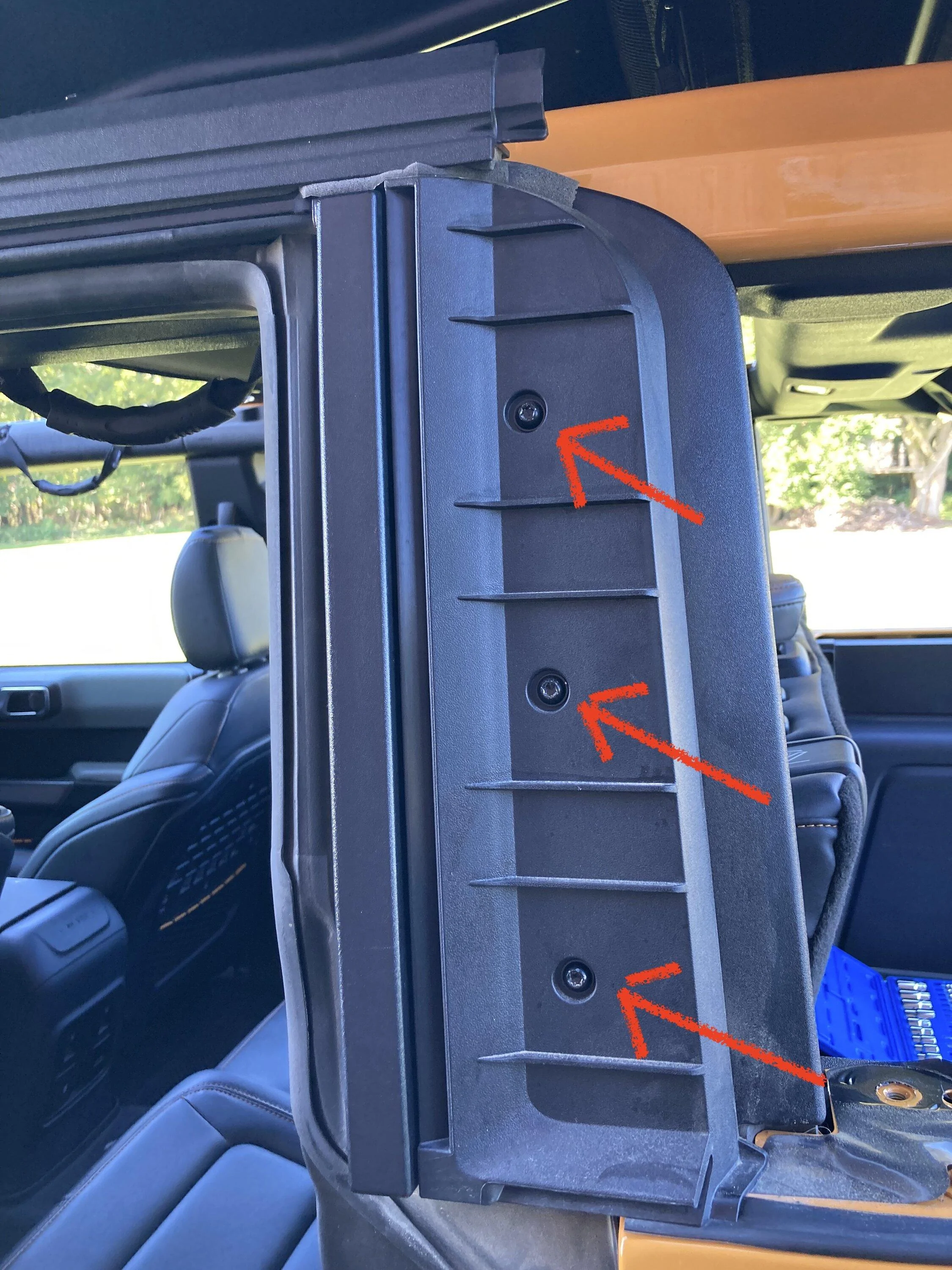

Step 8: Remove vertical window retainers
On the C-pillar, remove the plastic window retainer bolts using a T30 socket. Retain these for future installation. The plastic retainer piece should slide out easily though it might be attached at the top with some foam adhesive, so just carefully peel that away from the vehicle. Find the original OEM T30 bolts that were removed from the C-pillar during initial install and reinsert them (you did remember to save those, right??)

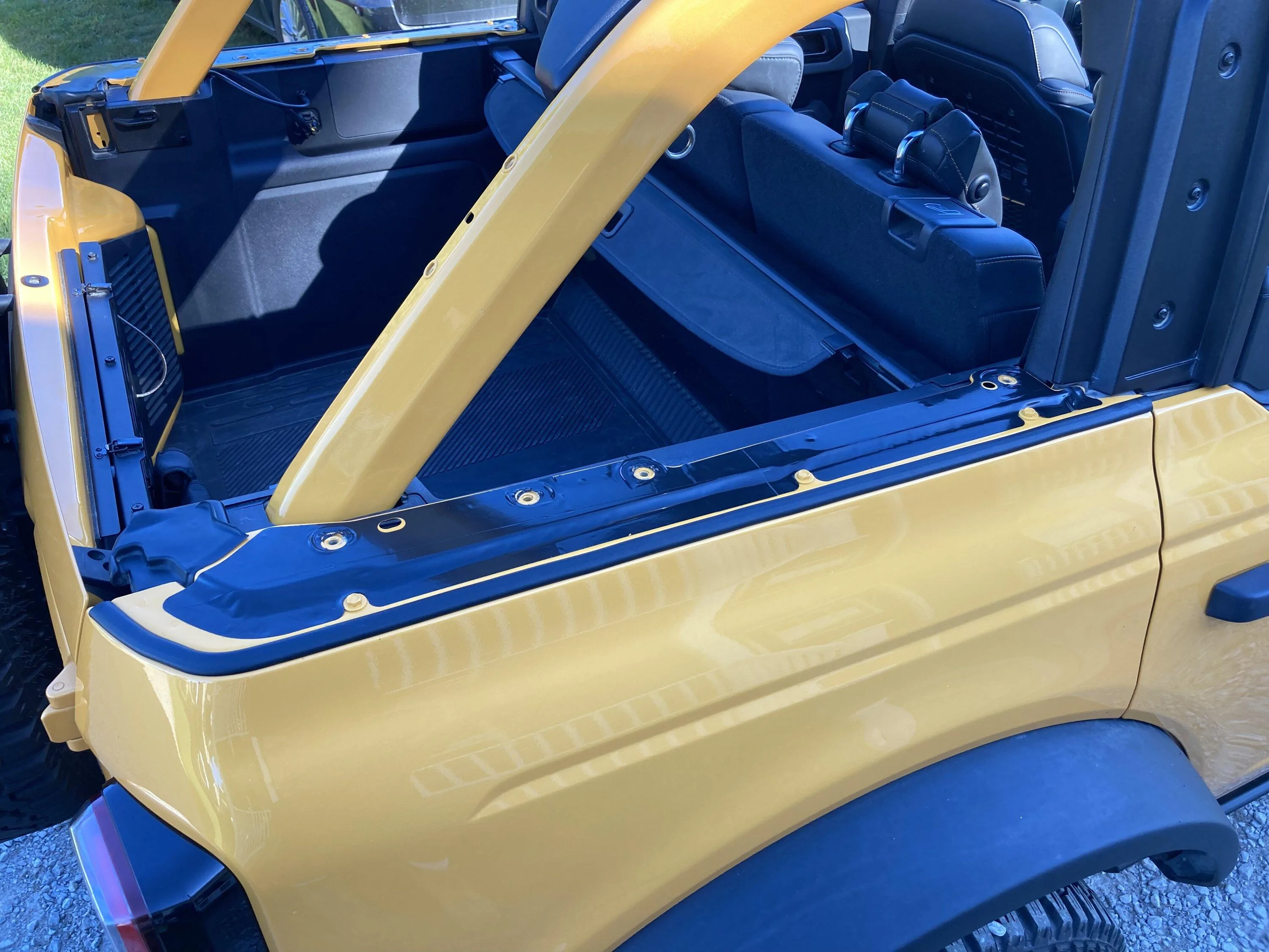

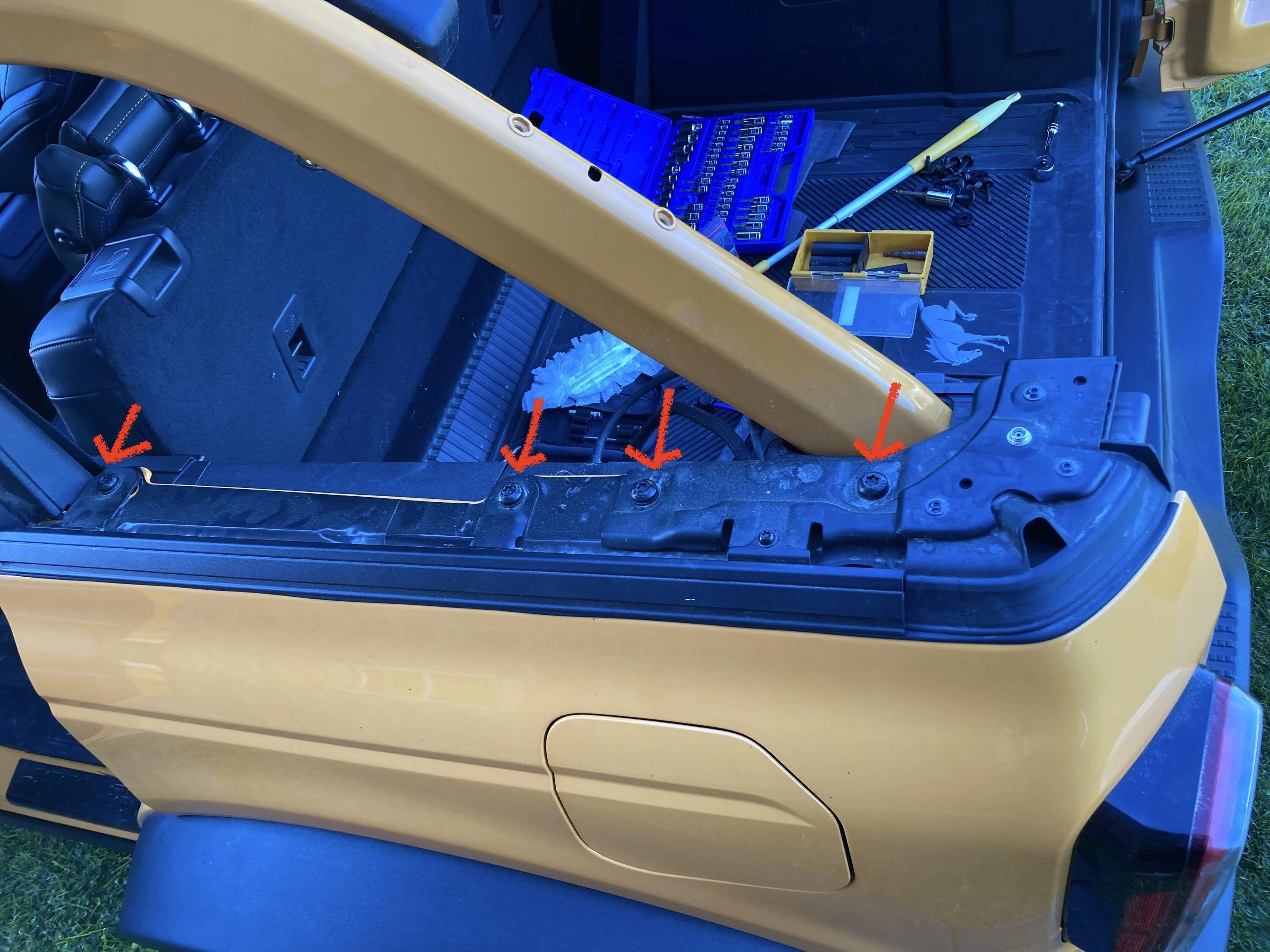

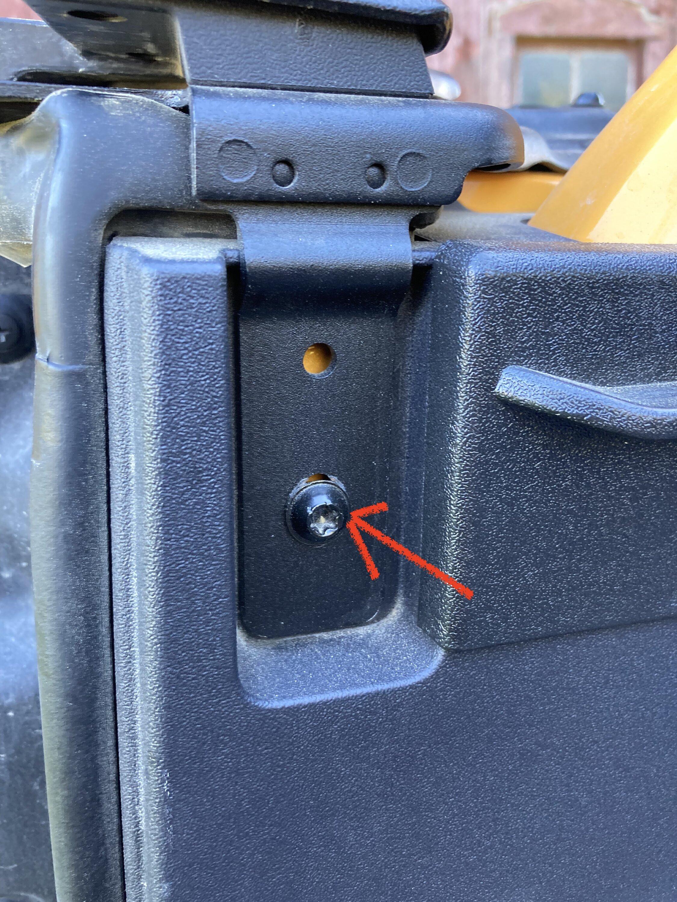

Step 9: Remove tailgate brackets
Using a T50 socket, remove the four bolts along each side. These are OEM bolts that you will use to reinstall the hard top, so hang on to them. Remove the T30 bolts from the inside of the tailgate toward the back. Retain these for future installation. The rear tailgate brackets can now be removed as one piece revealing the insulation and vinyl wrap that was used during initial install. This all can be left on the vehicle and used in conjunction with the hard top.

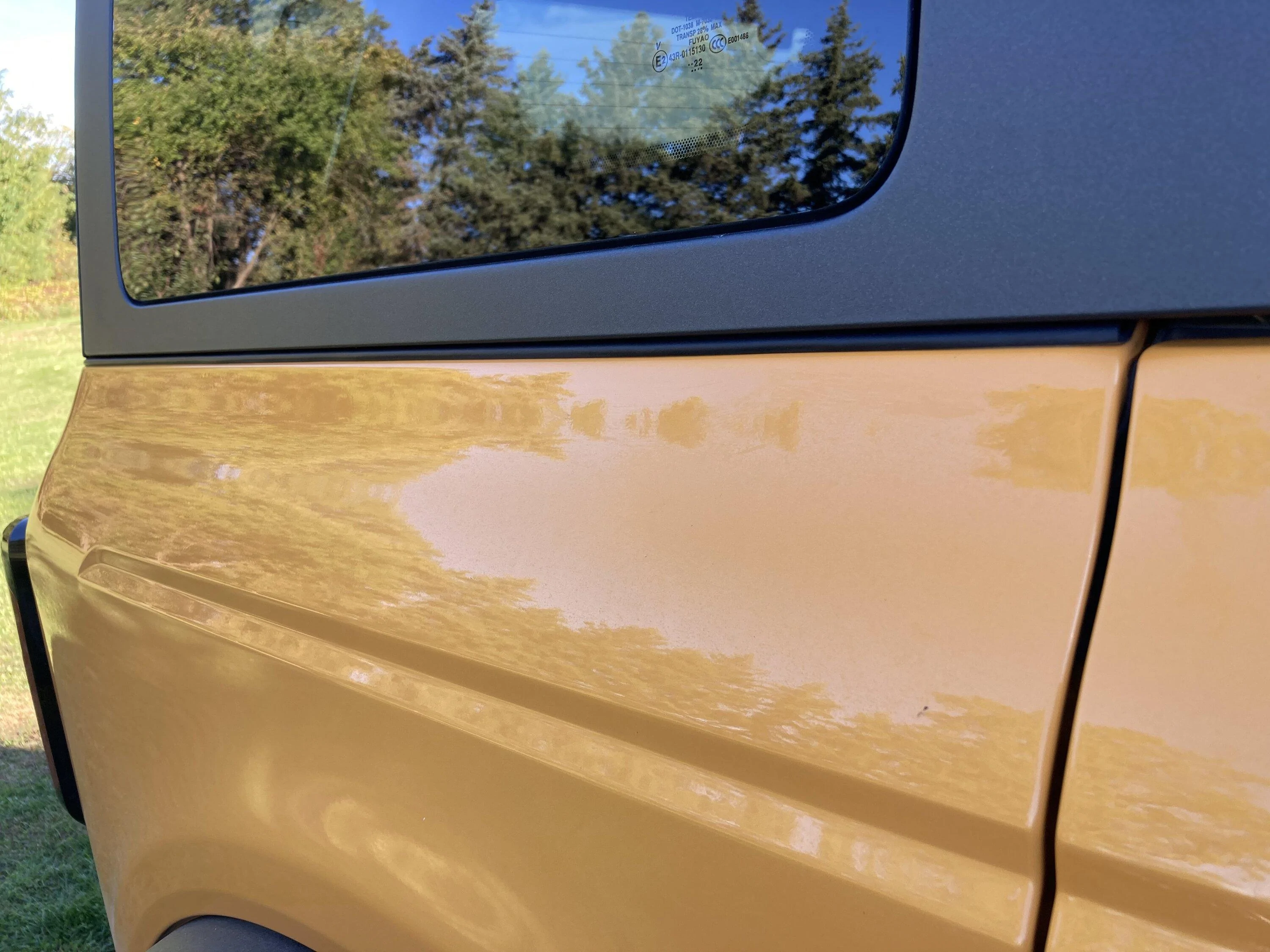

I didn't remove any of the foam, it all stayed attached to the vehicle or assembly where it was originally affixed. The only exception was the small foam piece on top of the C-pillar window retainer which was affixed to both the Bestop plastic and the vehicle trim. I had to peel that off the vehicle trim and left the rest attached to the window retainer, which will probably be fine next year since it gets squished by the installation of the bracket anyway.
I included a photo of what the tailgate looks like with the vinyl and insulation left on. I think it looks presentable as it is and you barely notice from a side view (and not at all with the hard top attached).
