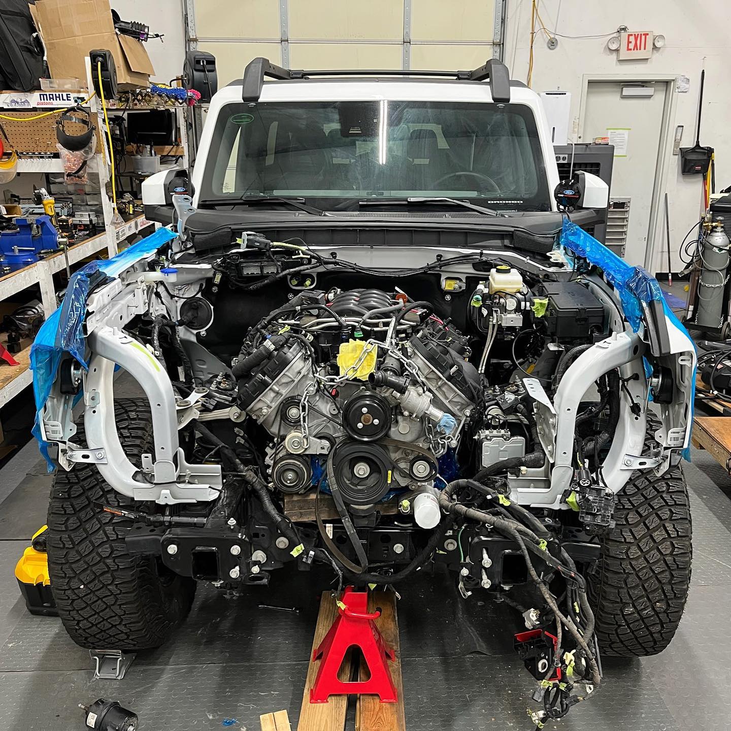

Didn't see a thread about this so thought I would share.
Ford Bronco Update 3-26-25: Whipple V8 5.0 Coyote Engine Swap into Ford Bronco by No Traction Faction 301952165_2918277588476416_6999123359042575946_n

I would worry about the trans more than the chassis.
If I were to try and tackle this I think I would try to find a donor F150 with a 5.0 already mated to a 10R80. Not sure how everything else will jive together though.
Engine, trans and transfer case. All you need to do then is have driveshafts made. That is the easy parts.
Hard part.............. integrating all the electronics to work together. Just look how hard it has been to upgrade just the rack.
Yes I'm curious to see how they program (or trick lol) the Bronco's computer that everything jives together.

Last I heard this project was scrubbed because of some issue it isn't feasable.
They couldn't get the steering rack programmed. :)
Eh, should be fine.
V8 Coyote maxes out at around 550nm, maybe 570nm of torque. Transmission is rated for 600nm. People tend to forget the 2.7L V6 EcoBoost has a similar torque rating to the V8 Coyote when the turbos on the are spun up on the EcoBoost. (Hence why Ford is using these smaller V6 EcoBoost engines instead of V8 engines.)
Now if they stick a turbo or a supercharger on the Coyote… well then yeah, something to be concerned about.
Logically they would just swap in the F-150 transmission to take the guess work away on the programming side. But not sure if there is physically enough room to do that, so they may have to stick with the stock Bronco transmission.
Changing that is a given. I doubt the bolt pattern for the bellhousing is going to match. I was thinking actually chassis bracing. Not too mention axles and driveshaft.
