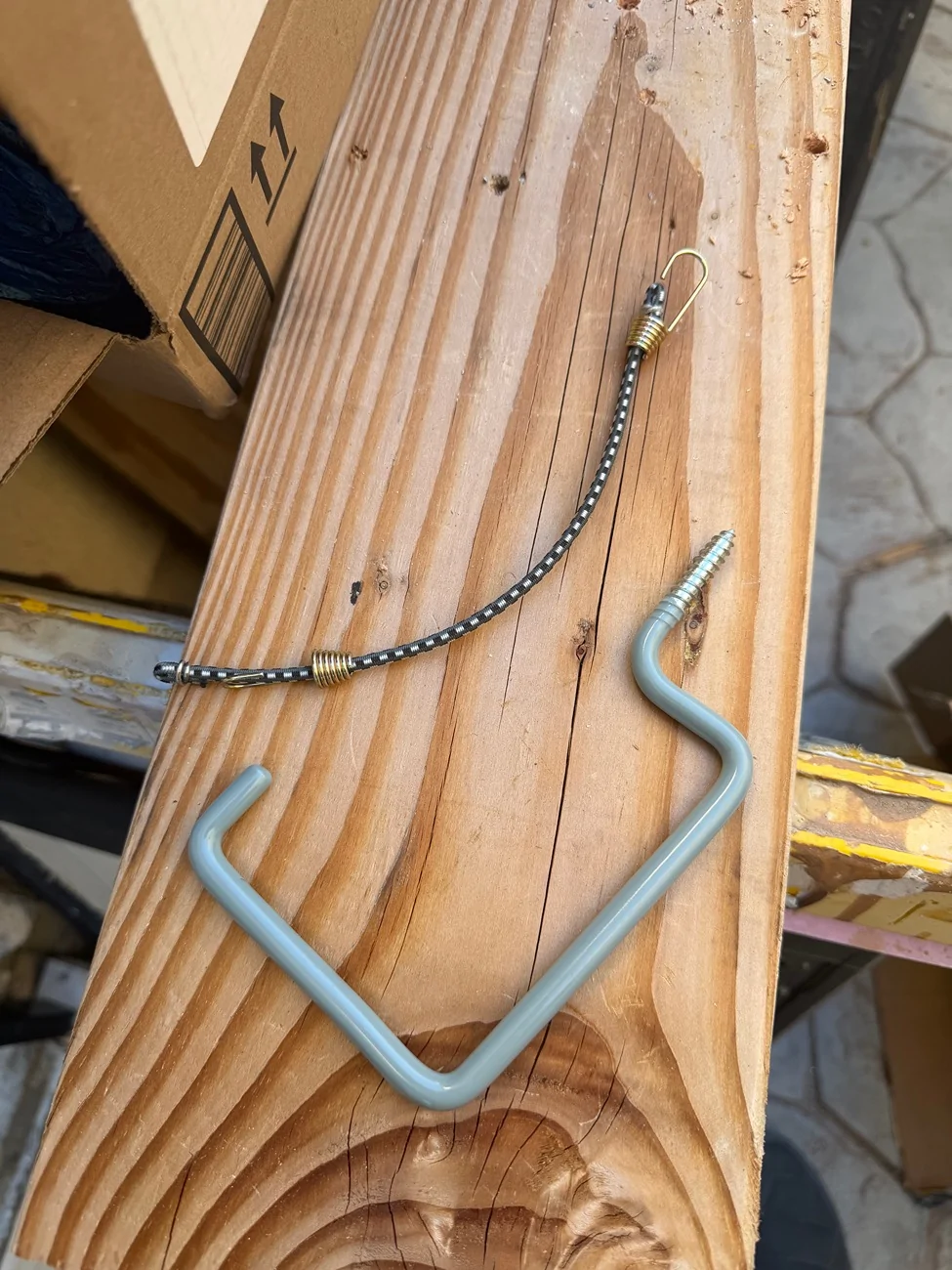

First picked up a small bungee cord and garage hook from the hardware store:
Ford Bronco $5 Seat adjustment lever extender IMG_5862

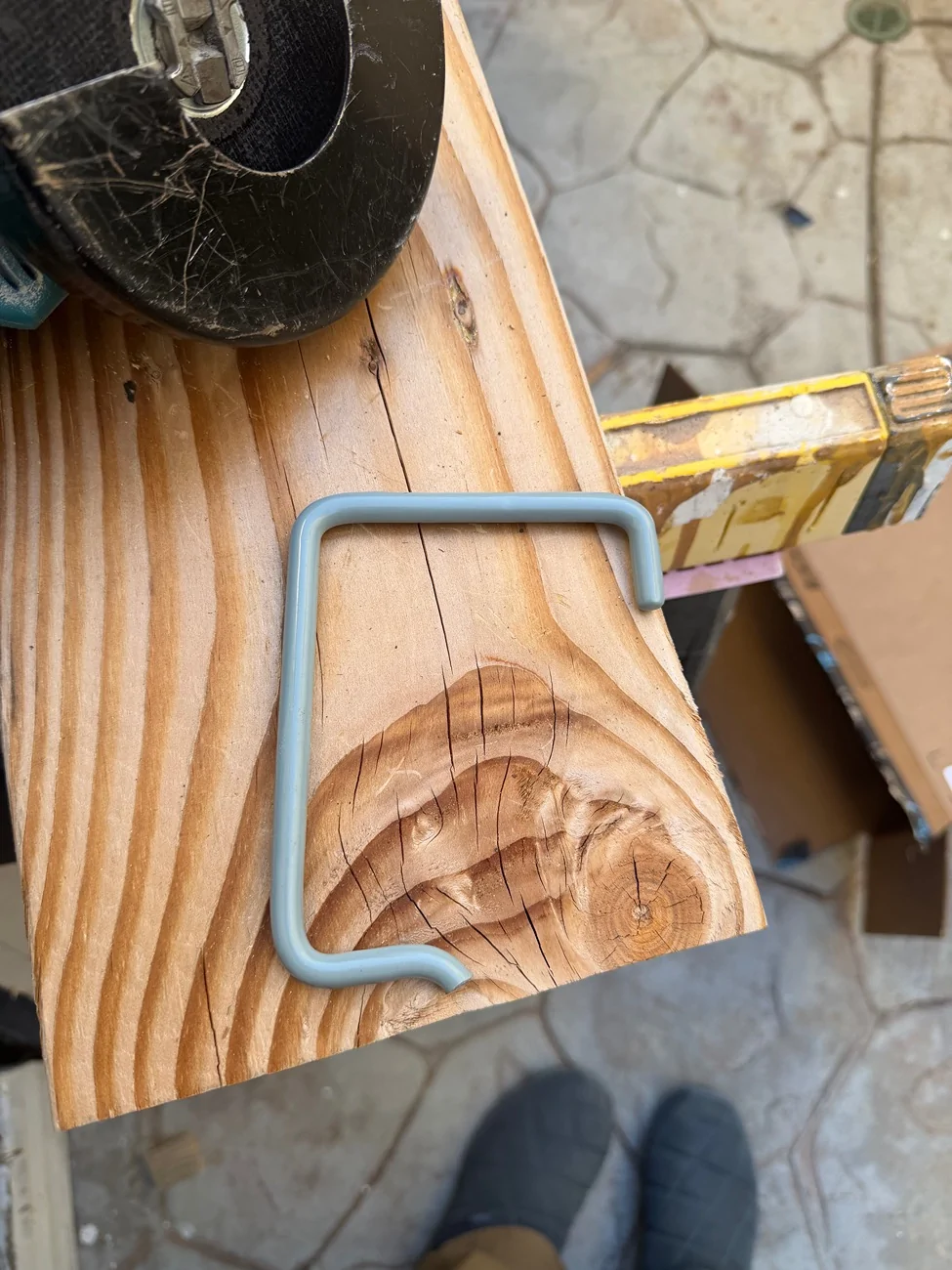

Then chopped off the screw part of the hook:
Ford Bronco $5 Seat adjustment lever extender IMG_5863

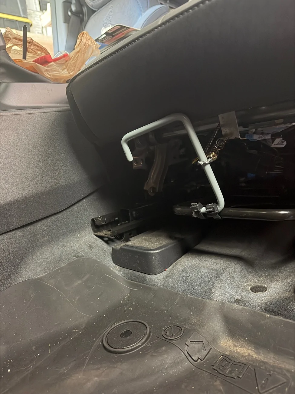

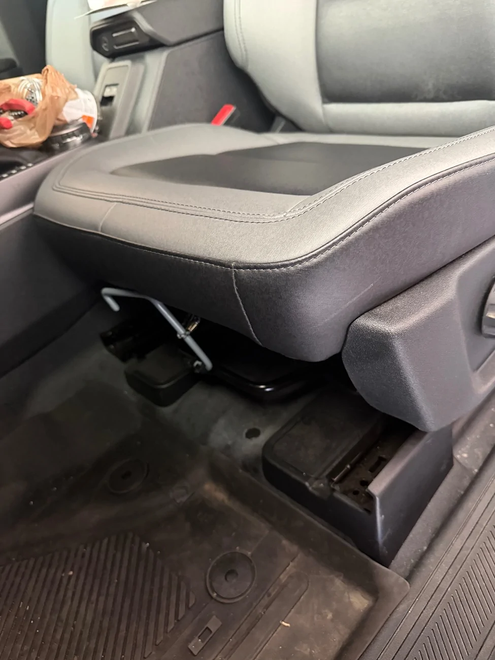

Then zip tied it to the original lever, and used the bungee cord to keep it pulled back.
Ford Bronco $5 Seat adjustment lever extender IMG_5865
Ford Bronco $5 Seat adjustment lever extender IMG_5866
A little janky for sure, and could make some improvements to make the attachment a little secure, but works pretty good. Just wanted to share in case anyone else was looking for an idea to make it easier to adjust.

Simple, effective & works for you @yamlro
May I suggest a pair of small worm claps instead of zip ties - it should make it a little less “janky” and likely a bit more fault-tolerant. 👍🏼

lexus nx, tesla m3p, 2door sas
That’s a great suggestion, I’ll try it, I’ll need some rubber or something to keep the clamp from marring the handle
Bschurr
Jan 28, 2021
1,816
4,168
NY
Wrap it in Tesa fabric tape or electrical tape…
