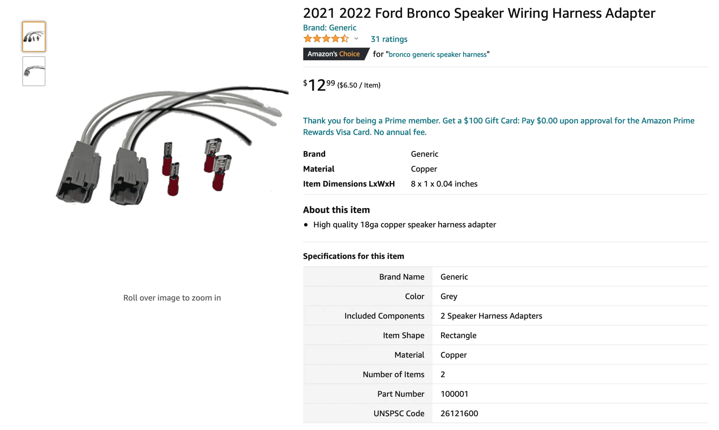

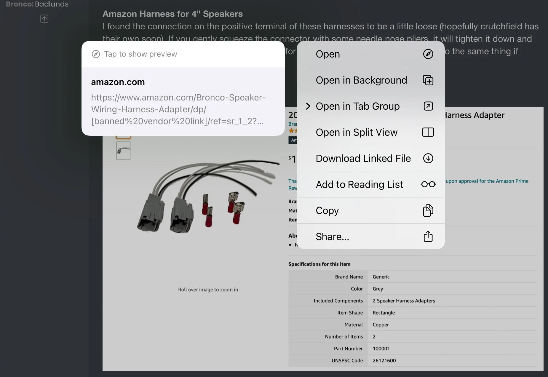

Amazon Harness for 4" Speakers
I found the connection on the positive terminal of these harnesses to be a little loose (hopefully Crutchfield has their own harness soon). If you gently squeeze the connector with some needle nose pliers, it will tighten it down and form a good fit. The negative terminal fit snug for me on all 5 harnesses, but you can do the same thing one that one if needed.

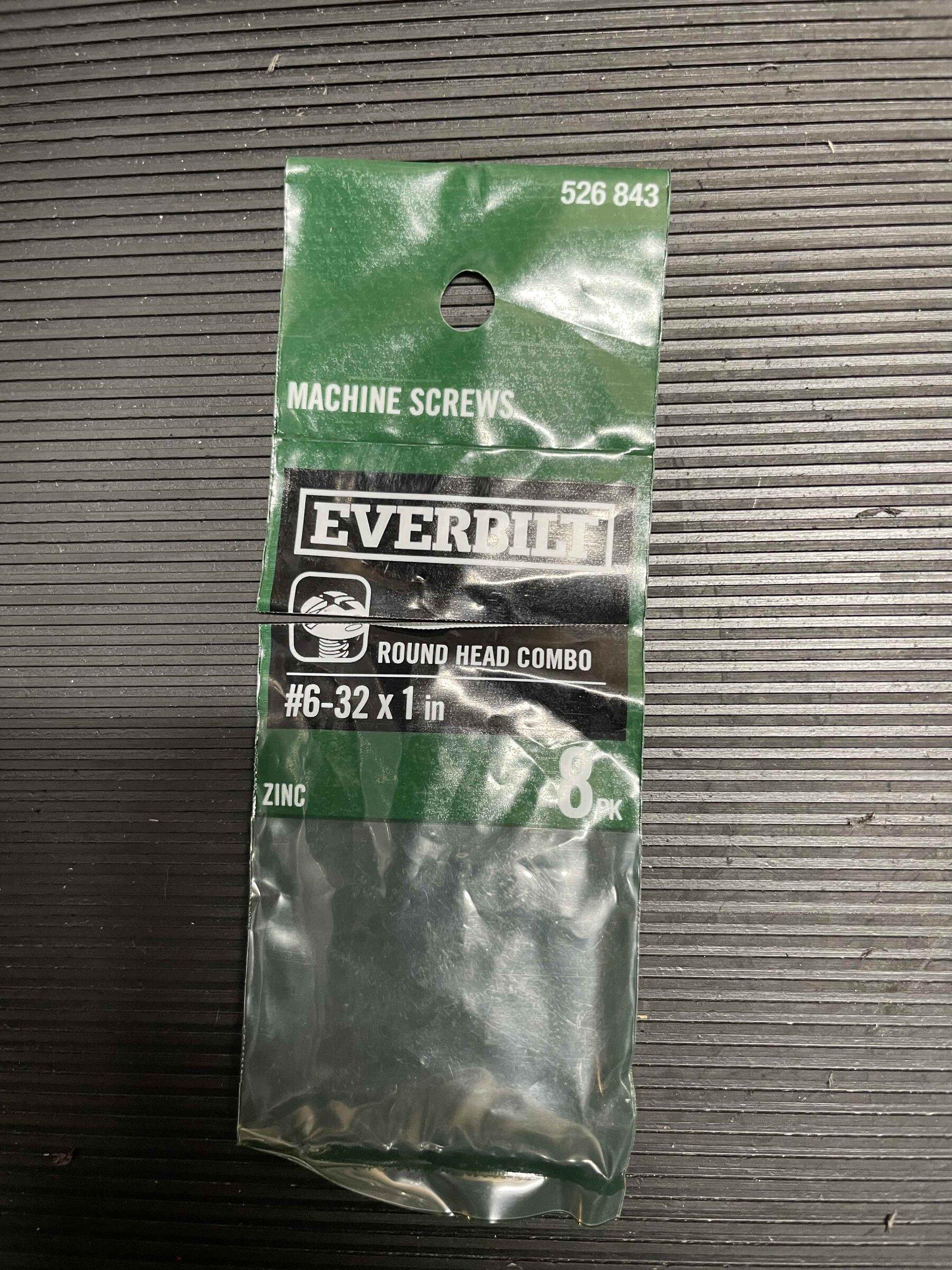

The installation on these was a bit more challenging. The screws that come with the Focal ACX 165 speakers will not fit in the Bronco. They are 1.5" screws and the metra extension plate is 1". Go to Home Depot and buy two packs of these #6 x 1" screws w/nuts (each speaker takes 8 screws). You can also do #6 x 3/4" screws, but you cannot do 1.25" or #8 screws (any length) since the #8 screw head is too big for the focal speakers.
Link to Home Depot Screws
Once I got the right screws, the speakers mounted to the brackets easily and installation was straight forward (it's an awkward position to work in, but everything else is easy).

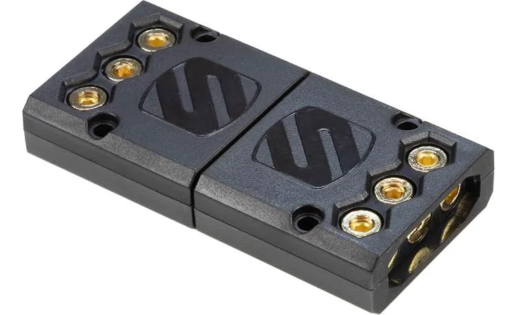

Scosche Kwik Plug for Power/Ground

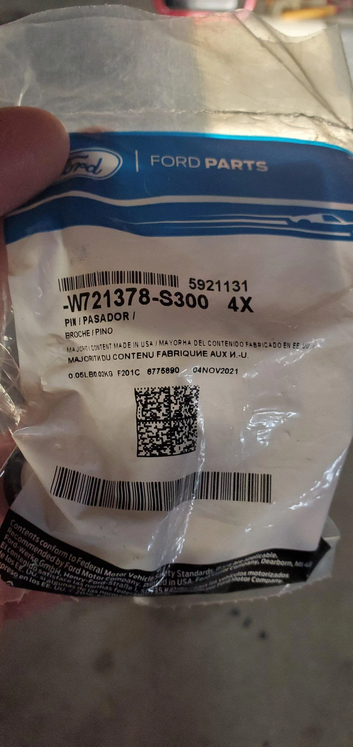

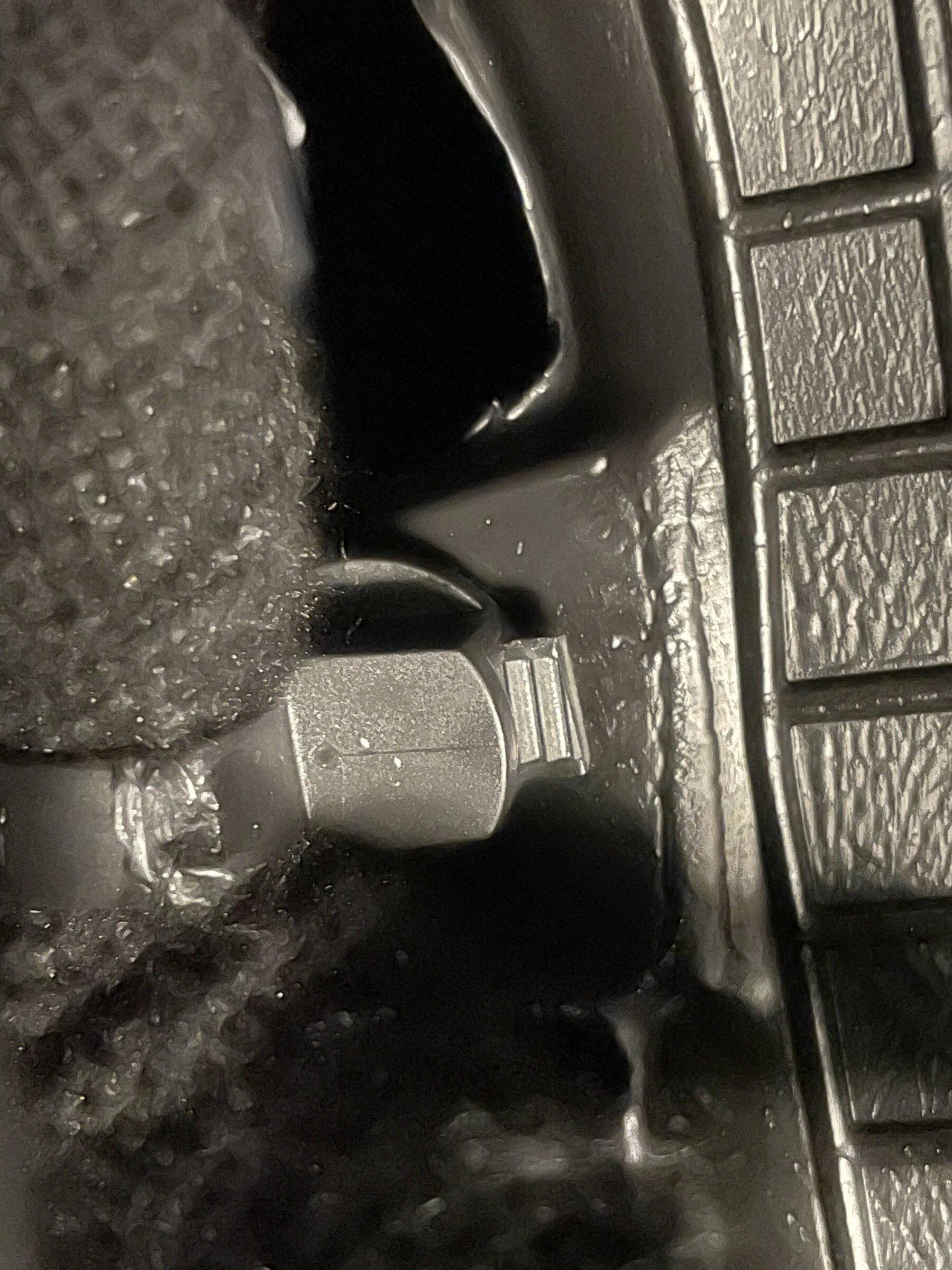

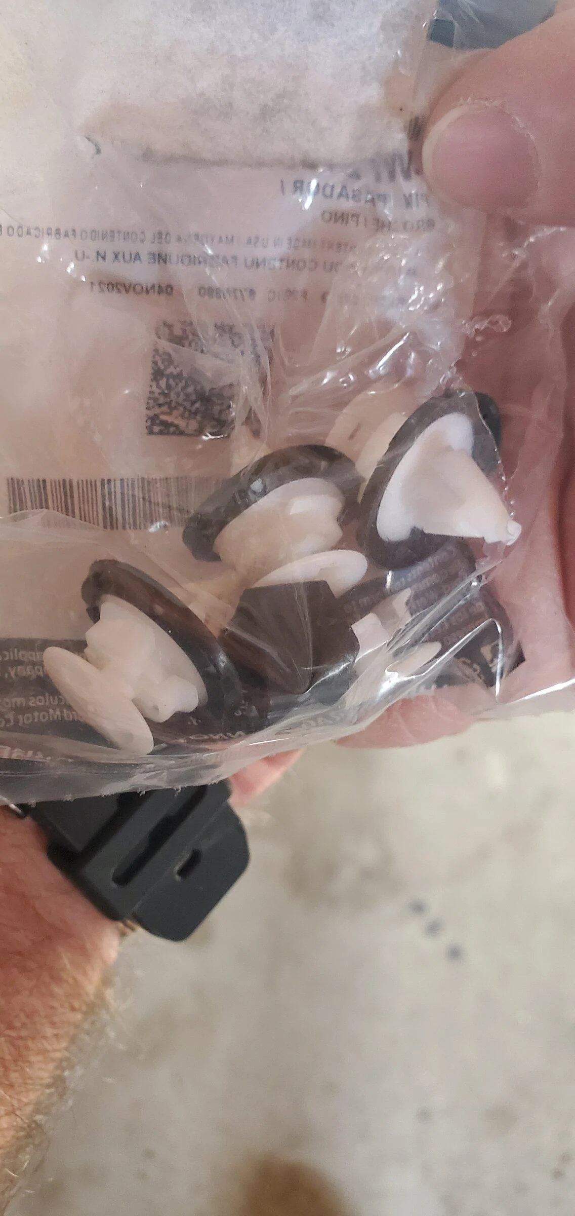

EDIT #1: I decided to remove the trunk panels myself for the sub install. Between the good instructions (attached) and some patience, I figured I would do a more careful job than the stereo shop. It isn't particularly hard, just take your time and use a good set of interior trim removal tools. You WILL snap a couple of these two piece clips no matter how careful you are, order TWO sets (they come in packs of 4). Most online retailers sell them for $5 a pack. Your dealer will charge you $30
[Factory 2-piece clips]

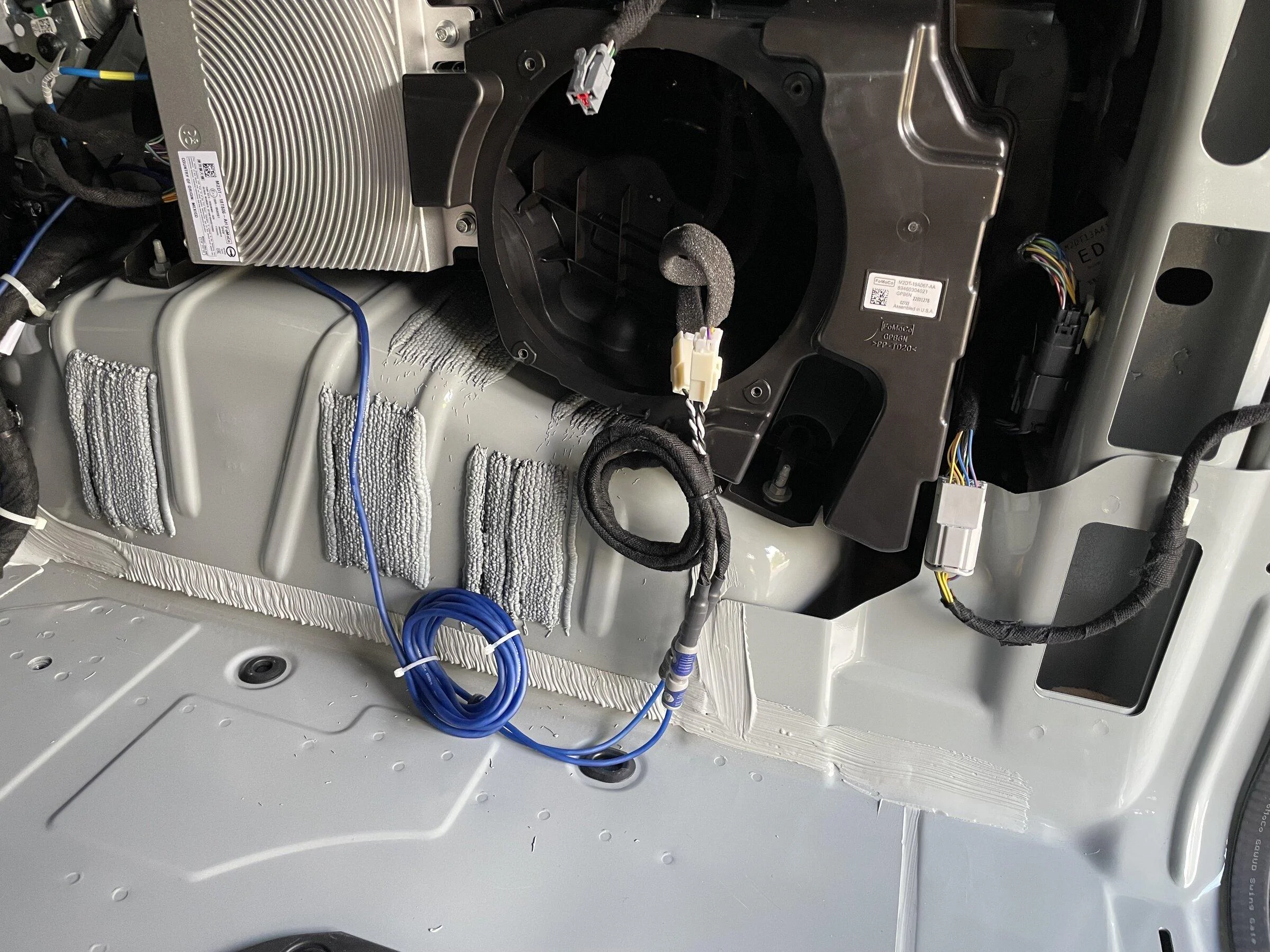

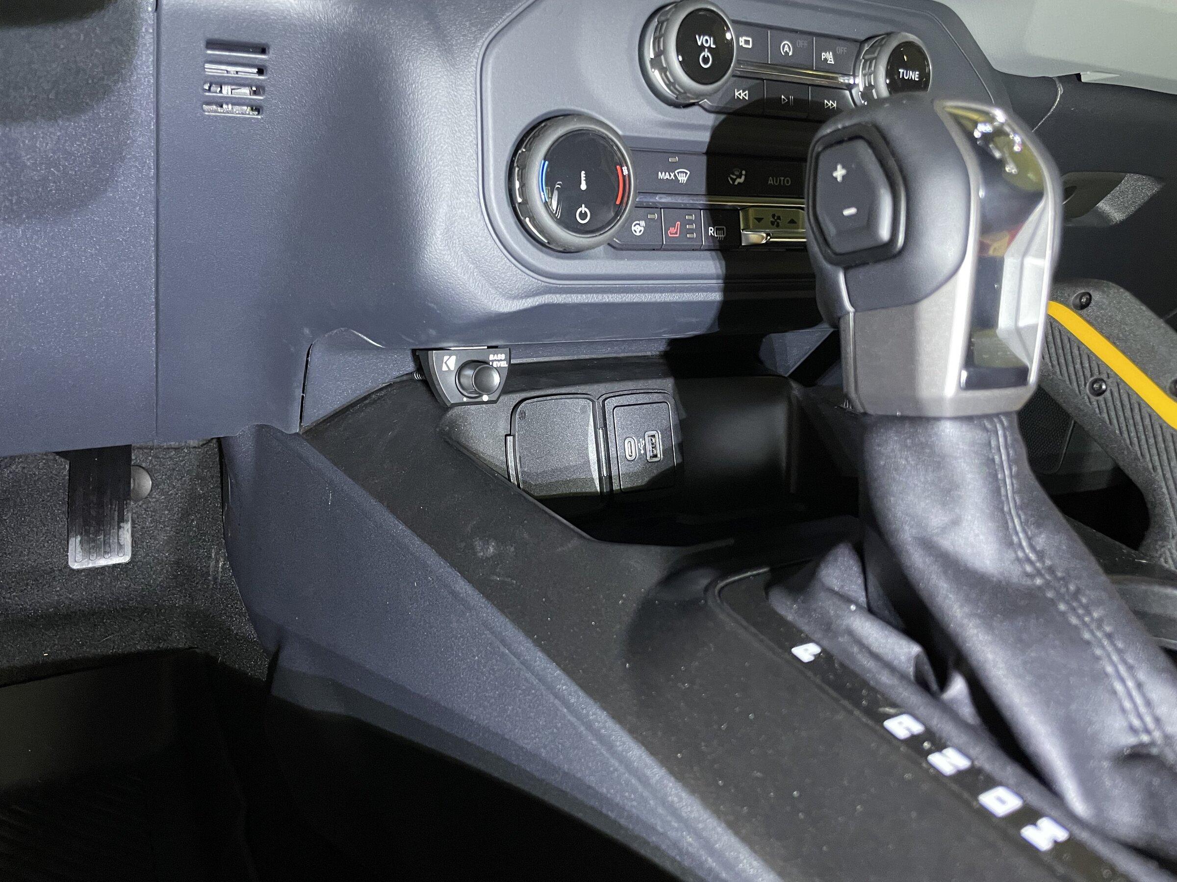

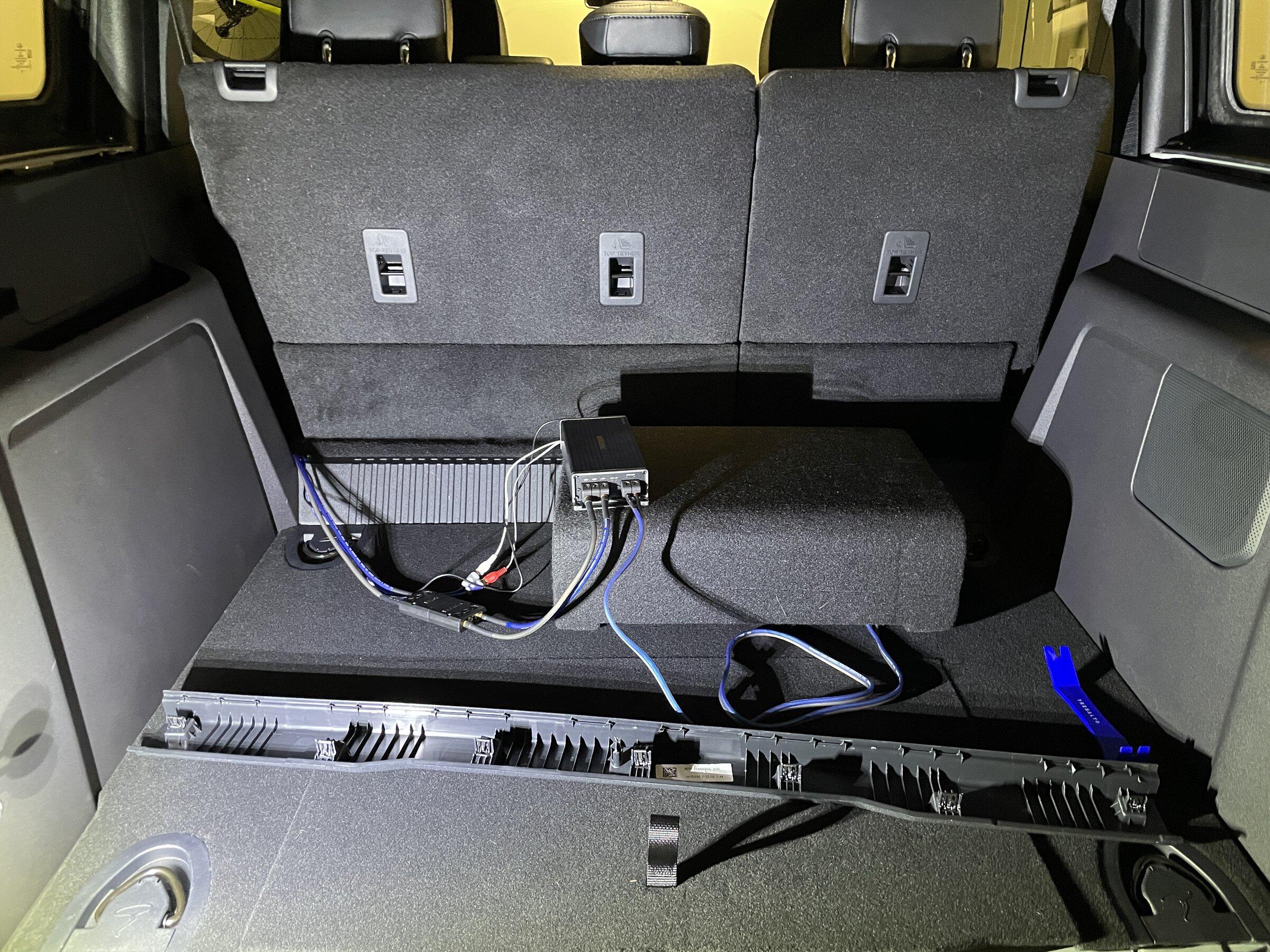

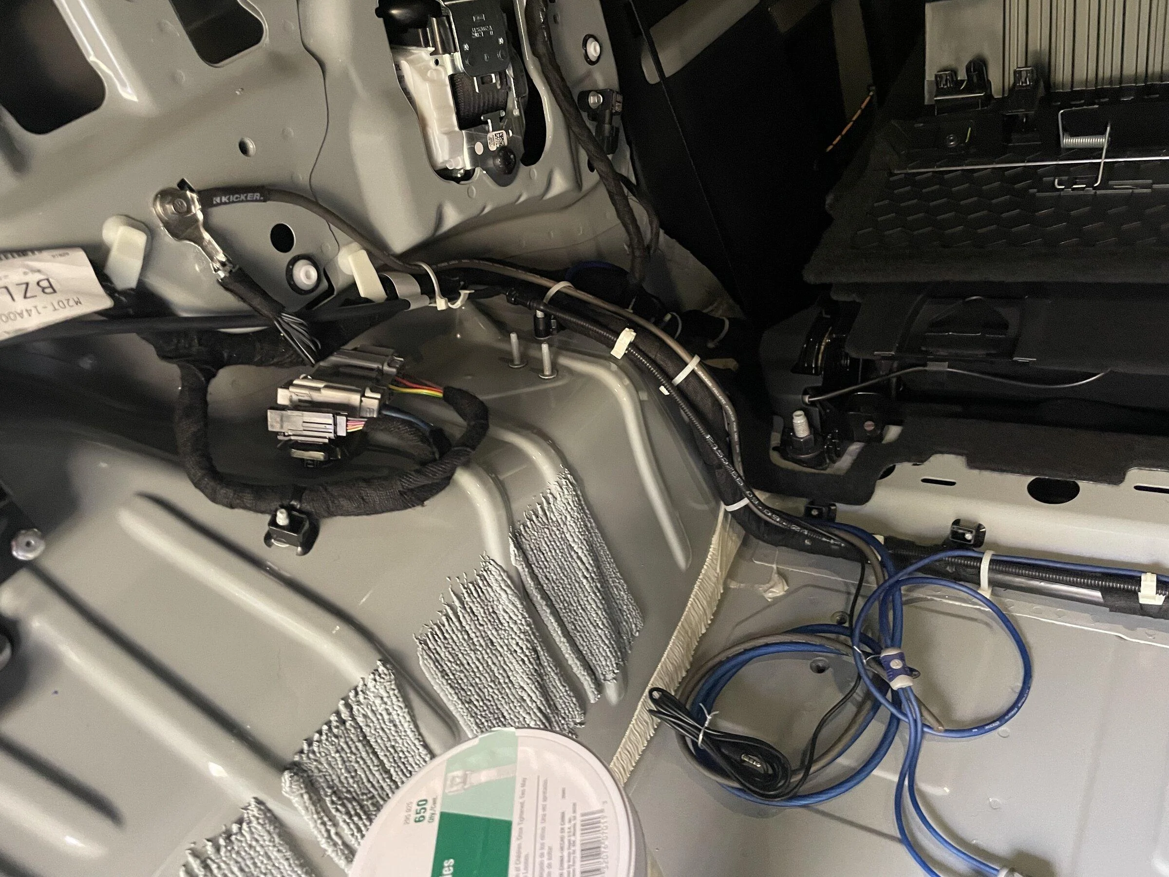

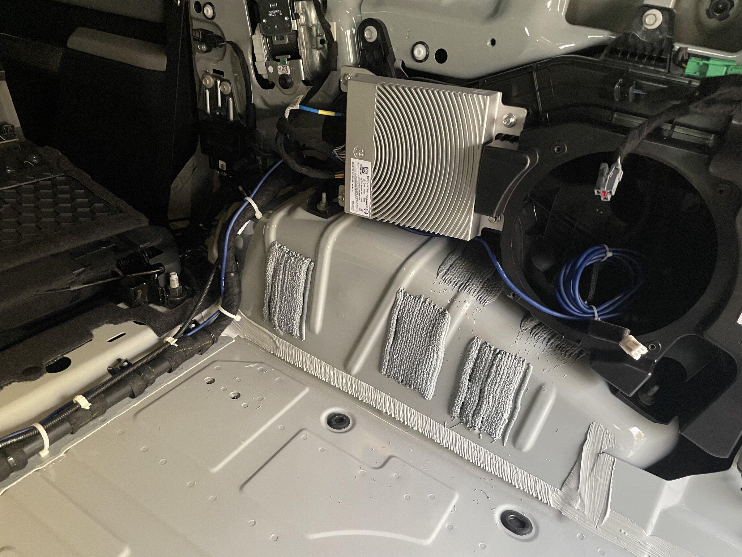

Since I still had the front driver kick panel off from replacing the 6.5" speakers, I figured I might as well pull the power and bass control remote knob wires myself. Once you have the trunk panels and driver kick panel off, it's very easy. Cut a hole in the grommet to the engine bay and it is easy enough to snake them along the driver side channel. I used a coat hanger to pull the wires between the front driver door and rear driver door to avoid having to pull that A-pillar.

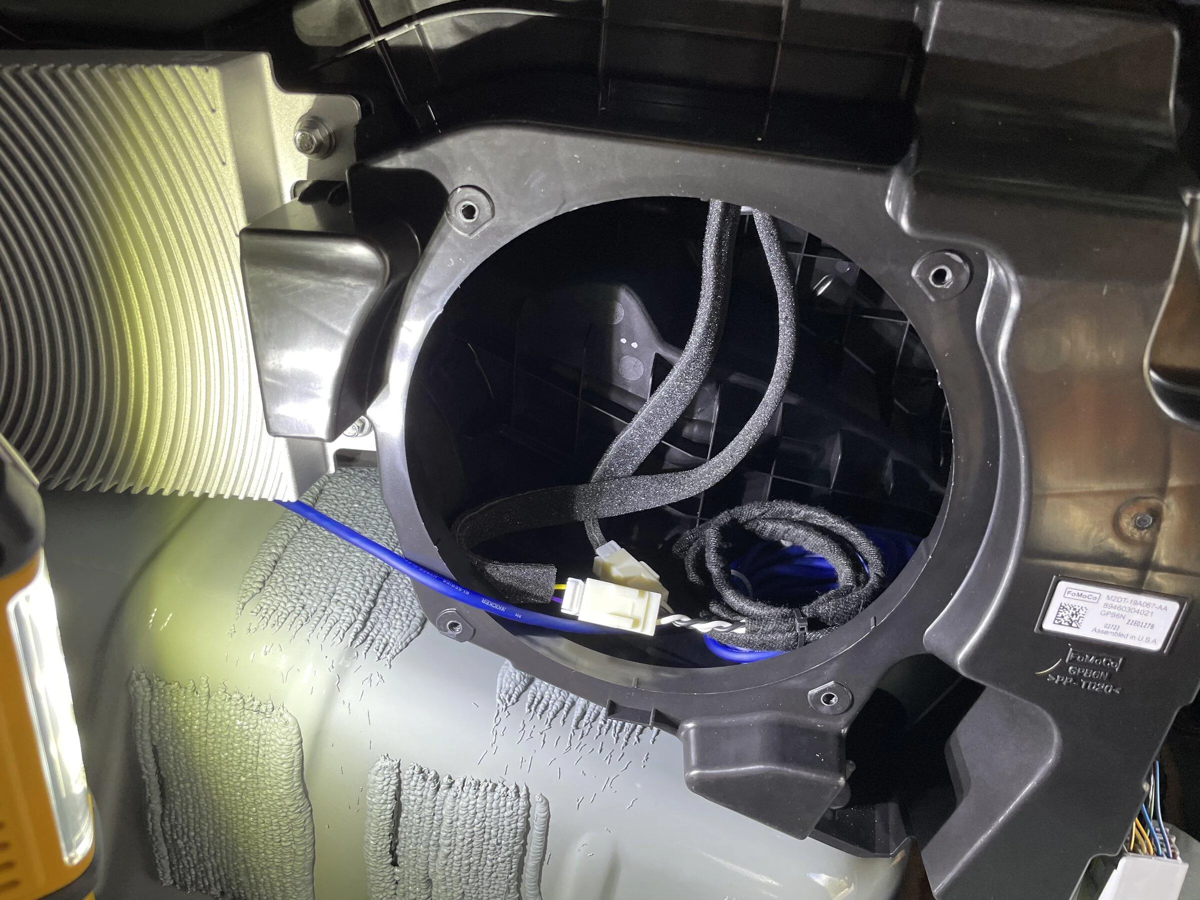

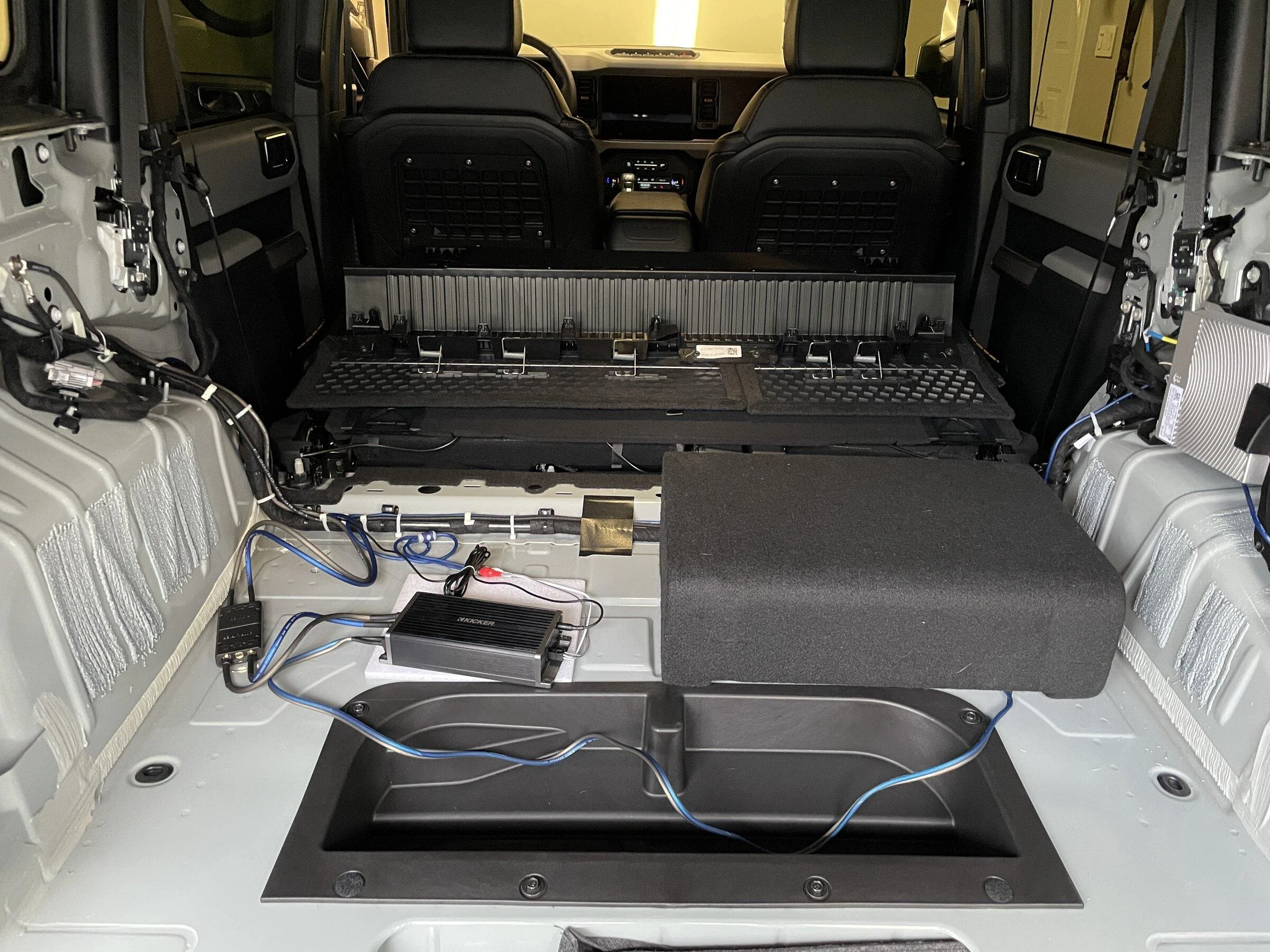

After I got the power/remote cables pulled to the trunk and zip tied up, I started looking for a good place to mount the Kicker amp. Surprisingly, there aren't a lot of good hidden places if you're leaving the factory sub enclosure in place. Under the rear seats doesn't fit when you fold them down. Behind the driver side trunk panel doesn't have anything besides an area all the way in the rear by the tail light but that wasn't ideal. The passenger side trunk panel doesn't work unless you remove the factory sub enclosure (which I didn't want to do because the harness I am using to tap the signal requires the factory connectors inside the sub enclosure and since the B&O amp is mounted to the sub enclosure, you'd have to fab something up to mount that amp as well). I also thought about putting the amp inside the empty sub enclosure but worried it would be difficult to secure and could rattle. Finally, anything behind one of the side panels would be difficult to access. While you shouldn't have to tinker with the amp after getting it set up, I am sure something would come loose eventually and I would be stuck tearing the trunk apart to access it.
My next thought was to mount it in the washout container beneath the trunk floor. After getting the wires run back to the trunk, the power and ground (even 8 gauge) is too thick to run beneath the carpeted floor without it buckling up. Possible, but not ideal. So I decided to use a Schosche kwikplug to create a quick disconnect system and mount the amp in the trunk next to or possibly attached to the sub enclosure).
[Schosche kwikplug]
[Ground on driver side I used]
[RCAs to factory sub enclosure for signal]

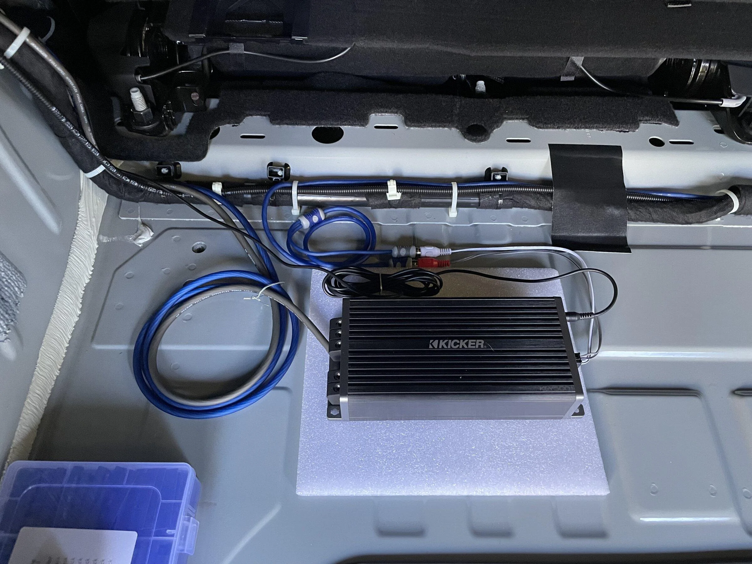

EDIT #2: A little more progress over the weekend. The Sounds Good Stereo adapter came (fits perfectly to factory harnesses -- note you'll need female to female RCA adapters (assuming both ends of your RCA cables are male).
Two pictures below, one with the cables/connector out of the sub enclosure so you can see them and one with everything tucked back in. I put a little electrical tape over them to keep them in place, but with the panels back on, they won't go anywhere and reversing it is as simple as unplugging the harnesses and plugging them back onto the factory sub. Nothing in this install involved cutting or tapping a single wire / part in the car.
Amp set and ready for the power, ground and speaker cables (just waiting for some ferrules and the scosche quick disconnect kit).
Bass knob mounted up front with gorilla glue 2-sided tape (I tried a number of thinner tape alternatives and none held up more than 24 hours):

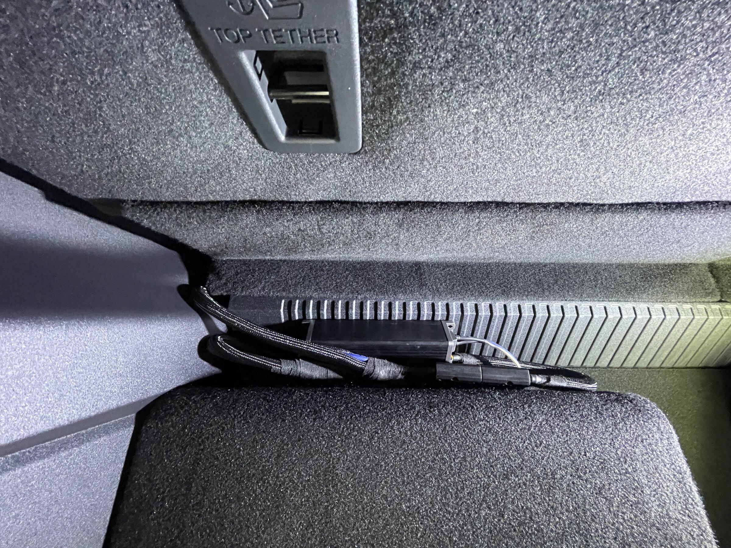

Still not sure how I want to "mount" the amp.
Before putting the interior back together:
Interior back together (snapped another one of those cheap two piece clips putting the passenger side panel on):

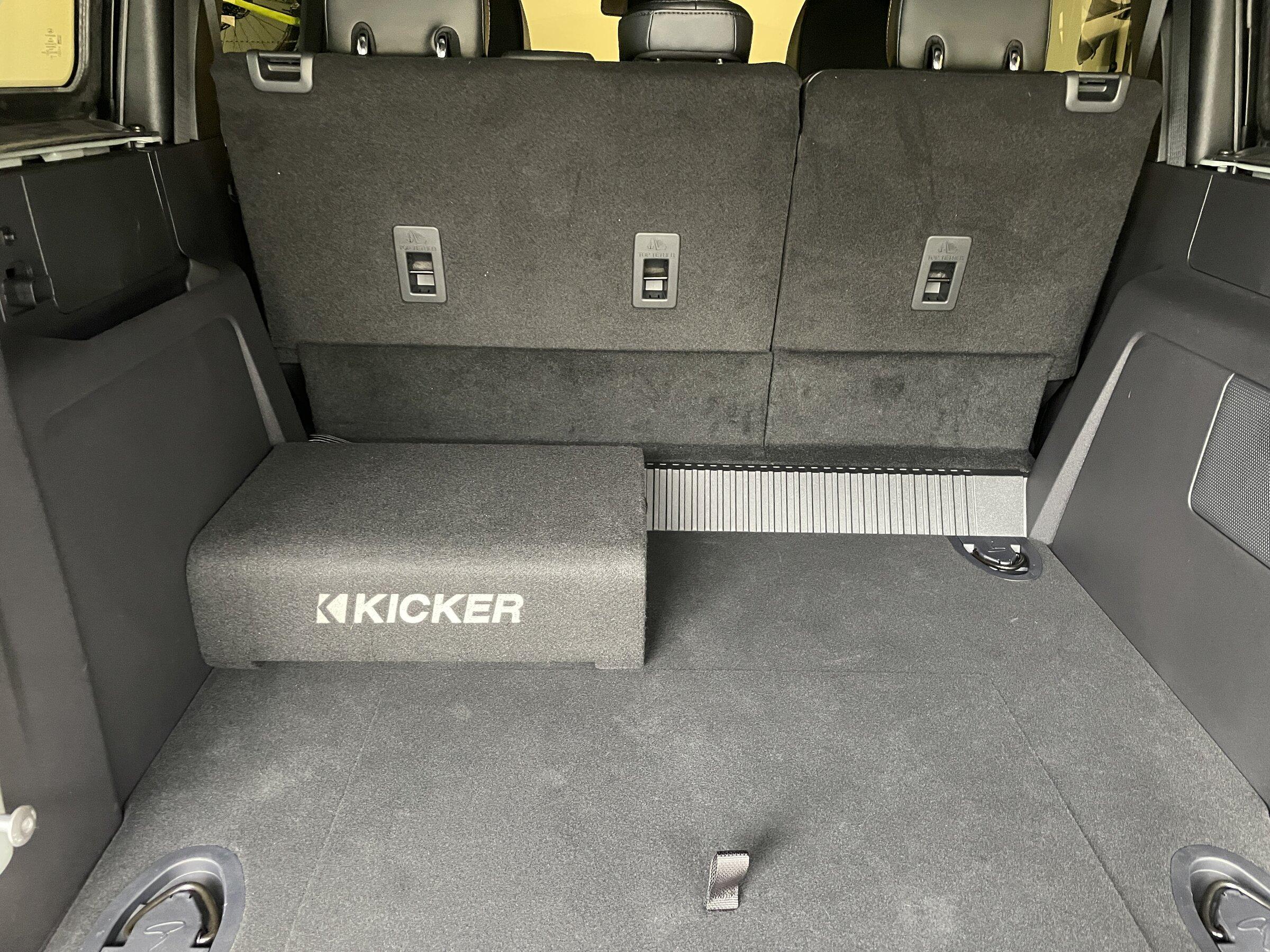

Final sub install pics:

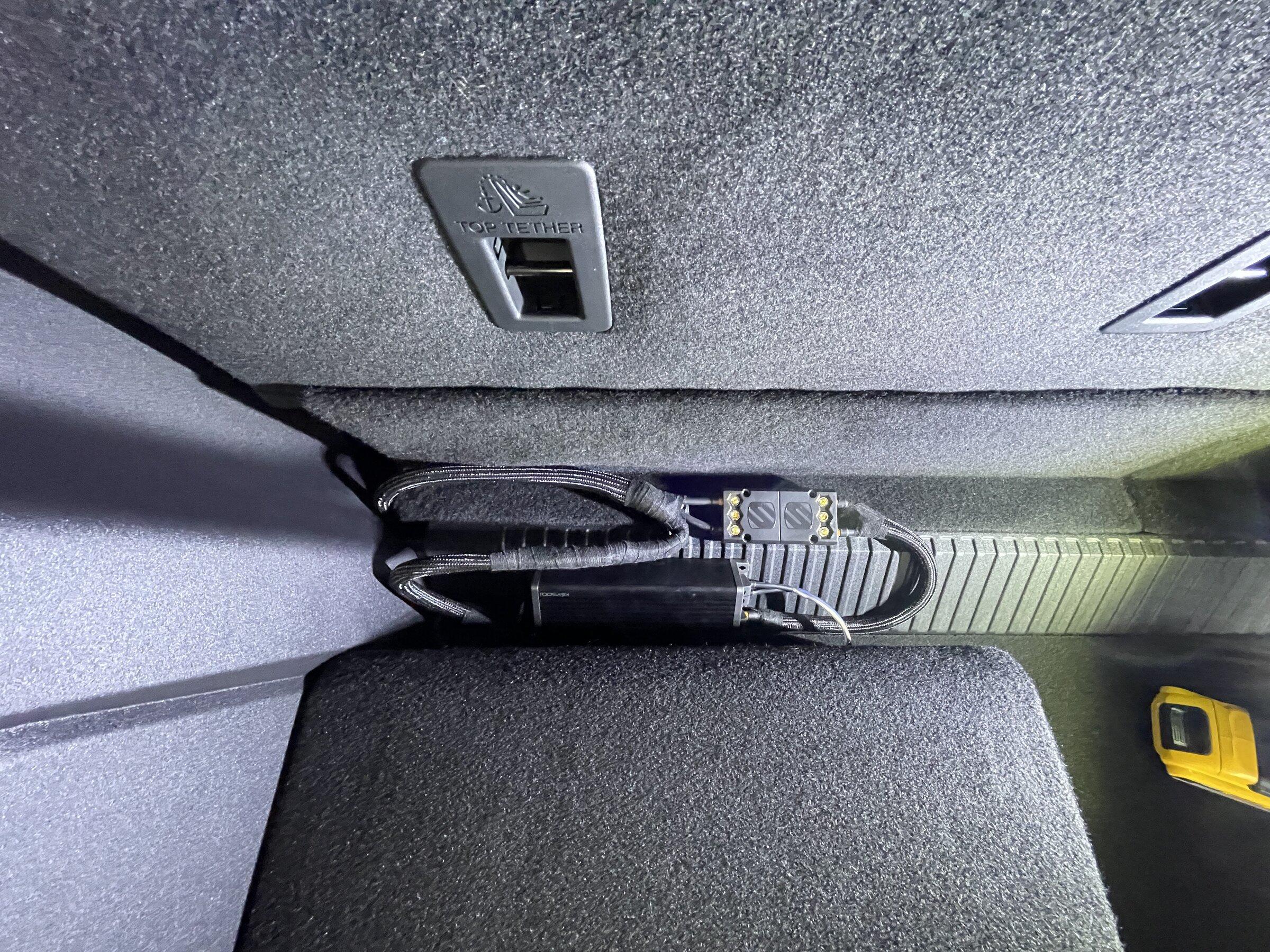

[Quick disconnect harness for power / ground. The other wire that splits off from it is the RCAs and remote wire concealed in the cable sleeve.]
[Harness/wires tucked behind the box:]
[View from the back of the truck:]
