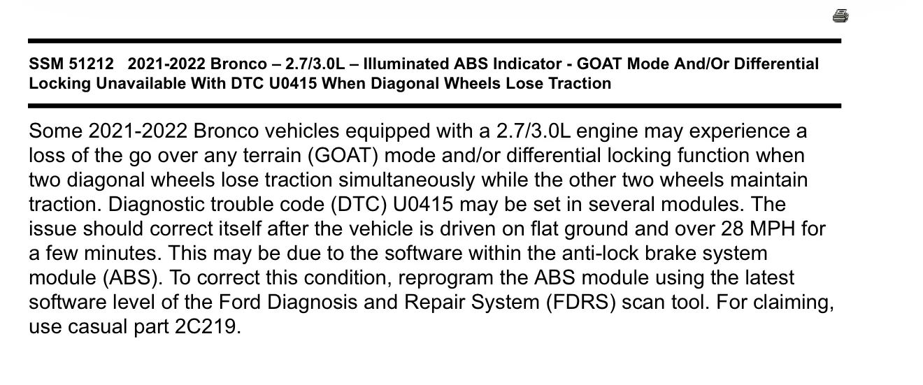

I had this happen to me DEEP inside Uwharrie on Dutch John Trail alone during the week. Horrible spot for it to happen. Every kind of error code you can imagine. I finally got out to a service road and once I got it up to around 25mph, everything cleared and was all good. I'm gonna have to check out that service bulletin above that @Ducati1098 posted (thank you, Ducati). That sounds like what was going on...hasn't happened since, but I definitely don't want to deal with that again.

Update! I was out on Daniel and Dicky Bell trails in Uwharrie last week. I tried my hardest to recreate this and could not following the ABS module update. I'm not positive if it did anything or just didn't happen this time out, but it didn't happen even though I tried.
