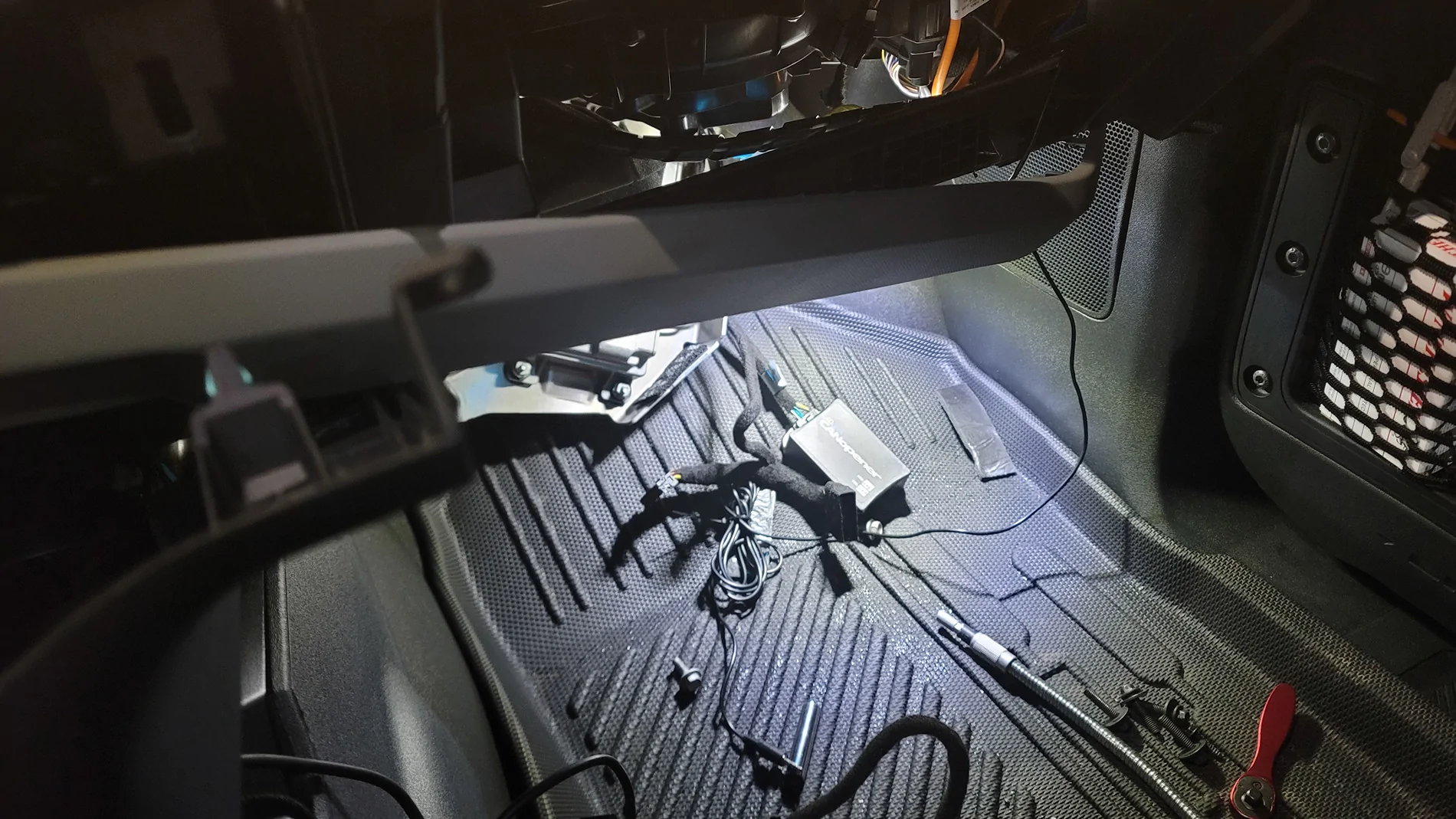

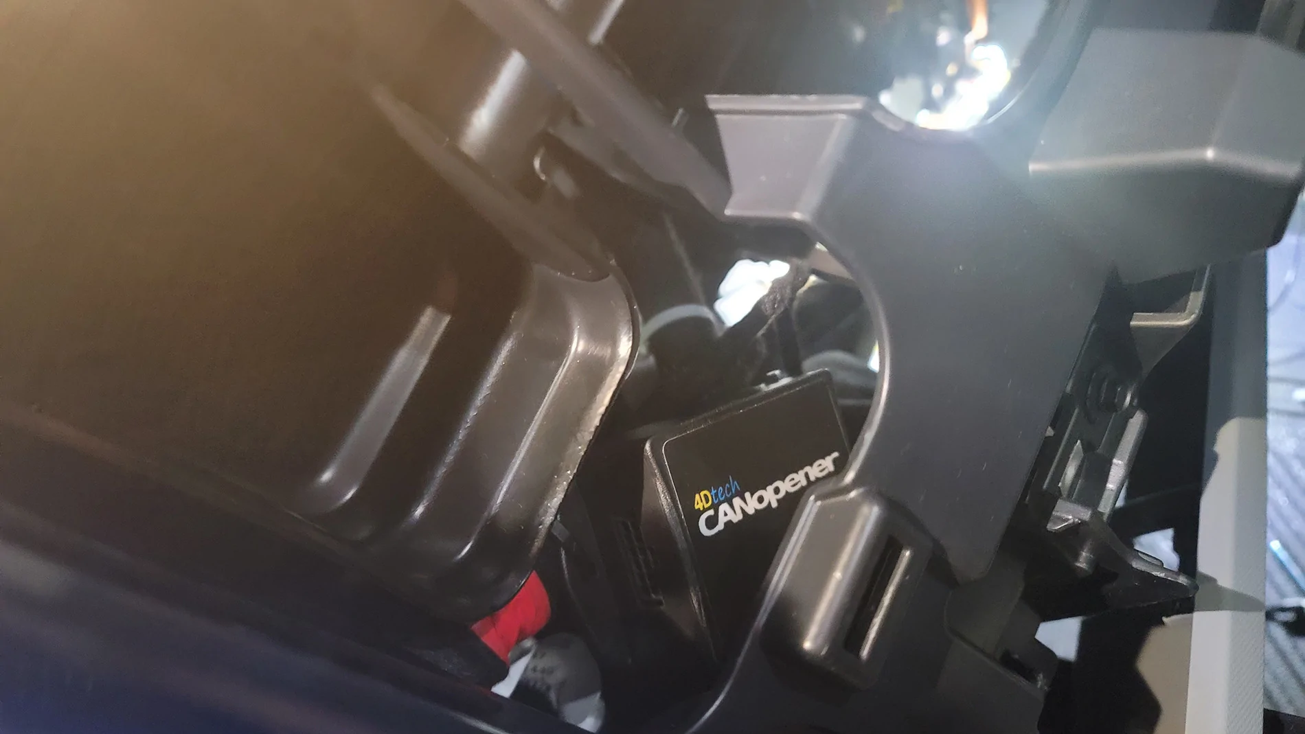

I have the CANOpener too. Other than one pain in the ass bolt on the footwell module install and making sure the pins are all seated in the HMI connector, the install is not that hard. I did it while installing the heated steering wheel.

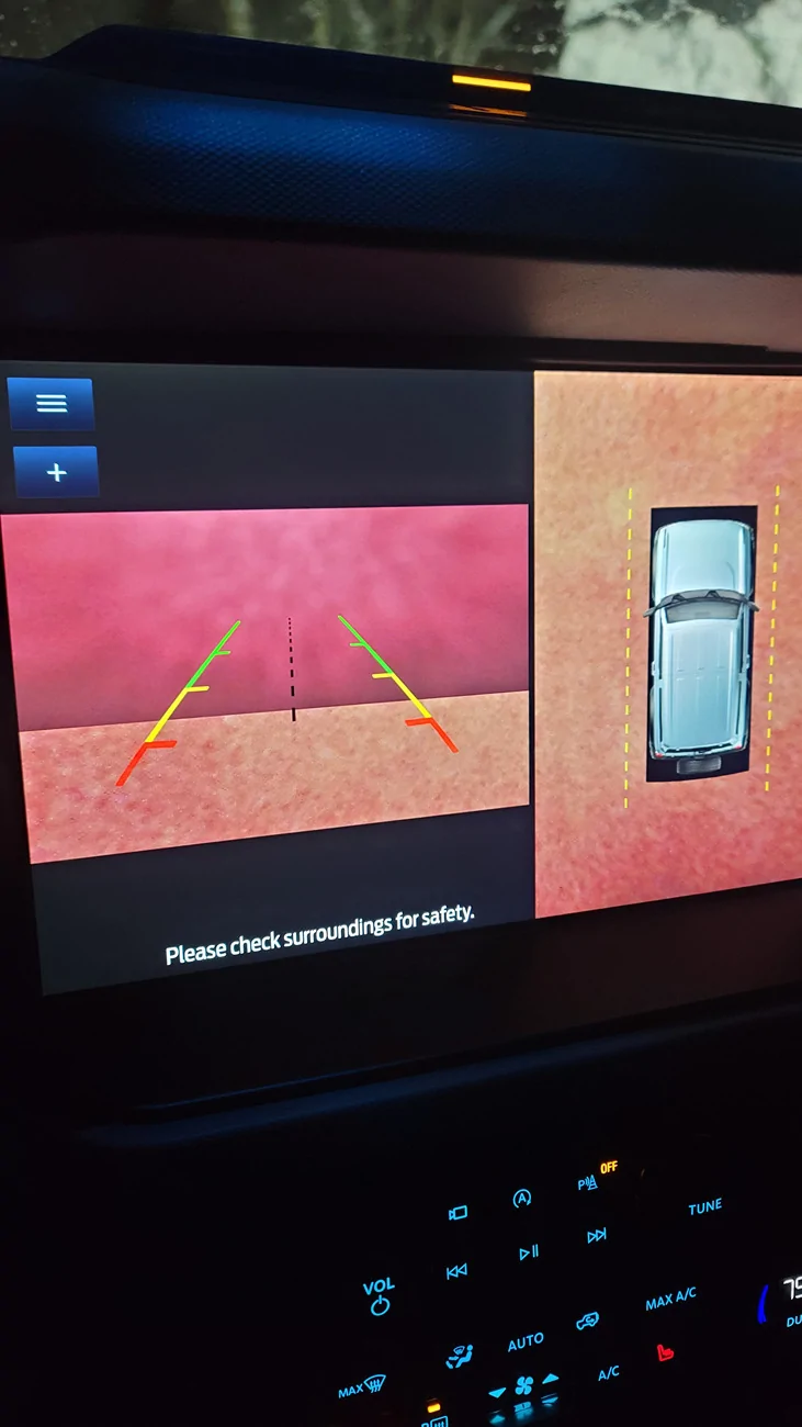

No, I use the camera at speed a handful of times each week this winter and haven't seen that issue. I did get this weird cardboard-looking error on the backup camera last week though:
Ford Bronco 360 Camera Unlock Device!?! 1000032968
I'd def notice on the 360 view, too, because the rear camera would be blocked with snow, like it is in the the top 2/3 of that picture, lol

Now that is odd.... I have had the reverse go black but that is it... Only time the reverse camera went black was in high heat temps. I think that is why there is a recall. I called the dealer to schedule and they have never gotten back to me but the reverse camera has been working fine ever since.... I have been attributing that to the cold temps.
I am not complaining about the rear camera (with the 360 cameras) suddenly working. It is nice... It just never had before.
