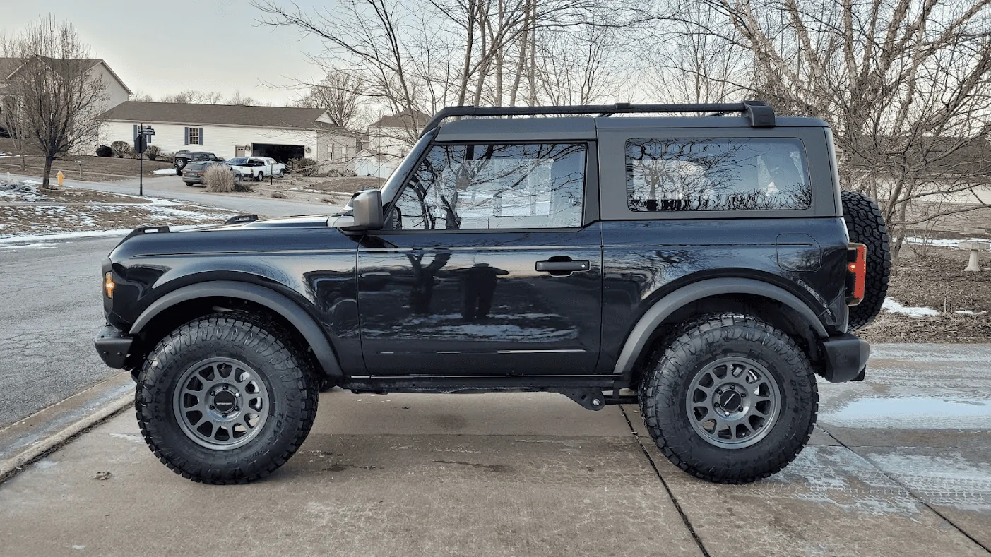

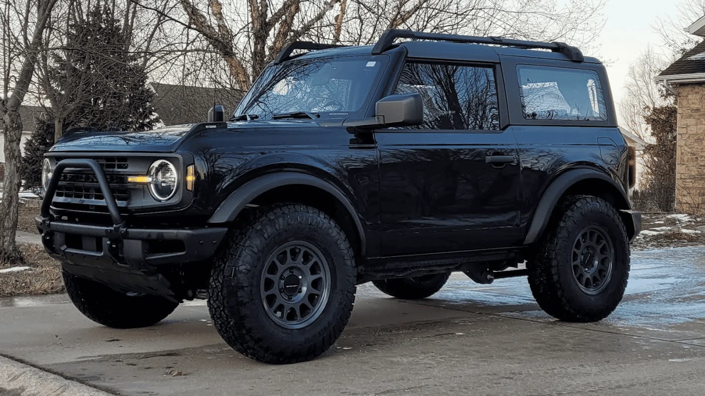

You don't even need a lift for 35's on a Base ... if all the parts are chosen properly.
I have 17 x 8.5 +35mm Methods.
35 x 11.5 - 17 Toyo AT3's ... load range C
NO LIFT on my base Base.
NO RUB in any street driving or any huge speed bumps or other flex I could find.
The 285/75 was my first choice, but the back order was forever ... the 35's became available with no warning, I had to jump. I figure I'd deal with the extra .6" of height.
The 11.5 is about .3" wider than a 285 ... a 1/4 or a 1/3 inch ...

No cutting. These things were built for 35s.
Crash bars have to be removed with over 33" tires, as I understand it. So yes, they are removed. Two bolts per and they slide right out. The bolts were tight as hell though and not enough room to get my big impact in there. Out came the 1/2" drive sockets long bar.
I have the MOD bumper, so the ends needed to come off to gain room for the front two to slide out. If you have the regular front bumper, it needs to be loosened up enough to get out of the way, then re-installed.

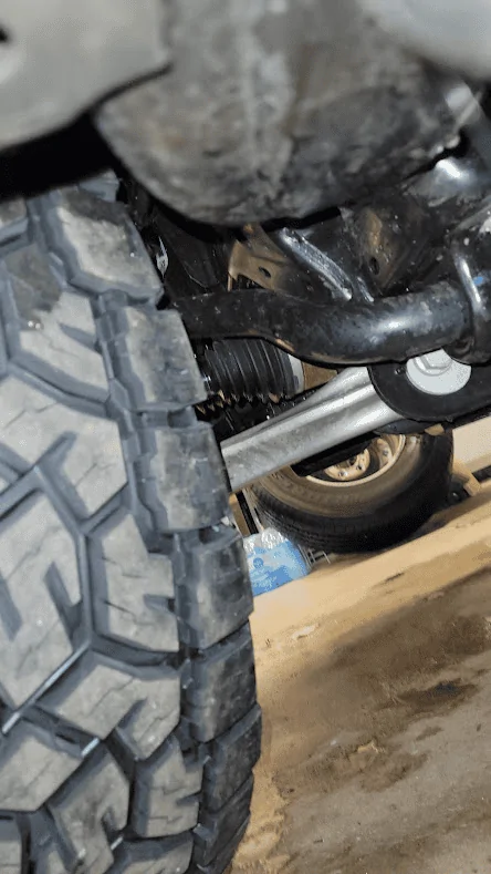

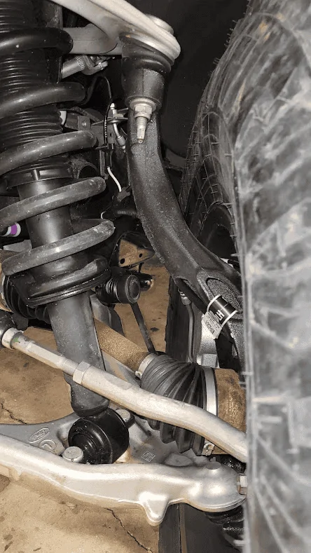

Now, if I were to offroad it and tried to get a tire fully stuffed into the wheel well, there will be rubbing , probably in the wheel well.
As far as wheels, folks have put 35 x 12.5's on factory +55 wheels and there was just a tiny amount of rub on the sway bar at full lock.
My does not rub just sitting. I think I have pics of going lock to lock.
Sway bar visible at the back of the tire in this shot. Full extension...

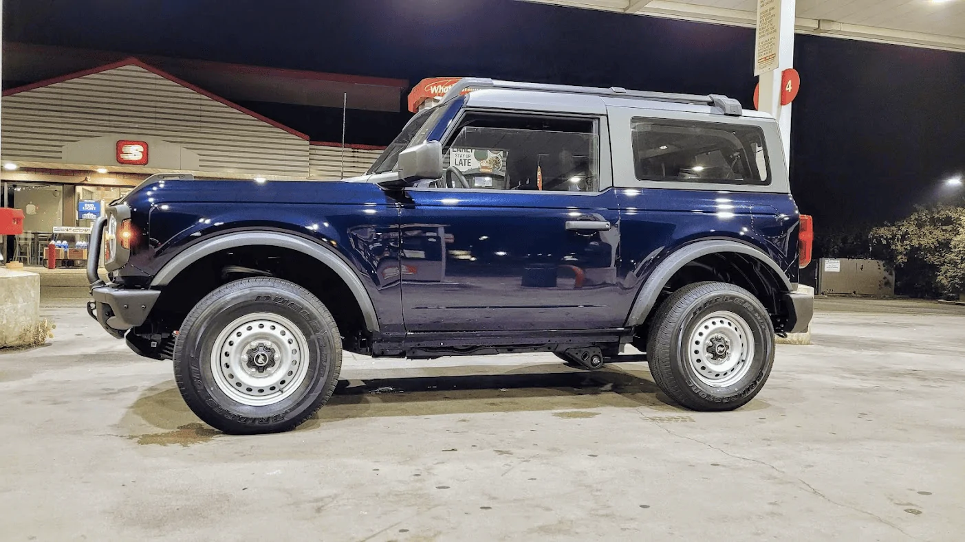

Ford Bronco 34"s the perfect size? 1645368487567
At ride height:
Ford Bronco 34"s the perfect size? 1645368591474

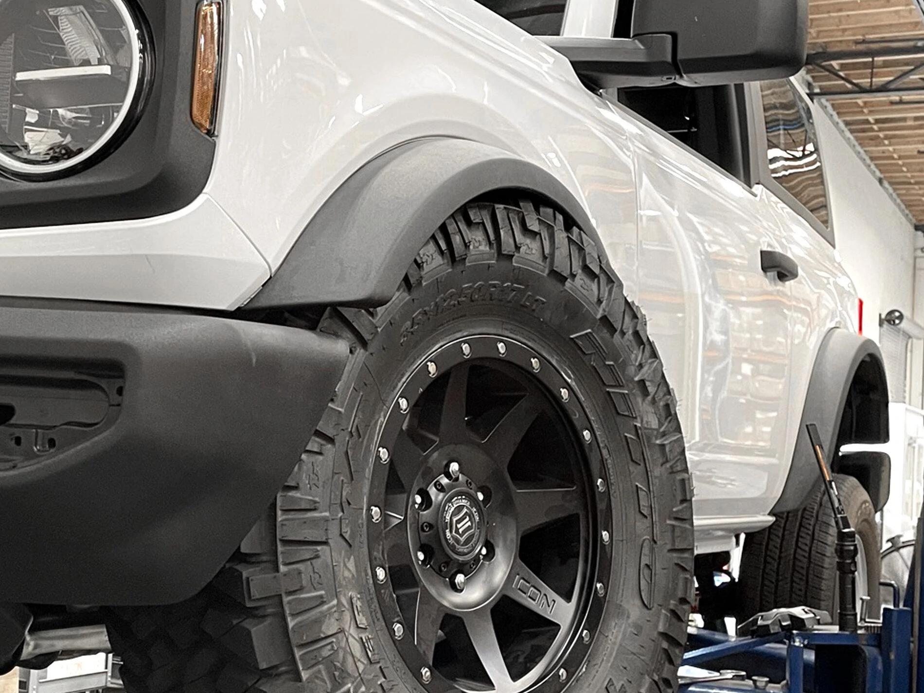

If I were to lift it, I'd probably go with the ICON 3" lift and level spacer type lift. They did their homework and figured out what is needed to get a no rub, full stuff install.
... or I'd go new coil overs kit. Ford is supposed to have a Fox kit coming.
Great thread here.... I love this pic and how they planned it.
Photo below shows the kit installed on a 2-door Base Bronco, non-Sasquatch, at full suspension compression (the coil springs were removed from the struts to allow full compression while checking clearance). The Bronco in the photo was equipped with 35x12.50-17LT Nitto Trail Grapplers mounted on ICON Alloys 17X8.5 Rebound wheels with 25mm offset. With this combination the tires tuck cleanly into the non-Sasquatch flares at full compression, with no rubbing and full steering range.

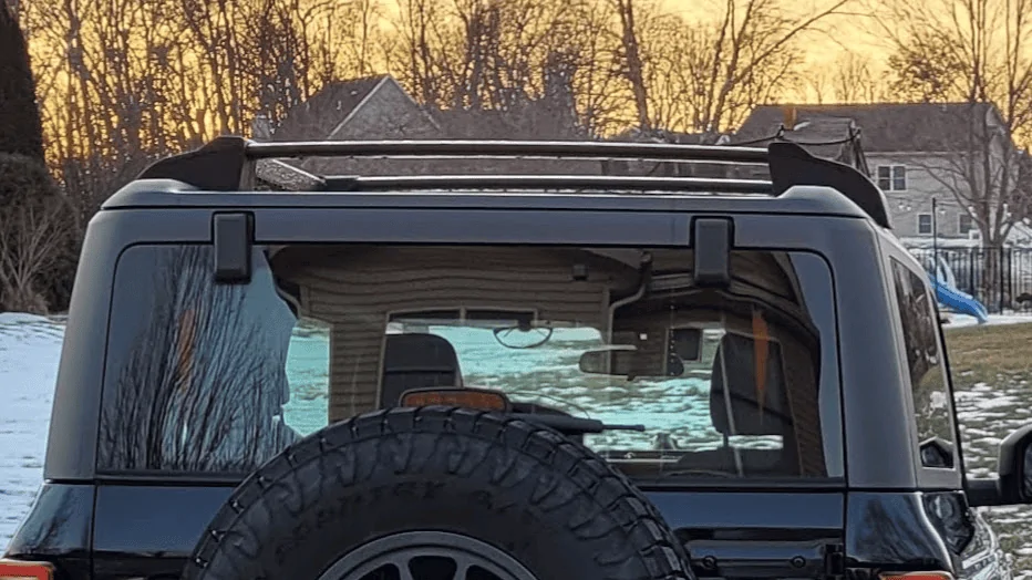

Last question: did you need a brake light extender or anything like that for the spare tire?

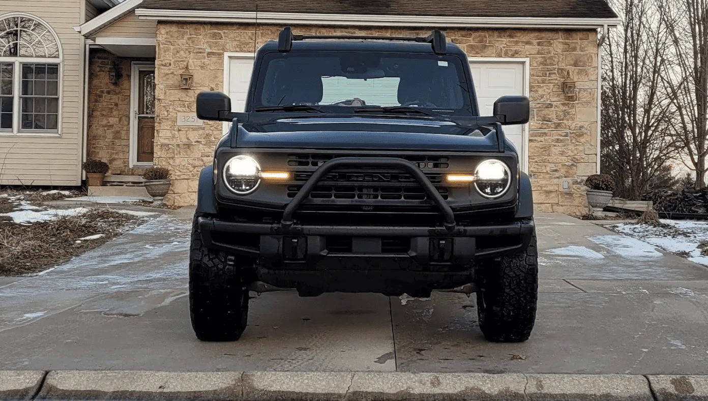

I do need one mainly because the brake light is probably mostly blocked (shadowed) by the new 35.... but the 35 JUST barely kissed the brake light when I put it on the mount.
I need to get a better pic, you're not the first to ask. What may be key is that, due to the offset and tire width, the inner sidewall is within 4/100ths of the factory 255, 30" tire. It a bunch taller though.
