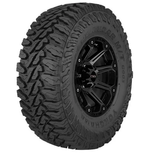

has anybody looked at or thought about the Yokohama Geo MT's. they are available in 285/75 R17. the aggressive tread looks damn good to me
Ford Bronco 34"s the perfect size? Yokohama Geolander M-T LT 285-75-R17
