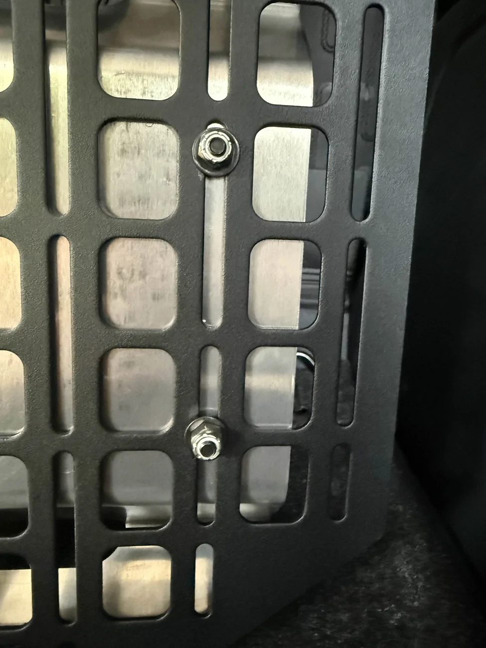

Hey everyone. I'd been looking for a while for a solution to hauling around a 30lbs propane tank. I had to kind of think outside the box here and this is what I came up with.
PARTS:
1 - Built Right Molle panel https://builtrightind.com/products/...nel-system-ford-bronco?variant=46279917568214
2 - Ace Manufacturing 30lbs propane tank bracket https://utsparts.com/products/metal...f3nDoNuAMLVjugf7F4o4oUdyp5EyPzIvkSX1zeDRZlvZw

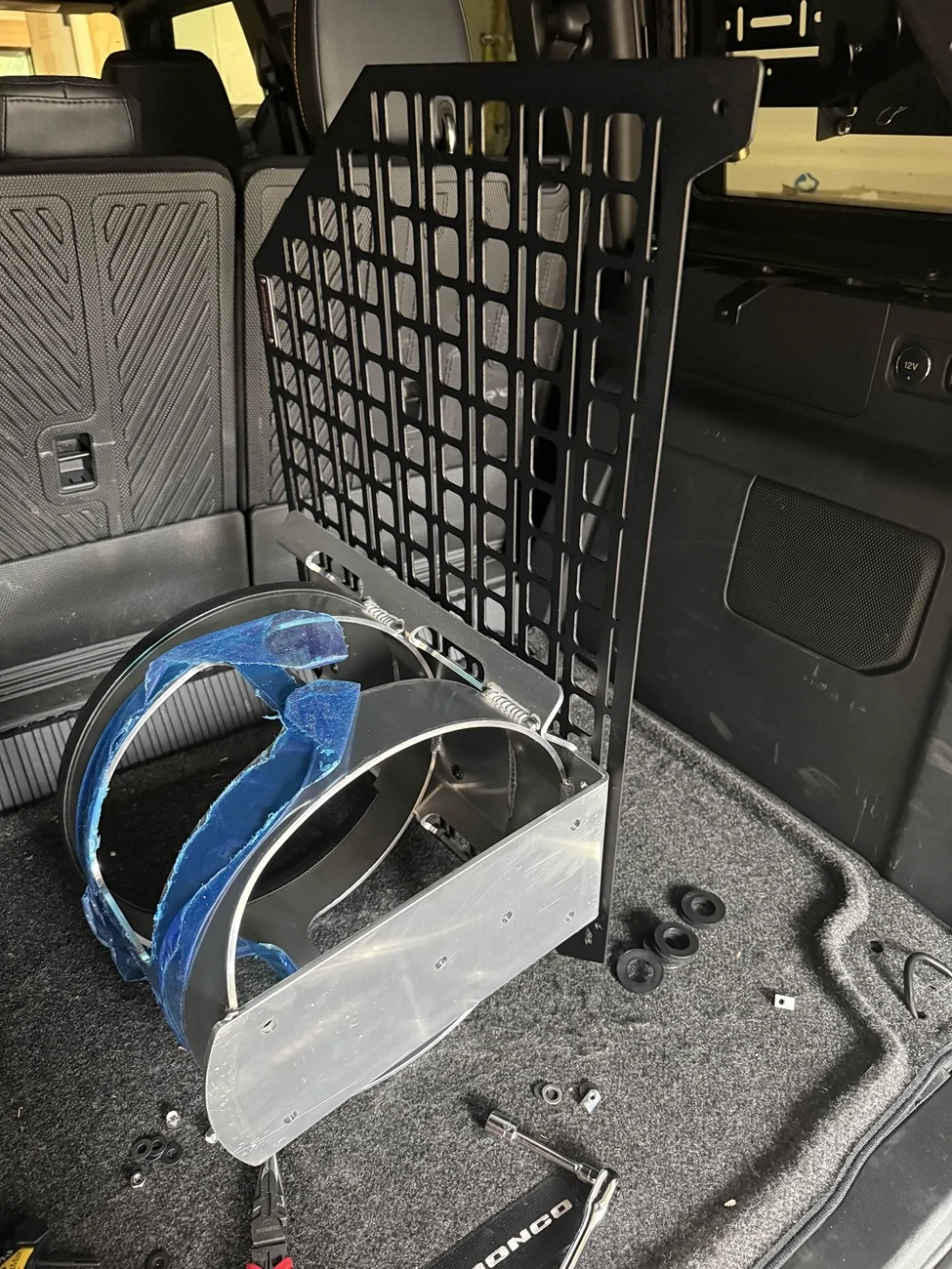

Let's start off with the propane tank beside the panel. Needed to see where it would line up best.
Ford Bronco 30lbs Propane Tank Mount (PICS INSIDE) IMG_6299

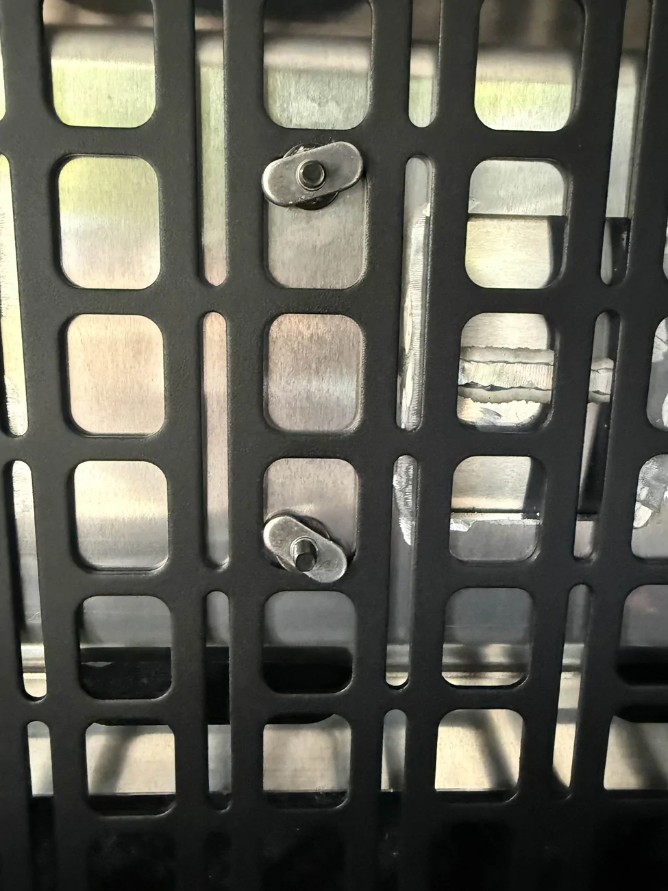

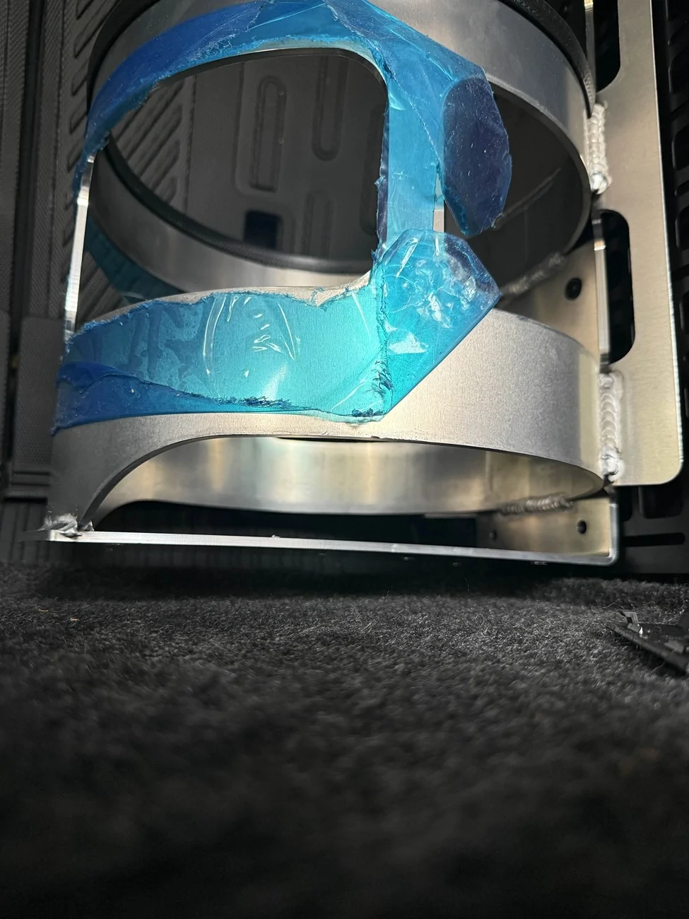

After that we had to get creative with the mounting hardware as it lines up almost perfect however it's best if you have some spaces and washers etc.. The side are pinned against each other oppositely so they really can't move.
Ford Bronco 30lbs Propane Tank Mount (PICS INSIDE) IMG_6302
Ford Bronco 30lbs Propane Tank Mount (PICS INSIDE) IMG_6301

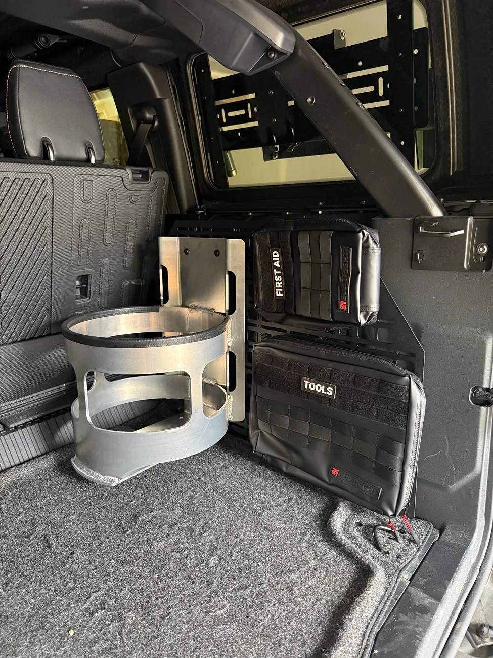

The Built Right Molle panel allows this tank to hover just slightly above the cargo liner bump out for a near perfect fit.
Ford Bronco 30lbs Propane Tank Mount (PICS INSIDE) IMG_6310

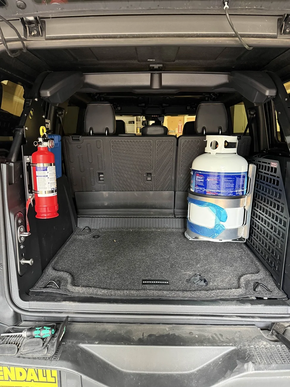

Finally we have the finished product.
Ford Bronco 30lbs Propane Tank Mount (PICS INSIDE) IMG_6314
Ford Bronco 30lbs Propane Tank Mount (PICS INSIDE) IMG_6313
The fit and placement is perfect while being extremely sturdy. Perfect solution for what I was looking for.
