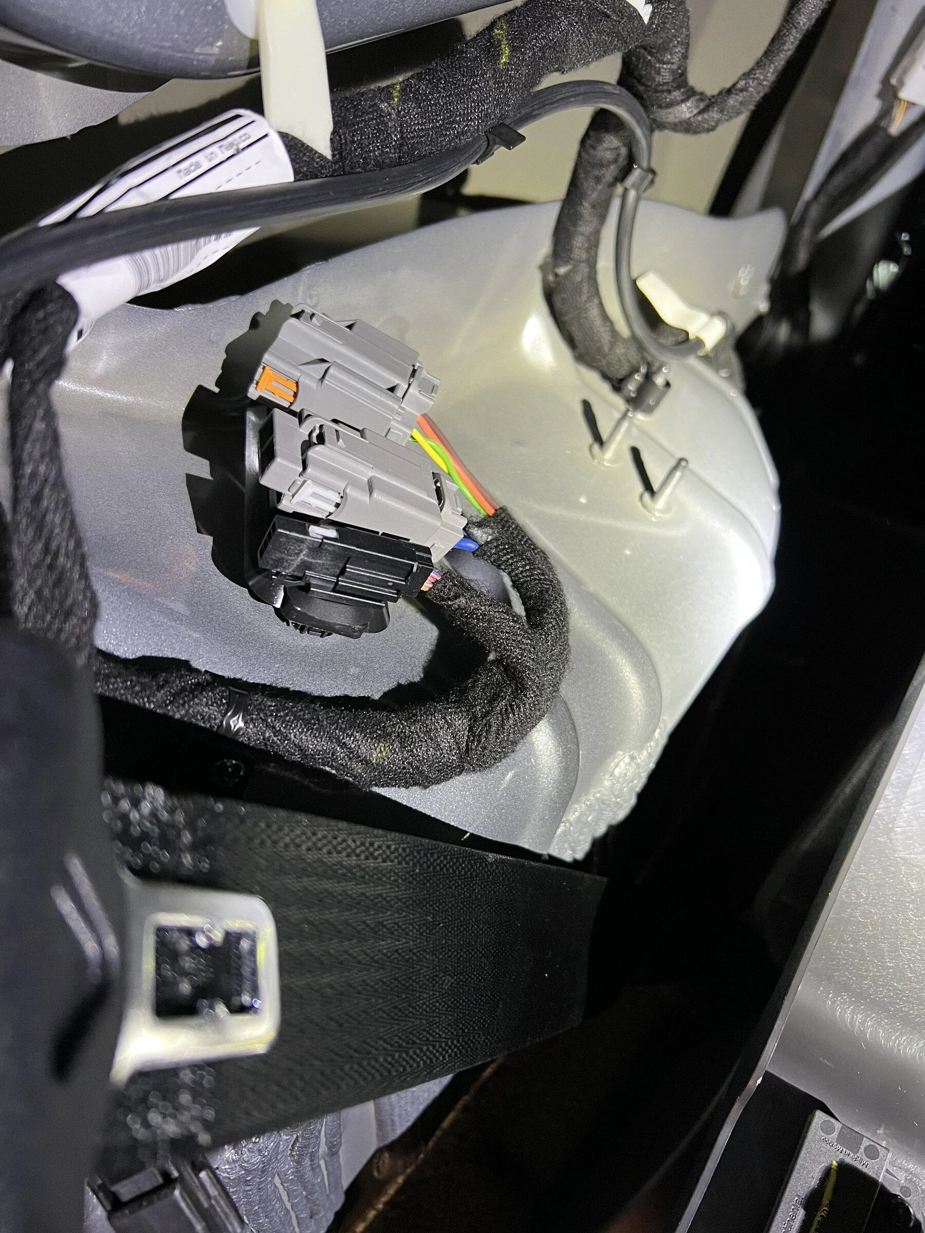

3 unused harnesses behind trim panels.

I'm sure they run the same wiring loom's for all vehicles. You bought a base model, so I'm sure there are options that are available that you do not have. Just a guess though...
I think the OP understands that... He wants to know what they're for.
Gonna guess Lux audio sub/amp? 🤷

trailer/hitch wiring. The lux audio gear is mounted in the passenger side

OK, I'll make it easy. Those are the 3 connectors that would plug into the trailer control module if you had factory tow. One is network, the one with two blue wires is 12V+ and the other has a park light signal wire and something else.
So is there a possibility of a more simple plug and play harness if you didn’t get tow from factory? I know there’s a kit out now but I wouldn’t necessarily call it plug and play. That would be nice to just plug in there for people that didn’t get the tow package.
I think the Base vehicle guys are hosed based on some of the feedback from folks looking for these. You can still add tow but have to run the power wire for the tail light converter to the battery instead of picking it up at this connector.
