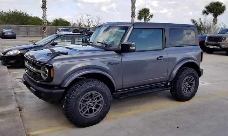

Ford Bronco 24 OBX tire wheel upgrade 20211205_115526
Stock OBX non-sasquatch suspension with the 295/70R17 Milestar Patagonia M/T's on the RTR Tech 6 17x9 +30 offset.

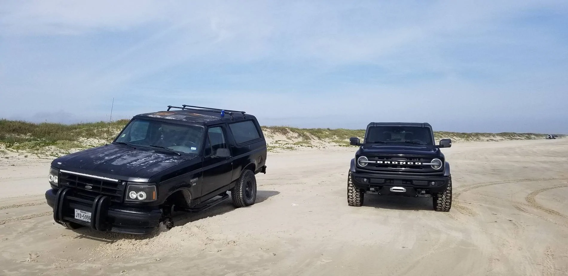

Ford Bronco 24 OBX tire wheel upgrade IMG_20220910_181155
One day after delivery. LOL.

Nice looking set up! Not sure why the dealer’s custom set up department said to go with the zero offset. They do a lot of Broncos and 150’s. I know the poke creates draft which kills mileage
I agree about the tire weight.

They are probably thinking that it's needed to clear the crash bars or the UCA, but it's not. I had no rubbing with the factory suspension at all. Strangely enough, RTR recommended me the +30 offset and I am very happy with it.
