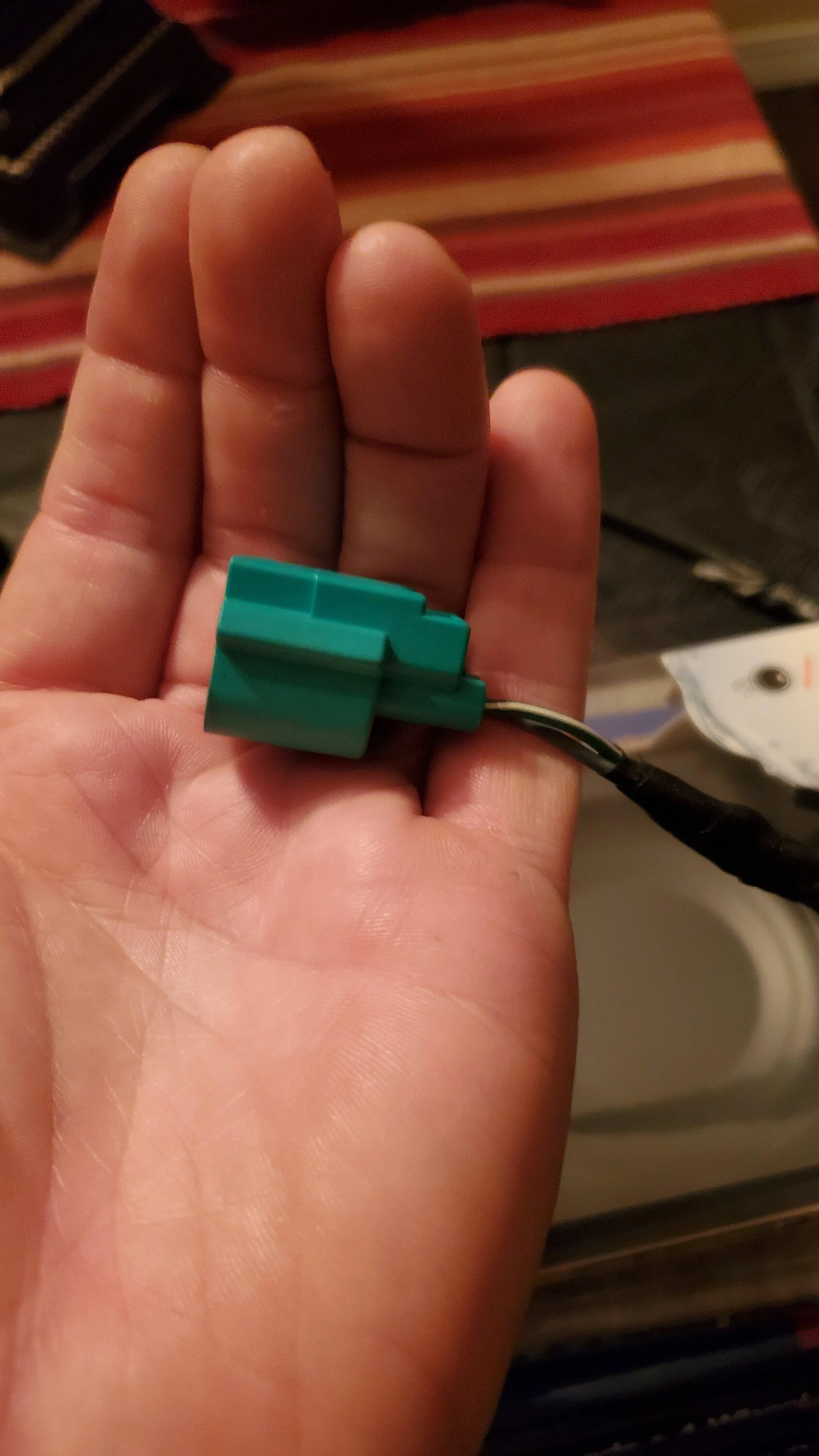

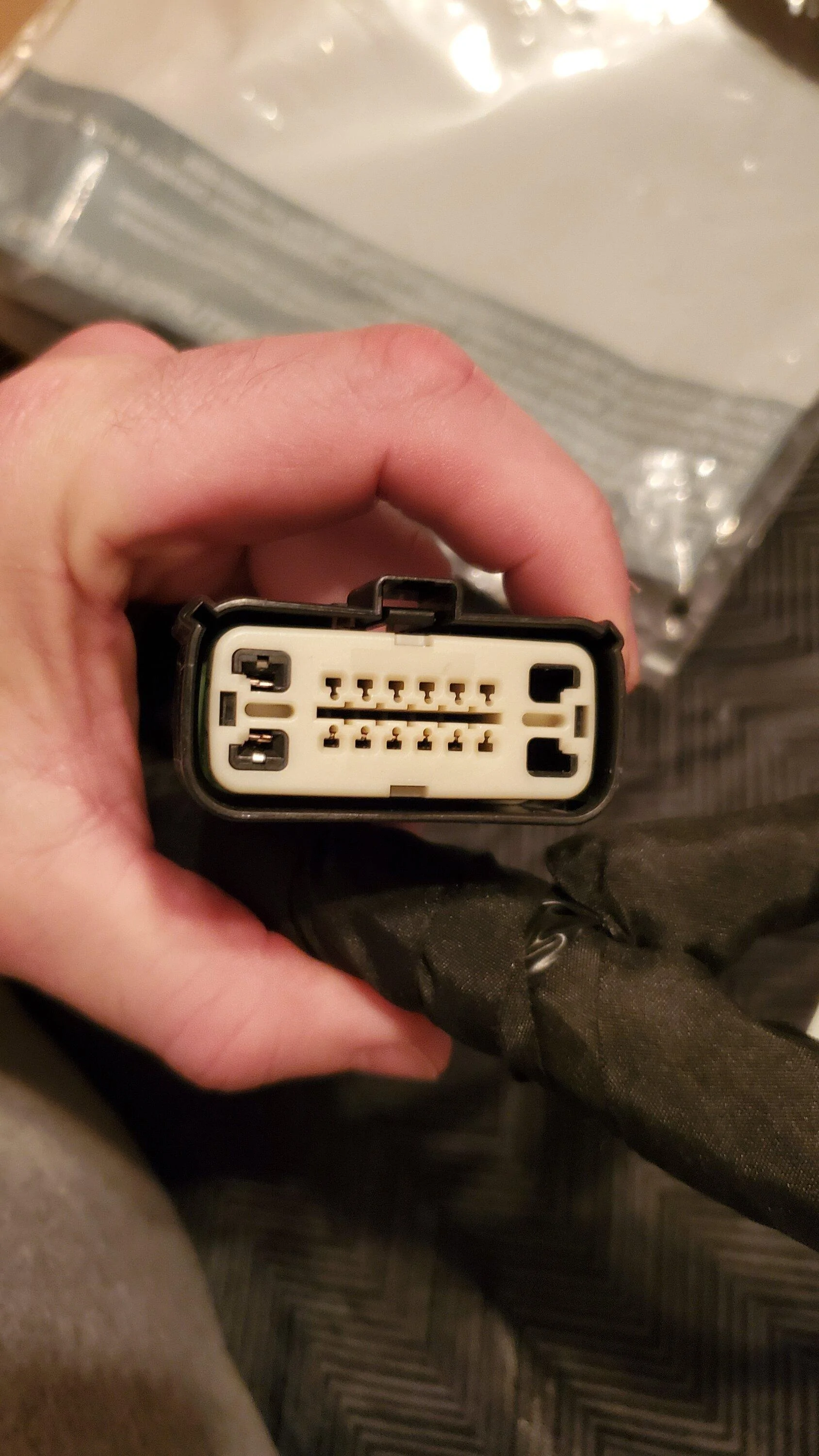

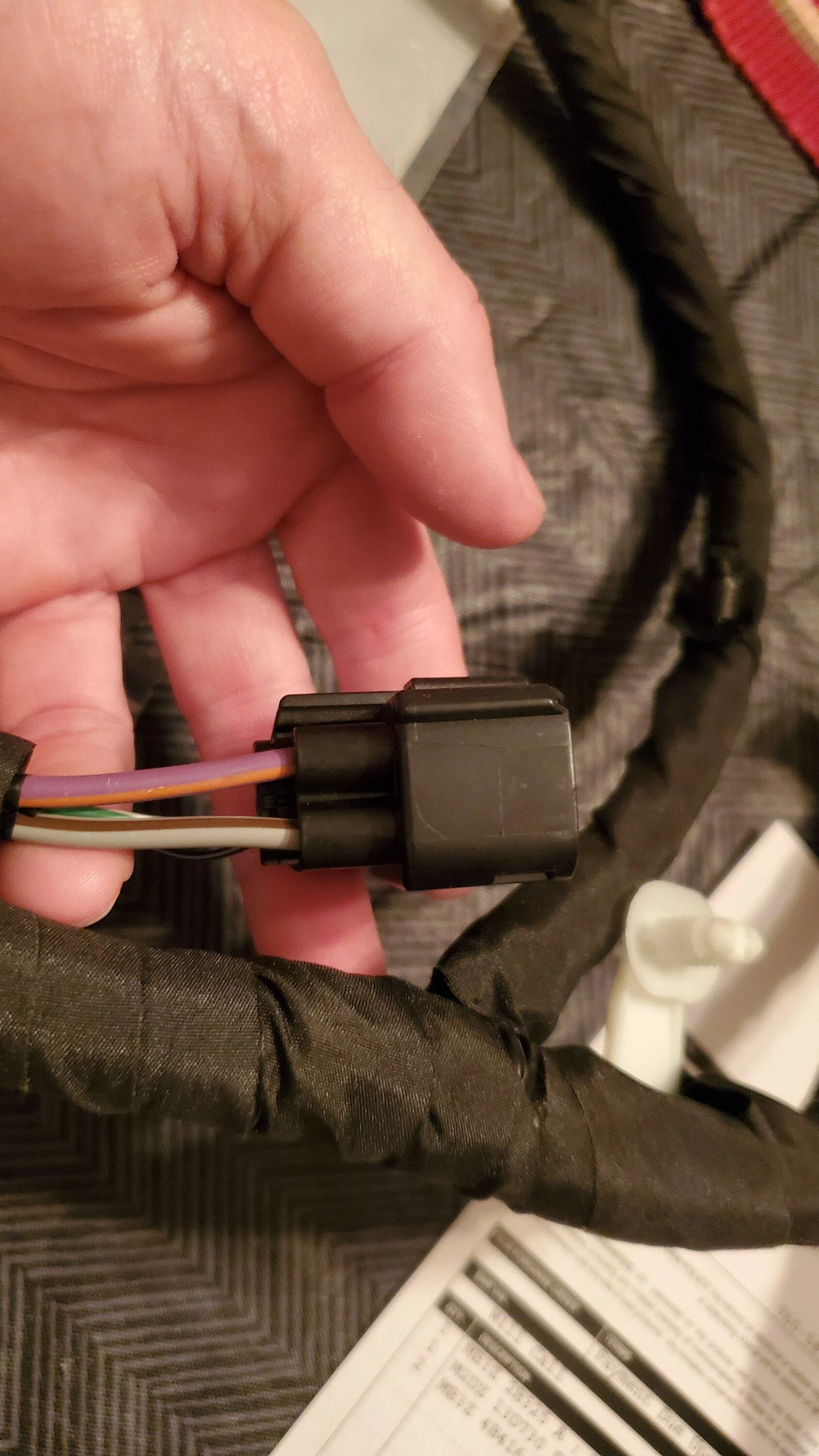

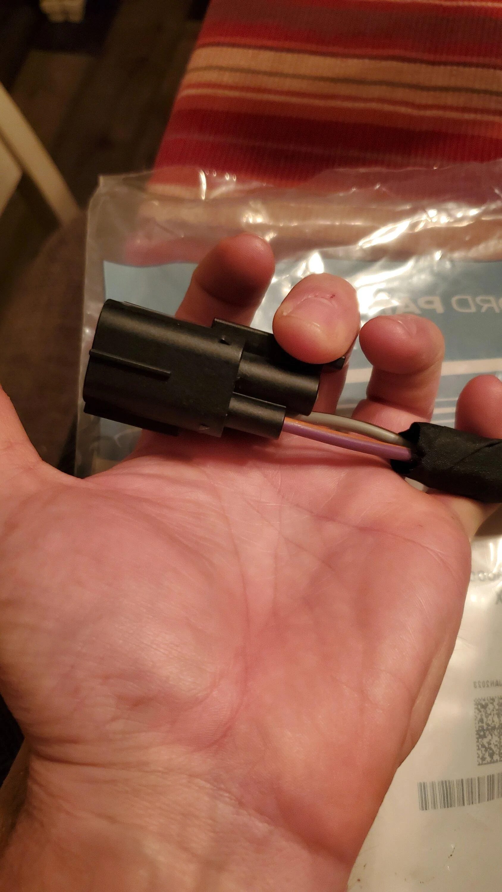

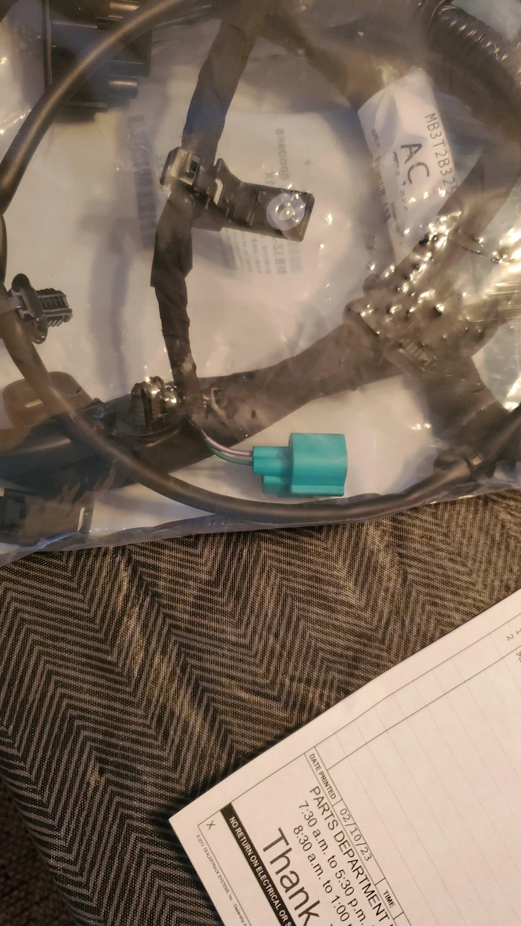

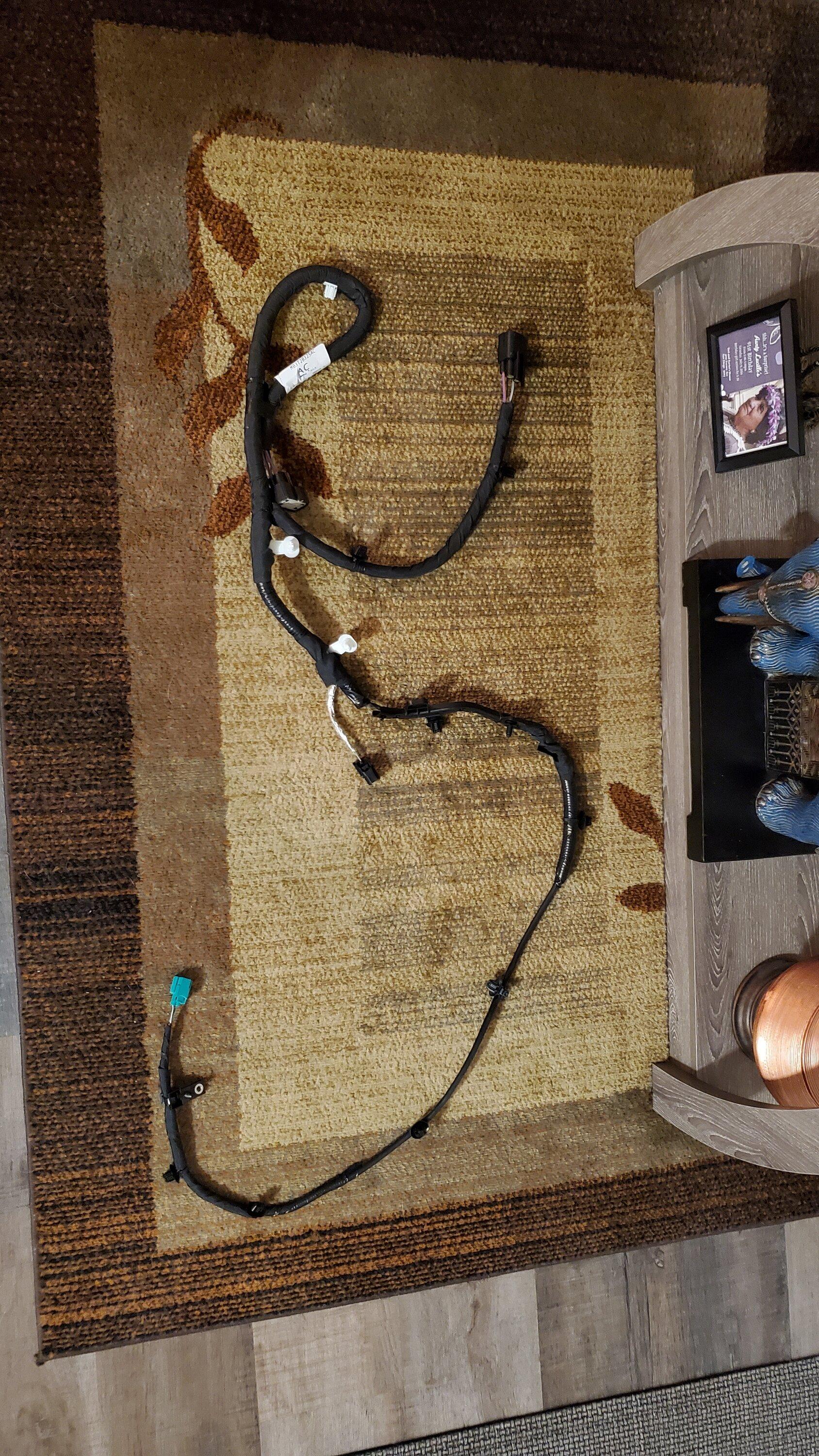

Like you linked above, I'm in the process. I got the harness and the hero switch, want one without swaybar disconnect. I'm hoping flip comes through on that one. I'm thinking Forscan will be all we need and the values from like vehicle but with Sasquatch package.
Here is the harness I bought.
Here's the locker connection.
I just need to figure out which harness this harness replaces and swap them. Hopefully it all comes together like it was done at the factory.
could you send me some more pictures of the vehicle side of the harness? I can look on my black Diamond today, according to the wiring diagrams the FAD and the lockers are controlled from the awd Module. Worse case I can trace the fad wiring back looking for a connector or maybe even at the awd module itself.

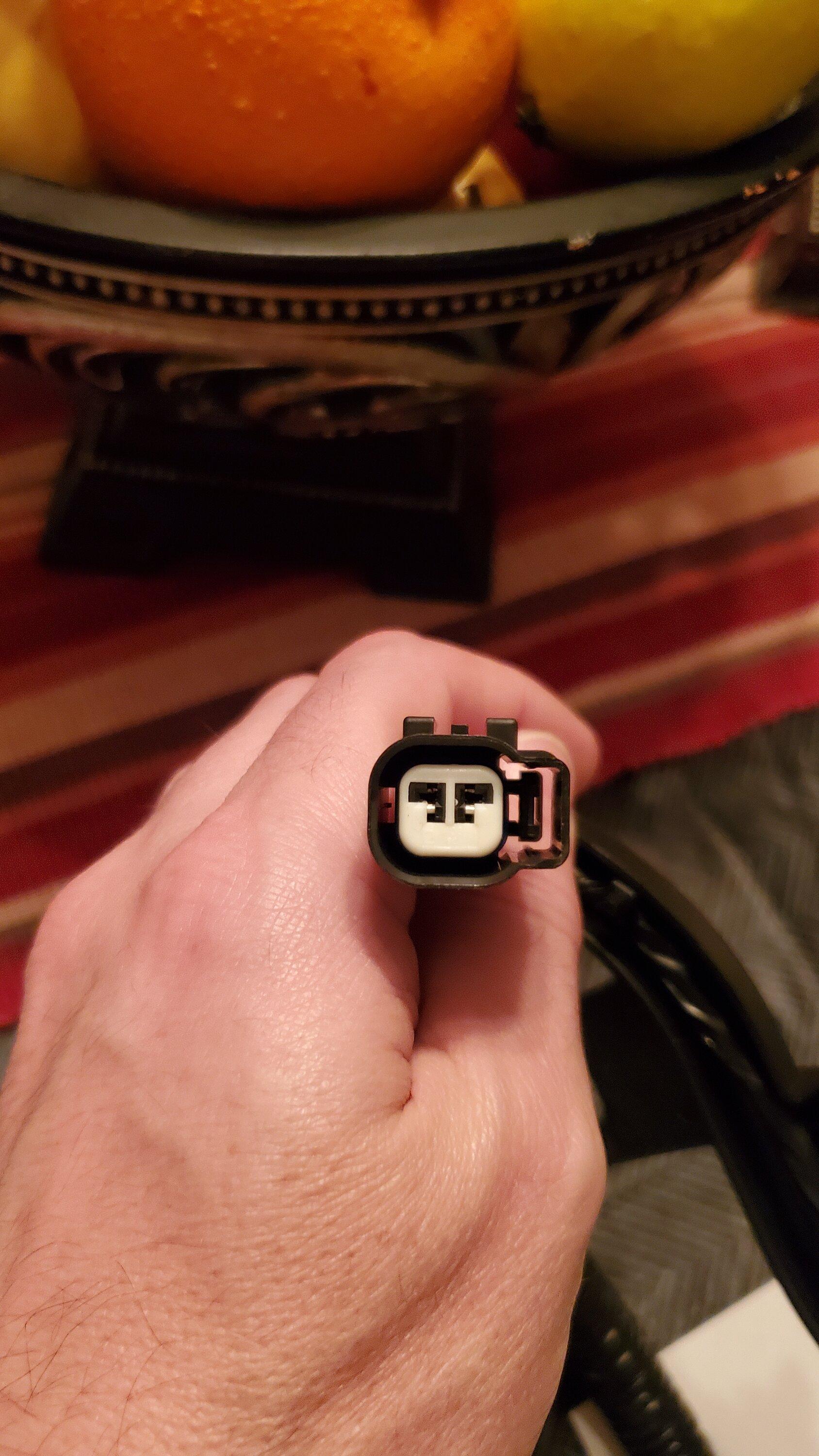

Oh sorry, I meant the harness you have, just the side that would go to the truck and not the locker side. The pigtail I started with was different and just 2 bare wires. I can't find connector diagrams in the schematics and wiring diagrams to see if it's a seperate plug or if they all come into one and it just needs pinned in the correct spot.

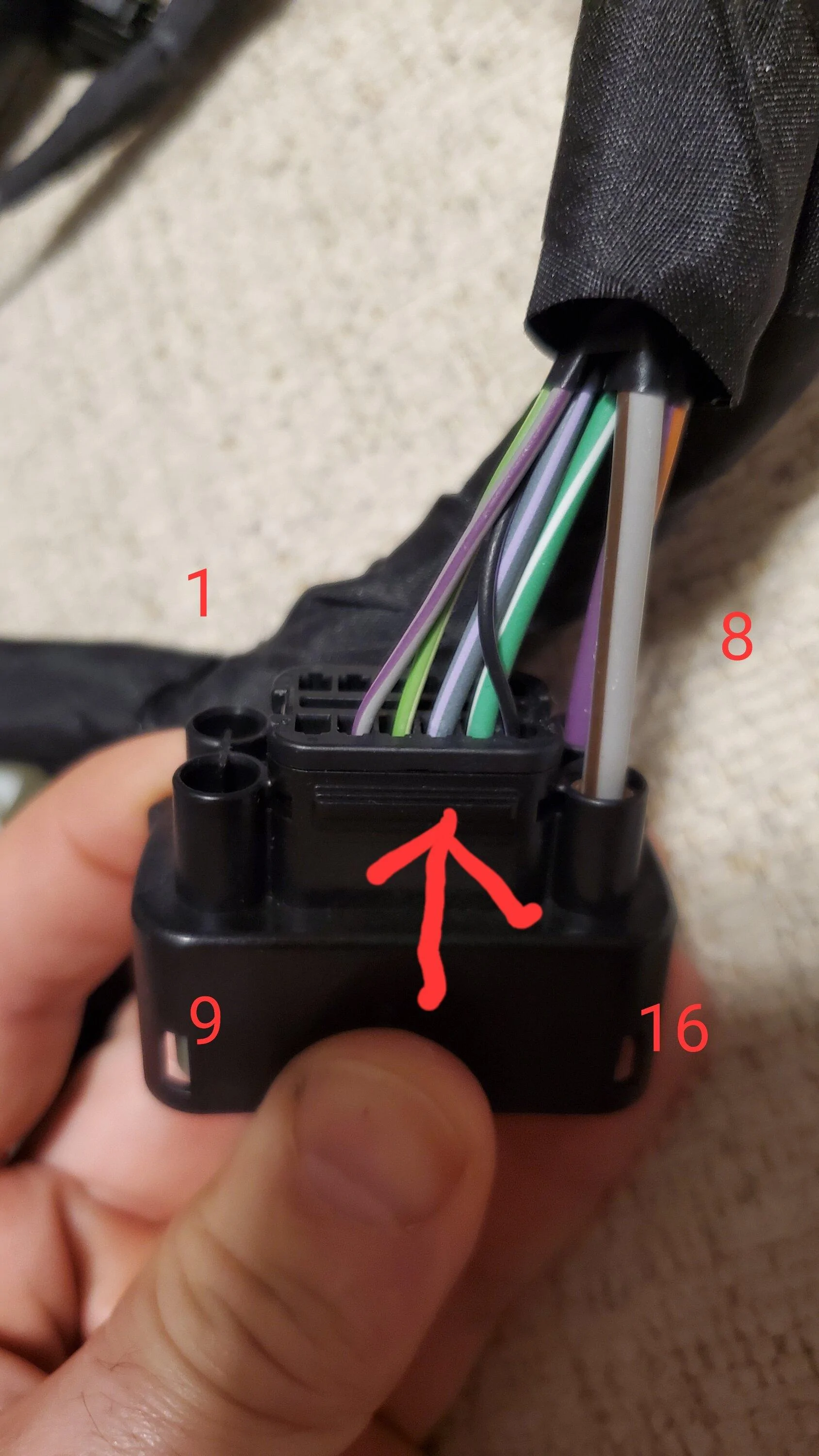

and yea I'm not looking forward to doing it again..

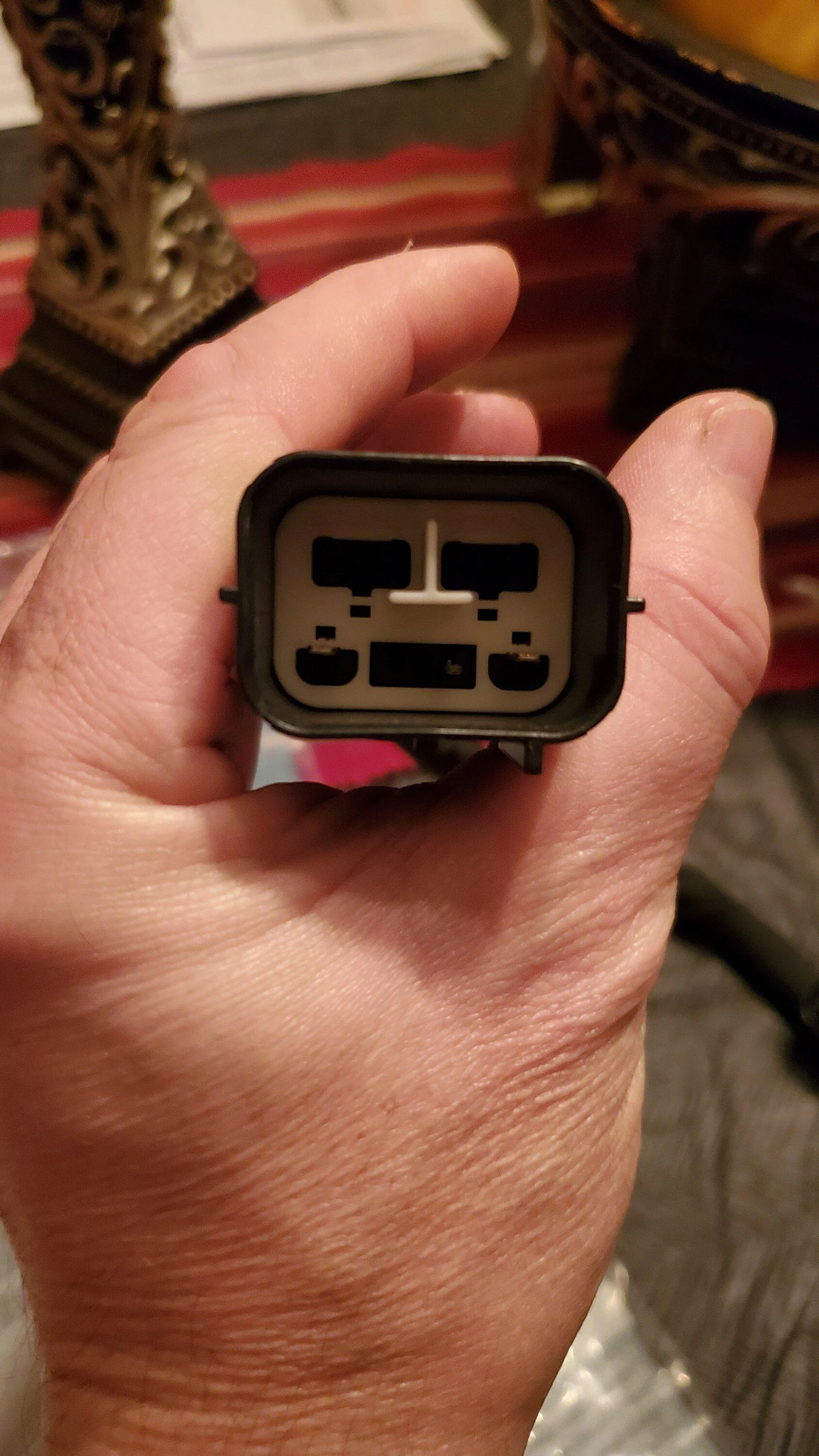

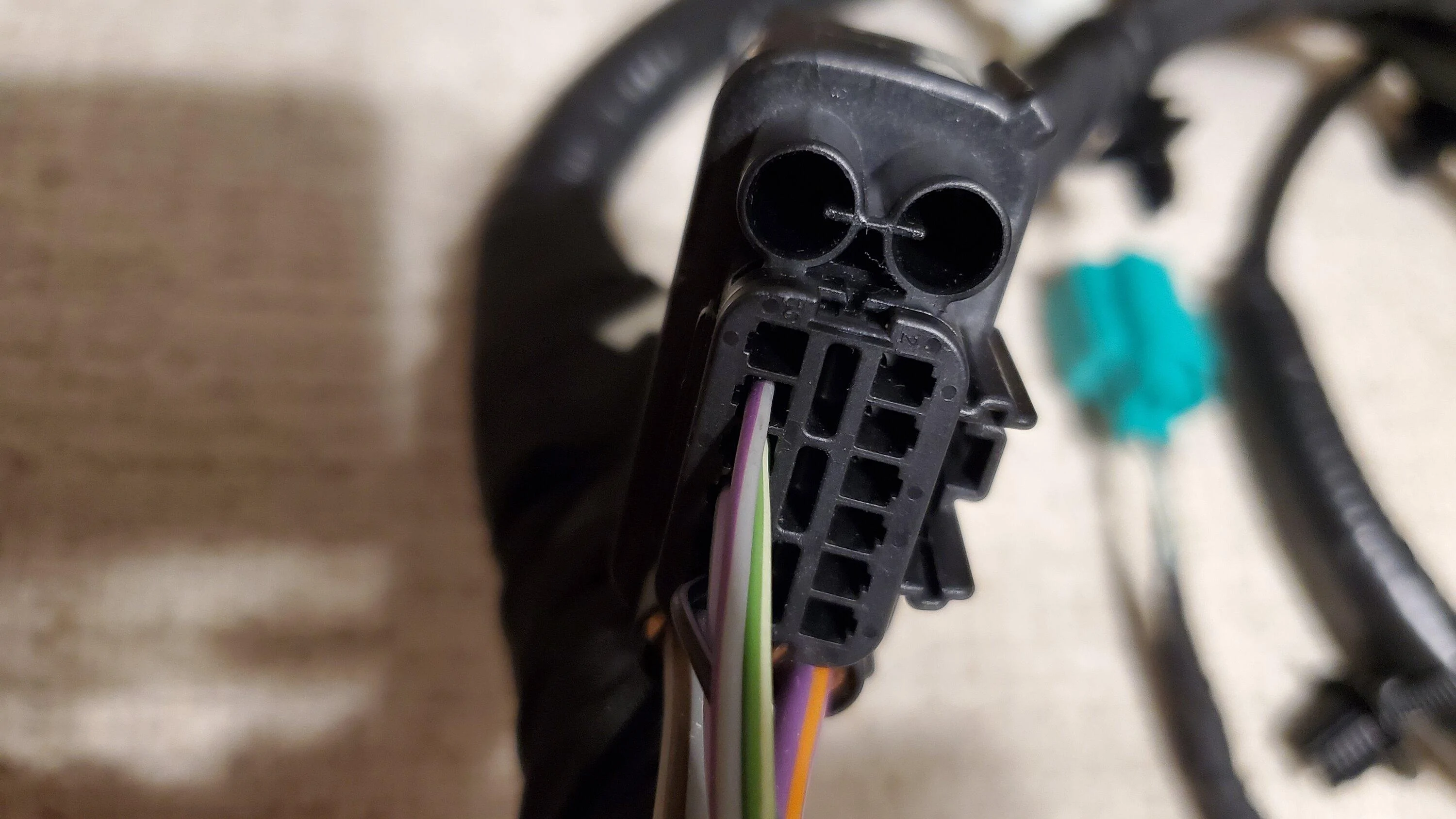

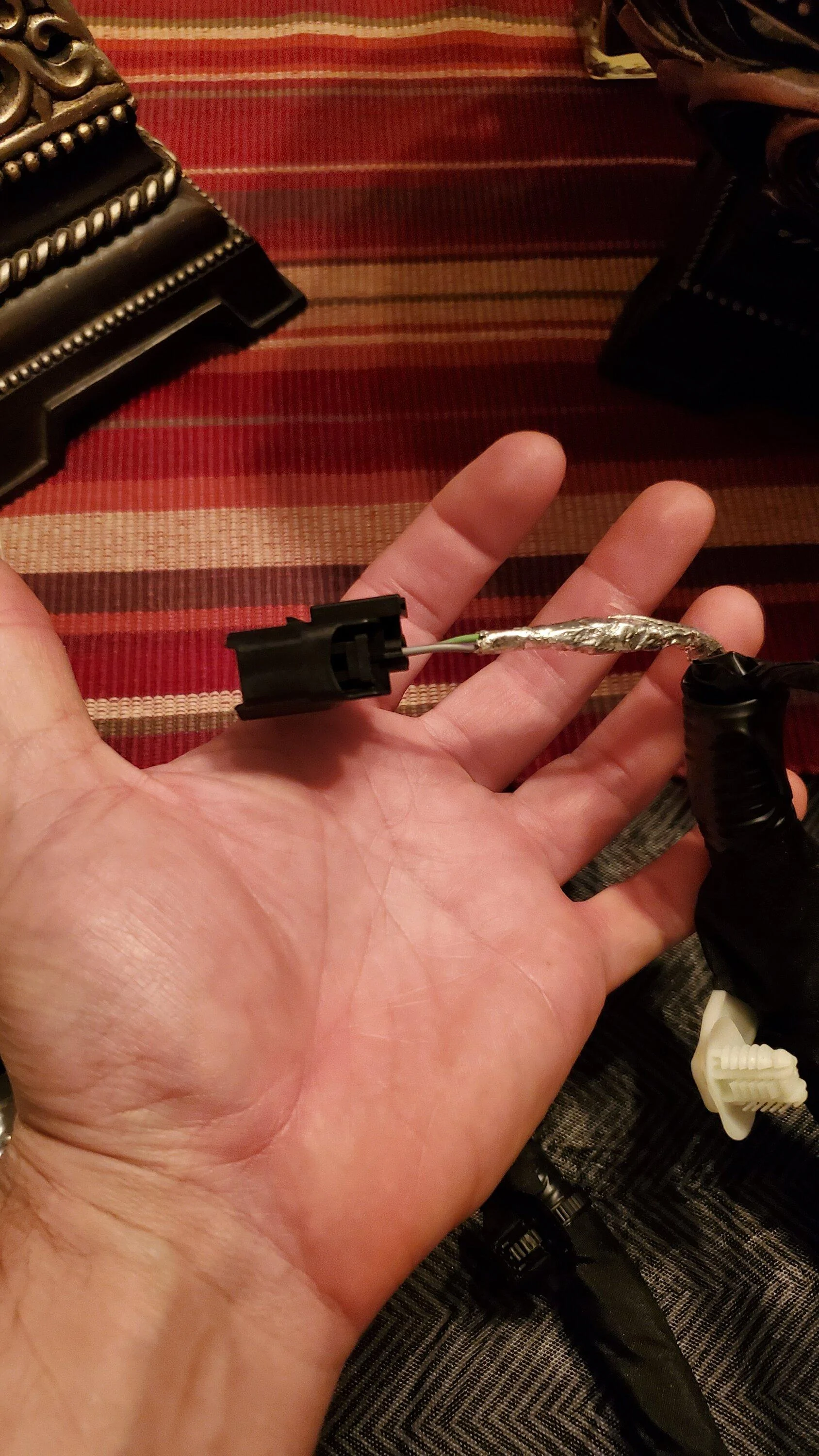

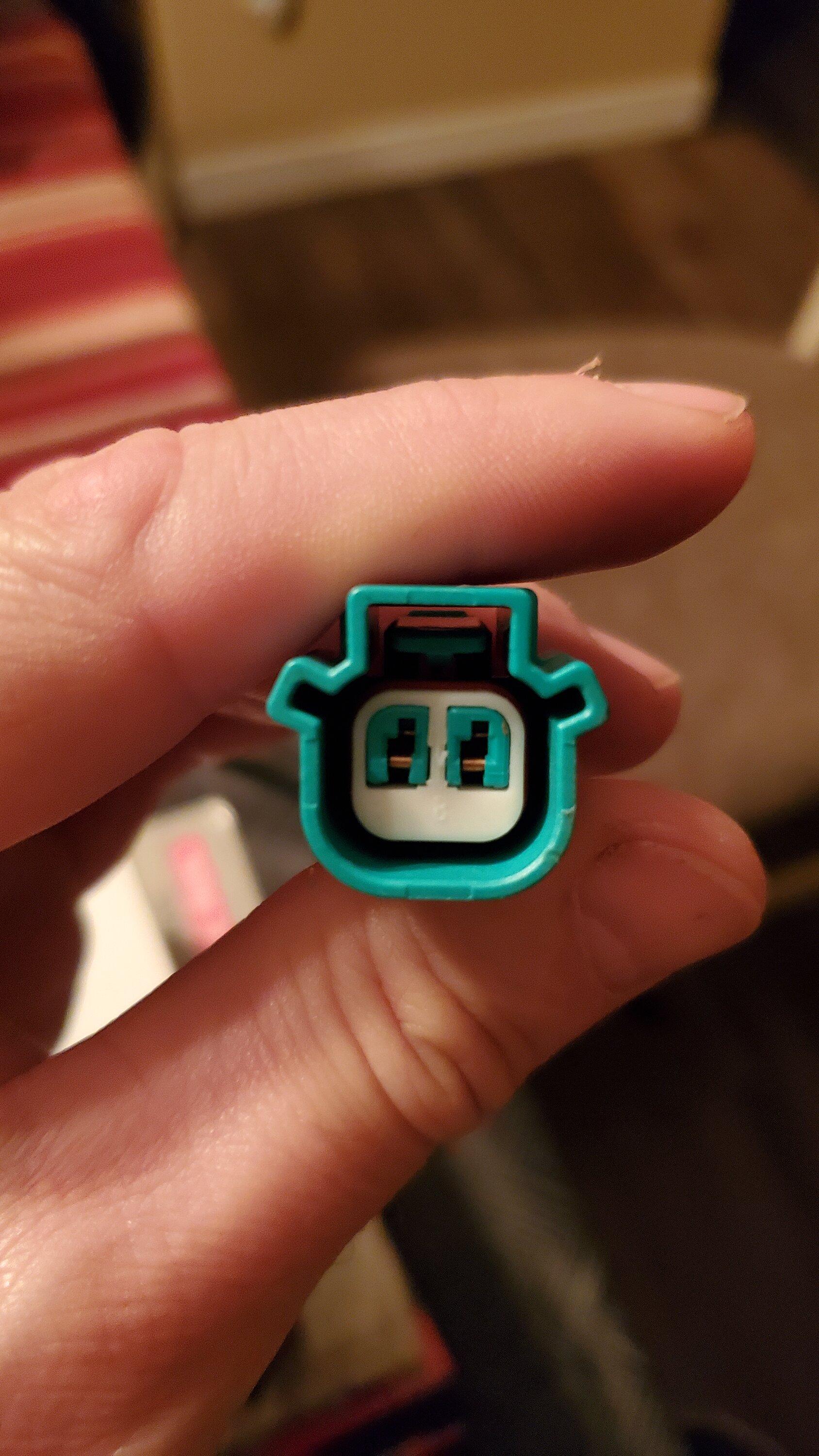

Here you go...
Locker:
Ford Bronco 210 drive unit swap from 190 20230213_044635
Ford Bronco 210 drive unit swap from 190 20230213_044640
2nd Connector:
Ford Bronco 210 drive unit swap from 190 20230213_044653
Ford Bronco 210 drive unit swap from 190 20230213_044658
3rd Connector:
Ford Bronco 210 drive unit swap from 190 20230213_044713
Ford Bronco 210 drive unit swap from 190 20230213_044717
Body Side Connector:
Ford Bronco 210 drive unit swap from 190 20230213_044725
Ford Bronco 210 drive unit swap from 190 20230213_044730
Overall Veiw:
Ford Bronco 210 drive unit swap from 190 20230213_044826
Pin 1 at locker goes to Pin 14 on body side Connector, and Pin 2 goes to Pin 13:
Ford Bronco 210 drive unit swap from 190 20230213_050028
Ford Bronco 210 drive unit swap from 190 20230213_050139

Here you go...
Locker:
2nd Connector:
3rd Connector:
Overall Veiw:
Right on, that's gotta be the right harness to make this work. Nice find and thanks for labeling that out. I wonder if that second connector is for a Sway bar disconnect or something, it almost looks like the connector I disconnected from the fad and the placement looks right but there shouldn't be a fad on any m210
