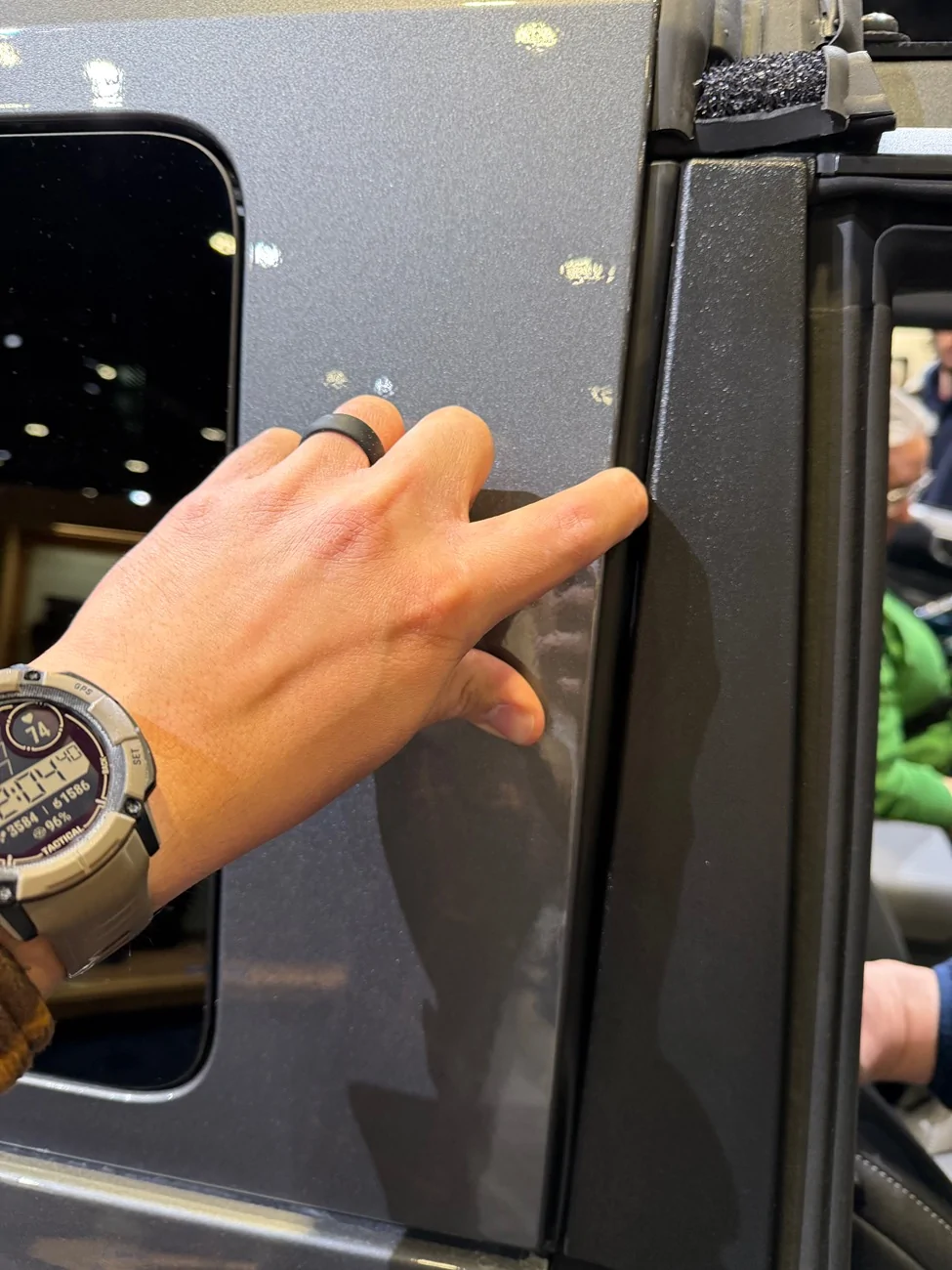

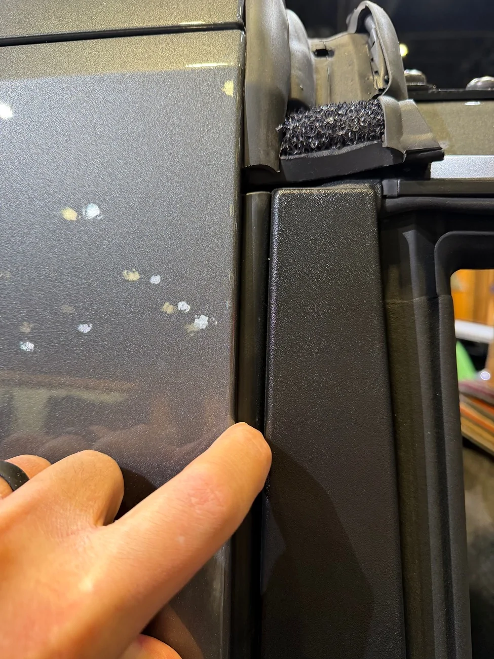

Greetings all,
I was at the Chicago auto show and I noticed something new on the 2 door hardtop. Wondering if this is new for the 2026 MY.
There is a rubber seal/weatherstrip in the gap between the hardtop and B-pillar trim.
I have a 2023 2 door and do not have this rubber seal/weatherstrip. Just an open gap. When I wash my truck I sometimes get water inside from this area. I stuff paper towels in there when I wash it and it prevents the water from shooting in.
I would like to add this on mine. I was planning on buying some kind of generic weather strip on Amazon to stick on there but if Ford has a specific part for it that would be preferable.
Wondering if anyone has any info on this. Hopefully a part #. I have been searching but haven’t found it yet.
Thanks!

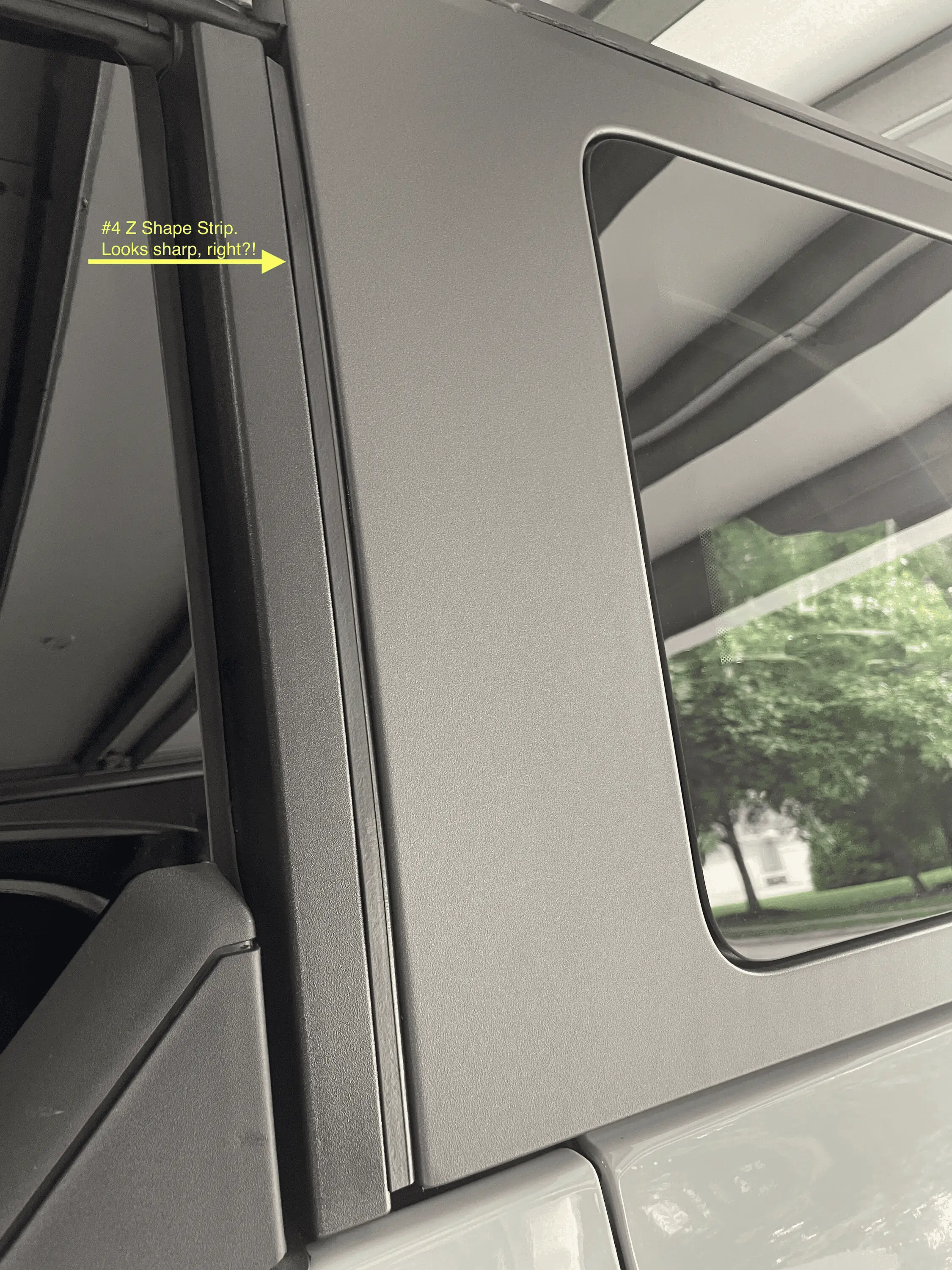

I saw your video with the foam. When you did the permanent mod with the rubber seal did you remove the foam or put the seal on top? Did you have to remove the clamshell to put the seal on?
I did the z-strip rubber seal on my MY'22 Black Diamond. It required me to unbolt and scooch the rear clamshell back about 8 inches leaving it resting on the chassis sill. At the time, there was other weatherstripping suggestions that I also affixed at that time.
I would suggest loading up the Amazon cart with all the weatherstrip suggestions and then affix all while you have the top unbolted so you don't have to keep doing it for every fix/suggestion.

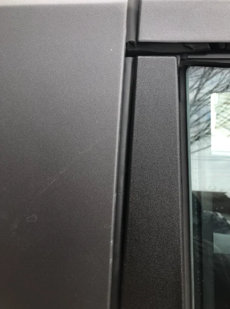

It must have been a change starting with the '24 model, as my '24 has this seal.
Ford Bronco 2026 2 door Hardtop Screenshot 2026-02-09 11.33.06 AM
GA2Dr
Feb 19, 2025
372
413
Marietta, GA
2024 Bronco 2 DR 2.7
I have a '24 Black Diamond with no seal there
