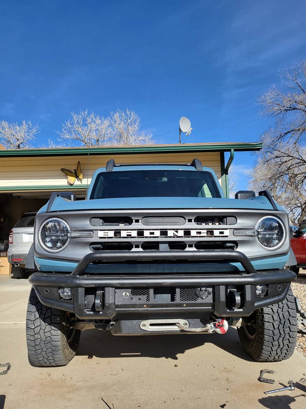

Originally I just had a 4 wire flat so it just kinda dangled in the intercooler opening. Now I have a 6 wire and an after market bumper. The six wire fit nicely into a parking sensor hole I didn't need. I also mounted my breakaway in an unused sensor hole, Were I mounting in a standard bumper and unable to use a sensor hole I would probably mount both in a piece of angle bolted into the intercooler opening.
Ford Bronco 2025 Outer banks saskwatch  TOAD 20240101_125325

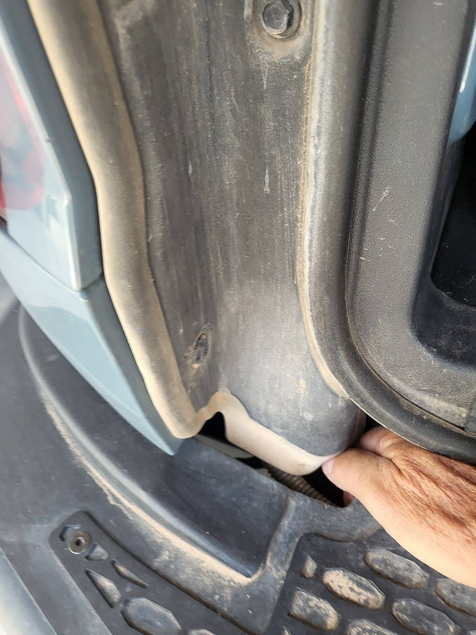

You don't have to remove the lights, just the black plastic access covers. Two ?? bolts and 4 PITA push pins each. Your wire come up from below. I used the Curt plug in harness.
Ford Bronco 2025 Outer banks saskwatch  TOAD 20250517_110629
I have a hold of the wire loom here

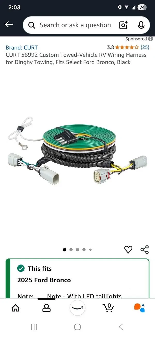

You talking about this setup? It works with red stop and yellow turn signal led lights? Or will the motorhome just use the red stop lights as the blinkers also on the bronco cause only 4 wires.
Kinda. Curt makes two. One for Broncos with LED and one for those without, mine was without.

Ok I have led lights red brake yellow turn signal i just don't want to hit the brakes on motorhome and yellow lights up for stop i will reach out to curt on Monday won't bother you anymore! Thanks again.
