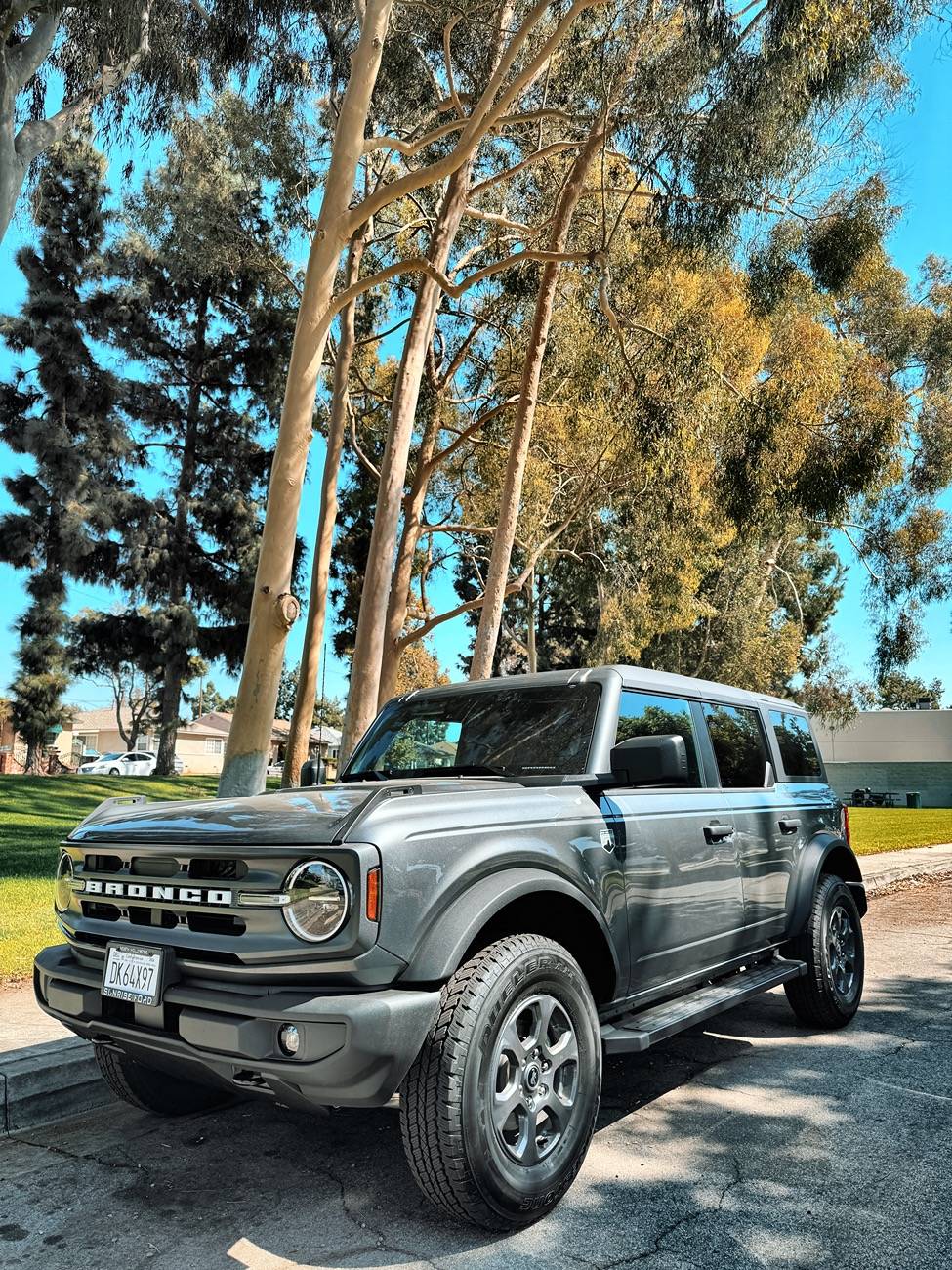

I recently purchased my bronco with hard top! Im curious is there a way to buy the soft top separately and swap it?
