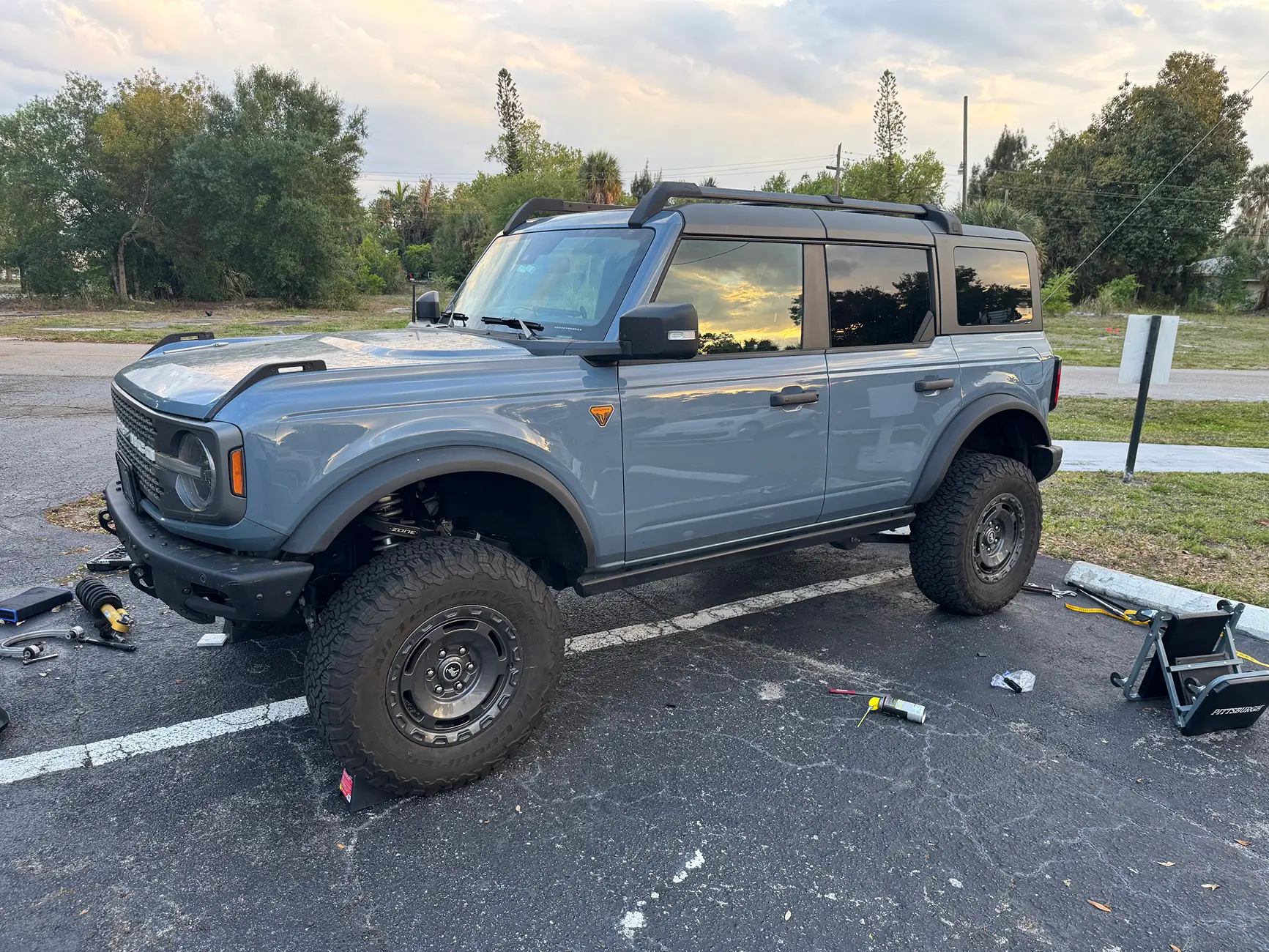

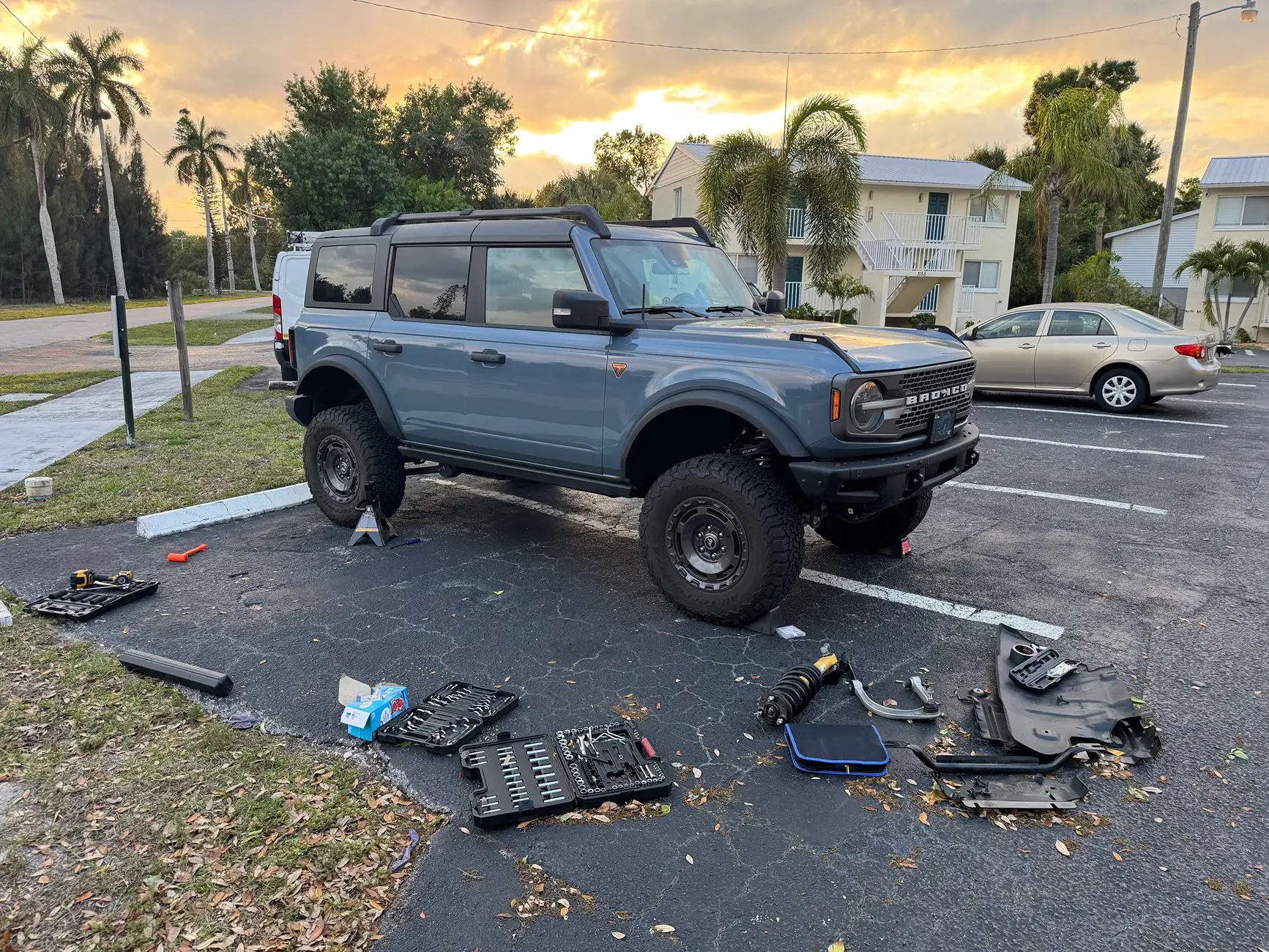

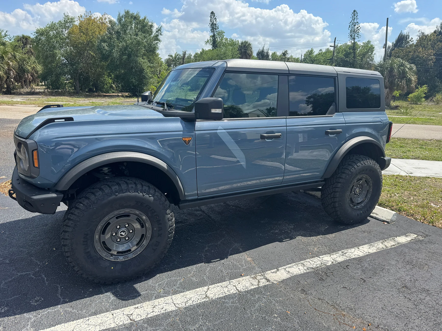

Figured I'll get it on the hype of showcasing what I've done with my bronco so far. I've already completed a few things already, so hopefully this thread won't last months. First thing I did was buy takeoff everglades wheels for a pretty good deal on Facebook
Ford Bronco 2024 Badlands Build Journey IMG_0470
for around $500 awhile ago

Looking good. Getting ready for 37” next?

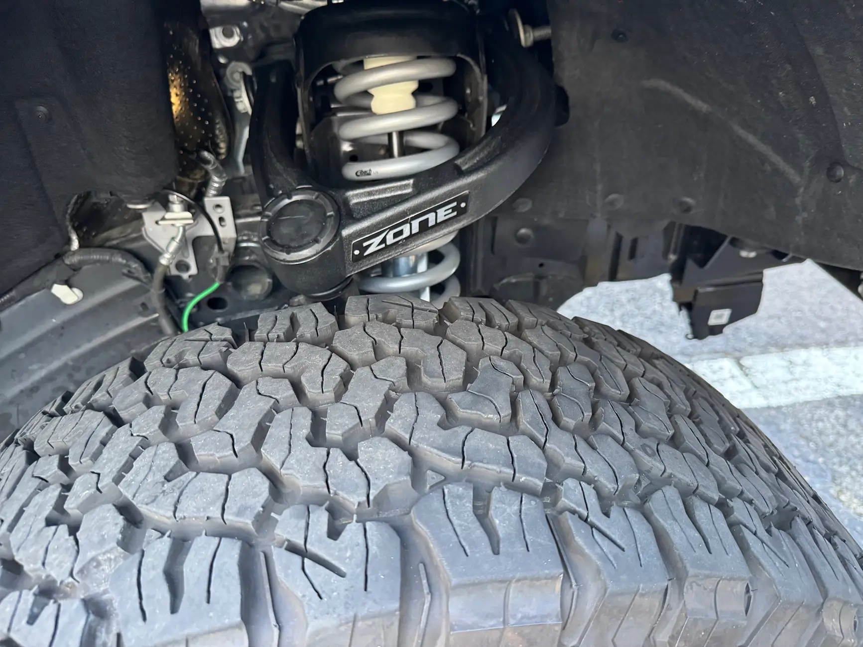

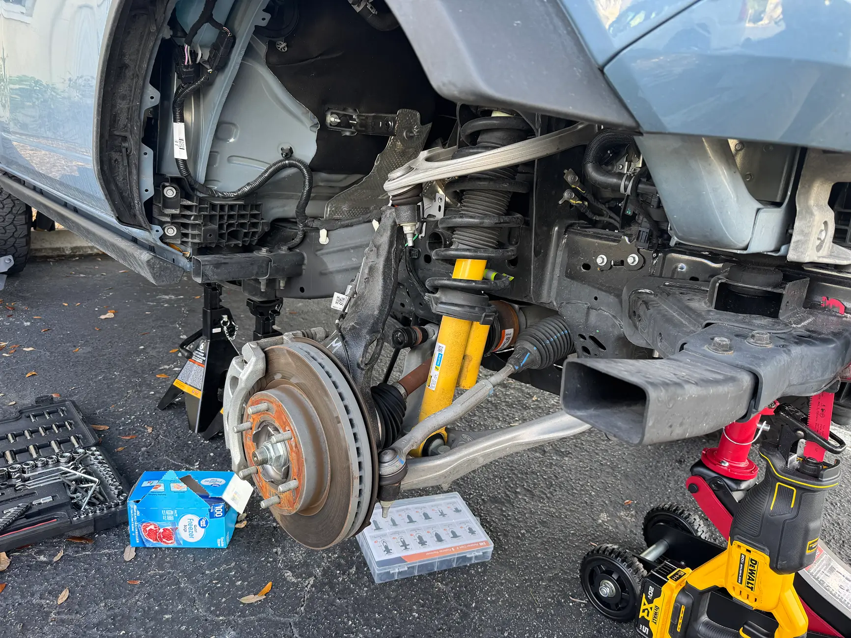

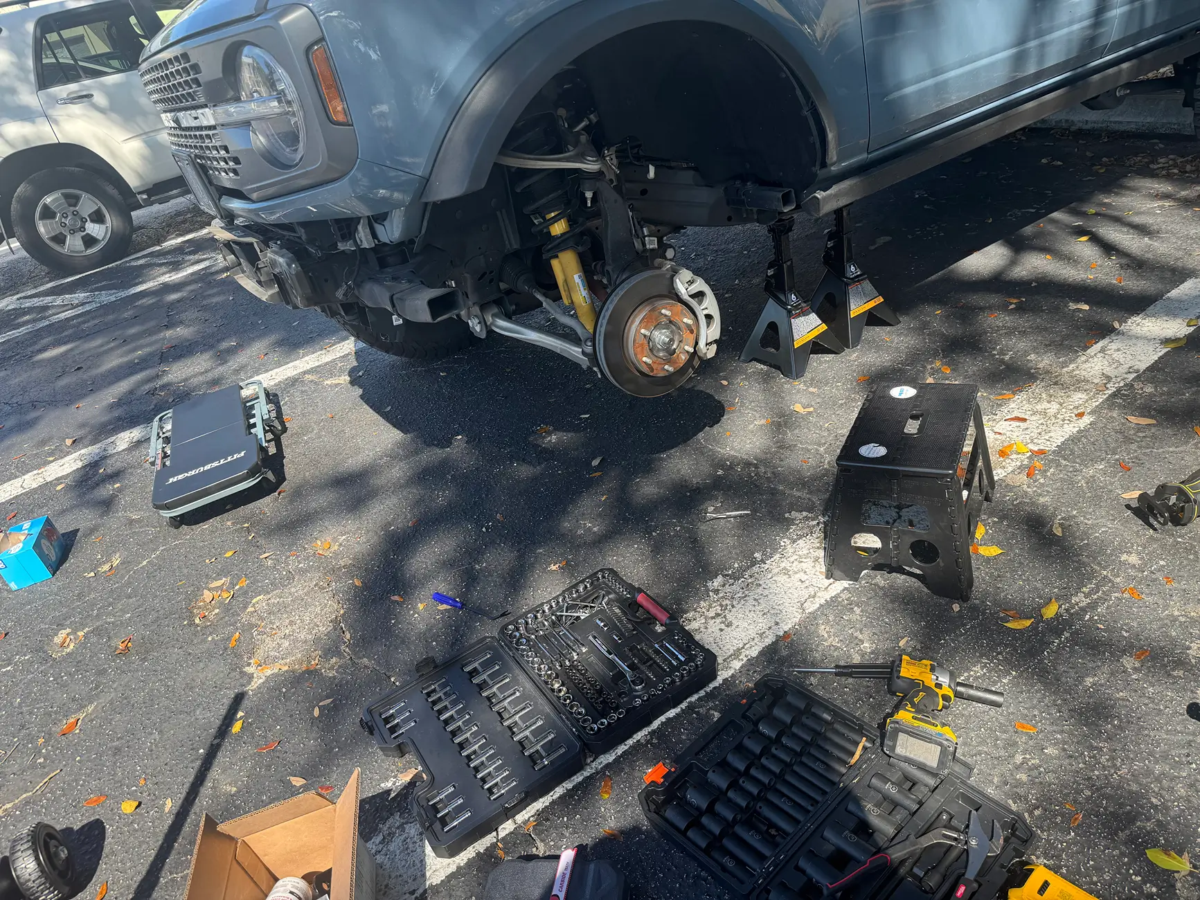

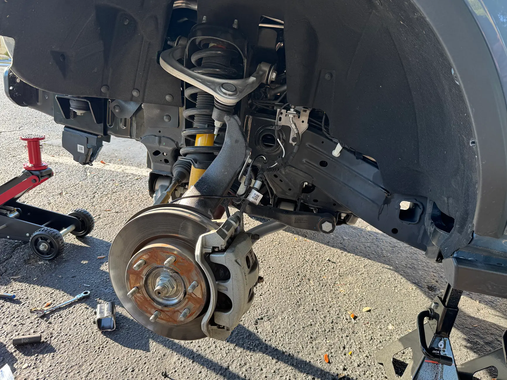

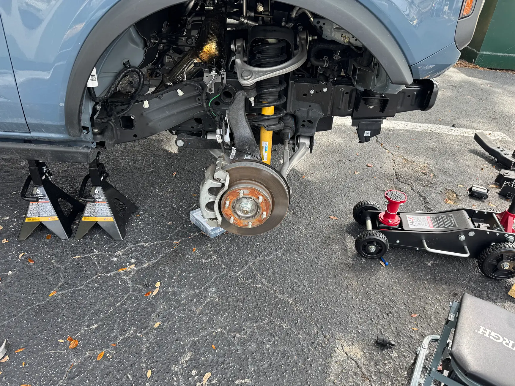

finally, after most of Friday and all of Saturday, I installed both the zone upper control arms and eibach 2.0 coil overs. Trying to get the top hat bolts put made me question there's a god but I got it done regardless. Still has the 33s, will be hopefully installing them plus alignment this coming Monday.

Nice build. You gonna do anything to correct the geometry in the rear before the alignment?
TheMissingPersonFrom1969
Sep 8, 2025
62
73
Fort Myers, FL
2024 Ford Bronco
Adju
Checkout Project Kehm channel on YouTube.
Yeah plus an adjustable track bar. You may also need adjustable rear control arms depending on how off your piñon angle and wheel center is from the lift.
Never thought about rear control arms and looking at what I have to go through to install it might break my soul again but I’ll most likely get a track bar relocation kit. An adjustment track bar is debatable but I think rough country sells one at a reasonable price

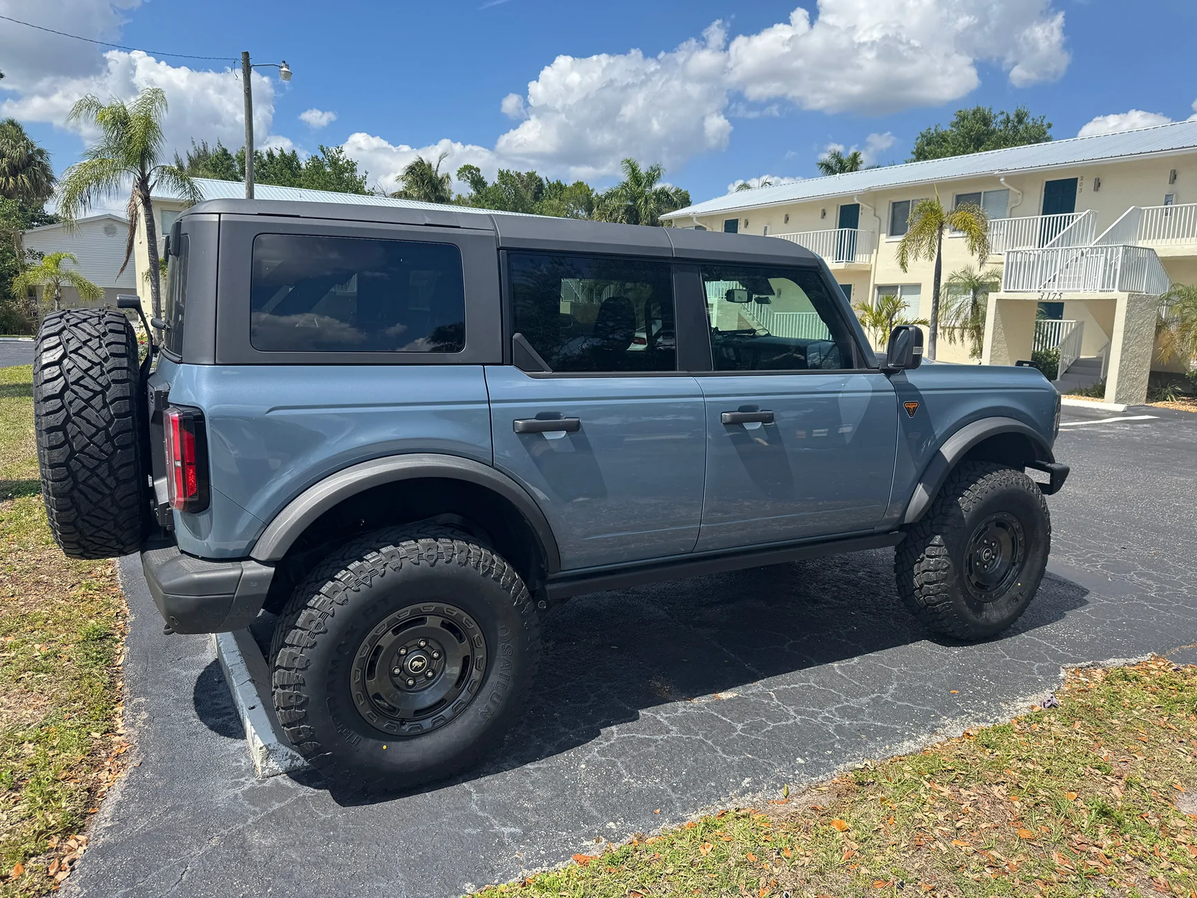

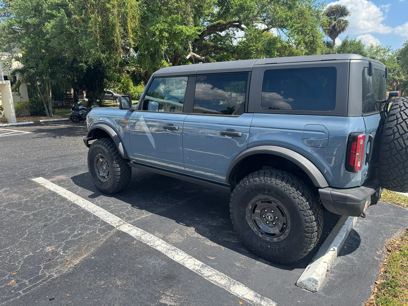

Got the 37s on finally thanks to discount tire. Looking at my rear axle I don't think I need new rear lower control arms but I have ordered a trac bar relocation bracket alongside an adjustable trac bar.

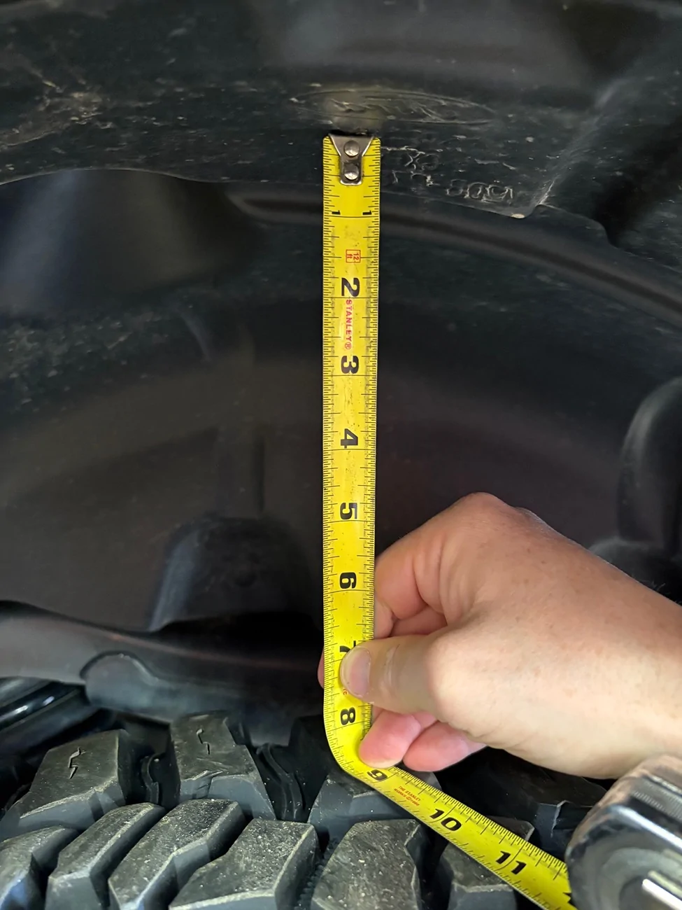

Looks great, can you do me a favor. Can you measure from middle of your tire to the fender? Curious what it is in inches for clearance for the 37s. I’ve got 9 inches now in the front and 8.5 in the back for my 35s from tire to inner fender.
Ford Bronco 2024 Badlands Build Journey IMG_3970
Ford Bronco 2024 Badlands Build Journey IMG_3972
