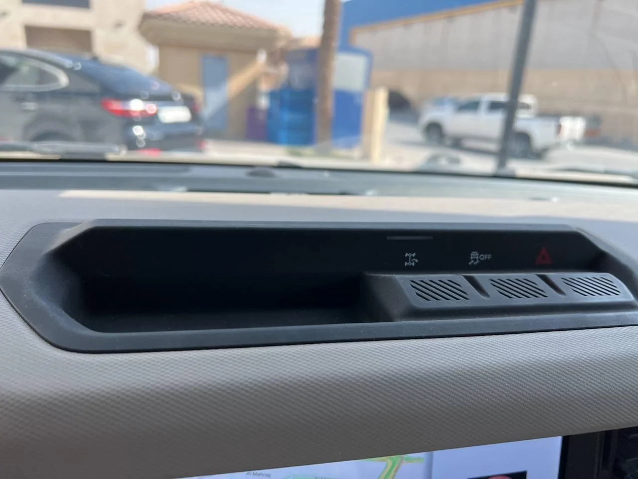

Initially I thought the vehicle had the sasquatch package, but apparently it doesn't .. I'm guessing that means I can't put these parts in? or is it that I'd have to do a bunch of programming to get these parts to work on it?

at least you won't have to futz with FORSCAN programming if you go this route. even better if you already have the up fitter switches already factory installed.
