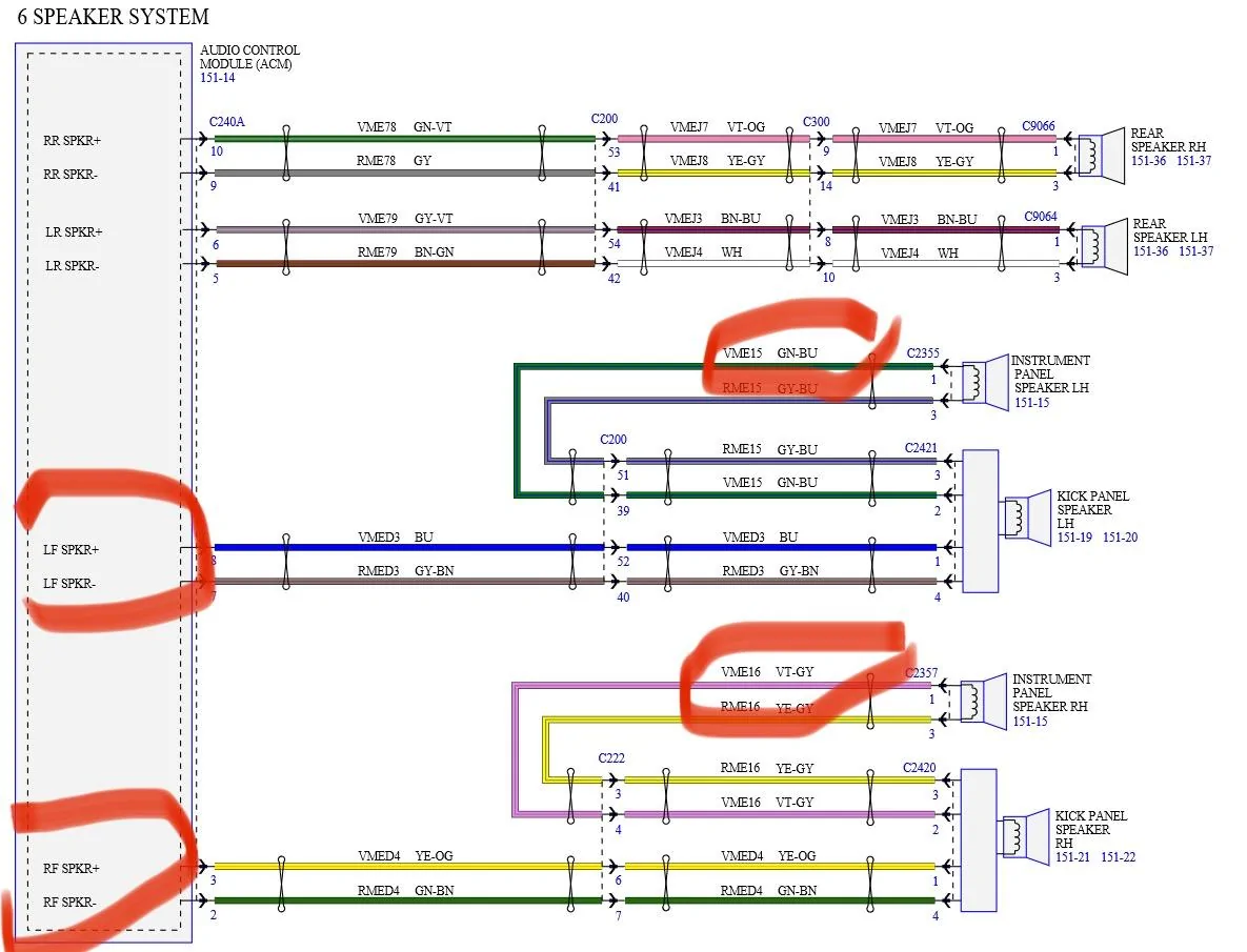

the bridging is done in the speaker connector.
By that diagram the dash speaker should work with the connector unplugged. There is still a complete circuit to the dash speaker.
NO. the plug from the wiring harness is a 4 position female molex connector with ZERO interaction between positions!! plug that female connector into the midbass driver, which has pins 1&2 bridged together for positive and pins 3&4 together for negative in the actual connector itself, then and only then will positive and negative signal go to the female positions 2 and 3 in the harness molex connector to go to the dash.
my diagram shows them unplugged for clarity. imagine inserting the harness plug (on top of diagram) with two wires from amp on pins 1&4 and two wires from dash speaker on pins 2&3 plugging into the connector (on Bottom of diagram) on the midbass. then and only then will signal go through the internal buss/bridge in the midbass connector to pins 2 and 3 to the dash speaker!!

Do we know what kind of Load the headunit/amp is receiving from the 2 front speakers being wired like this? 2 ohms 4 ohms 8 ohms?
Thank you. Going back I missed these key words " since the bridging is done at the connector on the speaker ".

it doesnt happen in the speaker itself, it happens in the connector of the speaker. the connector that plugs into the midbass has 4 wires in it. two from the head unit/amplifier and two that go to the dash speakers. since the bridging is done at the connector on the speaker, if you unplug the midbass, you lose the dash speaker also. if you were going to cut the connector off and use a crimp on disconnect terminal to plug into replacement midbass, you would have two wires in each disconnect terminal. You would have the wires that were under pins 1 and 2 together as your positive and pins 3 and 4 together as your negative.
Thanks! Super helpful, sounds like I would just need to install my own bridges then, thats easy enough.

The speakers in the dash and in the rear have a capacitor on them which is sized to pull the base out., so essentially they are tweeters.

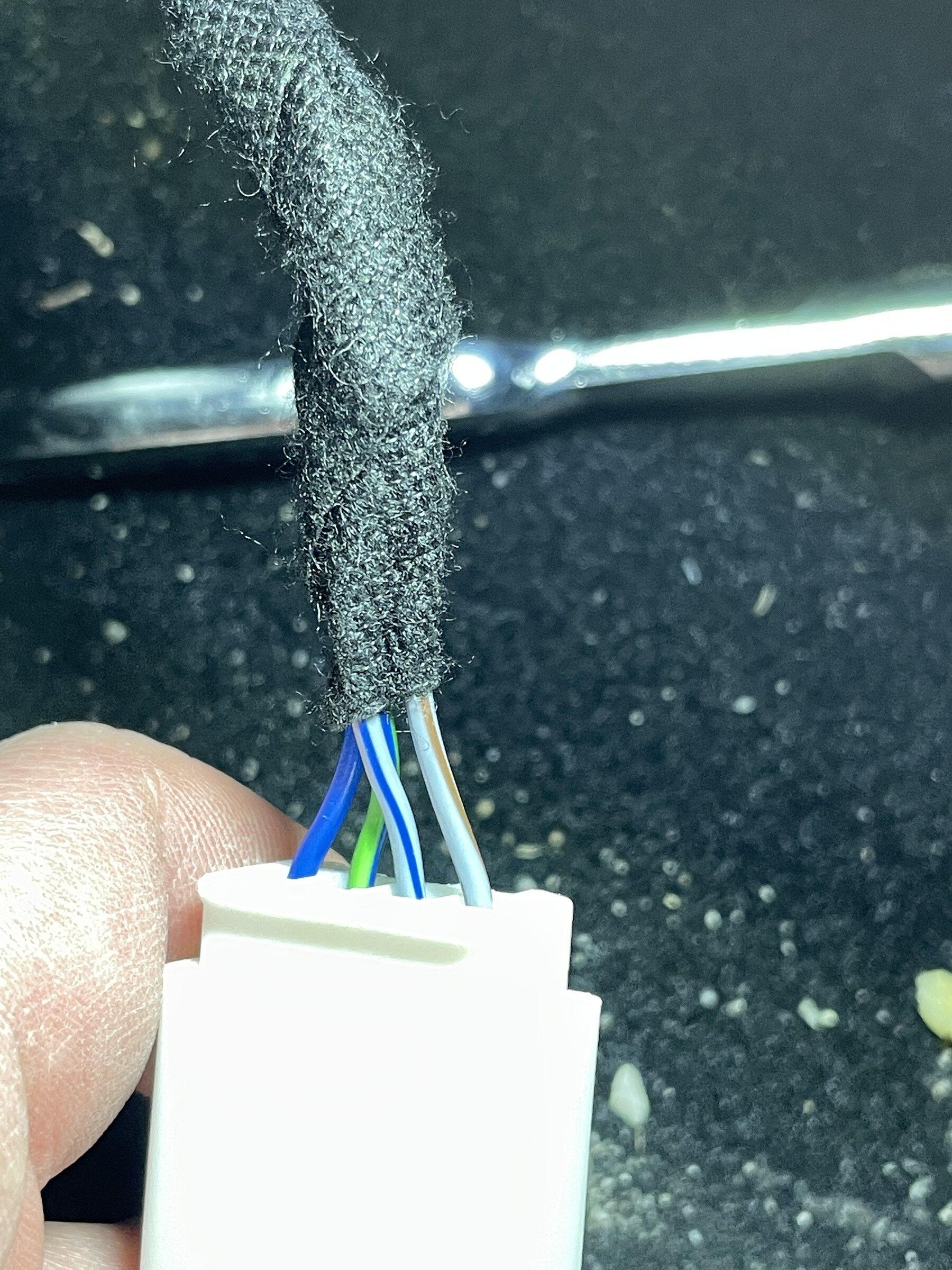

Also to just plainly type here and save some folks time. the right dash speaker positive is green/blue the left dash speaker positive is violet/gray.
You have this backwards. Should be right dash positive is violet/gray and left dash positive is green/blue. This is how the diagram shows it and here's a photo of the left hand connector... There's no violet/gray, only green/blue.

Can someone give me a quick lesson on how to read this wiring schematic? I just want to try and understand the wiring before I move forward with installing some new speakers.
