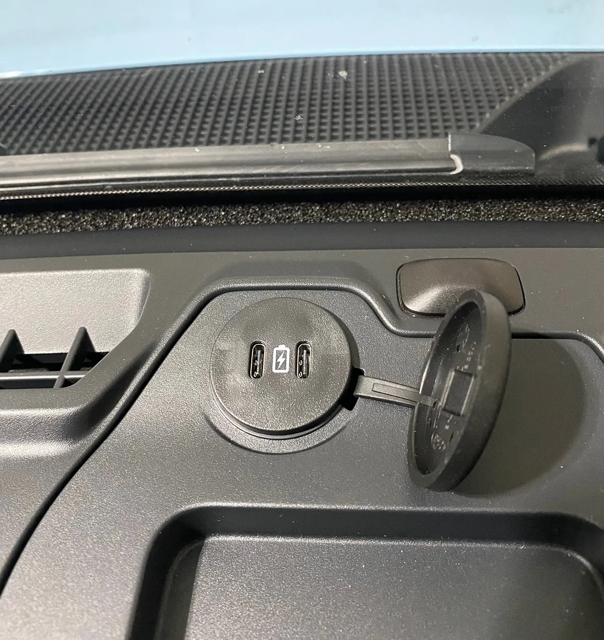

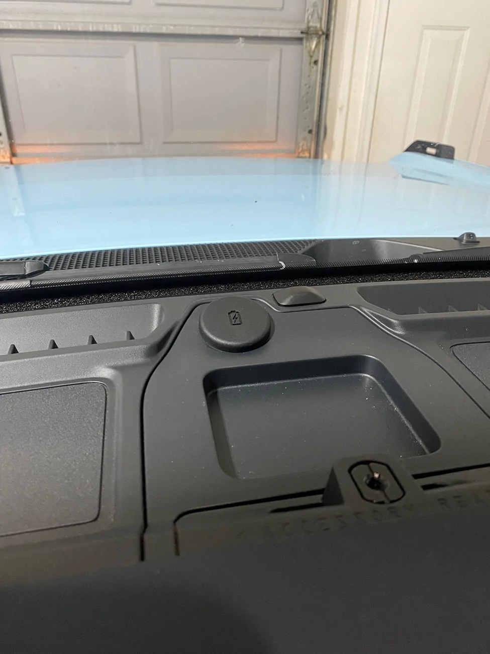

Won’t lie.. didn’t know there was one up there. I’m referring to the one below the dash in front of the shifter.

I don’t know what years/trims have them, but there is a dual USB-C up there on mine.
Ford Bronco 2021 big bend front USB not working IMG_3120
Ford Bronco 2021 big bend front USB not working IMG_3119
