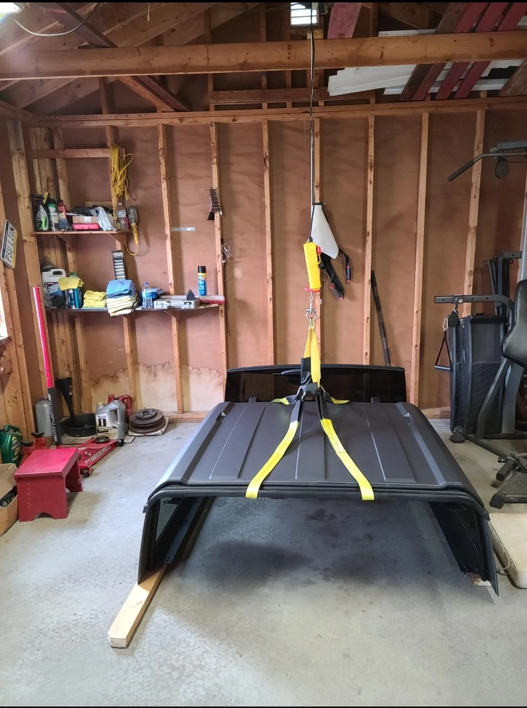

Harbor Freight electric hoist. Two ten feet long nylon tow straps. One small strap to connect the ends of the ten footers. Plug in, push button and raise. Reverse process to install. BL 2D.

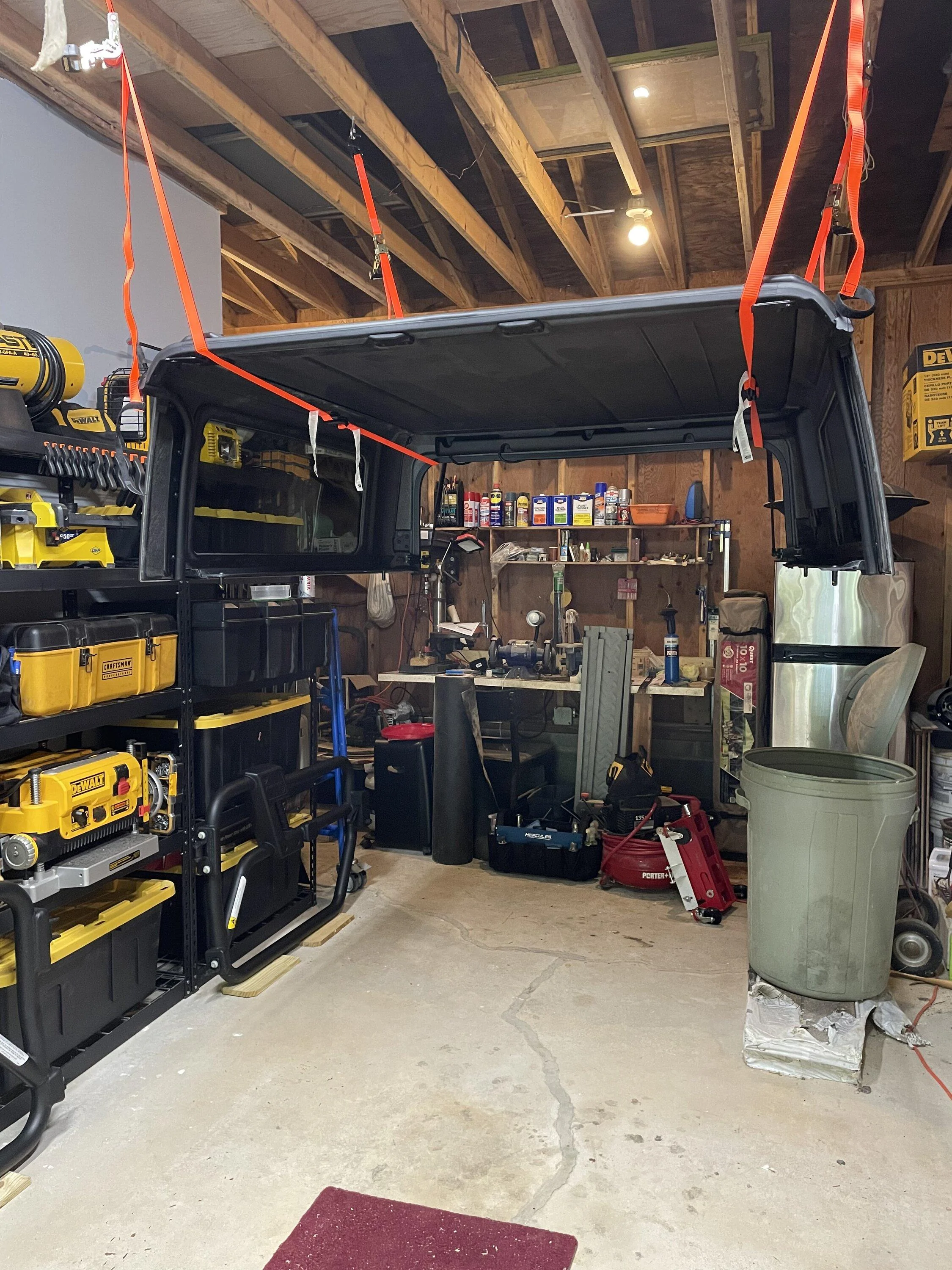

4 eye bolts and a $25 set of ratchet straps. Lift a couple inches and drive out from under it. Easy peasy!

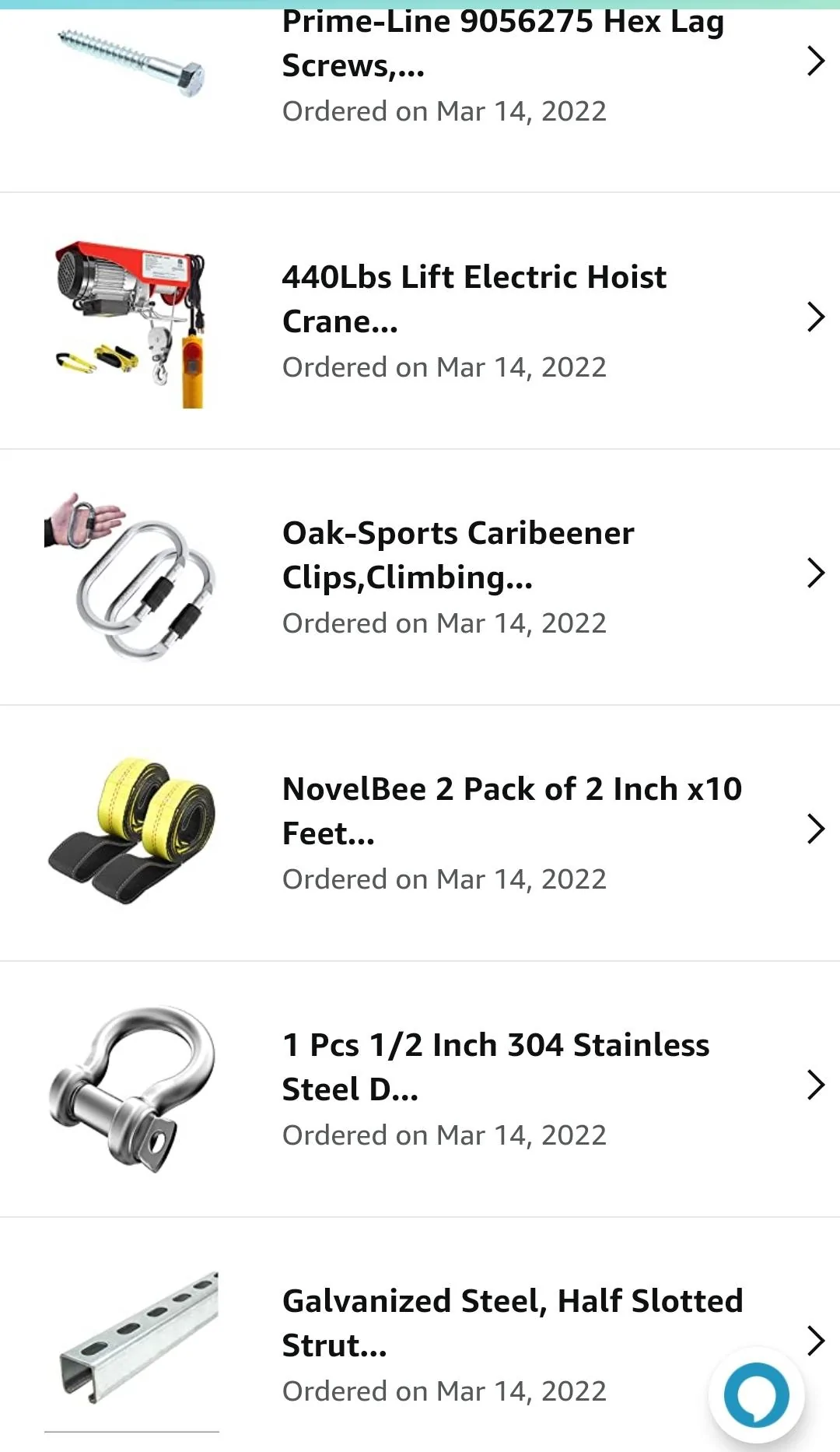

I spent around $200 for the hoist, straps and hardware off Amazon for my setup. I have a smaller garage and it sits above the hood when I have the top off and have it parked in there. I added a screenshot of everything I ordered for the setup. The top is heavy towards the glass so make sure your hoist point is back further to lift it off level.
