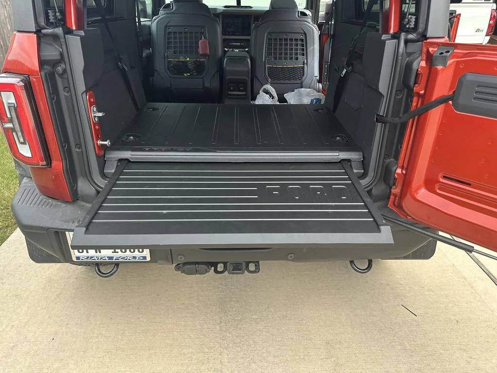

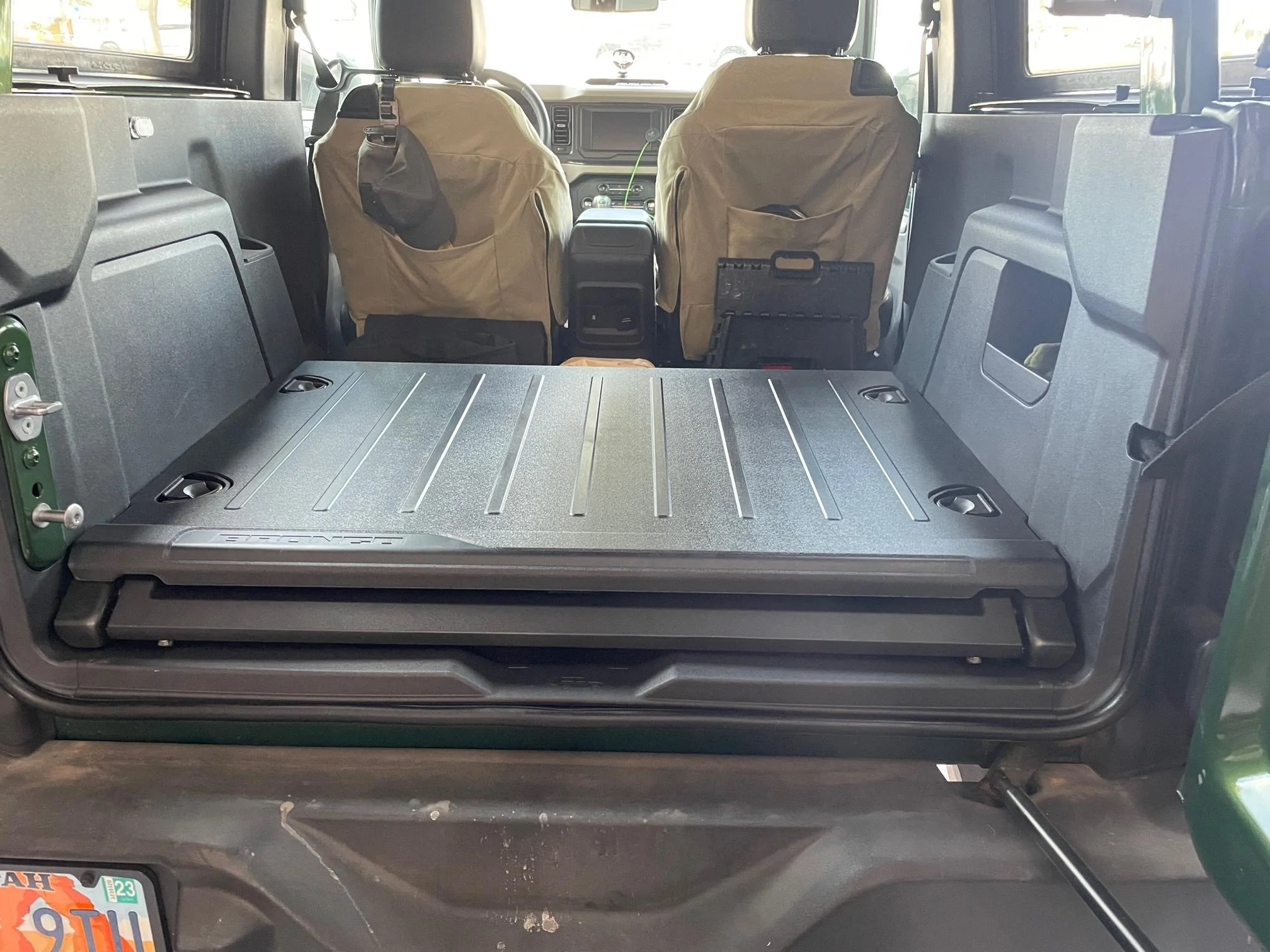

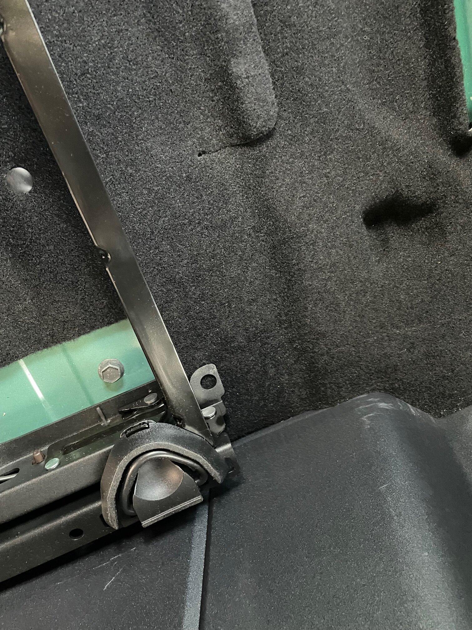

The 4 door slideout tailgate on Ford Accessories definitely fits the 2 Door with just a little bit of work to get the rear bolted in.
Stating the obvious, but you have to remove your rear seats for this to fit in a 2 door. The install was the same as 4 door except there aren't any rear bolt holes for the assembly to attach to the floor.

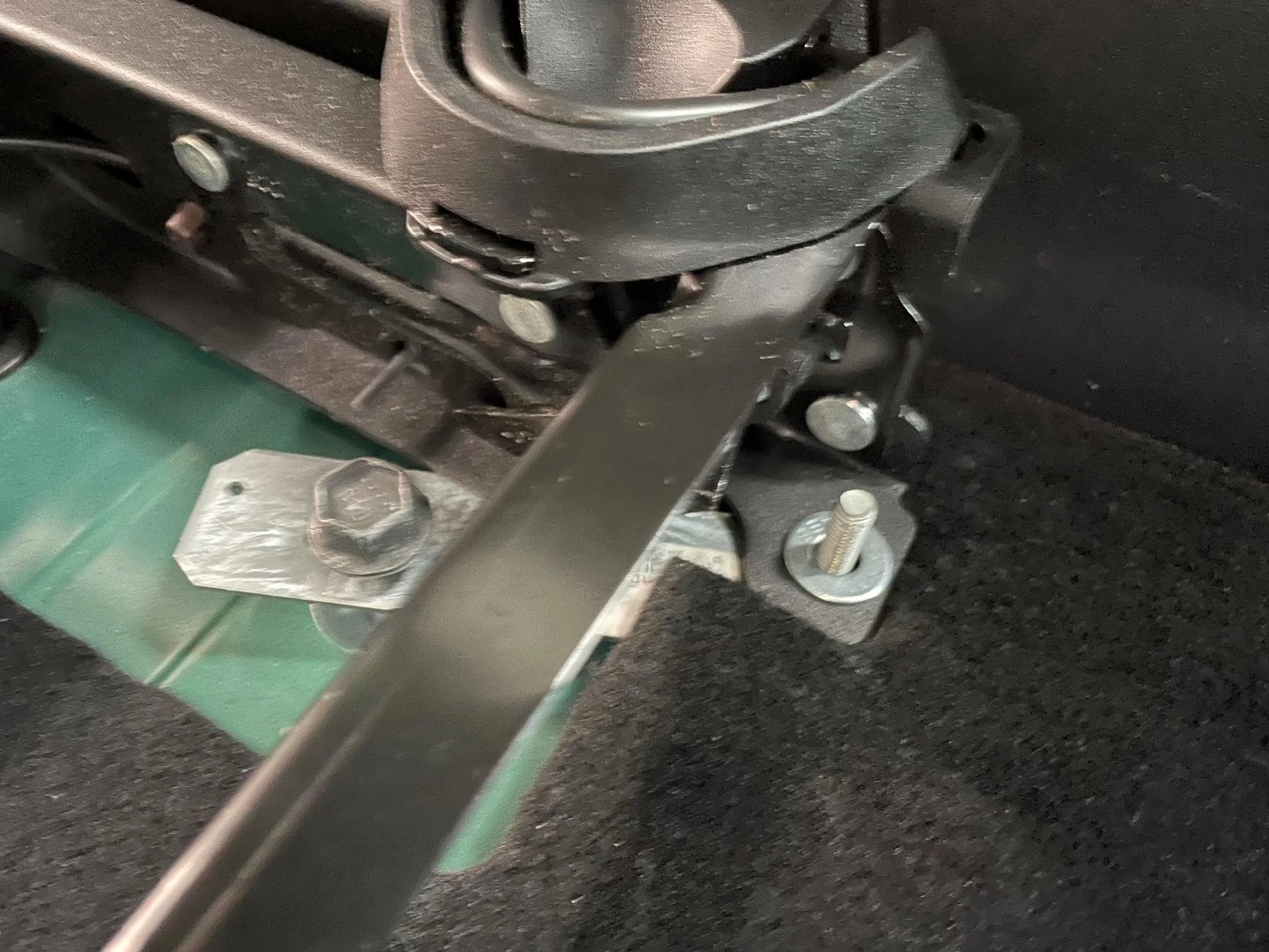

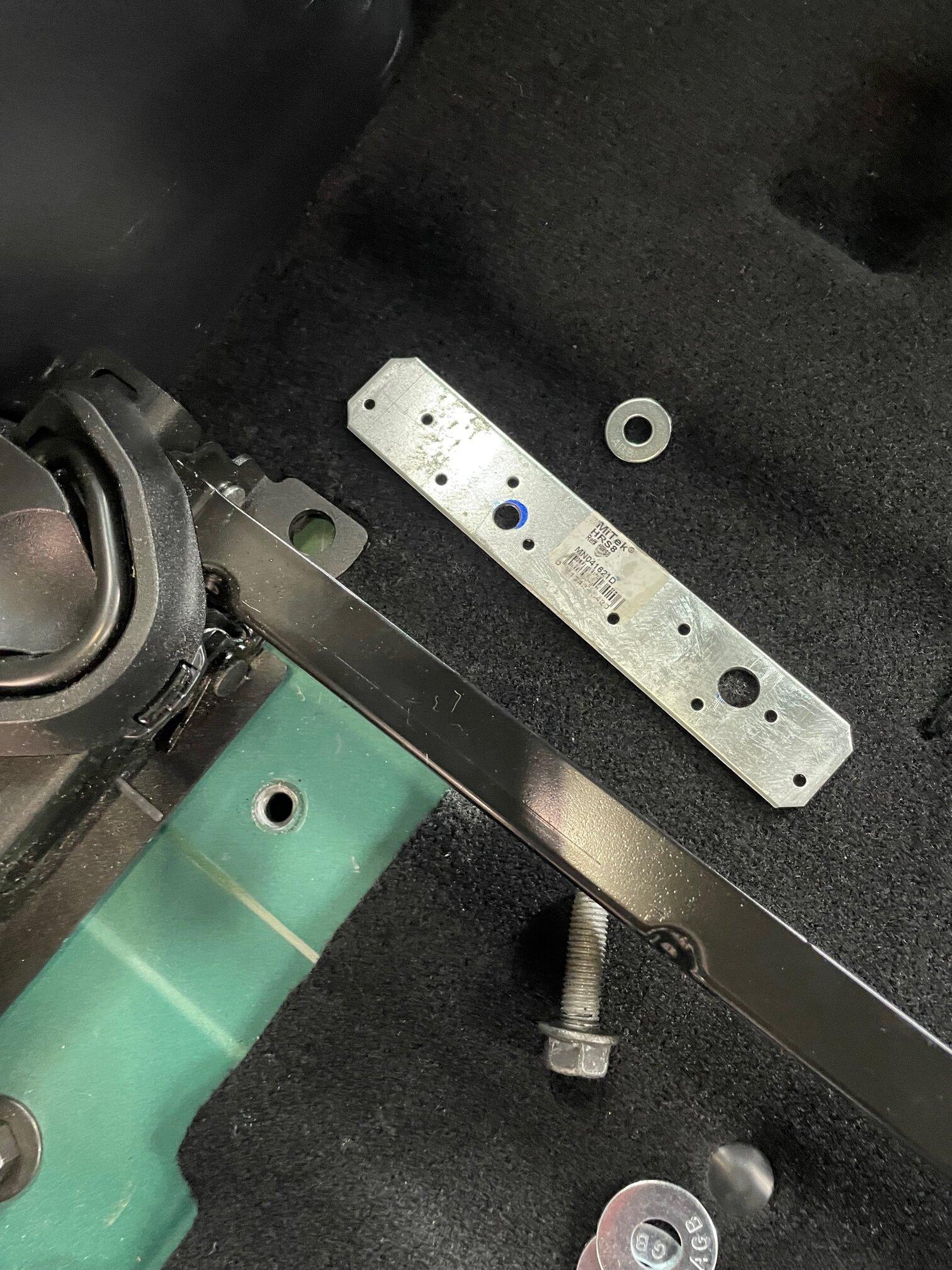

I used a 1/8" thick steel tie plate to secure the rear of the unit by connecting it to the existing seat-back bolt with threaded hole through the body and to the rear bolt hole of the unit using one of the kit-provided screws flipped upside down and a big washer & nut. I also used two big washers under the seat-back bolt to level the tie plate to the height of the upside down screw's head. Hopefully, my photos do a better job of describing this.
I did it this way because I didn't want to deal with drilling a new hole through the body and trying to get a fastener underneath. The tie plate is super sturdy- my partner and I jumped on the extended tailgate together and there was no movement or looseness in the rear of the assembly or tie plates.

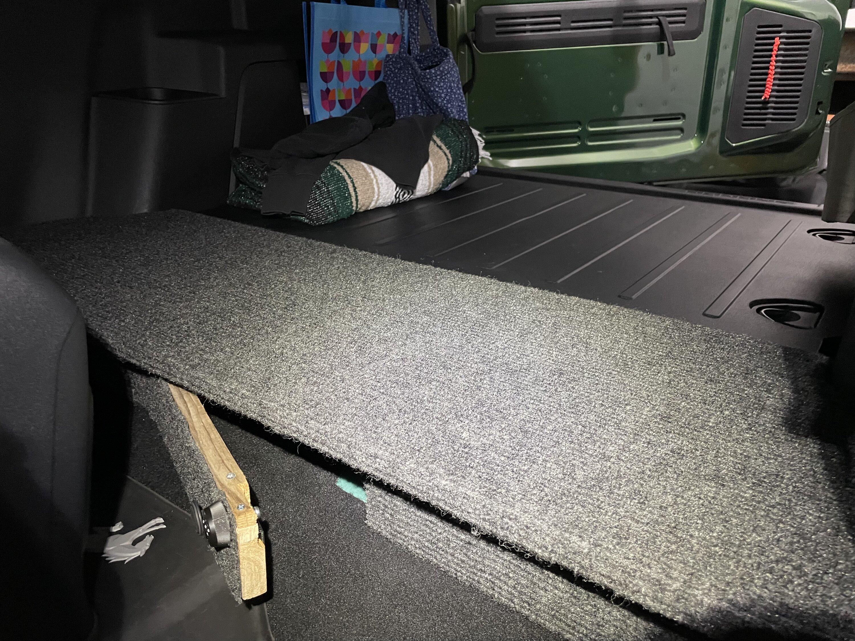

I still need to level out the front of the cargo area to match the slide out height and plan to reuse that section of my DIY rear seat delete platform. I'll update with some more photos when I'm done with that part.

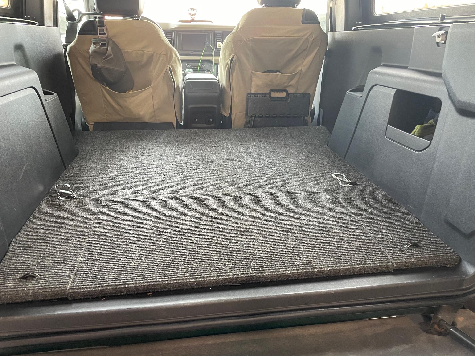

Ford Bronco 2 Door Slideout Tailgate IMG_5841

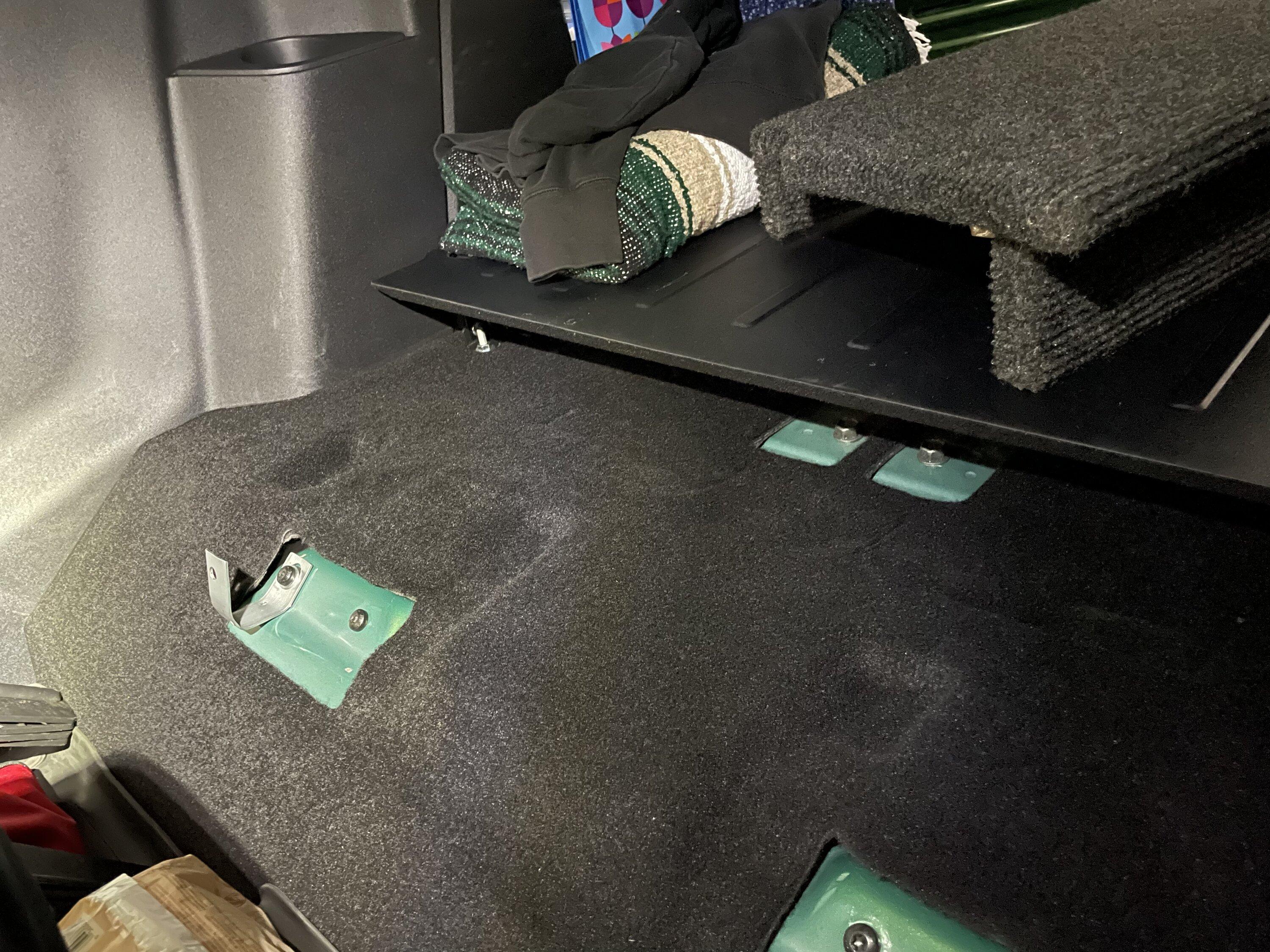

Start with removing my rear seat delete platform.
Ford Bronco 2 Door Slideout Tailgate IMG_5843

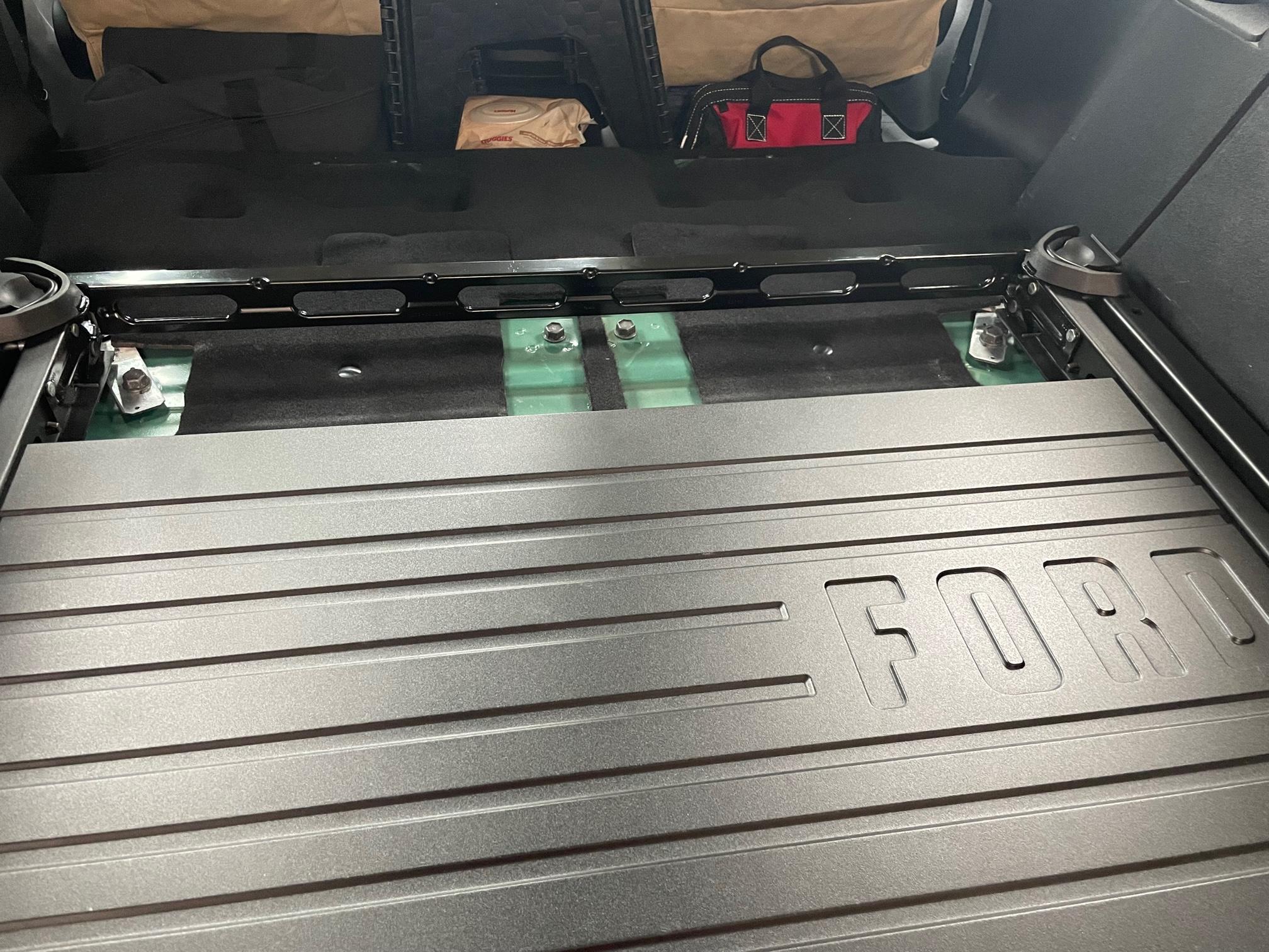

Original floor, tie downs, and rear trim strip removed- new trim strip and the left and right tailgate brackets installed.
Ford Bronco 2 Door Slideout Tailgate IMG_5844
These are the rear bolt holes that need to be secured.

Looks great with the load floor mat on top.

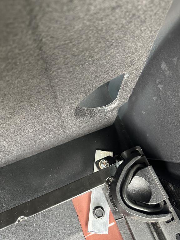

Figuring out how to secure the rear. Drilled out the steel tie-plates to connect the two points.
Ford Bronco 2 Door Slideout Tailgate IMG_5851
Tie plate in place (missing nut on the rearmost screw in this photo)

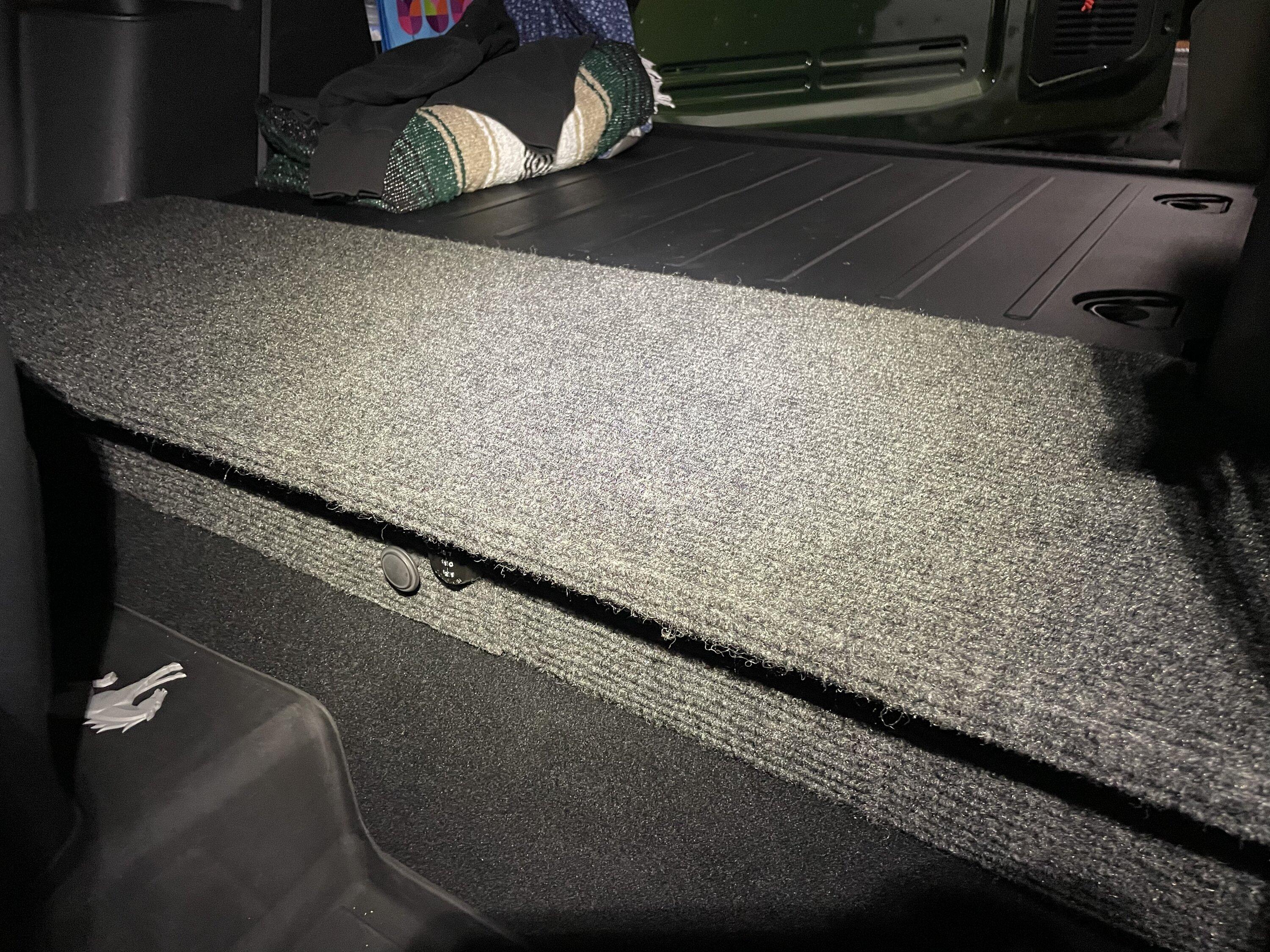

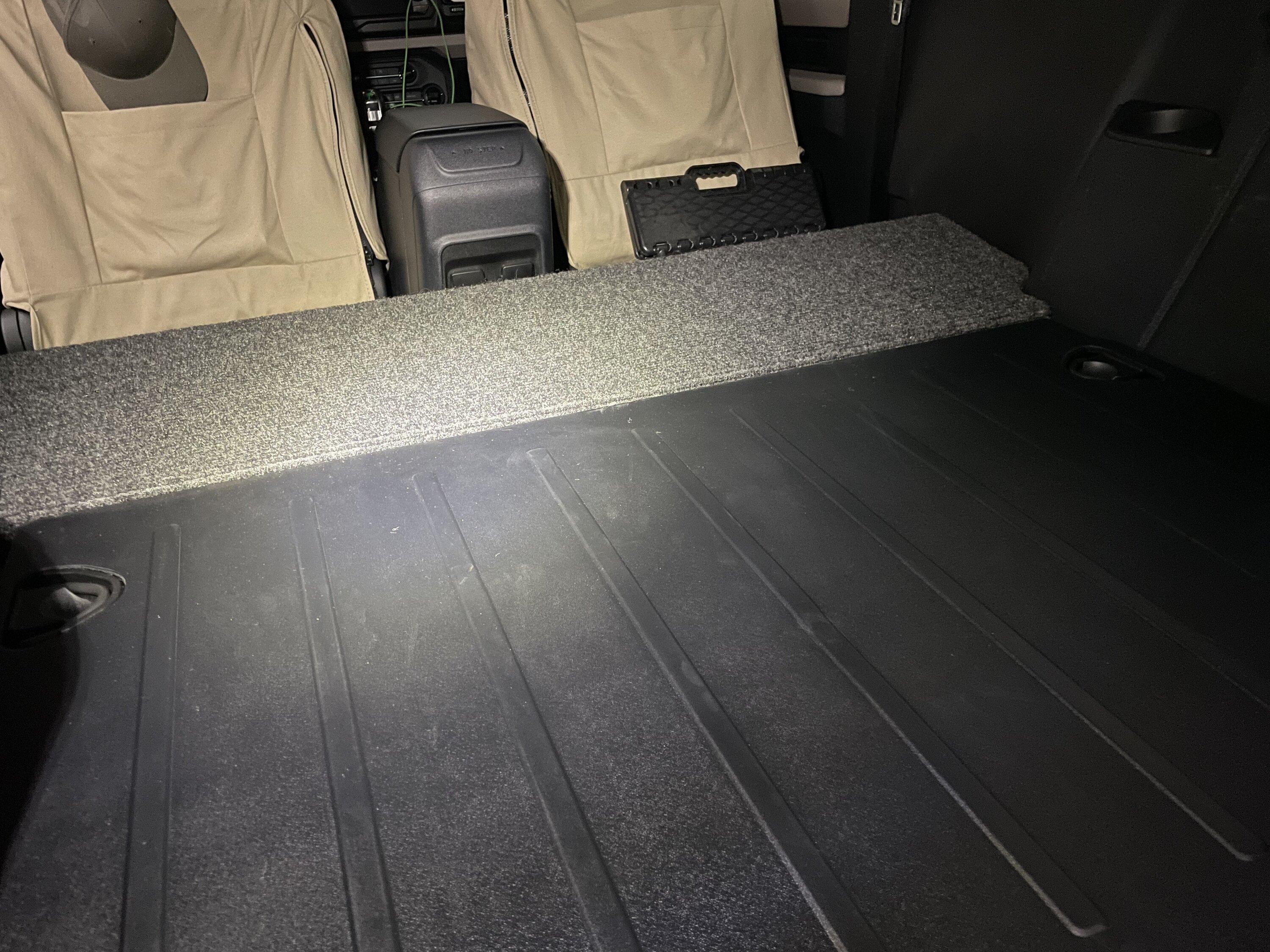

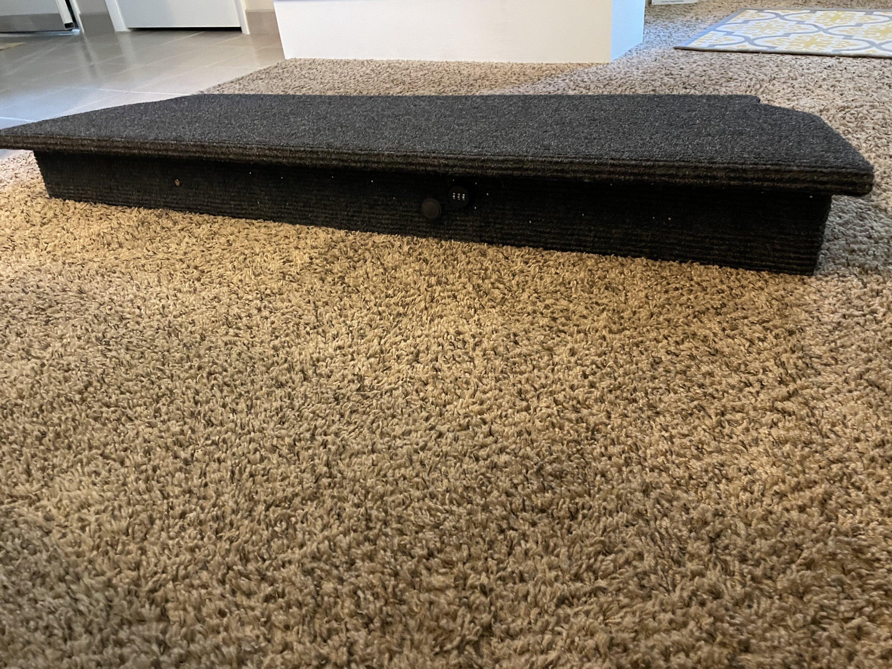

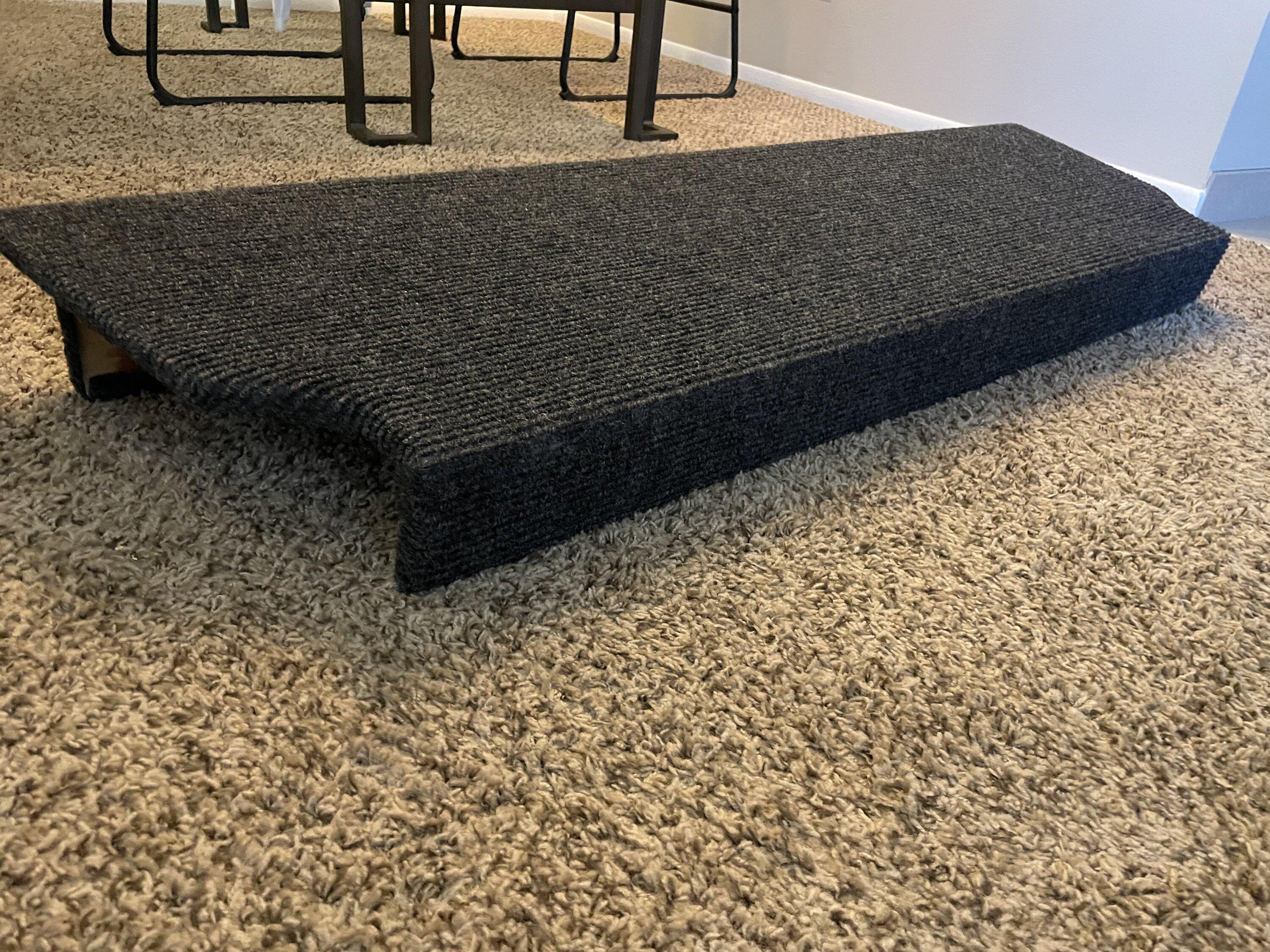

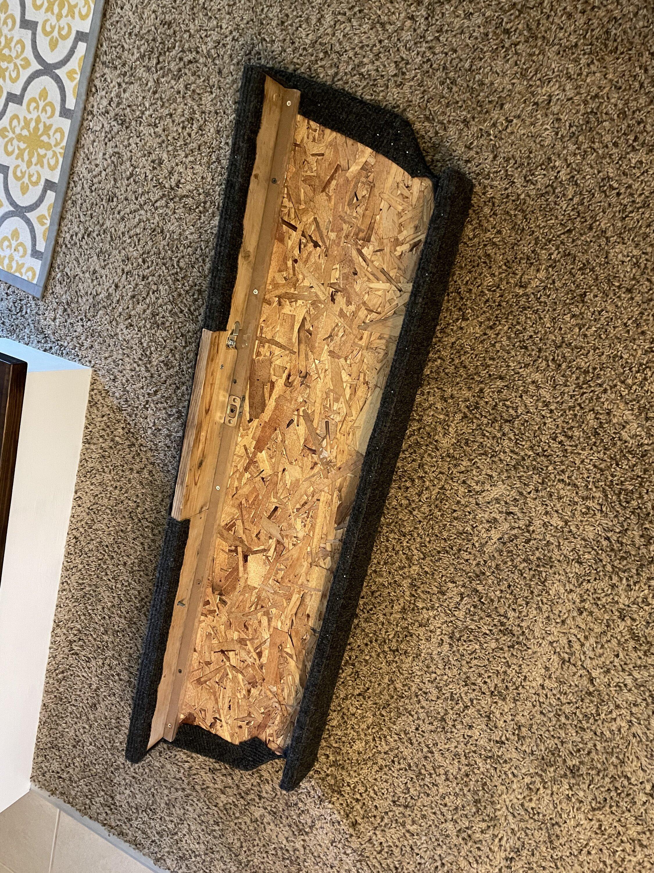

Here’s what I made to level out the forward portion of the cargo area with the tailgate slider. It’s secured using the seat bottom screws and I added a little locking door for some storage.
Please don’t judge me too harshly, I’m not a woodworker, but I did my best using the OSB from my previous rear seat delete platform and some scraps I had in the garage.
Ford Bronco 2 Door Slideout Tailgate 85575401-531A-47B9-8333-EE663841BB43
Ford Bronco 2 Door Slideout Tailgate D8F6C790-272E-4494-9F34-E1D11E20737E
Ah yes, the random, spare cabinet knob that got the black spray paint treatment. So lovely.
Ford Bronco 2 Door Slideout Tailgate D5865577-4A32-4023-841E-14720DF6201B
thankfully this will be the only time anyone other than me sees the underside.
Ford Bronco 2 Door Slideout Tailgate 0A3ED35F-D461-4557-AE2C-79FBB1C59725
Super professional mounting bracket for stability and a little security for the storage area.
Ford Bronco 2 Door Slideout Tailgate D98910E0-4600-47DF-93A7-350A3BCA4F3D
Ford Bronco 2 Door Slideout Tailgate 72B84437-DBFE-4EF5-8165-F447DCCD0856
little storage door
Ford Bronco 2 Door Slideout Tailgate 75265FBA-16DB-4545-8F37-1D38224207CF
view from the tailgate
Ford Bronco 2 Door Slideout Tailgate 9B69036B-937F-4E06-B378-ED0C17BDA6BF

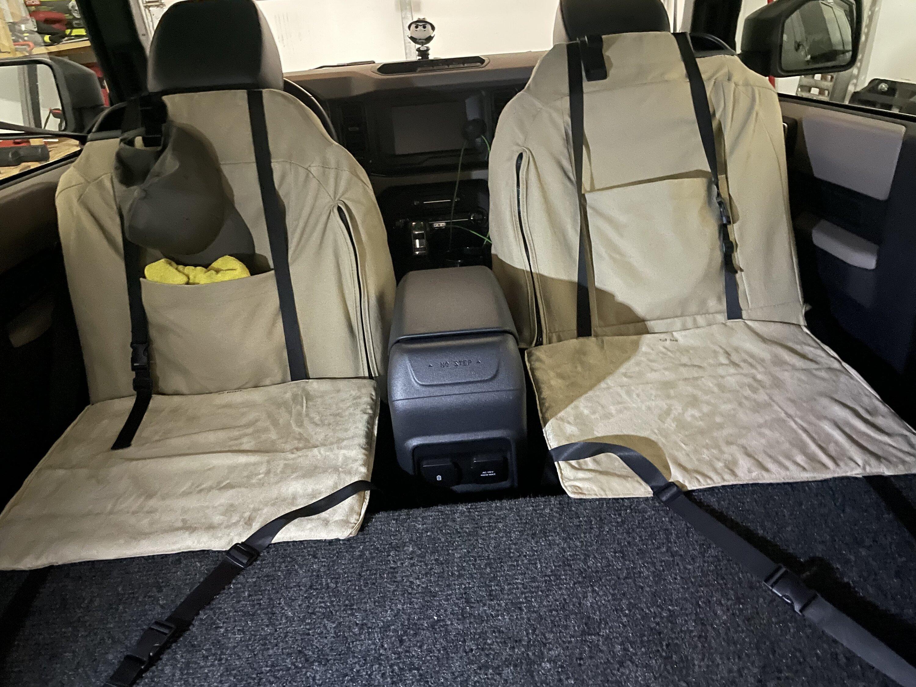

Lastly, these are the footwell bridges I made that are just thin wooden boards with a fabric cover and nylon straps that run underneath them and buckle around the headrests and tie down points for support. These take up almost no room at all and they go underneath my foam mattress for camping. Note the passenger side has almost 3 more inches than the driver’s side when the seats are pushed all the way forward.

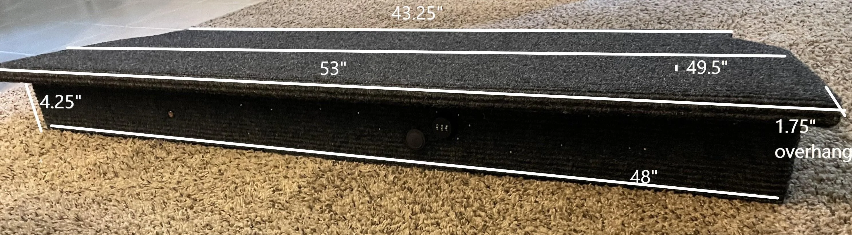

Thank you so much, I ordered one when I read your post and just got notification that it was shipped. Any chance you have measurements of the front portion your recreated to be level with the slide-out?
I originally had to temple it with cardboard and the sides are also tapered downwards, so it was just a lot of trial and error, but I’ll take a tape measure to it on my lunch break for you tomorrow.
@emulous74 - Sorry, my drawing skills are about on par with my woodworking skills, so I tried to mark up one of the photos. Also, these measurements are WITH the carpet. The curved portion on top also needed to be cut at an inward angle (when looking down) for a snug fit, or you could just cut the width a bit shorter.

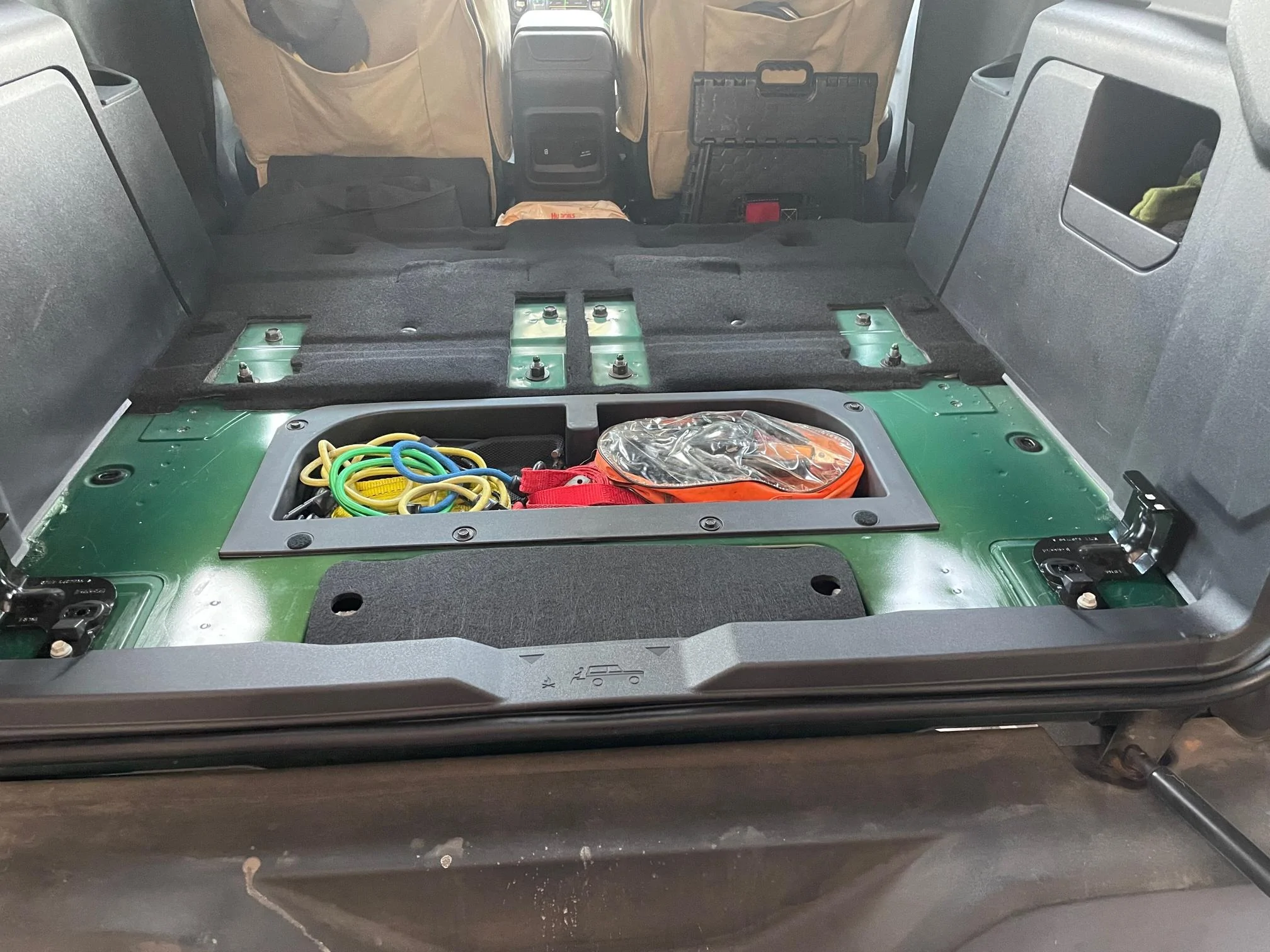

Thanks to you I got it installed on mine today:
Ford Bronco 2 Door Slideout Tailgate IMG_1038-XL
Ford Bronco 2 Door Slideout Tailgate IMG_1039-XL
I ended up using rubber bushings to make the existing bolt somewhat level with the attachment bolt.
One thing I found strange, is the rear (closet to the rear door) mounting points (holes) on the slide-out weren't threaded and weren't large enough for the provided M8 bolt to go through and there is no way to hold a nut underneath, so I ended up threaded the holes.
