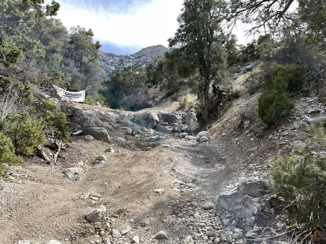

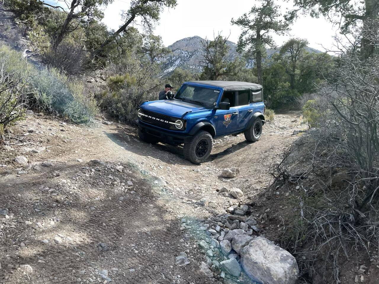

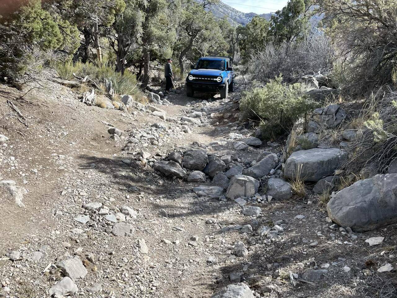

I went to the Nevada Off Roadeo a couple of months ago. Part of the course is a stream bad. They said don't use front lockers unless you're in a situation where you need them. Otherwise leave them off. But to lock the rear axle before you think you'll need it. We never used front lockers.
I was going to get a Black Diamond until I decided I wanted the Bilstein shocks. I think a Black Diamond would fill most people's needs unless they plan on some very rough roads.
This is looking back to the start of our route down the stream bed.
Ford Bronco 2 Door Badlands or Black Diamond? tempImageisujGF
Notice the Bronco below only has three wheels on the ground.
Ford Bronco 2 Door Badlands or Black Diamond? tempImageUIA4n
Ford Bronco 2 Door Badlands or Black Diamond? tempImage66woI
