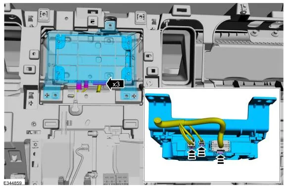

Howdy,
Hoping someone can help me out. I want to dig into where the 2.4Ghz Wifi and Bluetooth antenna locations are. I know the LTE antennas are under the dash trim right in front of the windshield, but nothing in the manuals seems to help me understand where the 2.4Ghz antennas are. I've noticed a lot of the reliability with the wireless carplay and bluetooth always cuts out at the same locations every day, which is leading me to believe there is some kind of interference in particular it's sensitive to.
Cheers!

They’re built into modules.
The WiFi antenna is the TCU and the Bluetooth antenna is the APIM.

right on, so the bluetooth connection from your phone to the APIM which is behind the screen should be pretty solid, where in the vehicle is the TCU situated?
