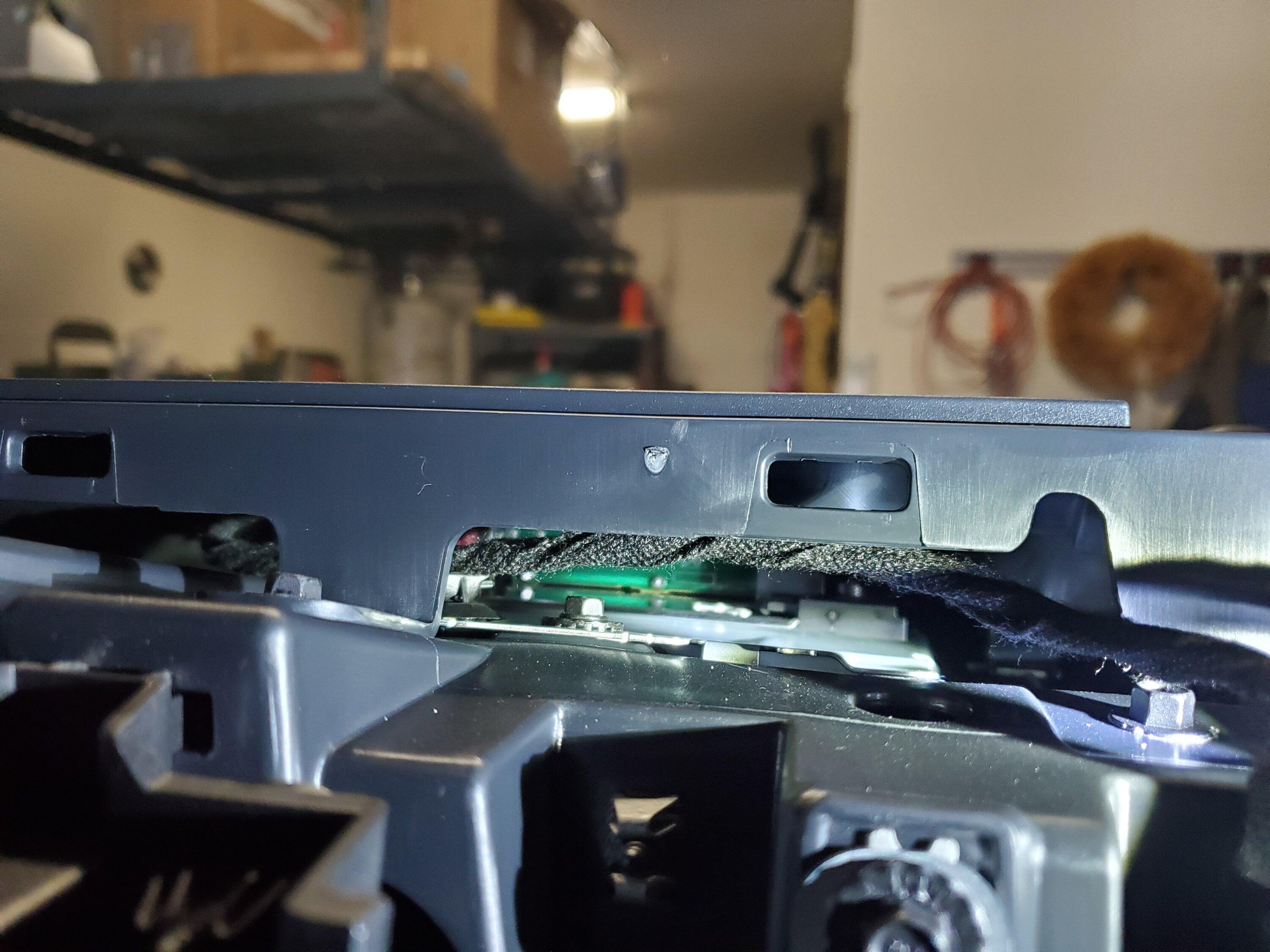

I’m trying to figure out where the hotspot/modem antenna is located. Our Bronco is a fleet vehicle that spends most of its time in the mountains with little cell service… hoping to add an external antenna directly to the modem or place a WeBoost close to it.
Any suggestions?

There is a primary and secondary antenna both located under the top part of the dash.

When I took the top trim of my dash off, I saw some boxes/boards under there. Not sure if that is what Ducati is refering to but there is one on both sides of the center.

Hard to tell, but very well could be. Those are the general locations of where they should be mounted.
