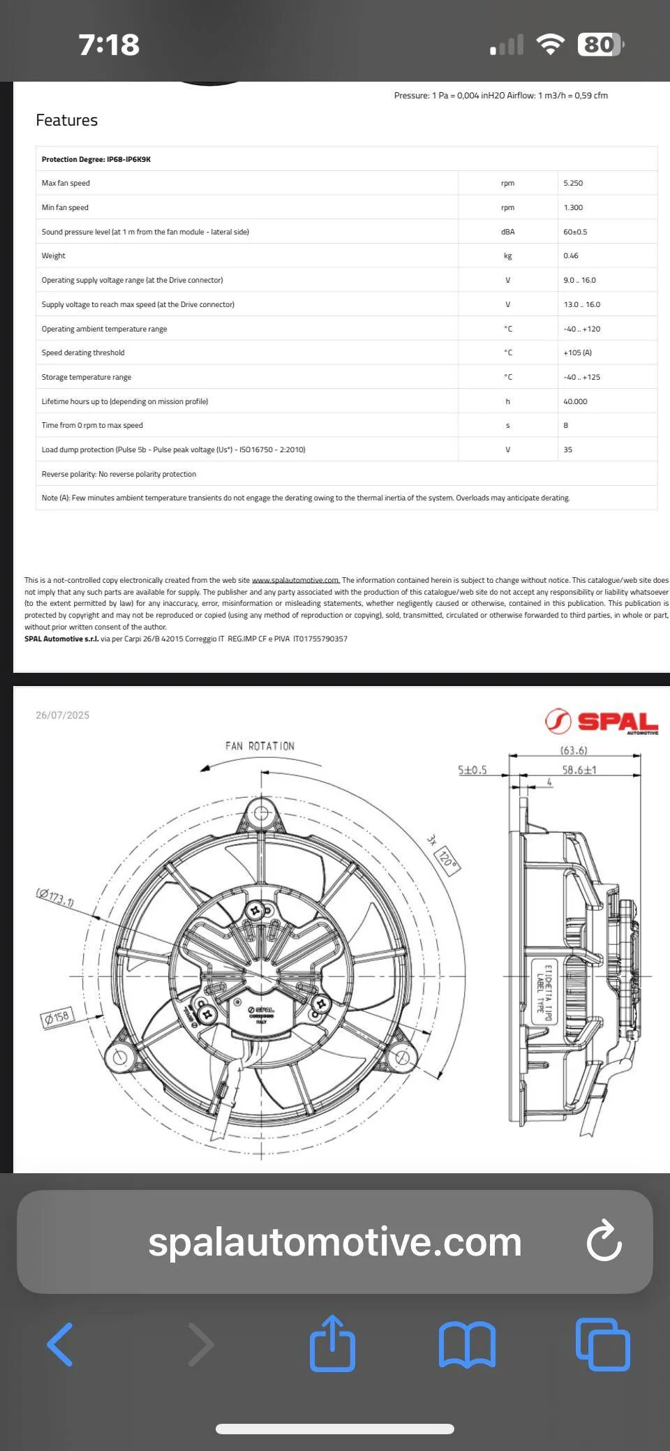

2.3L intercooler off roading …
Ford has the doors or shutters to control flow to the intercooler when flow is not needed.
But when off road slowly moving and under load / boost, there is little or nothing flowing through it…. I’m in hot dry climate.
Anyone WITH real knowledge
Have you added a SPAL cooling fan? OR …
I’m thinking of doing the same for oil cooling
[people with hyperbole syndrome- stay on your porch]
