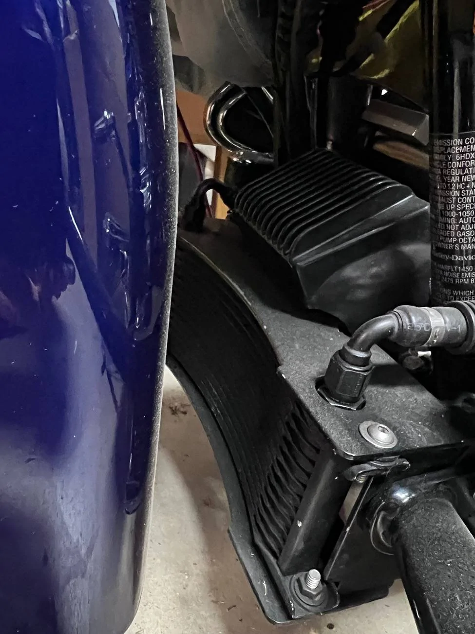

This is the oil cooler set up on the bike, cannot see the SPAL 150cfm puller.
? on bigger, It's big and did not do much until I found a 140* oil thermostat. HD oil temp 180-190* range... StocK HD 320* +++
It's now an Oil cooled motor with air assisted cooling lol
EARL'S Pumbing 'a Holley Co' I'll Do something like it for the Bronco

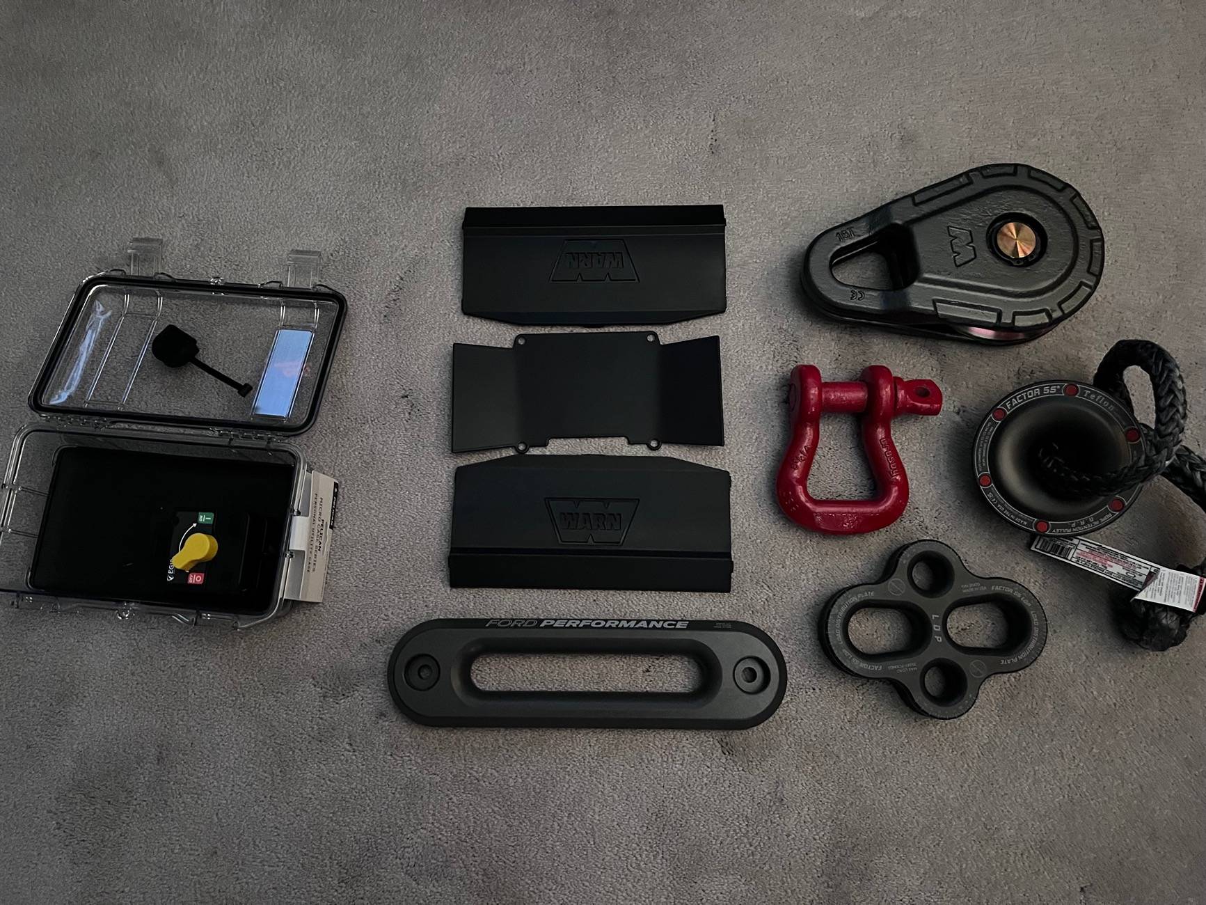

#1 priority is winch set up, relocation of control box... awaiting delivery of Bronco.
Ford Bronco 2.3L intercooler off roading - SPAL Fan IMG_6414

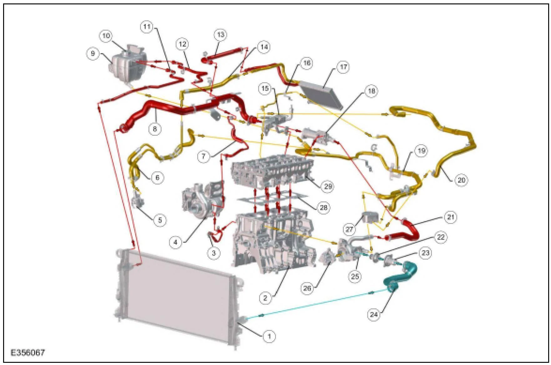

And a bit more info - so did a bit of digging around here
If the point is oil temps - the intercooler only has a minor, indirect effect on that (or at least that's my theory, I haven't tested it). The oil cooler on the 2.3 is driven right off the main radiator. It's a tiny little cooler that comes right off the coolant pump. So it's wet cooled from the main radiator.
Intercooler will affect combustion temps (that's how it helps prevent pre-detonation after all), and combustion temps will affect heat rejected into the coolant loop. So there is an indirect effect there - but as said before, the intercooler will only really function if the turbo is boosting, compressing the air (and compression heats it up). Otherwise, you are using ambient temperature air to try to cool something that's coming in at the same temperature - no difference in temp = no transfer of energy.
So to really affect oil temperatures (and make sure you want to do that - overcooling the oil will affect operating viscosity and is a generally bad idea and probably worse than overheating) - running water versus 50/50 is not a bad idea, it will transfer more heat more readily, but beware of the potential of boiling. A cooler-running thermostat, or upgrading the radiator or radiator fan. The poor man's fix of turning the AC on high to force the radiator fan on max speed is what I have always done out on the trail, but "estimated" oil temps upwards of 220-230 don't really bother me.
But then again, I'm not out in 120° desert in direct sun most of the time too running wide open throttle, and I can just pull over in the shade and let it idle for a few minutes to cool down and steady out if I had to.
#25 is a coolant manifold/thermostat housing
#26 is the coolant pump
#27 is the oil cooler
Ford Bronco 2.3L intercooler off roading - SPAL Fan 1753630542113-qx
Anyway, that's all my theory, I don't have data to back it up right now. I could be off base.

Which 2.3L motor?
Bronco Pre 25 or 2025
That would be the pre-25. I don't have the diagram for the 25 handy, would be interested to see if it changed. I would suspect - the location changed a bit, but probably still a radiator-cooled oil cooler.

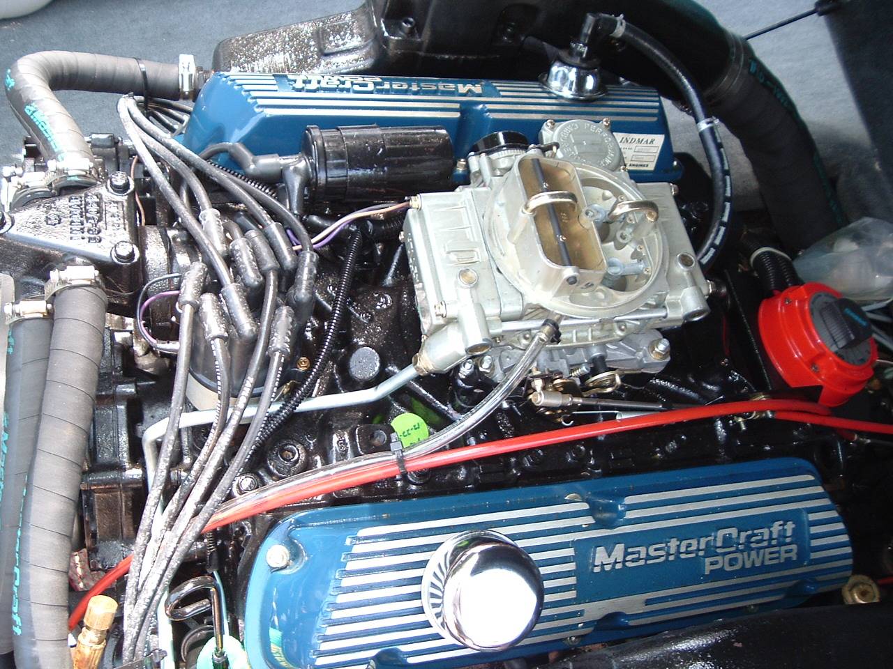

I had a 1993 ski boat with the same engine as my 1995 Lightning except the boat was Carbed. The boat sucked cold water straight out of the cold lake... through the motor... Differenes I ran different oil specification.
No reply needed just putting some background out there
Like your thinking... just stay a little broader in view
I noticed your in Kalifornia the cold water was Nacementmo same 351W w/GT40 heads, from Fords industrial program
