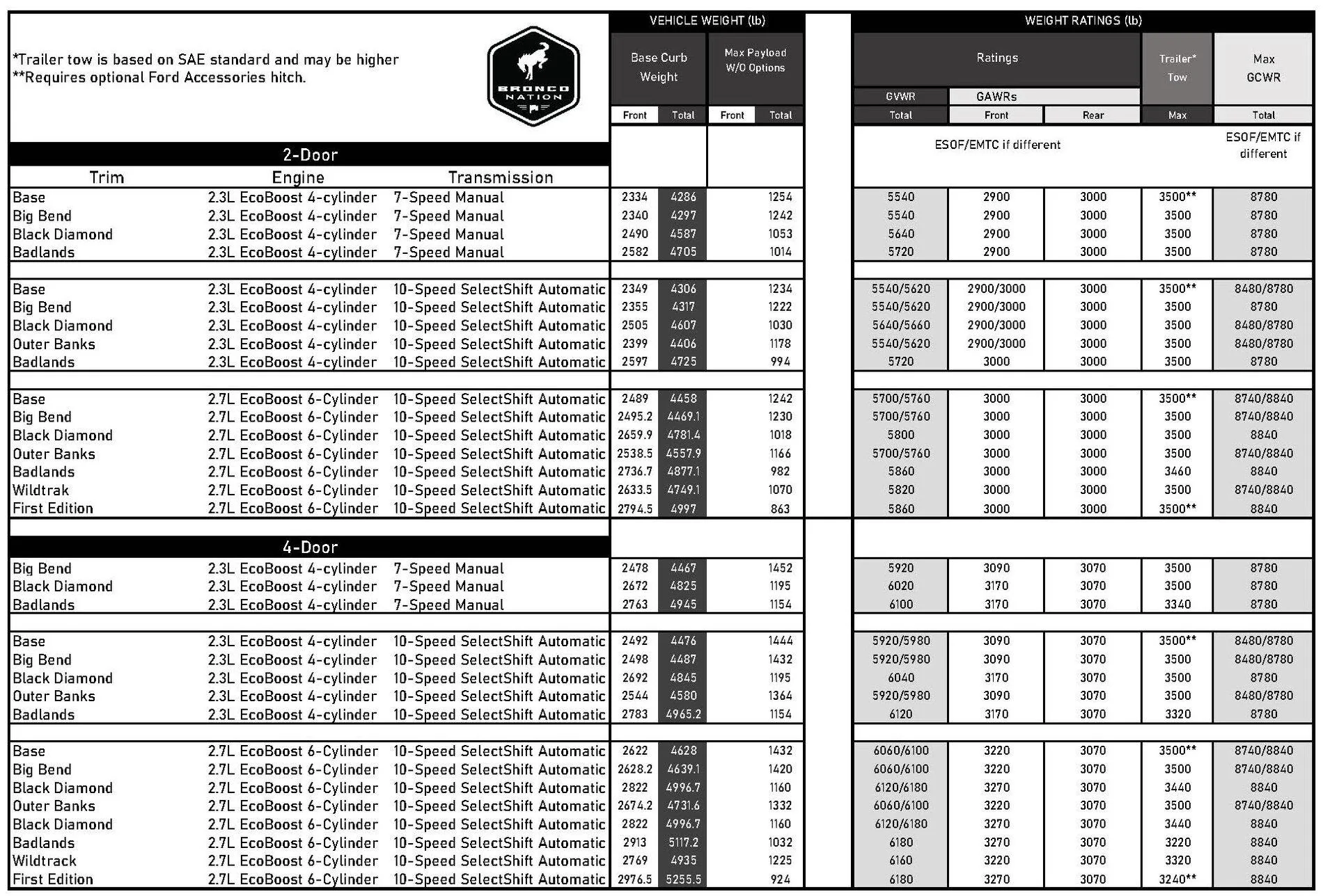

The designs are completely different: The 2.3 still has an exhaust manifold while the 2.7 the exhaust passages are in the heads without a manifold, V6 Crankshaft is shorter and also has a shorter stroke possibly making it lighter, etc.
I'm sure that there are some differences in the weight of the ancillaries between the two motors: V6 may have a larger radiator, Extra plumbing for the twin turbo setup, etc.
Even if there is a ~200 lb difference in total vehicle weight between 4 or 6, that is insignificant in a 4000+ lb vehicle.

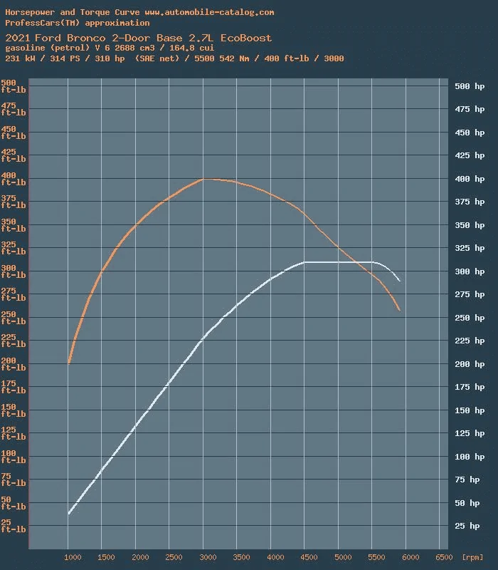

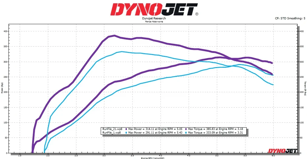

Based on what I've read on the Panda module...it looks like the 2.3 version nets a HP increase of at least 8%. That puts it at 324hp. The stock 2.7 is rated at 330 HP. So for $600 or so the module turns the 2.3 into the 2.7 while giving you the option of manual or auto. Am I looking at that (somewhat) correctly???
In short, no. Peak power numbers don't tell the whole story or accurately reflect how you'll use the car day-to-day. The power band is a way more nuanced way of looking at how a car will perform on the street. While Panda's numbers look promising (especially if you're 7MT or bust), the power band on the 2.7 still looks better, IMO.
Panda 2.3 numbers:
Ford Bronco 2.3 w module = stock 2.7??? 1638480814360
2.7:
Ford Bronco 2.3 w module = stock 2.7??? 1638480851178
Panda 2.3 is peaking in power way later and not sustaining that power for very long. The 2.7 peaks at 4.5k RPM and hold it through 5.5k. I don't know about you, but if I had a 2.3 7MT, I don't see myself getting it to the 5.5k RPM range with any kind of regularity, but shifitng around 4.5k-ish for onramps and passing seems reasonable.
That said, is the 2.3 with the tune good enough to make you not miss the 2.7? Possible, but that's up to you.
