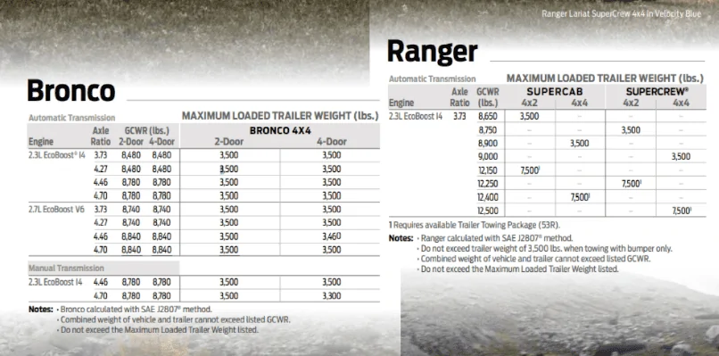

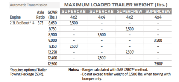

Completely agree with your turbo replacement assessment.
However, the part about needing the 2.7 to tow with is as un-informed as it is an outright lie.
2020 Ford Ranger has a maximum Gross Combined Weight Rating of 12,500 lbs.
Bronco will have a GCWR of 8,780 with the 2.3 engine or 8,840 lbs with the 2.7 engine. In Amurika terms where there's no replacement for displacement, that's a total difference of 3 racks of Bud Light (60 lbs).
Now, I don't smoke crack for a living, but in my line of work as an accountant I can tell that 12,500 lbs is a lot more than 8,840 lbs.
So what about Bronco with 2.3 is incapable of towing (regardless of door count)?
Ford Bronco 2.3 vs 2.7 compromise 1621640108537
Ranger GCWR source:
https://www.ford.com/cmslibs/conten...ral/pdf/guides/20Towing_Ford_Ranger_Oct15.pdf
Bronco GCWR source:
https://www.bronco6g.com/forum/thre...iler-weight-from-2021-ford-towing-guide.9944/

I’m not suggesting the 2.3 can’t tow, but you’re not going to tell me that a 2.3 4 door fully packed passengers and gear, pulling a 17’ camper with gear is going to hold strong thru hilly terrain. That’s when you need the torque. I’ll be towing a small enclosed trailer or snowmobiles /atv’s. But as soon as a standard height trailer is catching the wind with full passengers, I’m sure it will suck. My friends Ranger does, there’s no reason this will be better

Not sure what he's towing weight wise, what you list above is massively over what Bronco's chassis could handle. So, again, apples to oranges. Bronco does not need the 2.7 to tow it's meager 3,500 max load.
My '19 Ranger (Scab, 4x4) has hauled a 5K# trailer with 1,500# in the bed with >350 lbs of human plus more gear across the rockies without issue.
I've done the same trip with the same gear in a F350 Super Duty Dually and, yes, the F350 absolutely did it "faster" and without the driver to have any comprehension or understanding what they are doing.
However, the Ranger did just fine and there's no reason to go larger than Ranger for this annual trek (F350 was rented for the '18 pilgrimage before we took delivery of Ranger in '19).
The ability to look further than 50' ahead and understand weight in motion should be basic minimum skills whenever you've got a load capable of crushing everyone in your vehicle, plus others, to death.
