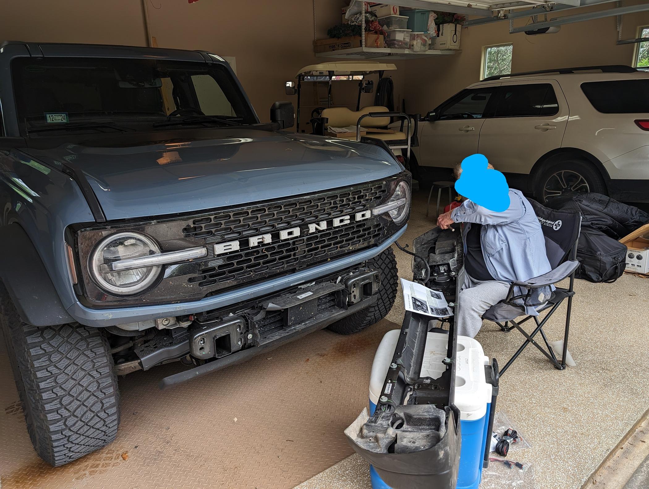

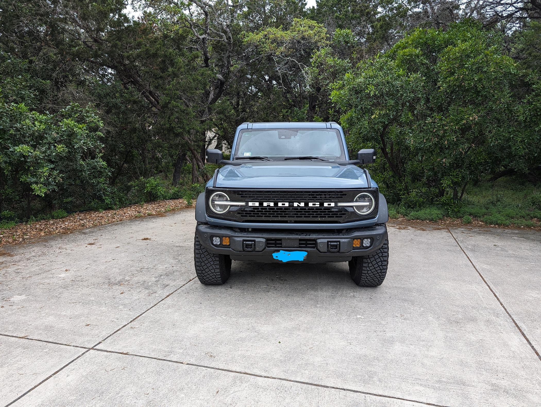

Yes, I installed mine a few weeks ago. I was able to do it without disconnecting the harness. Used a tall ice chest as a surface to rest the bumper on and I could do everything with it on that. Here's a pic of my Dad helping me out with it.
For tips: make sure everything works before you put the bumper back on. One of the supplied cables had a bad rubber seal on it that didn't let the pins make contact. I ended up needing to take the rubber part off of an unused connector that came with the lights and put it on the fog light connector the came in the kit. I thought everything was so straightforward that I didn't test the lights before re-mounting the bumper and ended up having to take it off again. It's a pretty easy job with two people overall.
