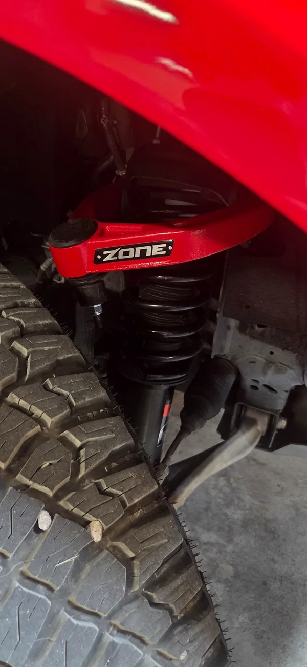

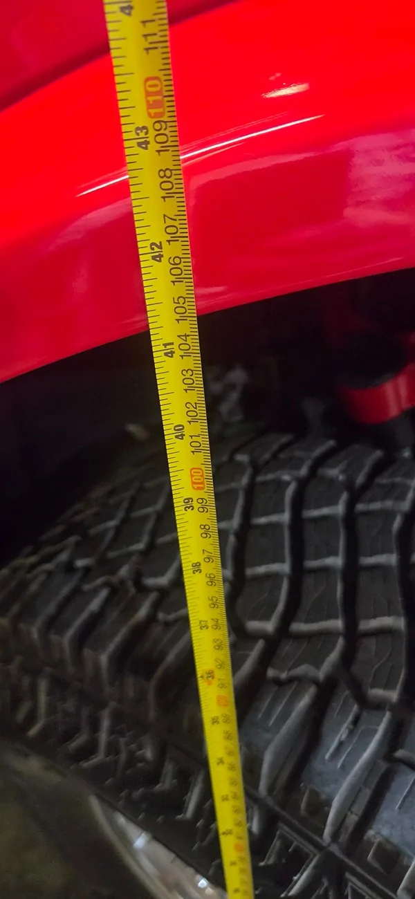

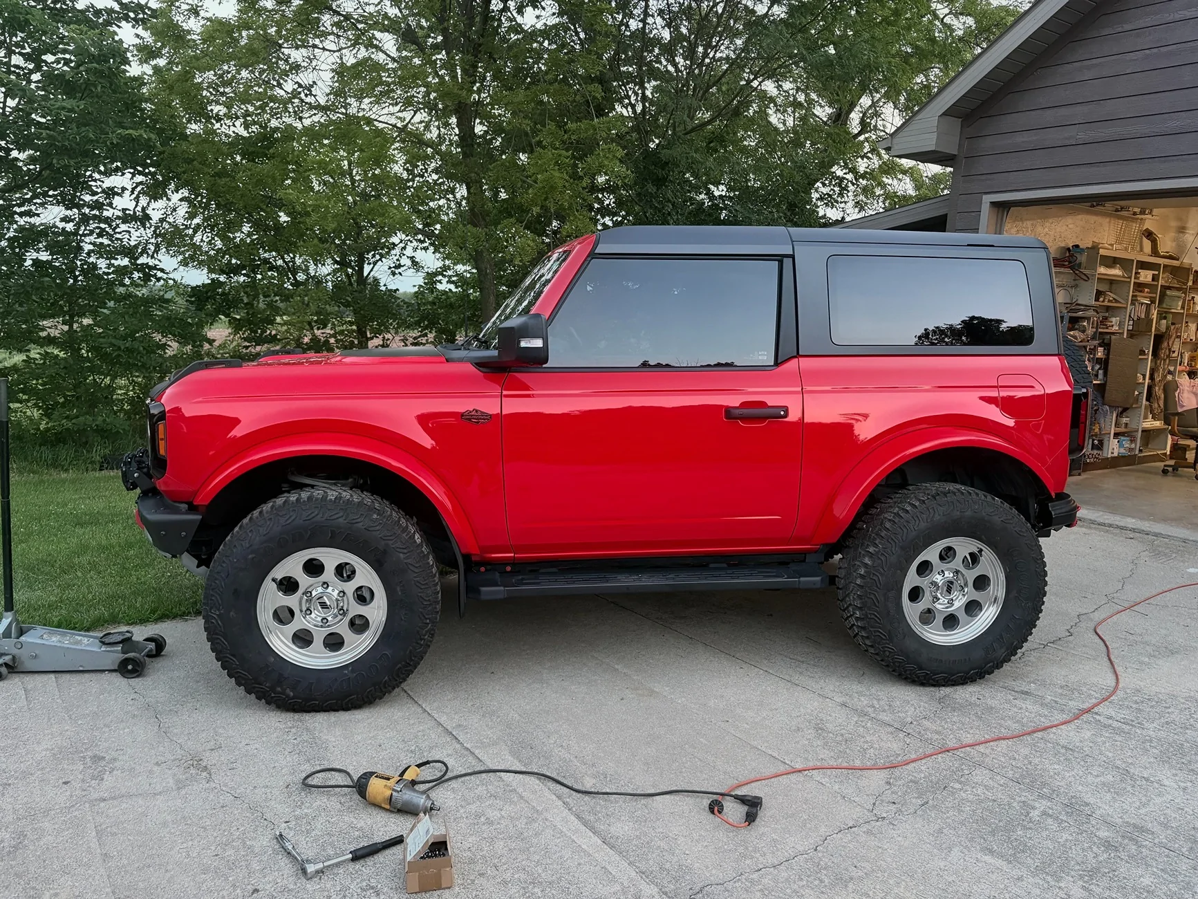

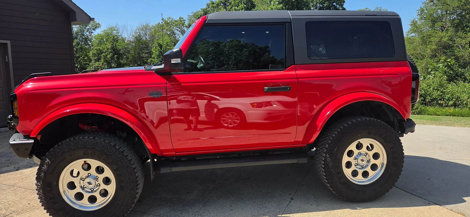

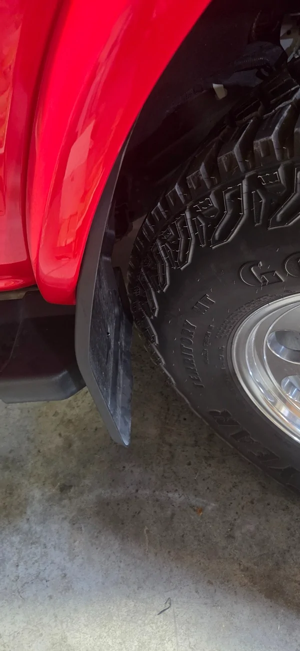

Never thought I'd add a lift to my wildtrak but came across a marketplace add for fox takeoffs for $1100 last winter and with all the bilstein corrosion talk at that time I snapped them up. With changing shocks and needing an alignment anyway I decided on the zone 2 inch level hoss 3.0 lift. After installing it all handled good and after a week for it to settle I took it to the shop for an alingment I had them follow the instructions included (specifications) in the instructions. When I went to leave it was rubbing the mudflap horribly so the teck put it back up to recheck...apparently zones specifications call for the wheels to be moved back ( castor) more than the factory sasquatch settings. We backed it off some but it still contacts on the right side I've trimmed mud flap some so hopefully that fixes it.
I'm also running stock tires with no rubbing issue in the 10k miles I've driven it. I also found a set of wheels for 500 and installed them on my wife's practically new goodyears. I forgot how bad they chuck rocks. My old set had 20k miles and had calmed down on the rock throwing. Honestly don't know if I feel a difference in shocks... they may not be quite as harsh but I can barely tell. I'm Not completely in love with the wheels but like the new stance. My factory sas wheels are 1/2 wider than the procomp. The procomp are 0 offset.

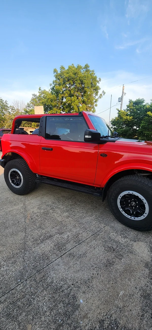

Adding a couple before picture. Unfortunately my lifted photo didn't turn out , i will add tomorrow!
