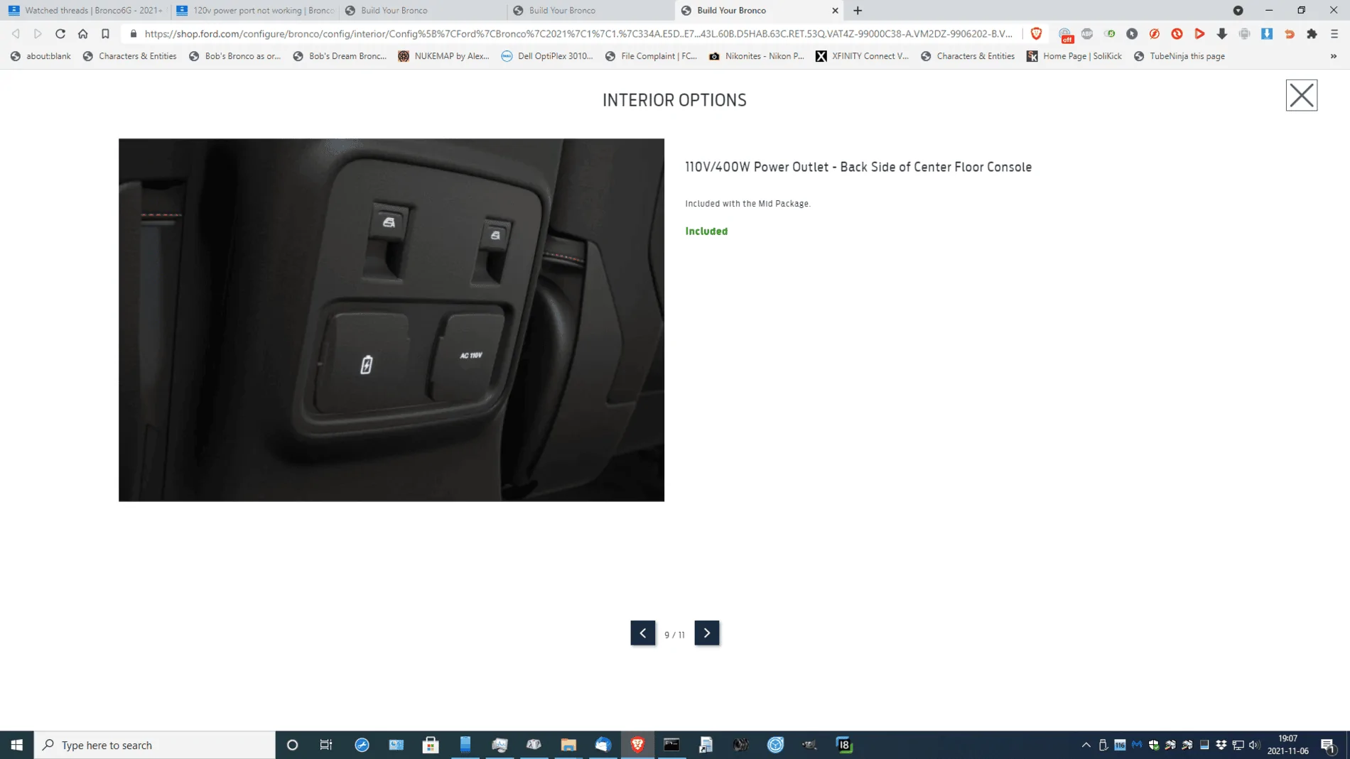

The 2021 owner's manual says it's 400 watts when in Park, and 300 watts when driving.
Ford Bronco 120v power port not working 1636251930759
mpeugeot
May 14, 2021
9,147
18,928

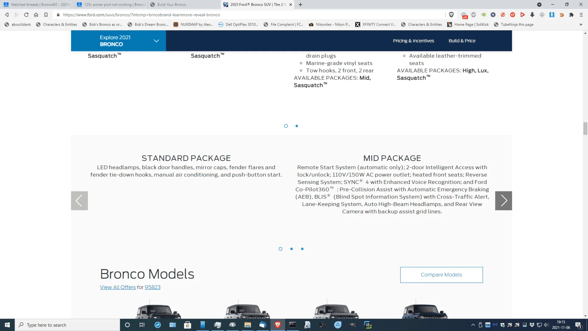

OK, I found one place where it claims that it's only 150 watts. I hope that's wrong. Everywhere else I can find any reference to the receptacle, it either says nothing about how much power, or else it says 400 watts.

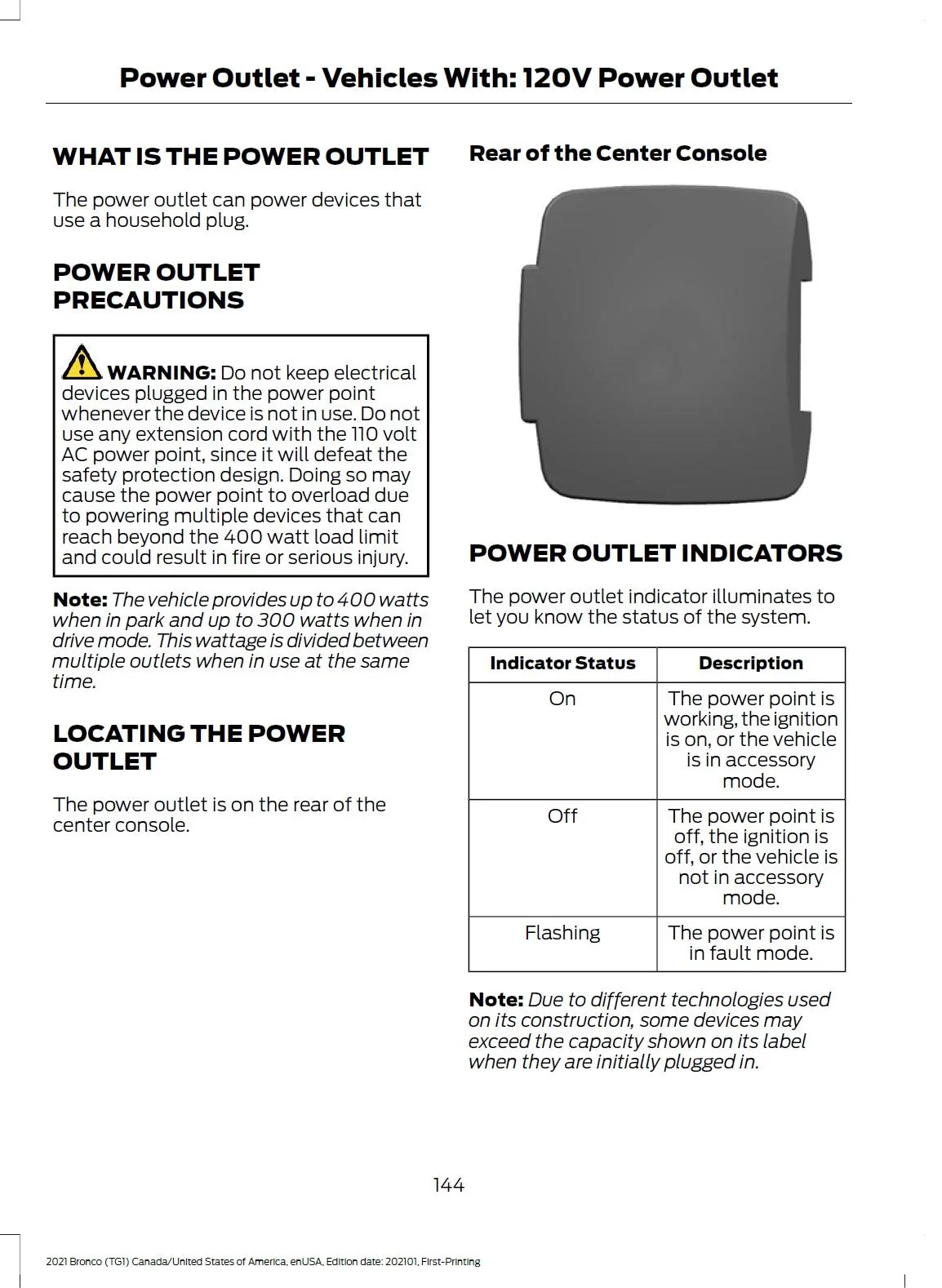

Yes, but the owners manual says this:
Ford Bronco 120v power port not working Power outlet user manual
So....

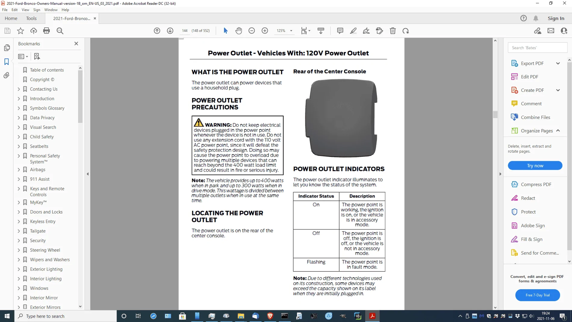

So....
Yup, that's exactly what I saw in the manual. I crawled in the back (which is no small feat for me :) ) and didn't see any indicator lights. My manual says that it is on underhood fuse 36, I pulled the fuse and it wasn't blown.

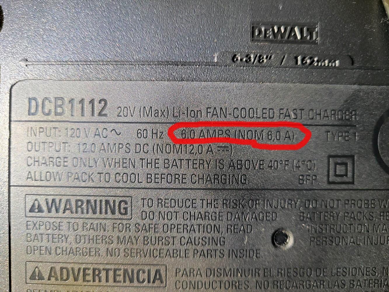

A disappointment to me is that 400 Watts is not enough to draw what the better of my two DeWalt battery chargers claims to need, and barely enough to run the lesser one.
I wonder, though, if these chargers really pull as much as they claim, or whether DeWalt greatly overstated it just to allow a generous margin of safety. 6 amps at 120 volts would be 720 watts. But the output is up to 12 amps at 20 volts, which would be only 240 watts. I know that some loss is to be expected, an of course, the cooling fan needs power, but does this charger really need three times as much power in* as it puts out?

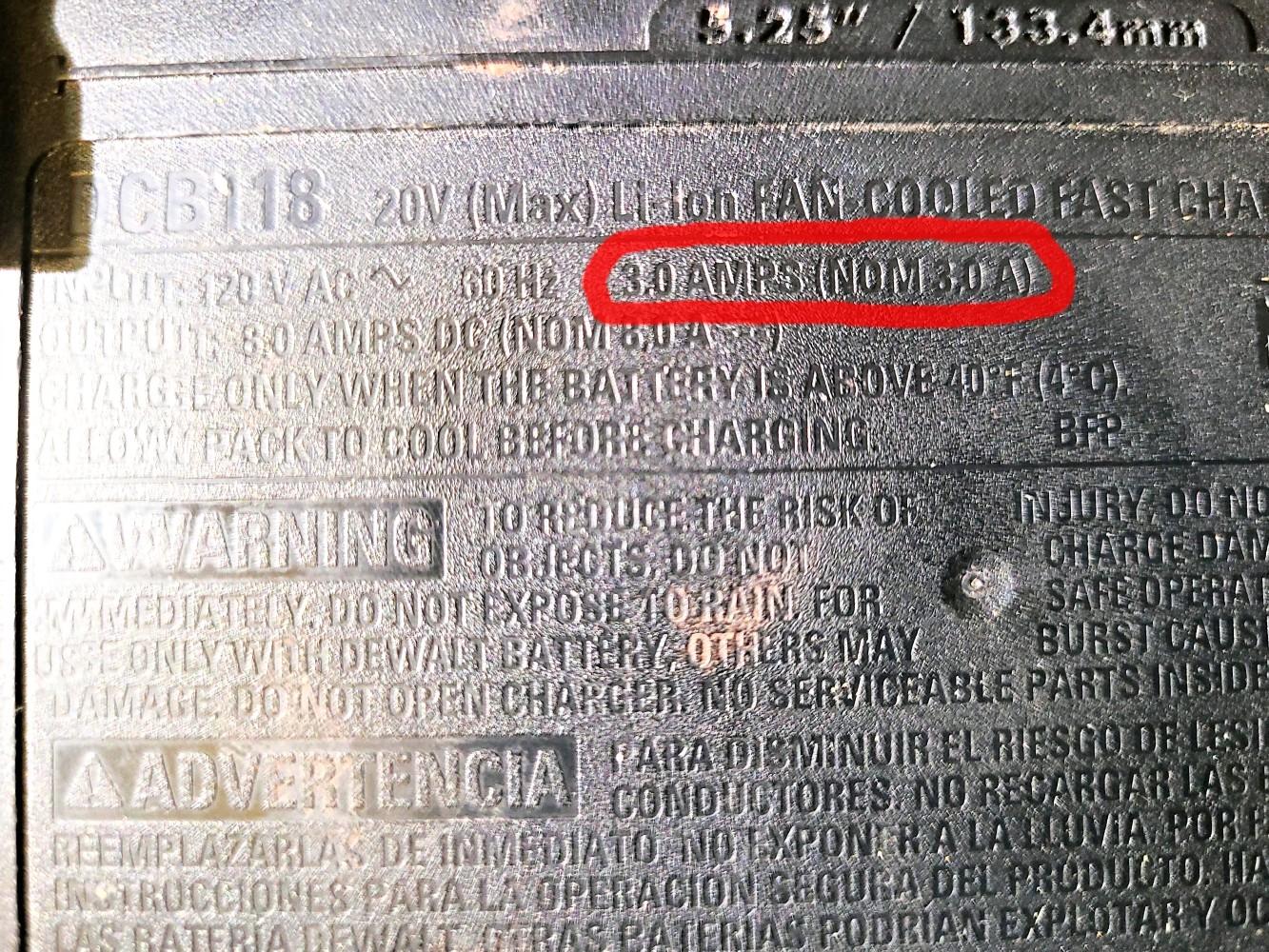

The lesser charger claims it needs 3 amps, which, at 120 volts, would be 360 watts. It outputs up to 8 amps at 20 volts, which would be 160 watts, Not as extreme as the DCB1112, but still, does it really need twice as much power in* as it puts out?
