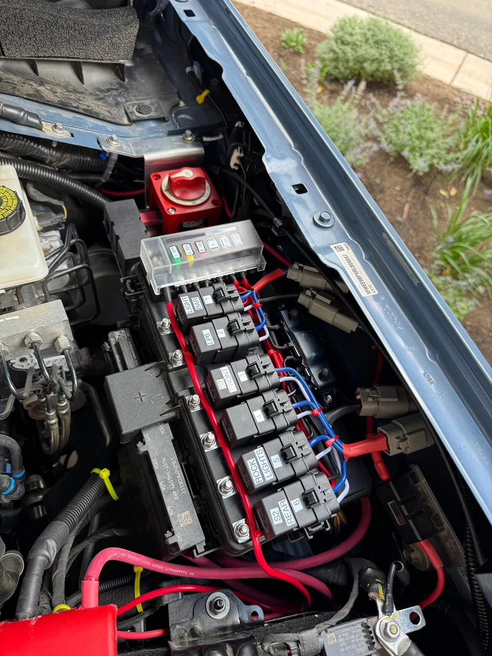

I needed to wire in 1 relay for my setup with the upfitter switches but I got bored and ran all 6 as relays. Totally unnecessary but it was fun. Power from the battery goes to the 6 slot fuse box before going to each relay. The wires going to lights and aux switches are on quick disconnects and the grounds are all going to a busbar. I built in enough slack to easily pull the fuse box lid and set aside but if it needs to be removed, it’s the 4 quick disconnects and the 2 wires going to ground and fuse box. Different colored shrink tube on the quick disconnects ensures I’m plugging them into the correct harness. Relay 4 isn’t hooked up to anything yet but it has a length of wire already to be spliced.

How do you open the fuse box without disconnecting all the relays?

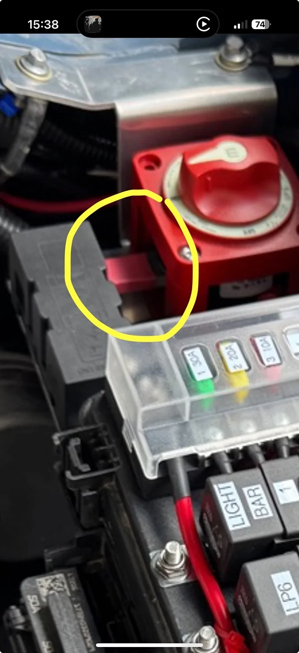

Looks clean! What do you have powered by the hard disconnect? I only ask as I have the same kit but only wanted the mount. I believe the bit circled in the attached image is two pieces of 1/8”stacked aluminum. Wouldn’t want to be drawing too much through that.
If you have enough wire you just leave them there and lift everything all at once. I have a y-splitter and fuse blocks mounted similarly. Just need enough slack to get it over to the side
Fuse box lid has enough slack in the wire harness to be pulled away. And if I do want to remove the wires, it only takes 3-4 minutes and an 8mm socket
That’s going to my dual battery setup. I have 4 20amp lithium batteries in the trunk. It’s drawing about 25 amps/hour.
