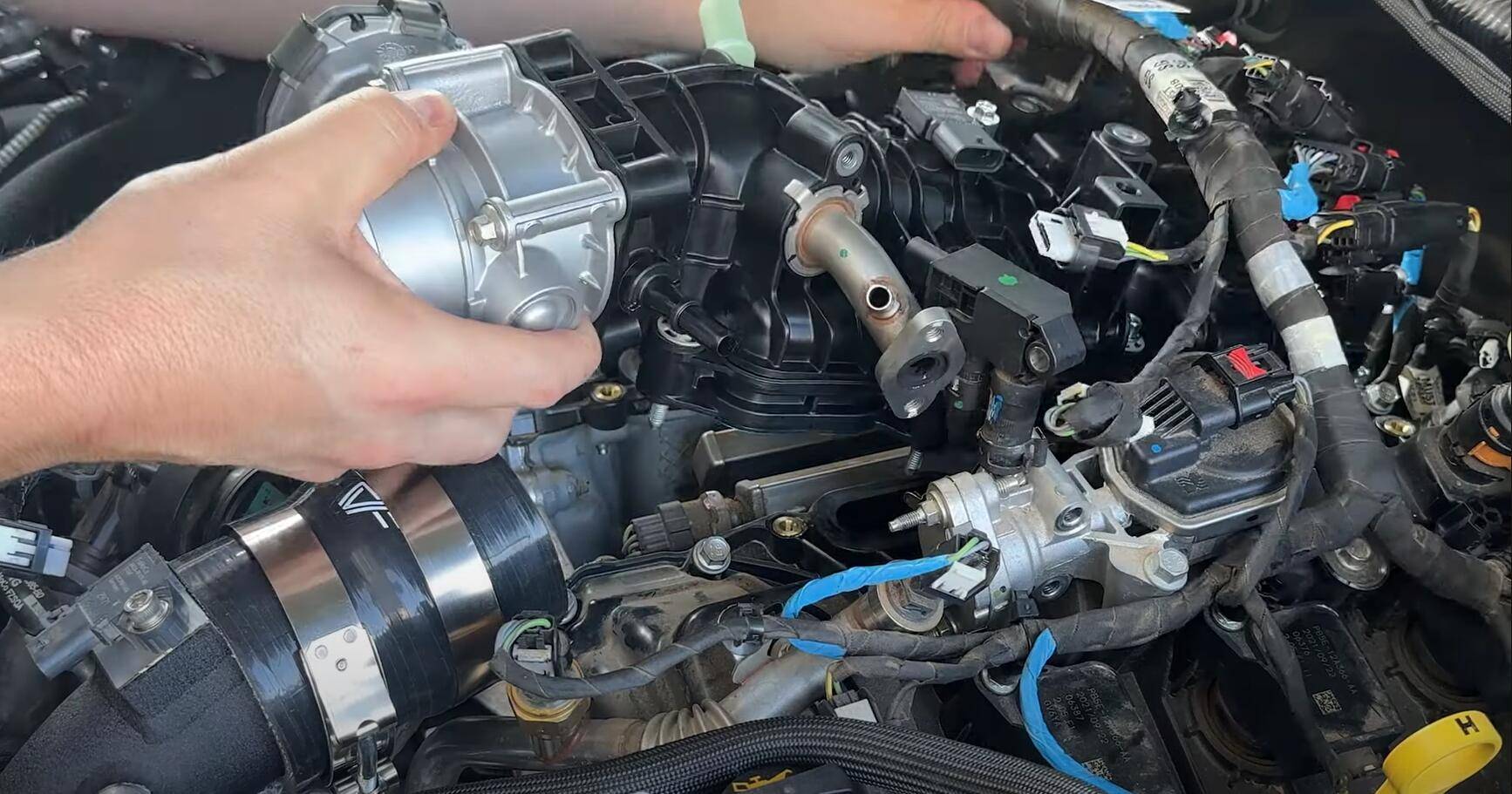

This is a follow-up to my previous post about the GPE HI-FLO ported Throttle body for 2.3/2.7/3.0 Ecoboost engines. I recently installed the GPE HI-FLO ported Intake Manifold and wanted to share my experience with the combo. I also created a video to share my thoughts and outline the installation process if anyone is interested.

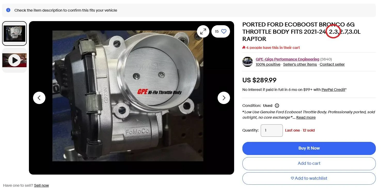

Link to the combo on eBay: https://www.ebay.com/itm/256637688245
Specs for HI-FLO Throttle Body:
  • Inlet is Ported to 69mm in a tapered style
  • Front shaft is removed for a 4mm increase in the air flow path
  • Outlet (behind blade) is mildly ported to avoid idle surging and/or the need for a custom tune
  • Retains OEM electronics for reliability and a smooth plug and play installation
  • Compatible with any aftermarket CAI or Spacer that fits a stock throttle body
Specs for HI-FLO Intake Manifold:
  • Inlet behind the TB has been enlarged by 4.5mm, so it has a 4.5mm cross sectional area increase
  • Port exits have the parting lines blended and are enlarged internally by 1-2mm depending on the port
  • Custom tune not needed
Ford Bronco GPE HI-FLO Ported Throttle Body & Intake Manifold - Install & Review 1728409152402-oe

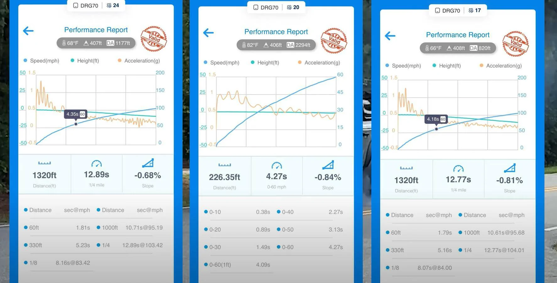

Here are the advantages I've experienced after installing this combo:
  • Better throttle response (Had to turn my throttle controller down a notch)
  • Improved low end and mid range power
  • Daily driving acceleration has improved.
  • Dropped over a tenth off my 0-60 and 1/4 mile time (Dragy verified)
Before TB & Intake Best 0-60 Before TB & intake After TB & Intake installed
Ford Bronco GPE HI-FLO Ported Throttle Body & Intake Manifold - Install & Review 1728407706789-yy
Overall, I'm happy with the purchase as I really had no idea if the gains would be worth it. IMO, this is a nice upgrade for those that have already done every bolt-on and not ready to drop big money on larger Turbos. I fit nicely into that camp :)
